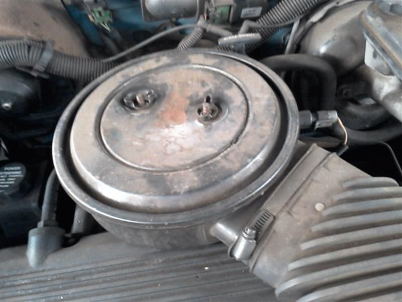

There is a split in the black hose part that goes into my air filter (I do not know the name of it). I was told it was a housing unit but every time I look it up nothing shows. I know the part is discontinued, but I need to know the name of it so I can try and find a piece. Can you help me?

I did not see it on there, but this is the piece.

I do not know why that air cleaner looks different, but here are the air cleaner parts for the 2.2:
https://www.tonkinonlineparts.com/showAssembly.aspx?ukey_assembly=807390&ukey_make=1086&ukey_model=15698&ukey_category=22490
Let me see if I can find the exact part. Is this a base model or GT and is it a two door or two door convertible?

I do not know yet, I cannot find a element or whatever they call it that has an oblong connection at the air cleaner end.they all appear to be round. that is why I wanted to confirm the model and engine and year.

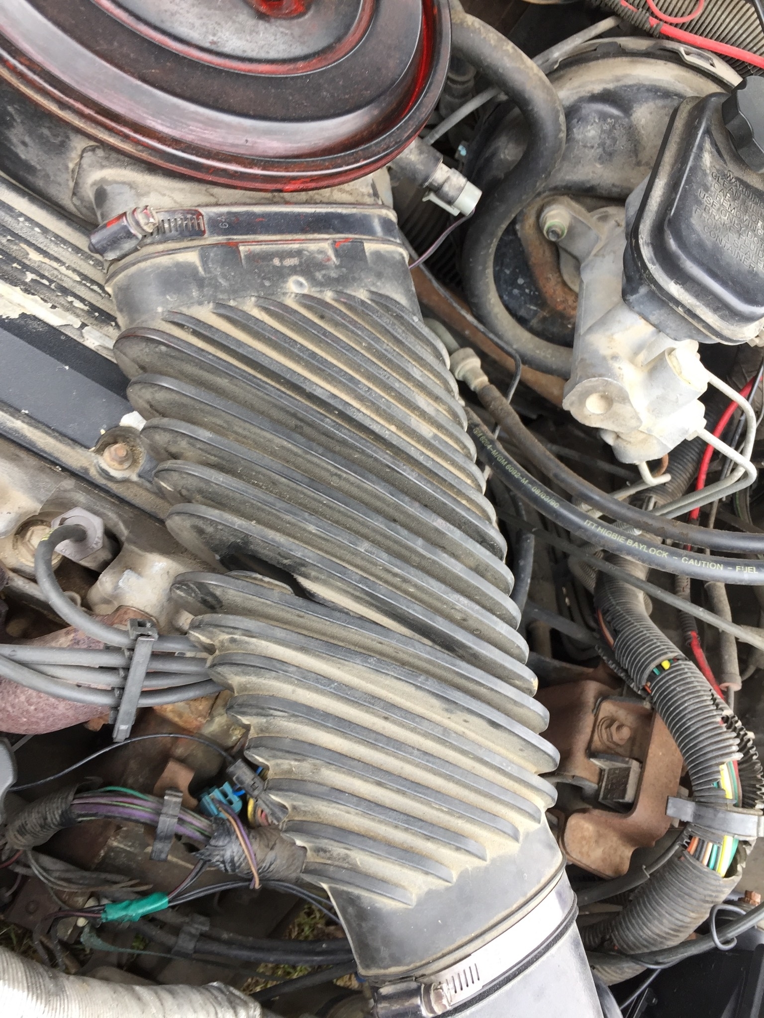

I am about to send you another picture. Give me a second.

When I looked for it online I think I found it but it was for a Cavalier, so I went back and chose Cavalier instead on that GM parts site and it does show a oblong connection at the air cleaner.
https://www.tonkinonlineparts.com/showAssembly.aspx?ukey_assembly=838884&ukey_make=1086&ukey_model=15725&modelYear=1991&ukey_category=22490
the part number is 10103592 and it is called a duct, but I did find one used for $36 here, M and K Used Auto, Inc. USA-FL(Orange-City) 1-386-775-2200

So I can use parts for a Cavalier and it will work for my Beretta?
Feb 15, 2018 at 11:32 PM
PATENTED_REPAIR_PRO
  • 1,853 POSTS
I believe so, it is also the 2.2l engine.
