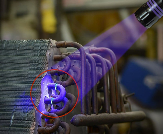

The good news is, there is always supposed to be dye added to the refrigerant. This is used to find leaks. I have included a picture below. You don’t need an expensive one, it just has to be a black light, well technically it’s purple but you get the idea.
Check everything under the hood related to the A/C, paying special attention to lines and their junctions. It can take a long time to find a leak so be patient and thorough. This way if there are multiple leaks you can address them all at the same time.

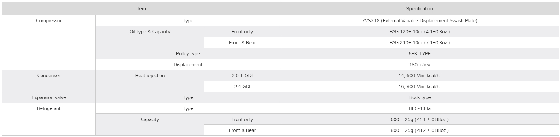

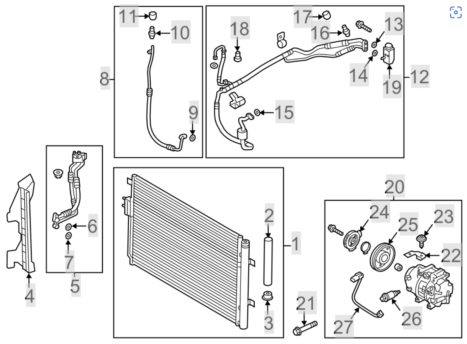

I am including a spec sheet that contains all the information on your A/C system like capacities and oil types. I also included an exploded view of the parts contained in your A/C system that are under the hood. You will see a box with a number 5 with a double hose and 2 O-rings. This is a very common place for a leak. It attaches directly to the condenser.

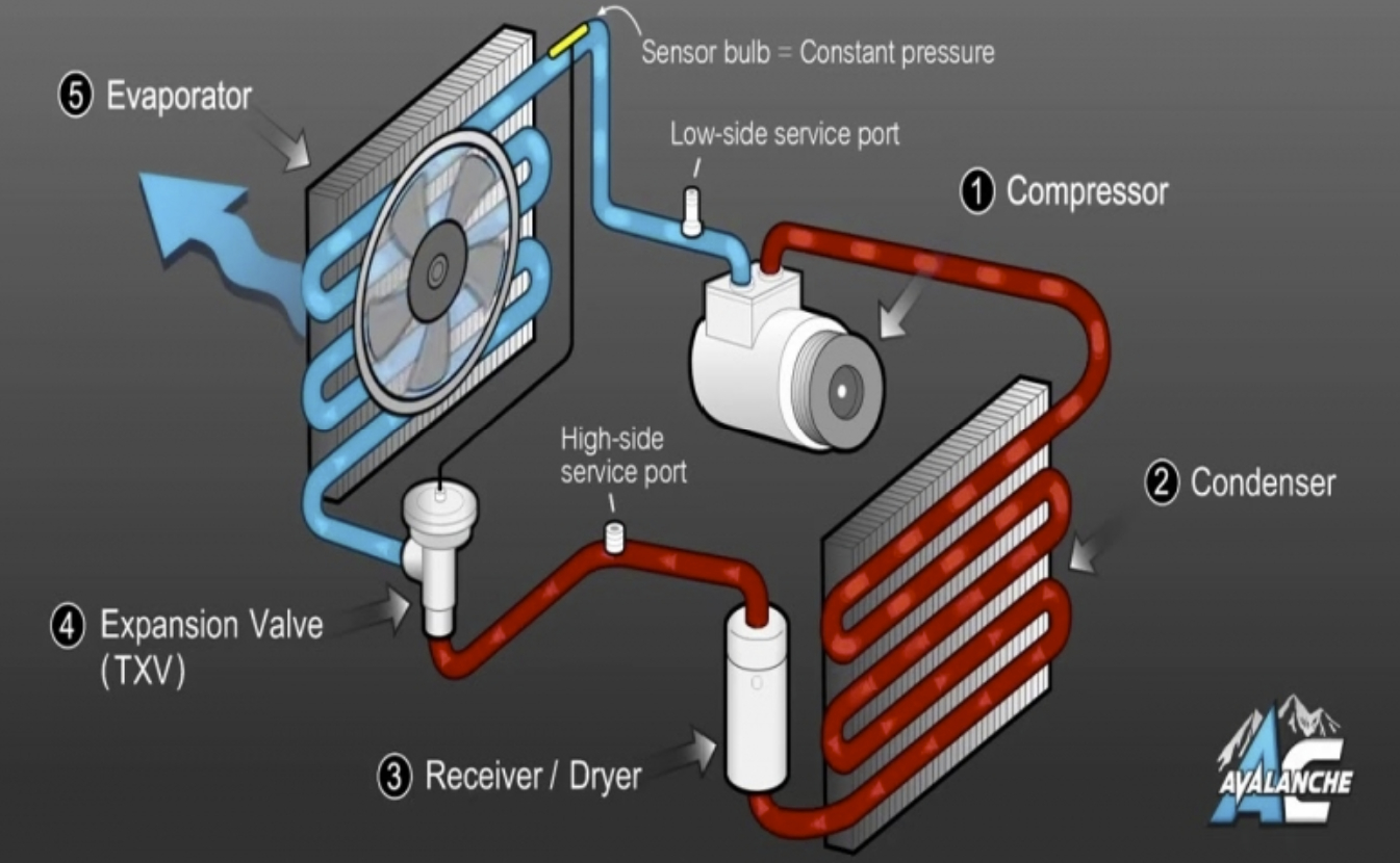

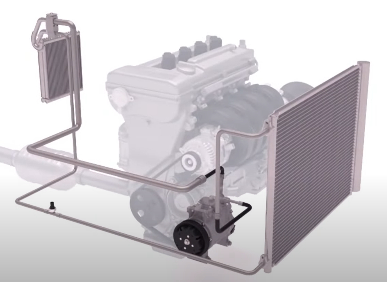

Also, I added a couple diagrams that show the components in the system. These are just generic and don’t match your vehicle specifically but show the components and the relative location. A/C systems can be intimidating to some, but they are pretty straight forward once you understand how it works.
