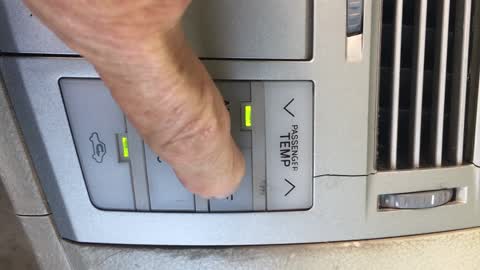

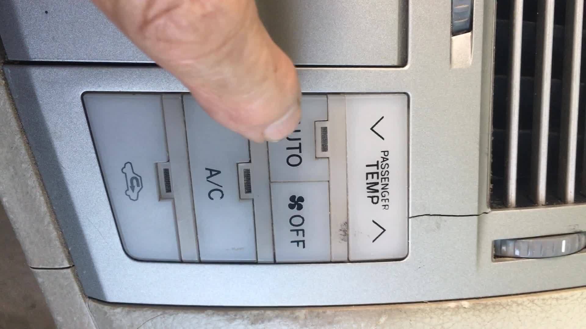

Hello Joe, I started to check/recharge the system this morning, but the hose was short, and it was difficult to assure a good connection to the low port. I did purchase an A/C Pro can with the gauge and it was much easier to use. It's 99 degrees and while the needle was in the green to start, I increased it to 50-52 lbs. Unfortunately, it did not make it cooler. When I first attempted to attach the hose from another can configuration, I may have lost some coolant. I have attached a video showing that you cannot turn on the A/C only button. You have to put it on auto.

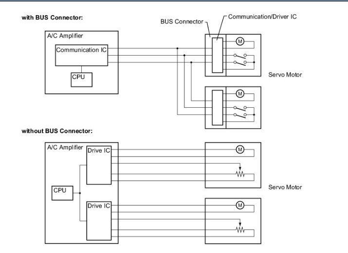

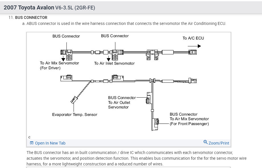

Do you have dual climate control? In other words, you can control the temps on both sides.
There is an A/C amplifier that controls the air mix motors which in turn control the temperature entering the vehicle. See pics below.
Because this is a difficult call, I would suggest having the can-bus scanned to see if there is a diagnostic trouble code stored in the HVAC module. I suggest this because the amplifier and servo motors are controlled via a wiring bus. It's easy to be wrong and spend money and fix nothing. LOL
