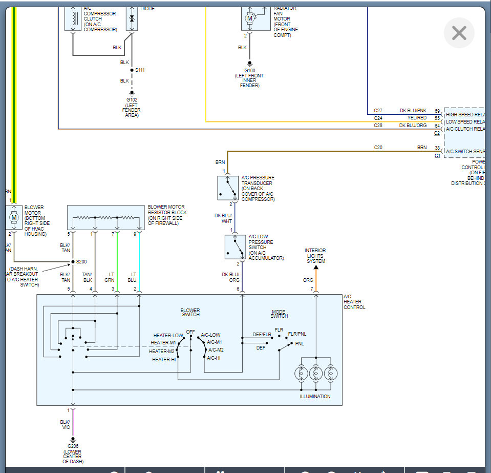

I have no air conditioning and the power windows do not work.
Jun 22, 2021 at 2:24 PM
  • CAR REPAIR CONTRIBUTOR

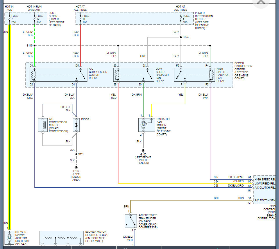

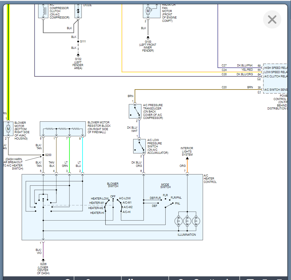

It is unlikely that these issues are related so let's start with checking the fuse and then grounding the blower motor. You do this by using a wire to jump the black/tan wire to ground and see if the blower motor comes on.
If it does then the resistor or control head is the issue.
Let's start with this info and go from there. I would suggest we start a new post on the window issue as we need to keep each post to one issue.
Let me know if you have questions on this. Thanks
