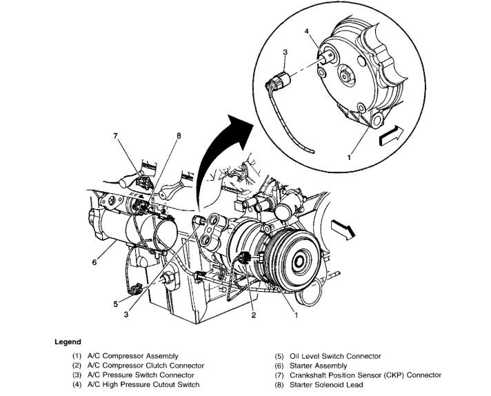

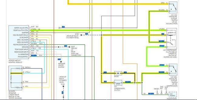

Compressor quit, replaced compressor, dryer, clutch cycling switch (low pressure) and manifold hoses on compressor. Pulled vacuum, no leaks,jumped compressor at relay and added Freon. Now compressor will not come on even by jumping. Replaced PCM, still no power. What should I try next? David.

Okay, let us start by checking for 2 powers at the relay with the key on.
87 id the wire to the compressor.
30 and 85 should have power.

Again, you do not have power to 87. That goes directly to the compressor. 30 is the pin that has power, not 87.
Okay, go to the switches on the lines. Check for power to the switches. Let us see if they are getting power.

Okay, a couple of posts ago, I told you to check the switches. You need to test for power to the switches. They send a signal to the ECM and when the ECM sees the correct signals, it will ground the load side of the relay and turn on the compressor.

Those are way too low. You need to have 12 volts to the switches.
Did you check both sides of the switch on the dryer? Hook up the switch and measure both sides. You will have to pierce the wires.
You need to get to the high pressure switch wiring. You need to check for voltage at and through that switch as well.

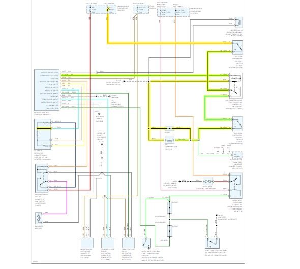

Sorry for delay, but just removed comp and high pressure switch in rear. There was a bent male prong in switch and no connection . I went ahead and replaced all three pressure switches, re-installed comp, pulled vacuum and no leaks. Added one 12 oz can and compressor came on pressures are 34 low and 250 high. Temp is 85 vents are cold. I read that this truck needs 30 oz, should I add more and are these pressures okay? Thanks.
Jun 13, 2020 at 5:14 AM
The low pressure is a little high. It should be 30 tops and rock solid.
As long as it is cold at the vents, you are good.
Do not install more Freon. That will overcharge it and cause it not to blow cold air.

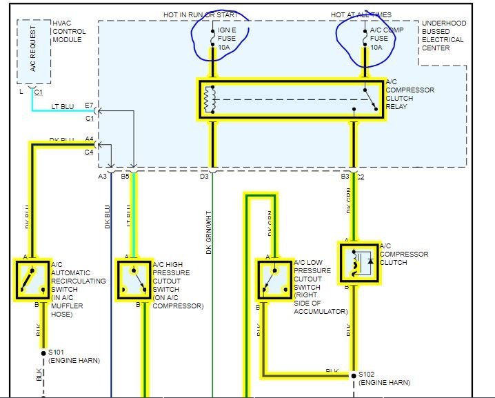

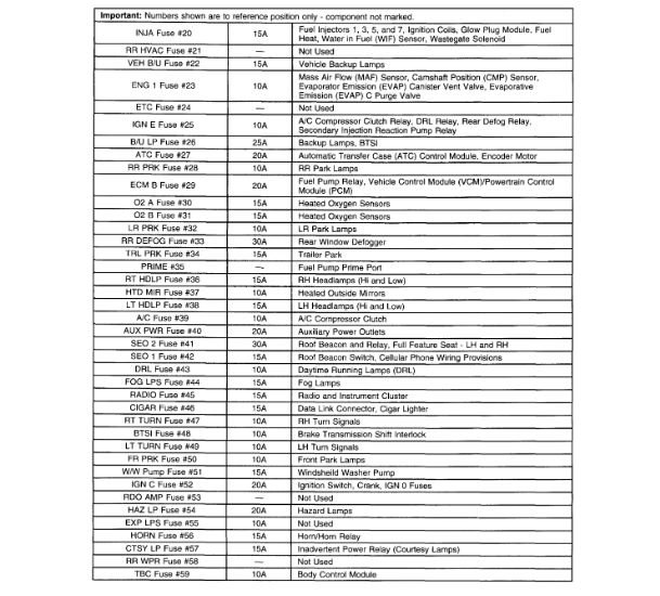

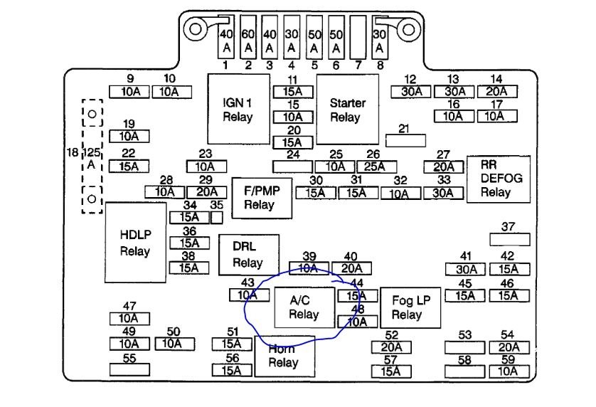

CORNGOLD3

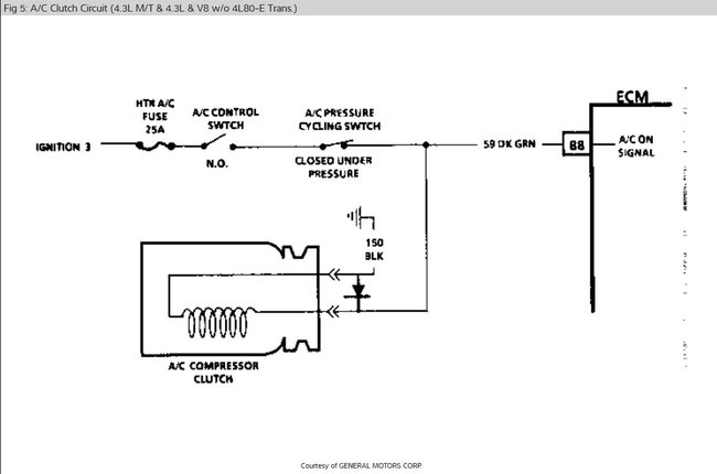

Truck listed above is a C1500. When I push the A/C button the clutch assembly does not engage to turn the compressor on. I have ran a wire from the positive terminal to the A/C harness and the clutch then engages. I replace the low pressure/cutoff switch on the accumulator but it still does not work. I have a new compressor, accumulator, any idea what's going on with this unit?
Dec 18, 2020 at 1:47 AM (Merged)

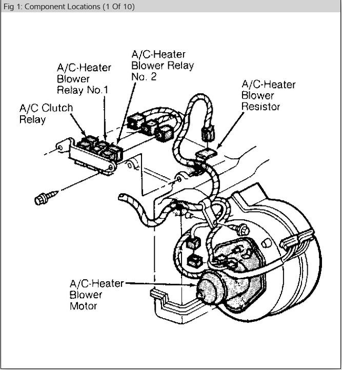

94 TRANSAM
  • 680 POSTS

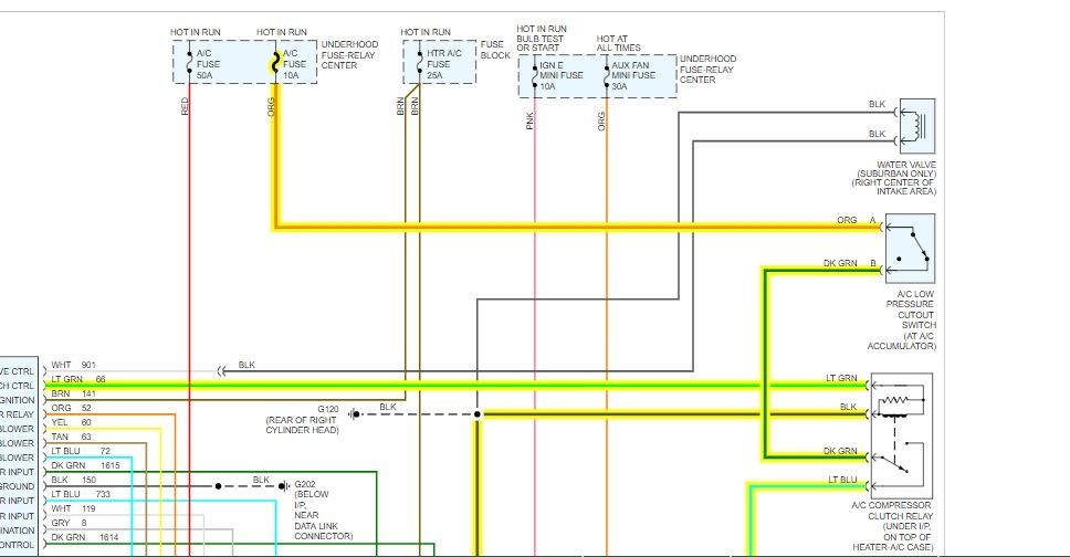

I would start with the A/C clutch relay.
Location is behind the right side of the dash sitting on top of the air-box. See diagram below.
Make sure you check the fuse and confirm voltage to the relay.
Confirm you have a good ground at the clutch winding.
Wiring diagram below also.
Also check the charge level. If it is too low the clutch will not engage.
https://www.2carpros.com/articles/air-conditioner-how-to-add-freon
Rich
CORNGOLD3
Hello 94 TransAm, I pull the relay pack out and verified all 3 of the relays and they all checked out good, I even swapped the A/C clutch relay with the other 2 relays and the compressor clutch still will not pull in. I jumped the A/C control switch on the accumulator out to see if that was the trouble but it still did not pull in. I pulled the relays off and verified that they were operating correctly by applying 12 volts to pins 30 and 87(?) and I heard the relay exercise(all 3) I measure the resistance between 85 and 86 and all 3 produced 74-75 ohms. What would you recommend I do next?
94 TRANSAM
  • 680 POSTS
Just because you hear a click from a relay doesn't mean its working. The click is the electromagnet pulling in the contact for the load circuit. Over time that contact gets charred and burnt and will no longer pass current. This is more common in a bad relay than to not hear the click. When testing relays you need to first put 12v to the trigger side and see if it does click. Then you need to leave it plugged in, trigger the relay and check the output voltage on the relay. If you do this unplugged you may read 12v no load but that burnt contact will pass voltage but not current. Thus it will read 12v free but under load it may read .03v for example.
You should always test relays in circuit.
You should also confirm you have 12v on the feed circuit for the load circuit. If there is an issue before the relay it's obviously not going to work.
Also, all the switches in the system are tied together, so as I said before you need to put a gauge on it and check the charge level. Too much gas or not enough will kill the clutch circuit. You need to confirm the charge is correct. You could be doing all this testing over it needs gas or its over charged.
Let me know what you find.
Rich
