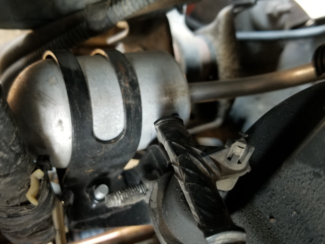

Yes the fan is working. I have attached a picture of what I believe is the drier. How do you remove and install the drier? It looks crimped. Is there a special tool?
Jun 2, 2018 at 5:12 PM

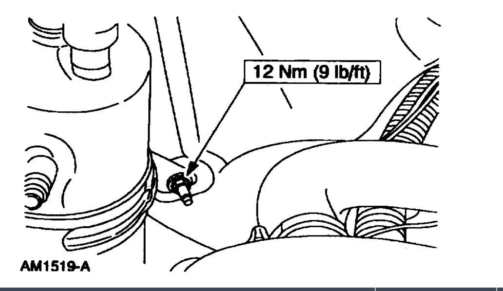

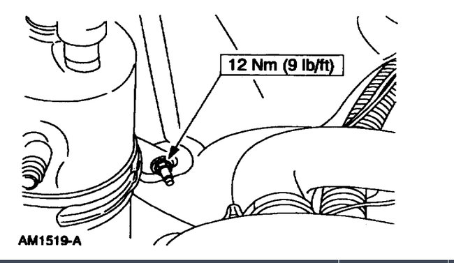

That is not the dryer.
I attached a picture for you. It is bolted to the firewall and has a low pressure switch mounted on it.
It is part of the low side line.
