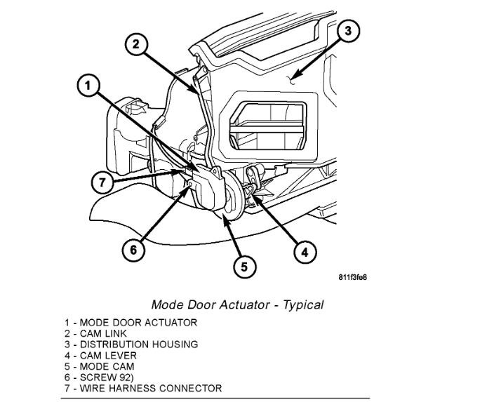

A/C and heater will only go through the defrost port
HOSSDOG64
  • 2004 DODGE DAKOTA
  • 3.6L
  • V6
  • 2WD
  • 72,121 MILES
I've checked all the vacuum lines non are messed up or broken. Any suggestions?
Monday, March 18th, 2019 AT 3:45 PM
  • 52,797 POSTS
Good afternoon,
This sounds like the mode door actuator is not responding.
I attached a picture and a procedure for you to view.
Removal
Warning: on vehicles equipped with air-bags, disable the airbag system before attempting any steering wheel, steering column, or instrument panel component diagnosis or service. Disconnect and isolate the battery negative (ground) cable, then wait two minutes for the airbag system capacitor to discharge before performing further diagnosis or service. This is the only sure way to disable the airbag system. Failure to take the proper precautions could result in accidental air-bag deployment and possible personal injury.
NOTE: The single zone heating and air conditioning system is equipped with a single mode door actuator.
1. Disconnect and isolate the negative battery cable.
Mode Door Actuator - Typical
2. Disconnect the wire harness connector from the mode door actuator.
3. Remove the two screws that secure the mode door actuator to the HVAC distribution housing.
NOTE: When removing the mode door actuator, make sure that the mode door cam and all mode door links remain in their correct installed position on the distribution housing.
4. Remove the mode door actuator from the distribution housing.
INSTALLATION
1. Position the mode door actuator onto the HVAC distribution housing. If necessary, rotate the actuator slightly to align the splines on the actuator output shaft with those in the mode cam.
2. Install the two screws that secure the mode door actuator to the distribution housing. Tighten the screws to 2 Nm (17 in. Lbs.).
3. Connect the wire harness connector to the mode door actuator.
4. Reconnect the negative battery cable.
