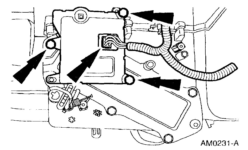

cannot adjust air condition or heater. Constant heat. Cannot adjust temperature.

The heat in that vehicle is controlled by a blend door that regulates heated air flow. it is operated by an electric motor/actuator. The problem can be that the actuator is stripped or inoperative or the door itself could be damaged. This is what needs to be determined by examining the actuator and see if it is responding to heat change commands or not.
You can access the actuator by removing the glove box.
