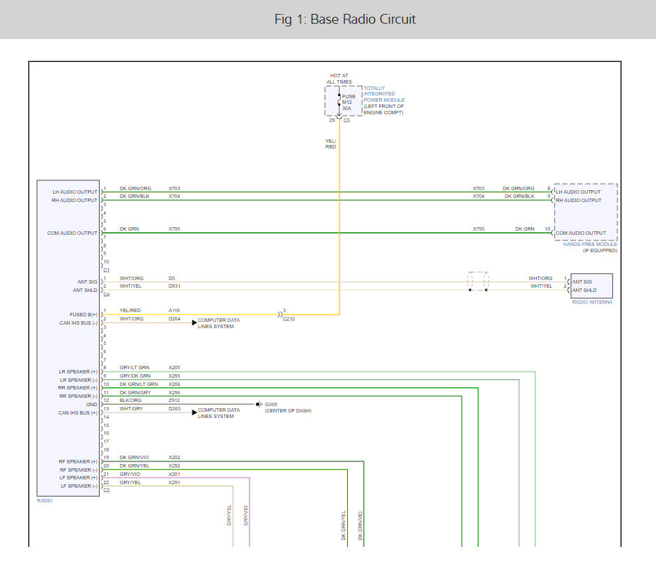

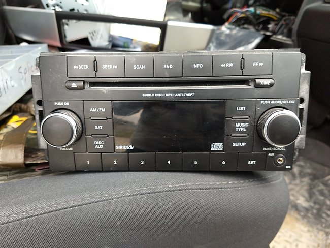

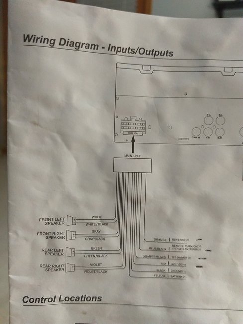

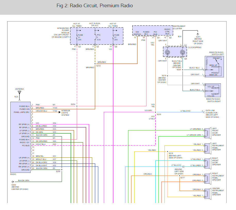

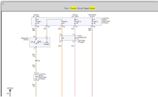

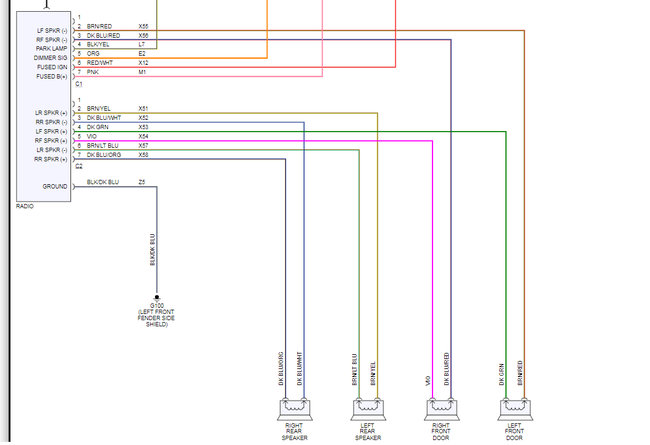

I have a white wire with orange tracer and a white wire with gray tracer. I'm not certain where they go or to what other wire to connect to. I have an orange and orange/black remaining as well as red and blue/black.
Dec 28, 2018 at 10:51 AM
STEVE W.
  • 15,200 POSTS
Welcome to 2CarPros,

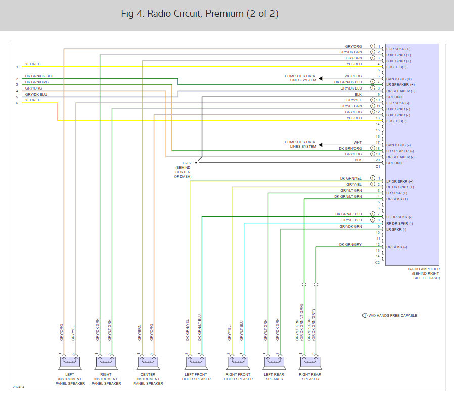

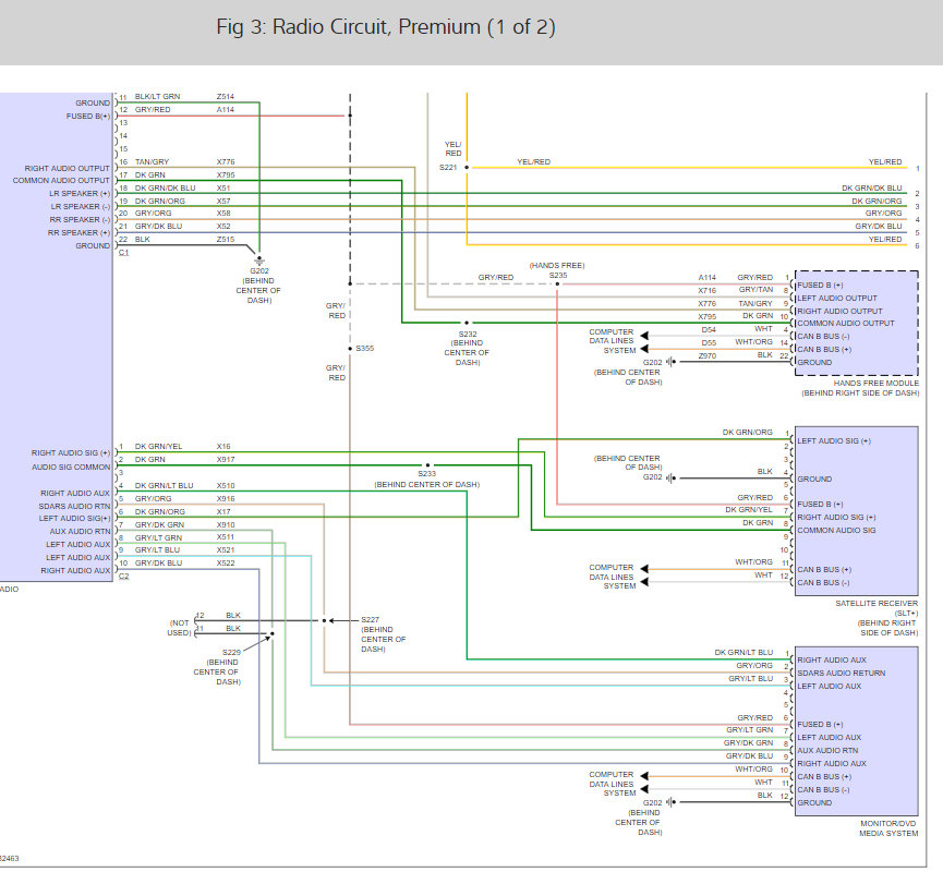

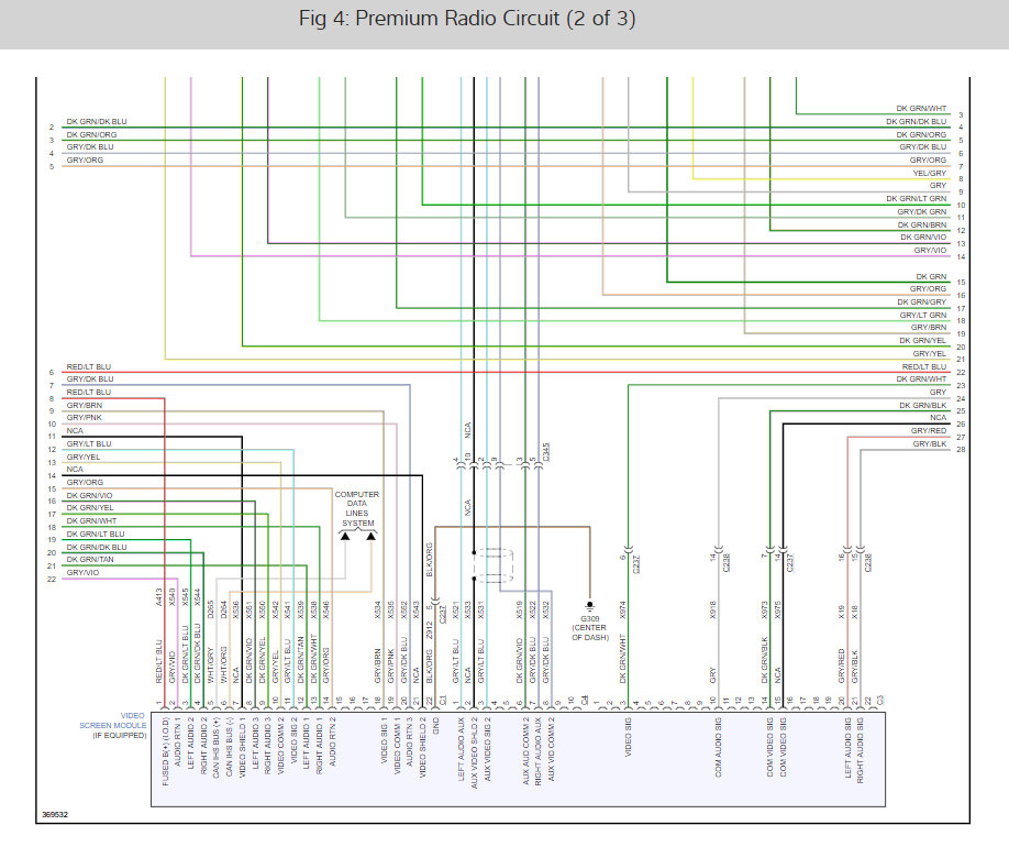

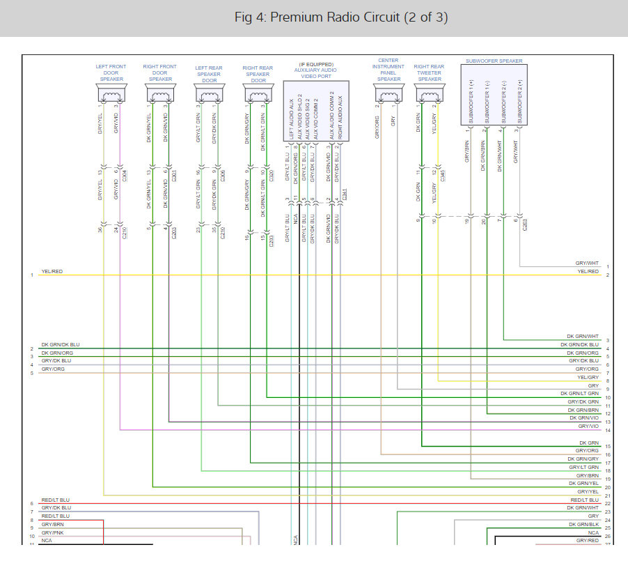

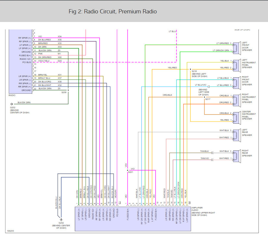

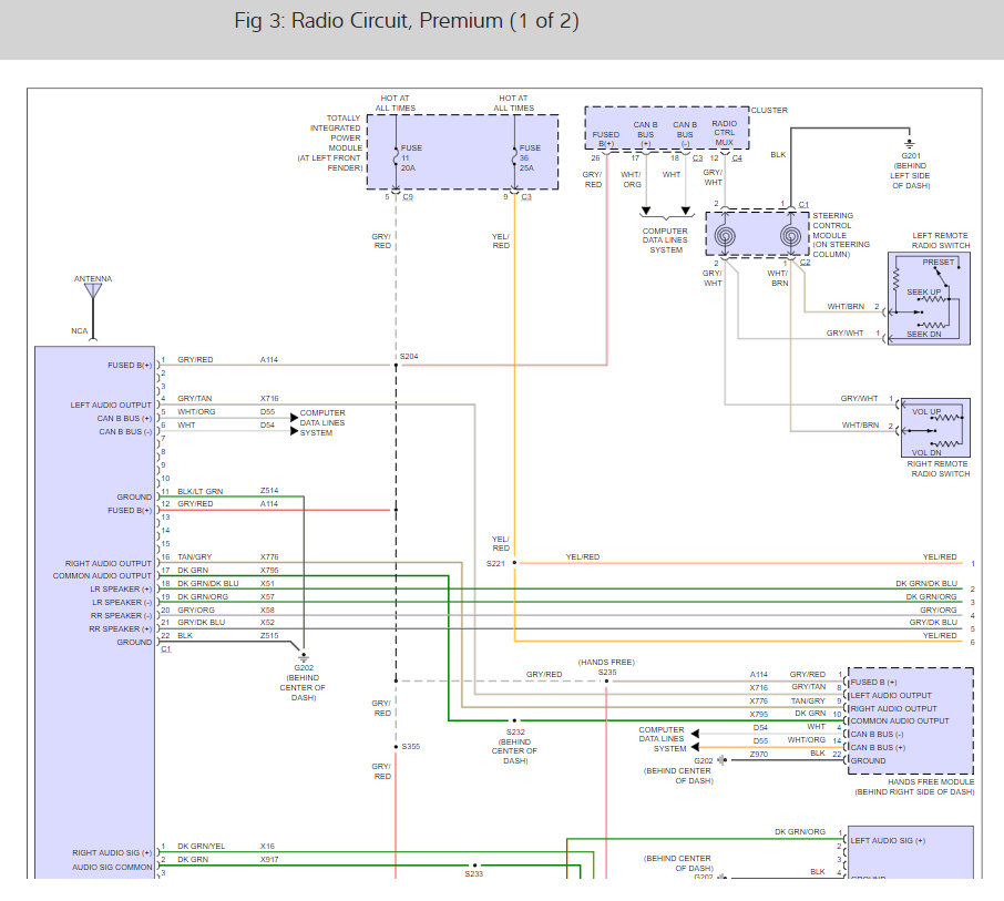

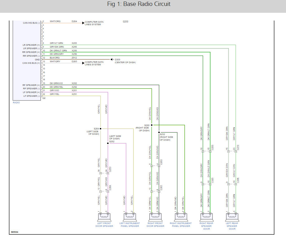

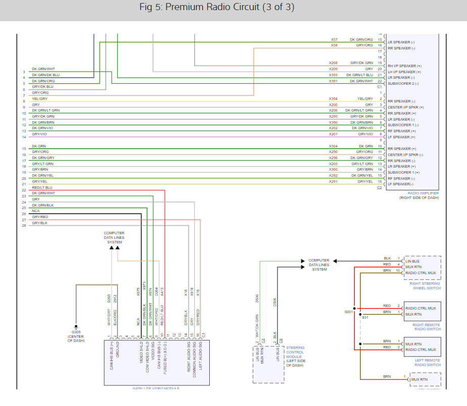

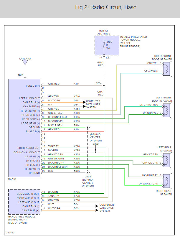

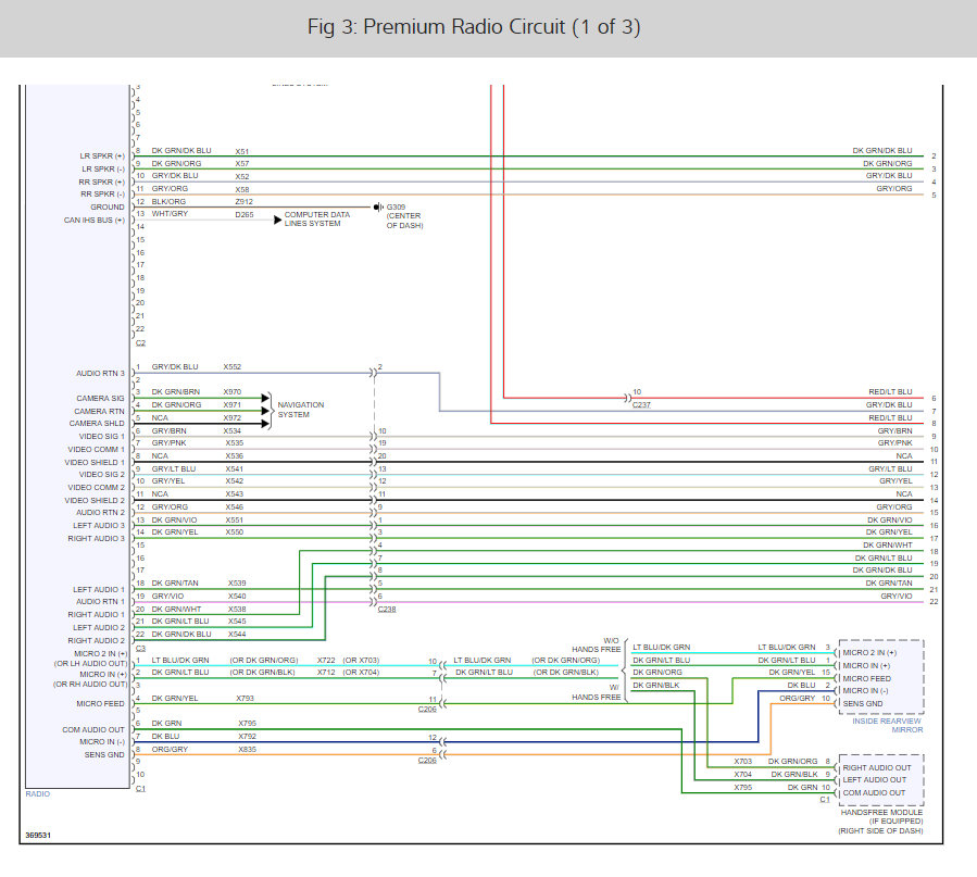

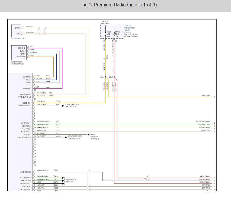

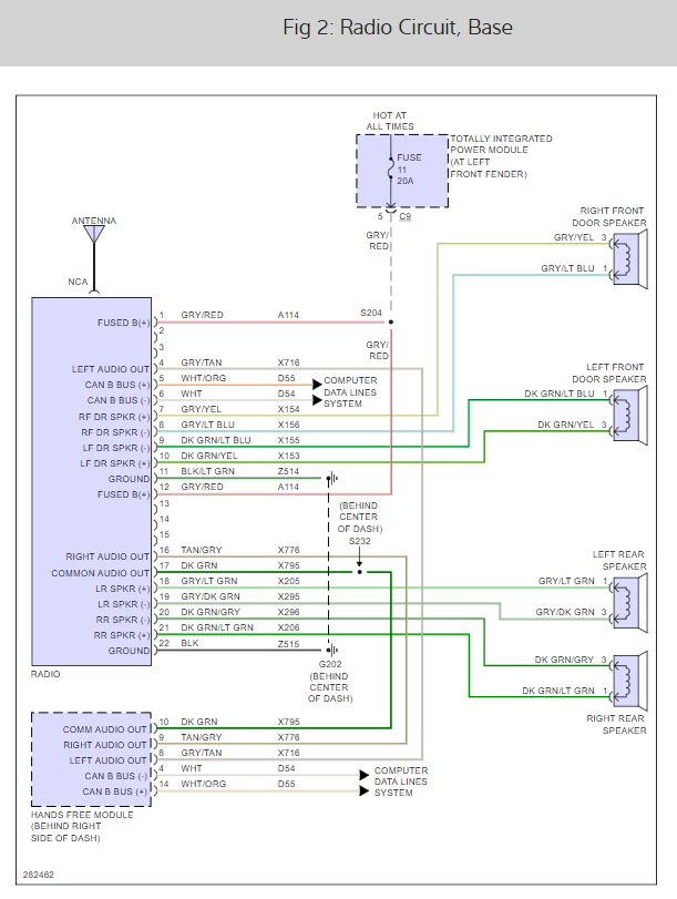

On which end are these wires? Truck side or the radio? Which radio option was in the truck from the factory as the wiring changes depending on the options. Here are the radio wiring diagrams you requested and a guide to help check the connections.
I have included radio wiring for both base and premium units. Check out the diagrams (Below). Please let us know what happens.

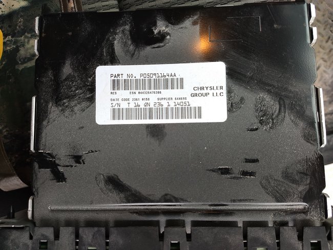

The white/orange and white/grey are on the truck side. Original radio image is attached.
Dec 28, 2018 at 12:46 PM
STEVE W.
  • 15,200 POSTS
Okay, those are the computer data lines that were used to control the OEM stereo. I doubt the replacement unit will use them. However it depends on the new unit. If you post the make/model number of the new one I can see if they have an online wiring diagram and see if it uses those. Do the orange and orange/black, red and blue/black you have remaining come from the new radio?

Yes they are on the new unit. I have attached the original diagram that came with the radio. Dual - XVM286BT. Thanks for you help.

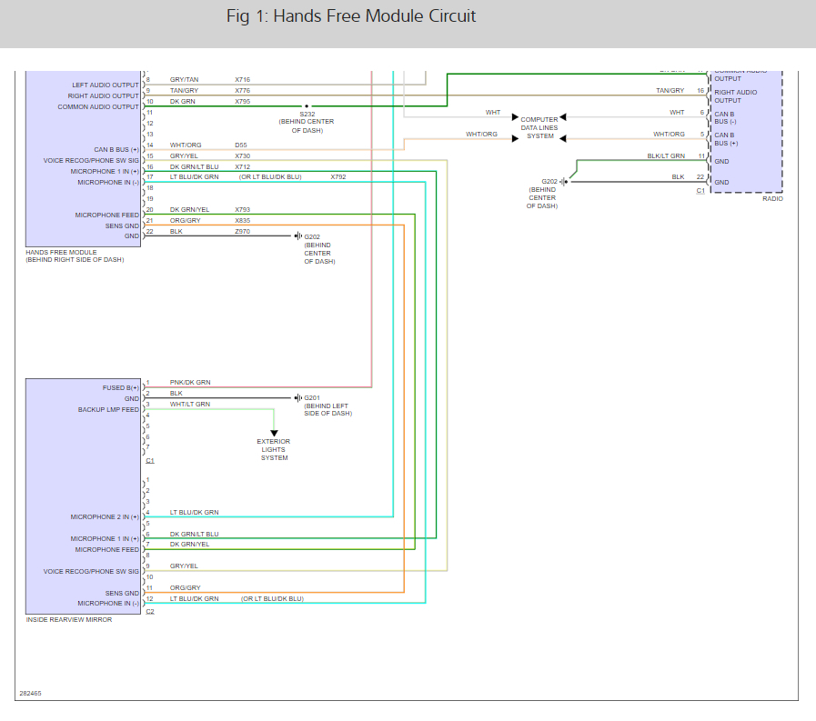

Looked it up.
Orange wire would connect to the wire that turns on the back up lights. It would tell the radio you are in reverse and to turn on the back up camera.
Orange/black wire is the dimmer for the radio screen.
Blue/black wire is the remote turn on, it would be used to turn on the OEM amplifier and amplified antenna.
Red wire is an accessory power feed. It goes to a switched power feed to turn the radio on/off as you turn the trucks key on and off.
The reverse wire, dimmer, and remote are all part of the vehicles network so there is no direct way to connect them. It might be possible to find wires that would control those items but because most of them are ground switched you would need to add relays and be sure that it doesn't cause issues with the computers signals.
You have V6 in the trucks information. Is this a Dakota or full sized truck? If you verify the vehicle information I can see if the wiring diagrams show places you might be able to connect them.

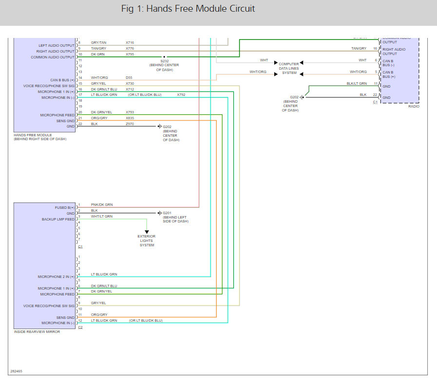

The radio is tied to the hands free and satellite portion of the car so it sounds like that got interrupted. I would try to find a harness adapter or try to figure out what goes where to satisfy the CAN and security systems of the car. Here are wiring diagrams to help you see how the system works and a guide how how to test the wiring:
Check out the diagrams (below). Please let us know what you find.

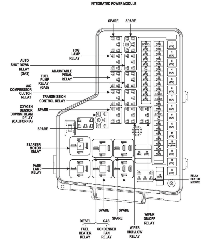

I tried to replace the factory radio, and couldn't get it to power up. Had the factory wiring already stripped, and set that back in the dash until I can get back to it next week, while figuring out if the problem is the radio or the truck. Since then, though, I have no dome lights when the doors open, no lights on the dash, and power locks only work when the ignition is on. I had no issues with any of this before. Are these somehow related to the wiring for the radio?
Aug 27, 2020 at 11:06 AM (Merged)
  • 54,840 POSTS

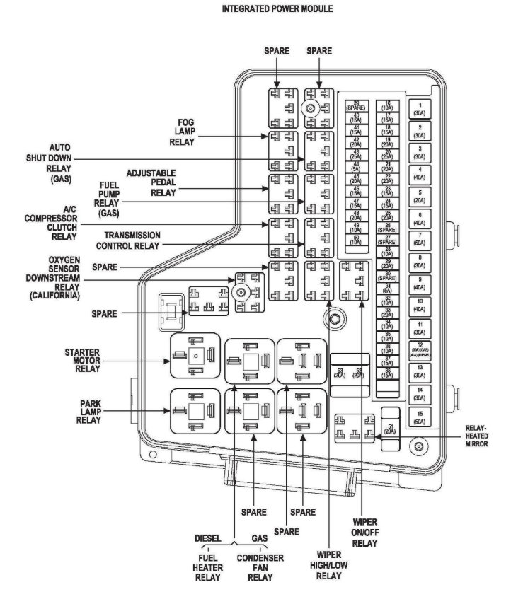

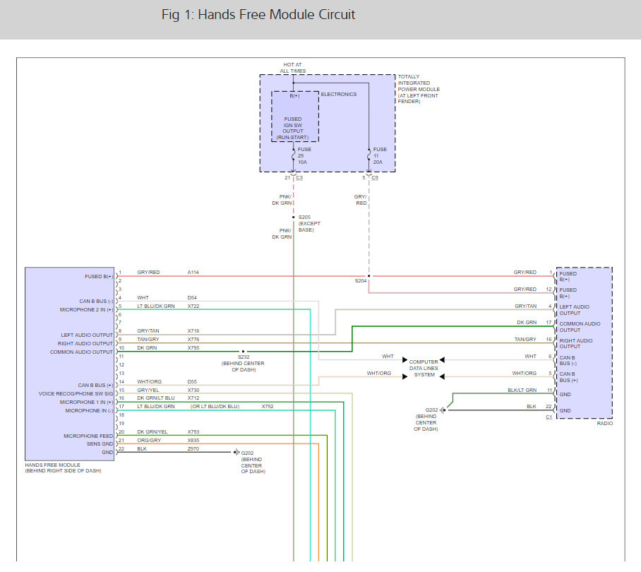

It sounds like one of the wires might have grounded popping a fuse I would check fuse # 51, 2 and 21. Here is a guide to help get you started and the fuse locations with the radio wiring diagrams so you can see how it works:
Check out the diagrams (below). Please let us know what happens. Cheers, Ken

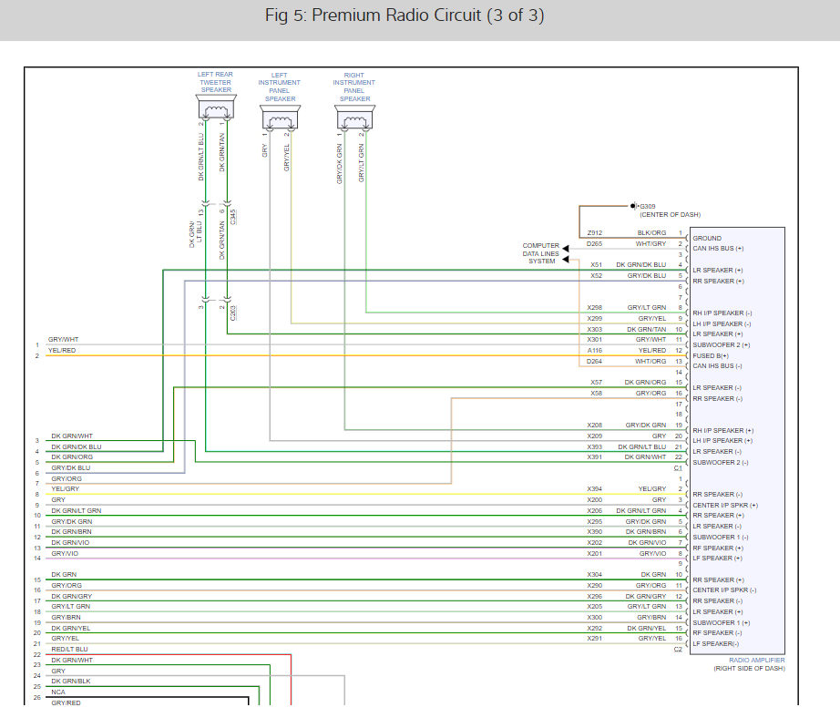

Here is a factory radio wiring diagram I hope this helps. This guide can help test the connections
Check out the diagrams (Below). Please let us know what you find. We are interested to see what it is.

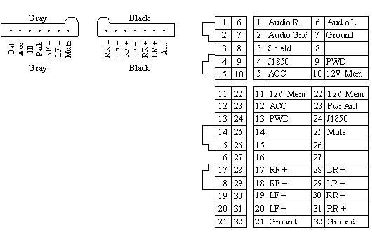

I have the gray and black plugs I am trying to find the left and right audio on it but don't know which one can't read the diagram that good if you can help me out
