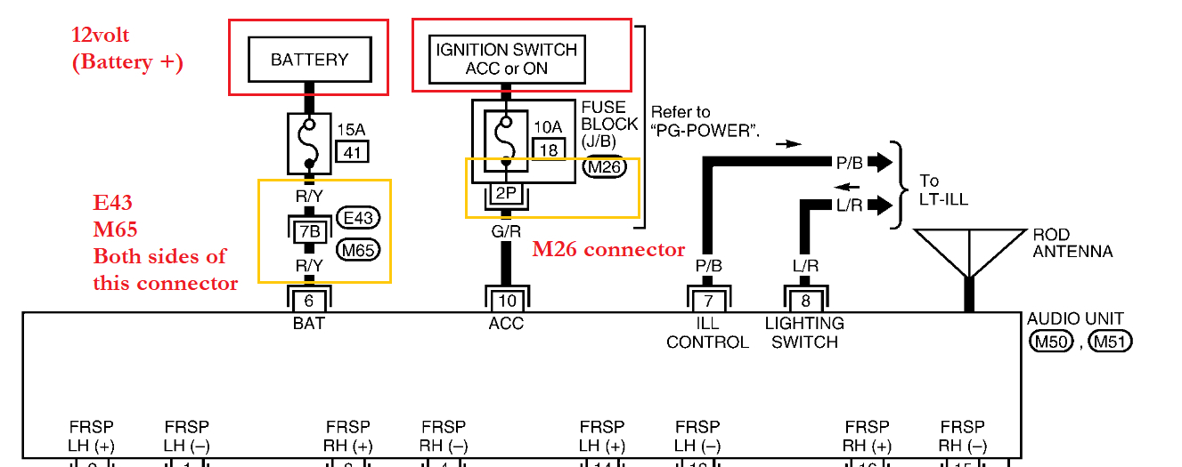

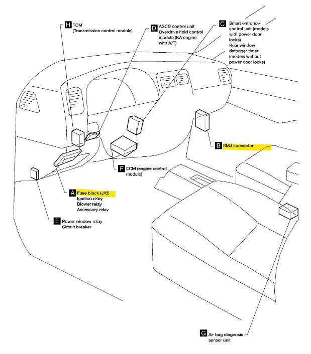

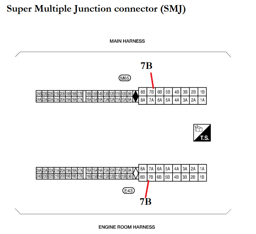

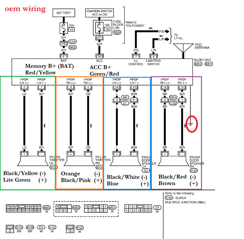

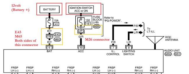

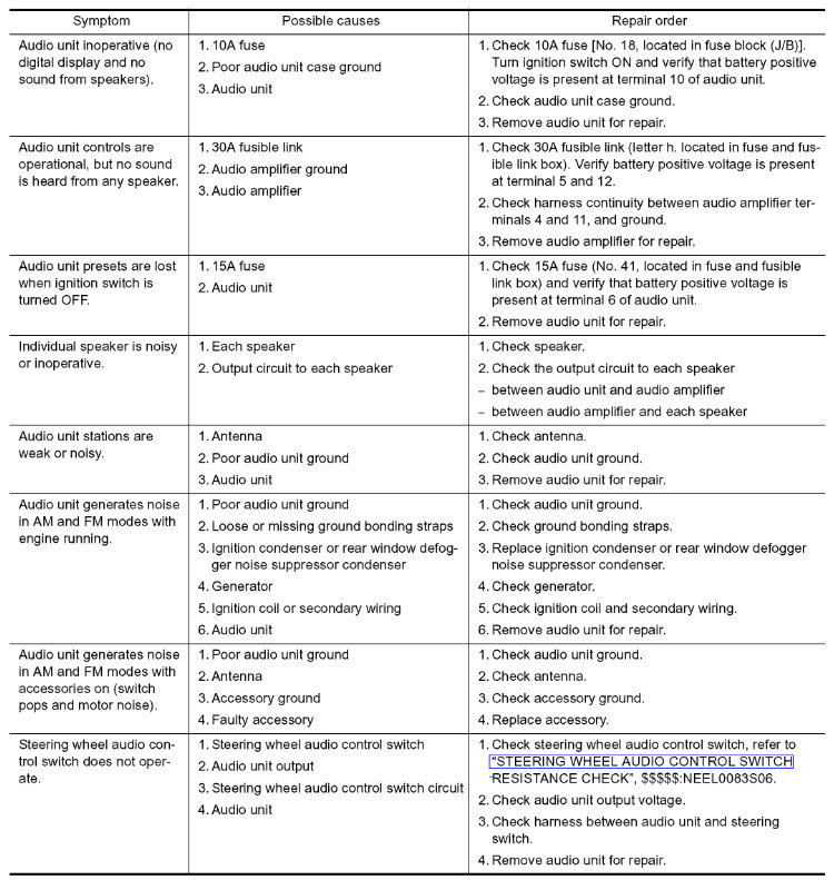

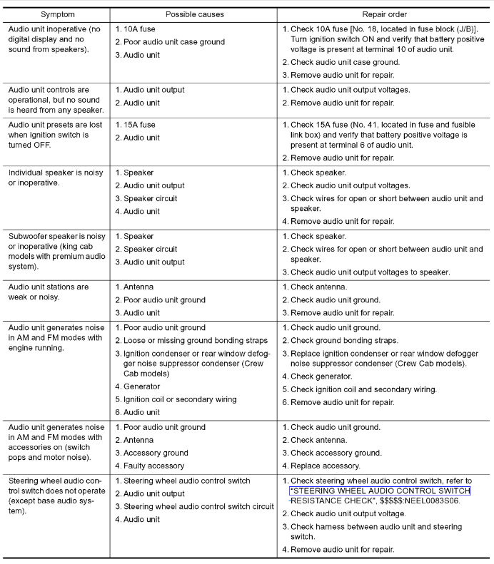

Here are the two Audio Flow Charts for diagnosing audio issues. Run through these are see if you're missing something.
Feb 8, 2024 at 5:18 AM
AL514
  • 5,663 POSTS
refresh this page. I just posted the trouble flow charts for audio issues.
