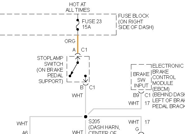

Greetings,
After turning blower resistor to highest setting (4), I lost power to several electrical circuits ie: radio/blower, brake lights, interior lights &more
99 chevy lumina 3.1 - All fuses in all 3 fuse blocks are confirmed good.
My symptoms: The following are non-functioning: brake lights are out, power side-mirrors, ALL interior lights, radio, blower fan, cigarette lighter, ashtray courtesy lamp, hazard flashers; and the audible 'dinger' indicator.
Also, the auto door locks don't work (has been occurring since I bought it and according to the Haynes manual this could be a faulty relay or a broken wire in the wire harness sheath between the door and frame that is under constant moving when door is opened/closed), however after studying the wiring diagrams I realize that the auto-lock switch is also tied into many other circuits and I am starting to think that the myriad of circuits problems could be a single Ground connection loose.

Use a test lite, check for voltage at applicable fuse. Even if the fuse is good, if no voltage on the fuse circuit, the circuit is still dead.
With multiple issues, I pick one circuit and troubleshoot. Fixing that one circuit may or may not fix the others.

Did you check for voltage to and from the brake switch? Use a test lite. The orange wire is hot all the time, fuse protected. The white wire goes hot when brake switch is activated.
