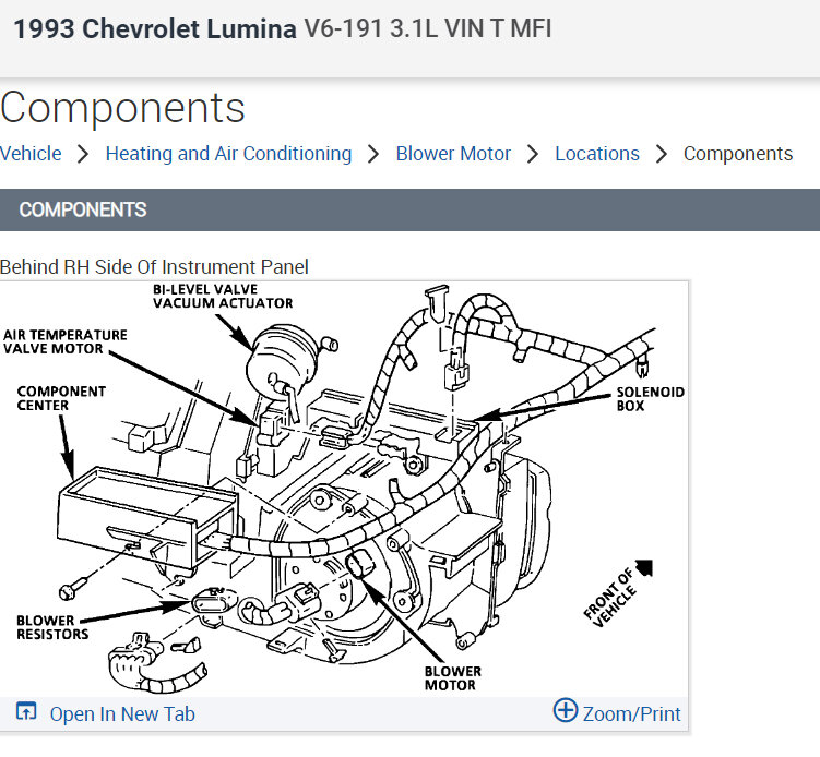

can anyone tell me where the blower motor is located?
1993 CHEVROLET LUMINA
95,000 MILES • 6 CYL • 2WD • AUTOMATIC
HIMO1123
can anyone tell me where the blower motor is located on this vehicle? thanks in advance for your help.
Dec 14, 2007 at 5:26 AM
  • 75,992 POSTS
Its on the right side of the dash
Dec 14, 2007 at 6:46 AM
  • 55,224 POSTS
I agree with RASMATAZ, the blower motor is on the right side of the dash under the glove box, here is a diagram showing you the exact location. Check out the images (below). Let us know if you need anything else.
