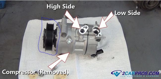

Absolutely, the compressor pulley shouldn't be wobbly. Do me a favor, it could be the pulley is loose or the bearing in the compressor is bad. If that's the case, it will need replaced and the freon that was put in it has likely leaked.
If possible, make a video of the pulley when you see this happening. Then, turn the engine off and see if you can wiggle it with your hands.
I attached a pic below showing the pulley and clutch. If there is movement in the pulley, pay attention to the center of the pulley area. That is where the clutch is located. Does it move as well as the pulley?

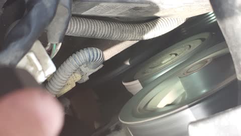

Also here is said wiggle, it cannot be wiggled by hand but the compressor is working good.
Jul 21, 2021 at 8:34 PM
  • 110,248 POSTS

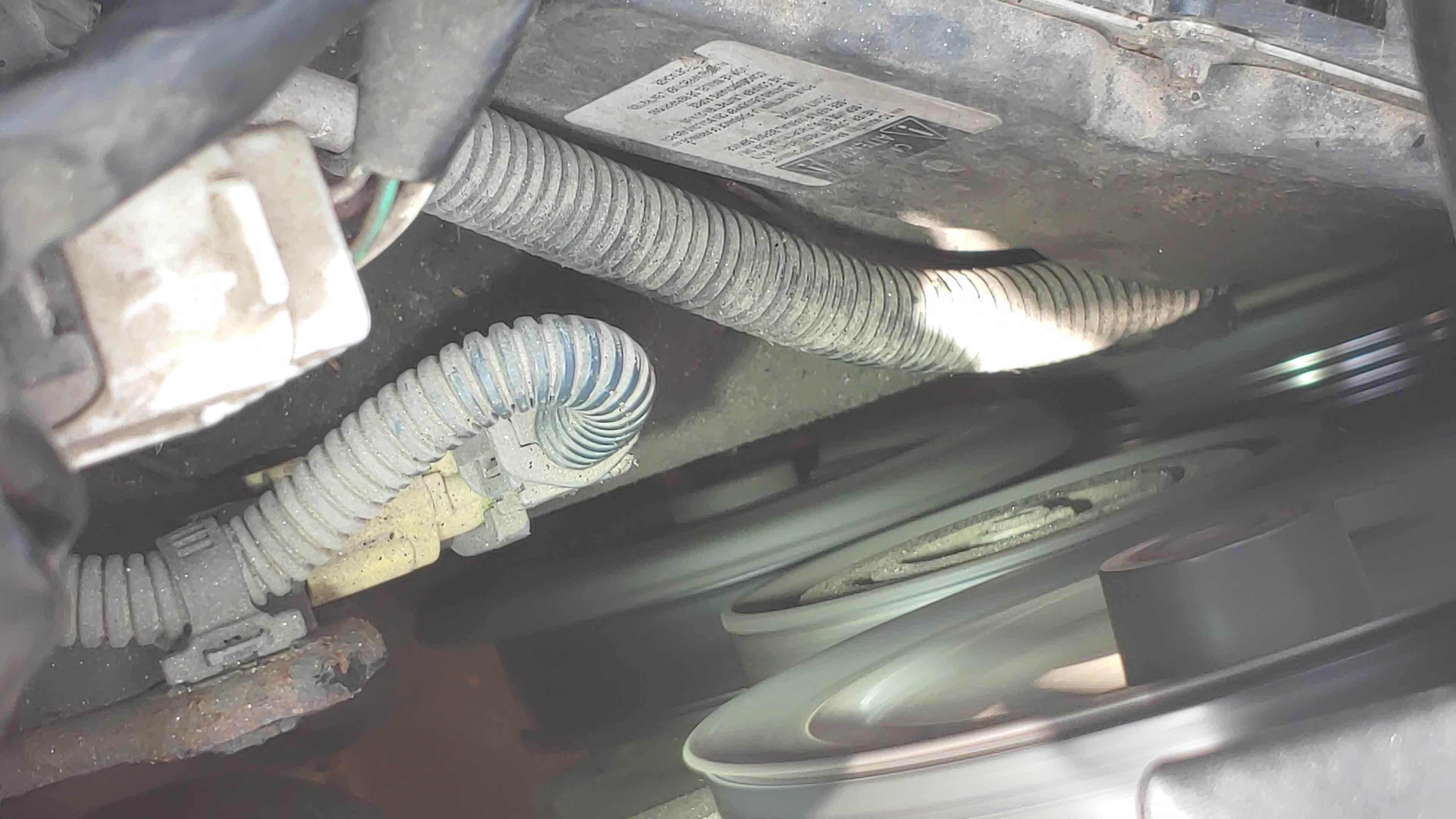

I'm glad to hear you got it fixed. Also, I did watch the video. It looks like the pulley is out of alignment and causing the belt to jump around on the A/C pulley. Do me a favor. With the engine off, take a pic of the A/C pulley so I can see the belt on it. Also, make sure the pulley is aligned with all the other pulleys.
