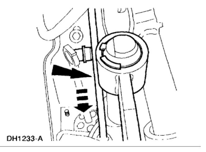

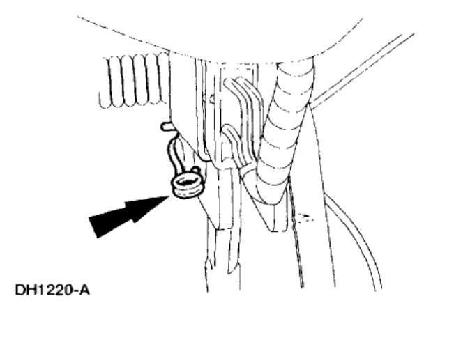

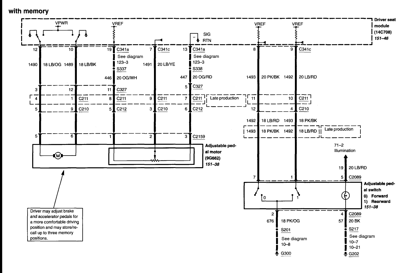

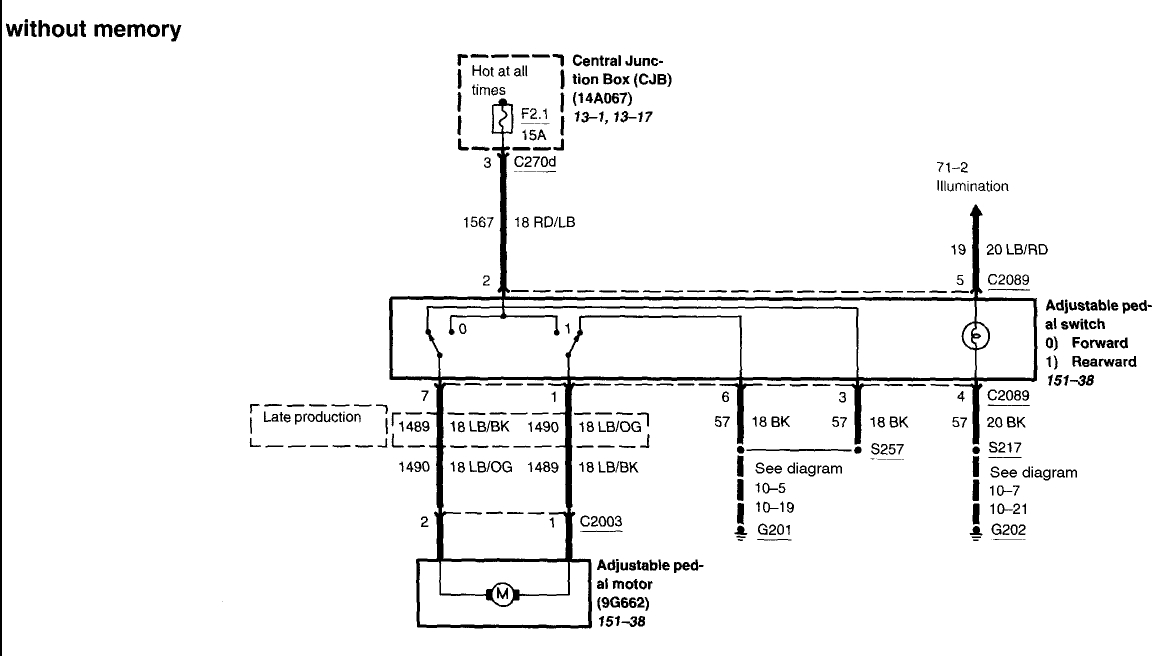

where can I find a power adjustable brake pedal? truck listed above is a diesel, Lariat model
Oct 25, 2017 at 8:21 AM
STEVE W.
  • 15,351 POSTS

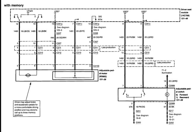

Ford might have them but they are expensive. Better option would be a salvage yard. There are different ones based on if the vehicle has the memory option or not. I take it the ones you have will not adjust?
Oct 25, 2017 at 9:49 PM
AK2STEPIN
That is correct. There are new ones available for the accelerator.
The dealer hear in Soldotna AK. said they do not make them any more.
I would take a chance on a junk yard/used but at $400.00 for a thirty day
guarantee, seems like a suckers bet. Plus, I can only find them in a set
with the accelerator pedal. I do not recall anything about memory.

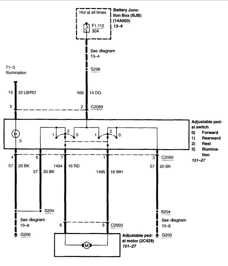

Are you familiar with what years are compatible? I sure appreciate the
schematic.
ak2stepin.
Oct 26, 2017 at 4:35 AM
  • 55,433 POSTS

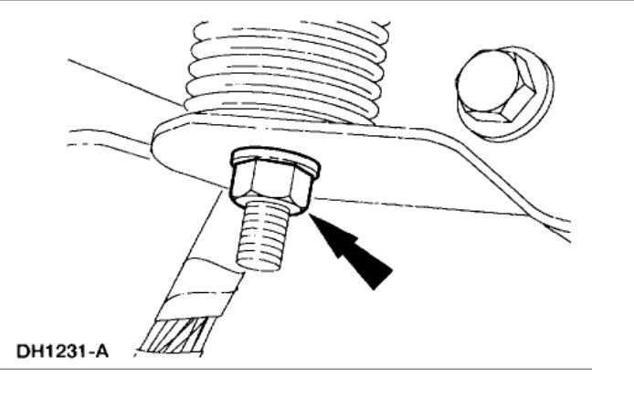

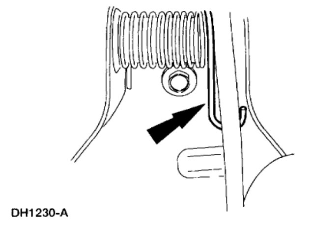

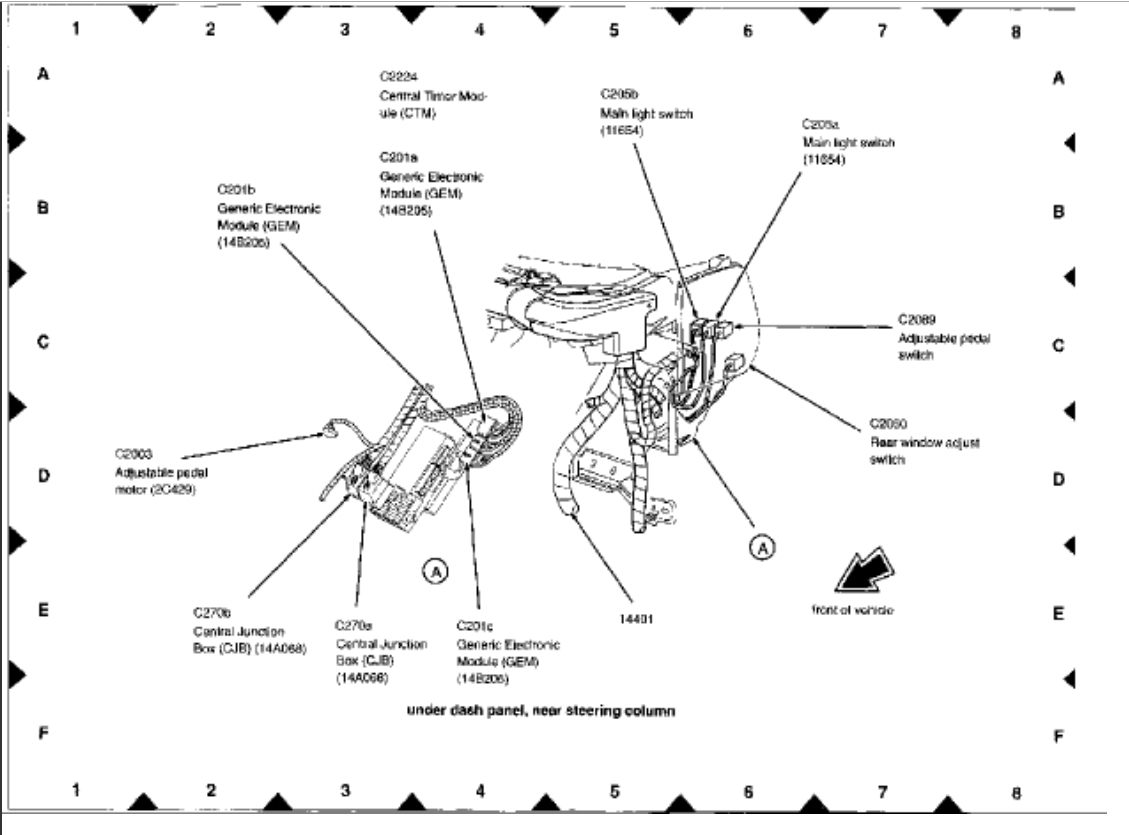

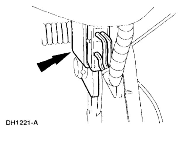

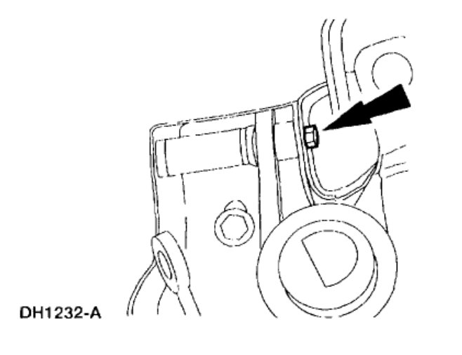

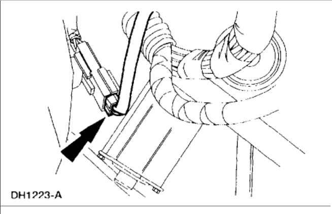

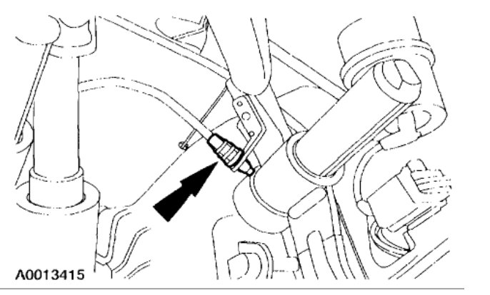

I have found some diagrams to help you see whats going on and hopefully replace the unit. (below)
