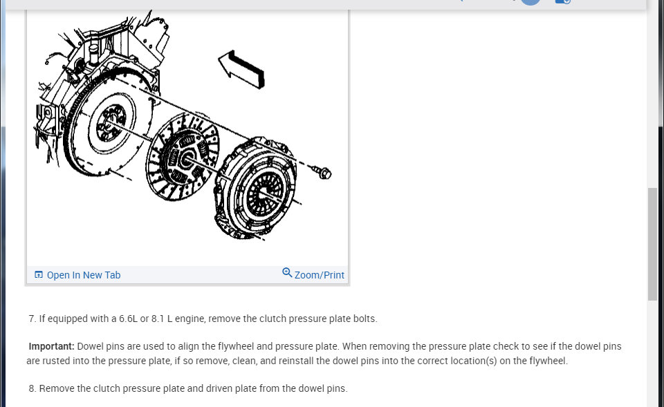

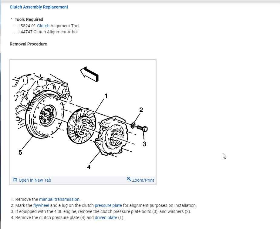

The clutch on this vehicle isn't adjustable. It has a hydraulic release system. If it is slipping, the clutch needs replaced. You didn't indicate the engine size above, so I went with a 5.3L V8 which is most common. If that is wrong, let me know.
Here are the directions for replacing the clutch on the truck. The attached pictures correlate with the directions.

^ Tools Required
- J 5824-01 Clutch Alignment Tool
- J 44747 Clutch Alignment Arbor

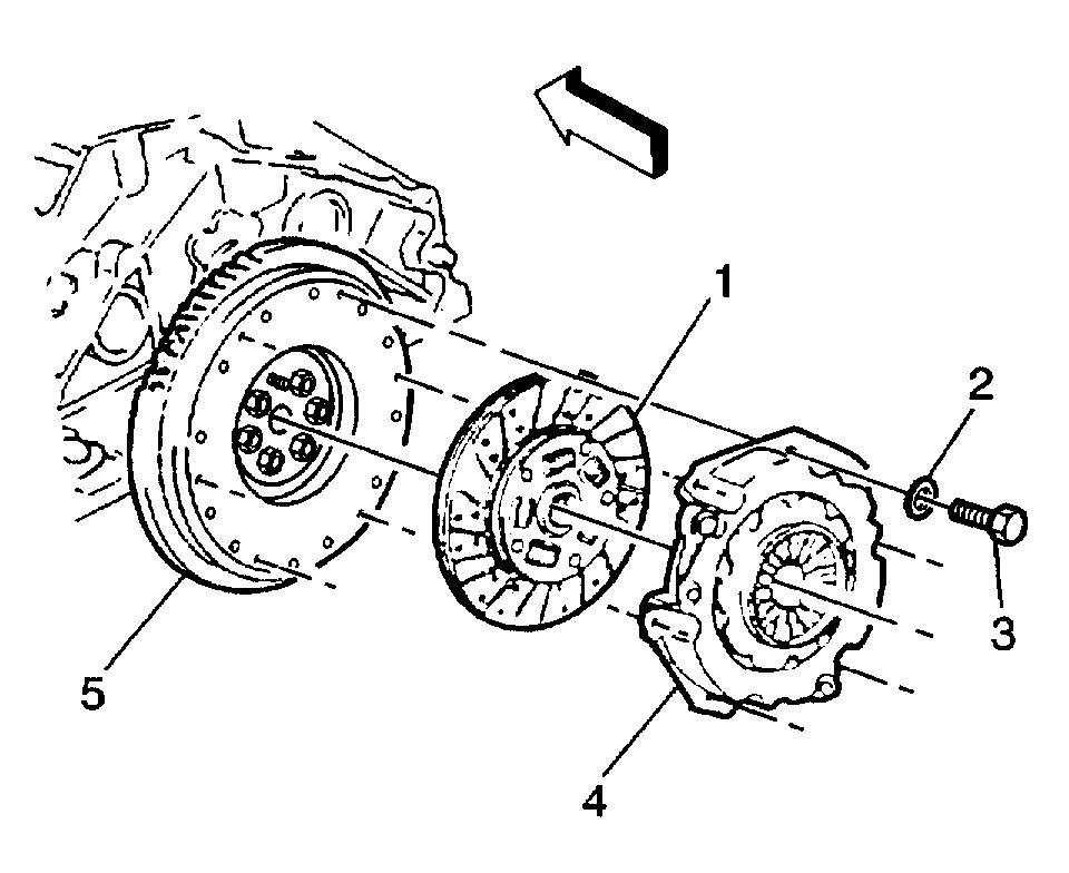

Removal Procedure
pic 1
1. Remove the manual transmission.
2. Mark the flywheel and a lug on the clutch pressure plate for alignment purposes on installation.
3. If equipped with the 4.3L engine, remove the clutch pressure plate bolts (3), and washers (2).
4. Remove the clutch pressure plate (4) and driven plate (1).

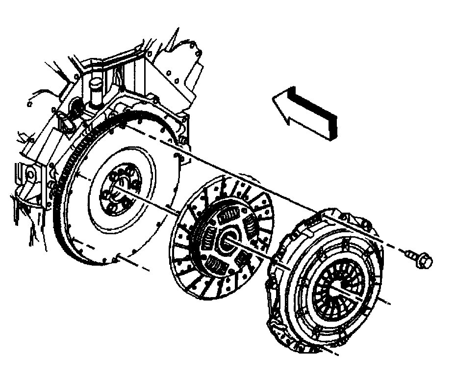

pic 2

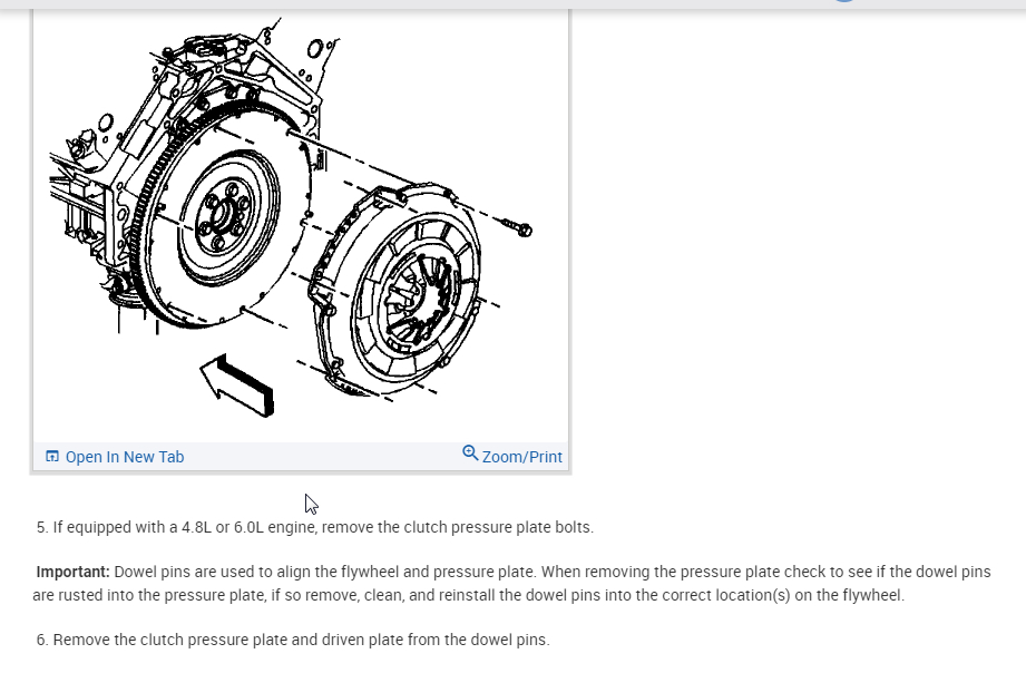

5. If equipped with a 4.8L or 6.0L engine, remove the clutch pressure plate bolts.
Important: Dowel pins are used to align the flywheel and pressure plate. When removing the pressure plate check to see if the dowel pins are rusted into the pressure plate, if so remove, clean, and reinstall the dowel pins into the correct location(s) on the flywheel.
6. Remove the clutch pressure plate and driven plate from the dowel pins.

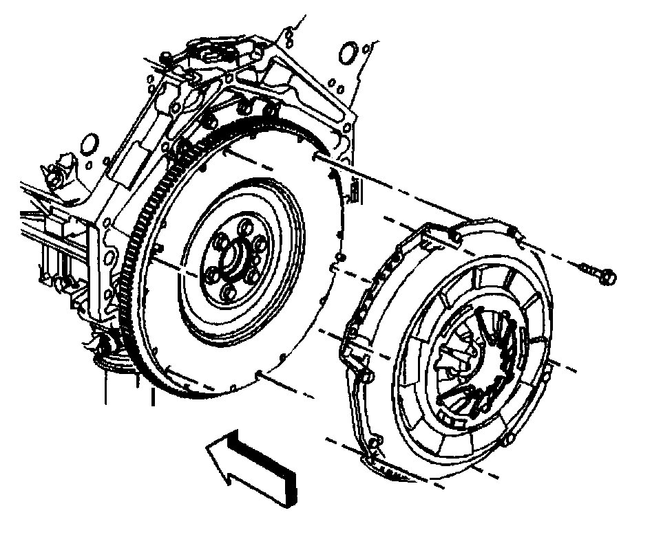

pic 3

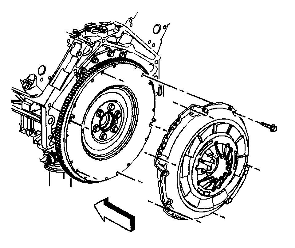

7. If equipped with a 6.6L or 8.1 L engine, remove the clutch pressure plate bolts.
8. Remove the clutch pressure plate and driven plate from the dowel pins.

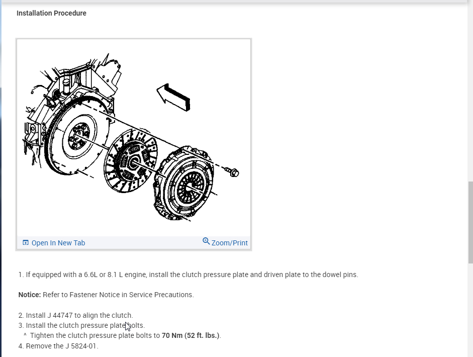

Installation Procedure
pic 4
1. If equipped with a 6.6L or 8.1 L engine, install the clutch pressure plate and driven plate to the dowel pins.
Notice: Refer to Fastener Notice in Service Precautions.
2. Install J 44747 to align the clutch.
3. Install the clutch pressure plate bolts.
^ Tighten the clutch pressure plate bolts to 70 Nm (52 ft. lbs.).
4. Remove the J 5824-01.

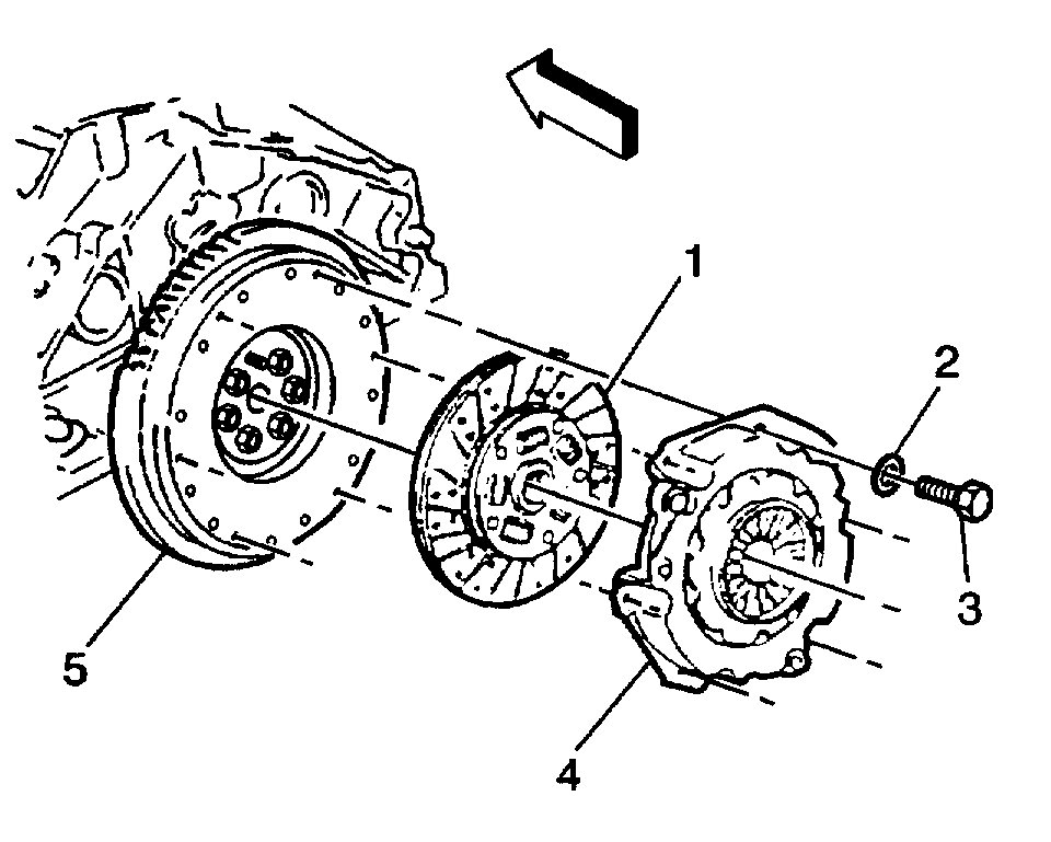

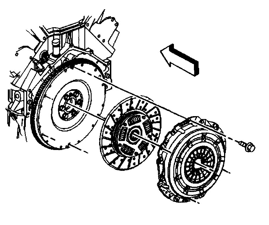

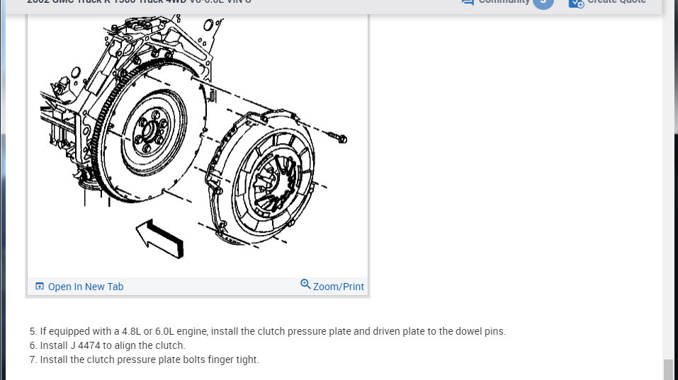

pic 5
5. If equipped with a 4.8L or 6.0L engine, install the clutch pressure plate and driven plate to the dowel pins.
6. Install J 4474 to align the clutch.
7. Install the clutch pressure plate bolts finger tight.

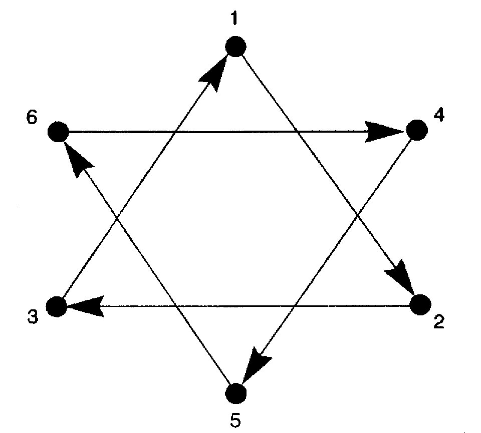

pic 6

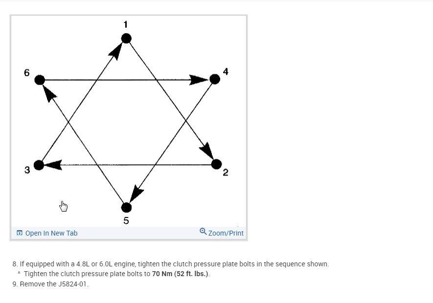

8. If equipped with a 4.8L or 6.0L engine, tighten the clutch pressure plate bolts in the sequence shown.
9. Remove the J5824-01.

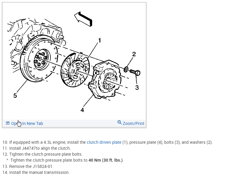

10. If equipped with a 4.3L engine, install the clutch driven plate (1), pressure plate (4), bolts (3), and washers (2).
11. Install J44747to align the clutch.
12. Tighten the clutch pressure plate bolts.
^ Tighten the clutch pressure plate bolts to 40 Nm (30 ft. lbs.).
13. Remove the J15824-01.
14. Install the manual transmission.

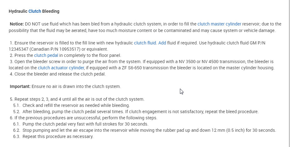

The only option to "adjust" this clutch is to bleed the system because it is not a mechanical clutch. However, if you are not getting complete clutch operation more than likely you have a leak in the system somewhere. If that is the case, then you will need to disassemble and replace the part and then bleed the system again.
If you are going to do this, I would just replace everything in there so you don't have to go back in to replace something else in the near future.
I attached the process for a 6.0L which is what I assume you were going for in the header. However, I think most of the configurations are the same or close enough but let me know if yo uhave questions. Thanks
