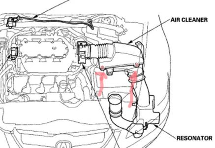

How do I replace my engine air filter?
Friday, October 29th, 2010 AT 9:11 PM
8 Replies
SERVICE WRITER
  • 9,123 POSTS
Buy the filter.
Remove the screw highlighted in the front and find the back ones. Lift off cover and remove the old filter, reverse procedure to install.

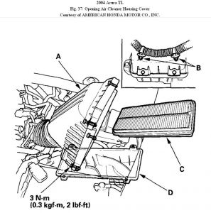

KHLOW2008
  • 41,814 POSTS
Hi btulshi,
Here are the procedures.
AIR CLEANER REMOVAL/INSTALLATION
1.Remove the bolts (A) and clamps (B).
https://www.2carpros.com/forum/automotive_pictures/192750_AirCleaner04TLFig37_1.jpg
2.Remove the air cleaner (C).
3.Install the parts in the reverse order of removal.

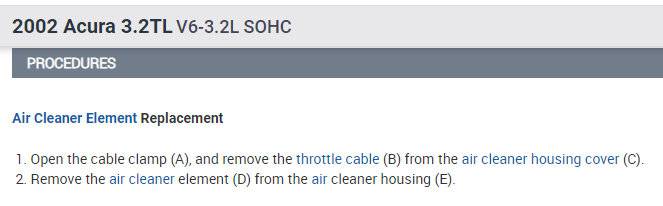

DANNY L
  • 5,648 POSTS
Hello, I'm Danny
No, The TL base model and the Type S air filters are different. I've attached the pictures below with the part numbers from AutoZone parts stores. The Fram CA8475 is for a TL base model and Fram CA9502 is for a Type S. Hope this helps and thanks for using 2CarPros.
Wednesday, January 27th, 2021 AT 2:10 PM (Merged)

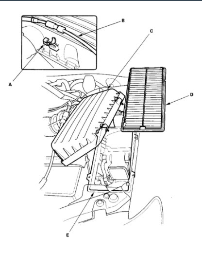

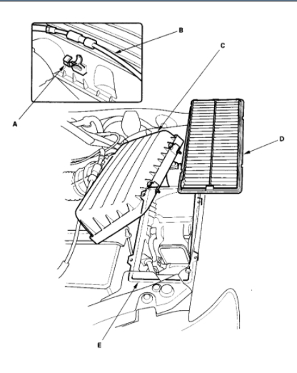

DANNY L
  • 5,648 POSTS
Hello again.
Here is a tutorial showing how to replace an air filter.
https://www.2carpros.com/articles/how-to-replace-a-car-air-filter
I've attached a few picture steps below showing how to replace the air filter on your Acura. Hope this helps and thanks again for using 2Carpros.
