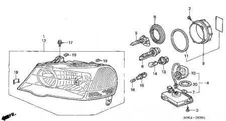

Thanks for the information. I will do the tests first, however, if it is the ignitor or ballast, are they located inside the cover that I would remove to replace the bulb?? Is there any similar instruction sheets for the ignitor or ballast replacement??
Thanks again for your help!!
Jim
Aug 1, 2010 at 7:17 AM
KHLOW2008
  • 41,814 POSTS
There are no instructions and information on the inverter and ignitor locations and replacement procedures in our database. I managed to get the diagram from another site but do not know if it is the correct one as it is not labelled. Item # 7.
https://images.2carpros.com/forum/automotive_pictures/192750_HIDComp03TL_2.jpg

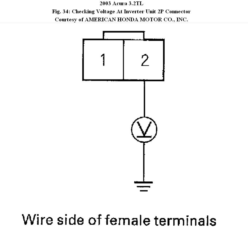

3. Disconnect the 2P connector from the inverter unit.
4. Turn the combination light switch ON.
5. Measure voltage between the No. 2 terminal of the inverter unit 2P connector and body ground.
Fig. 34: Checking Voltage At Inverter Unit 2P Connector
Is there battery voltage?
YES -Go to step 6.
NO -Repair open in the wire between the under-hood fuse/relay box and the inverter unit.

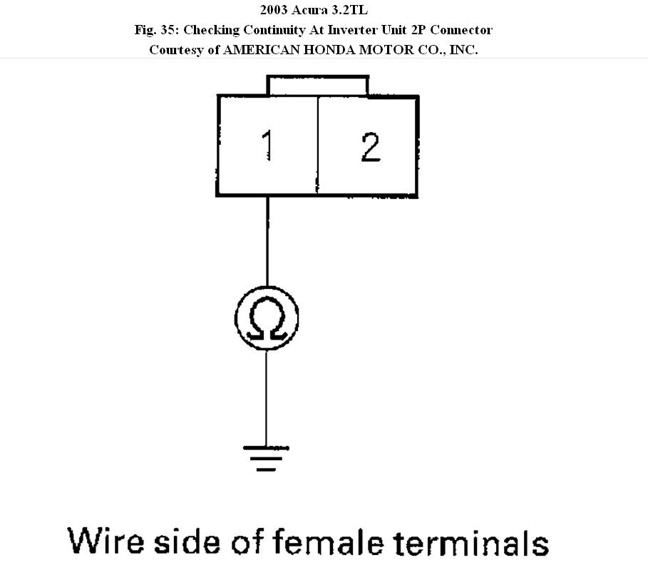

6. Turn the combination light switch OFF.
7. Check for continuity between the No. 1 terminal of the inverter unit 2P connector and body ground.
Fig. 35: Checking Continuity At Inverter Unit 2P Connector
Is there continuity?
YES -Go to step 8.
NO -Repair open in the wire between the inverter unit and body ground. If the wire is OK, check for poor ground at G201 or G301.

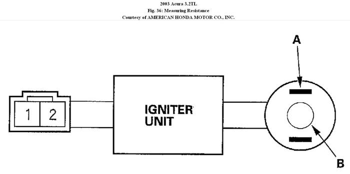

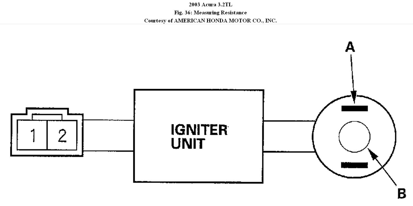

8. Measure resistance between the No. 1 and B terminals and the No. 2 and A terminal of the igniter unit.
Fig. 36: Measuring Resistance
Is there about 1-2 ohm ?
YES -Substitute a known-good inverter, and recheck. If the symptom goes away, replace the original inverter unit.
NO -Replace the igniter unit.
