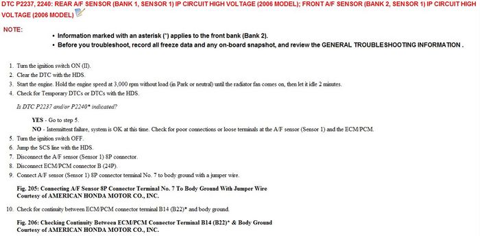

TOM V1956

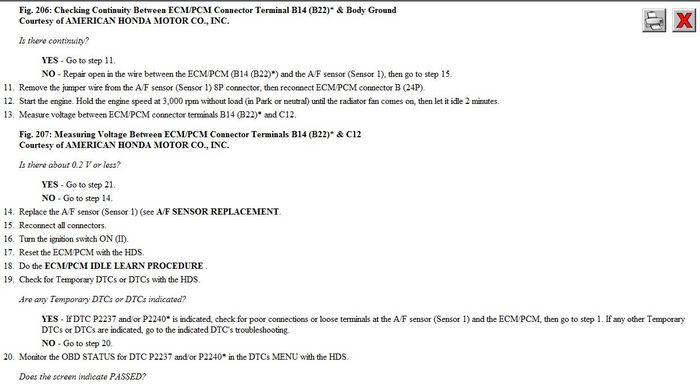

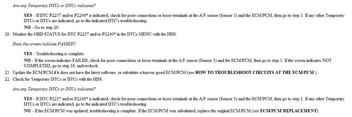

BMRFIXIT
  • 19,053 POSTS
DTC P2237, 2240: Rear A/F Sensor (Bank 1, Sensor 1) IP Circuit High Voltage (2006 Model); Front A/F Sensor (Bank 2, Sensor 1) IP Circuit High Voltage (2006 Model)

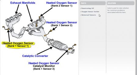

NEDU
  • 7 POSTS
TL P1172 Bank 1 sensor 1 is out of range. I bought the sensor online. I need to know exact location of this sensor on the car. How do I get to it? Is it under the hood or under the car? Are there any instructions available online? Are there any photos available? I would really appreciate any help.

TOM V1956
got it fixed, did the wrong one first. look at exhaust diagram on here posted march 30,2010 and it shows bank one at front of car and it is not bank one is at the firewall where cyl 1 is. so replaced the o2 sensor at front and is bank 2 sensor one upon buying a manual.tell legitmate007 that diagram is wrong for a Acura TL 3.2 Thanks for the help!

LEGITIMATE007
  • 5,121 POSTS
Here you go, it should be fairly easy to do because it is right in the front of the engine.
Mar 13, 2019 at 11:01 AM (Merged)
LEGITIMATE007
  • 5,121 POSTS
https://images.2carpros.com/forum/automotive_pictures/88091_bank_1_sensor1_1.jpg
