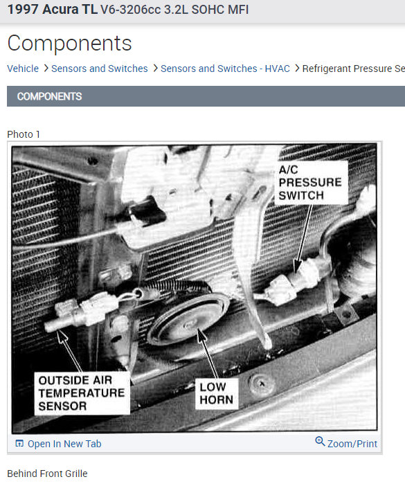

I replaced my tension pulley and belt for my A/C and it works sometimes. I just did the 3 days ago the bearings where gone in the pulley. When the A/C does come on it freezes you out so I know it does not need Freon.
Jun 20, 2009 at 5:31 PM
SQM
  • 6,383 POSTS

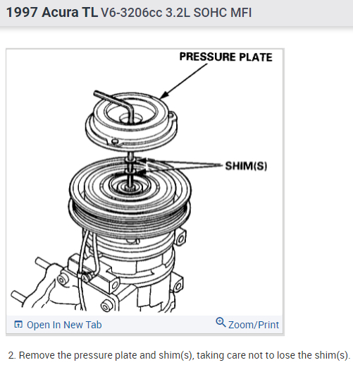

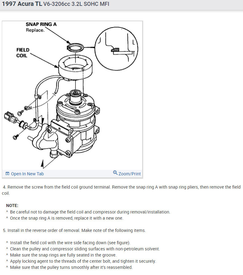

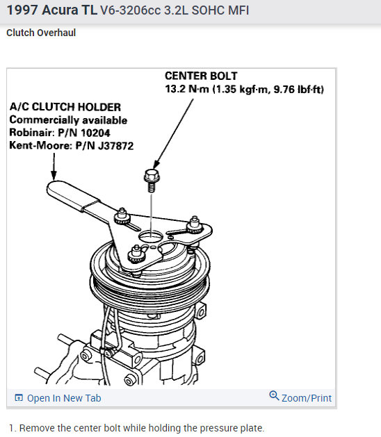

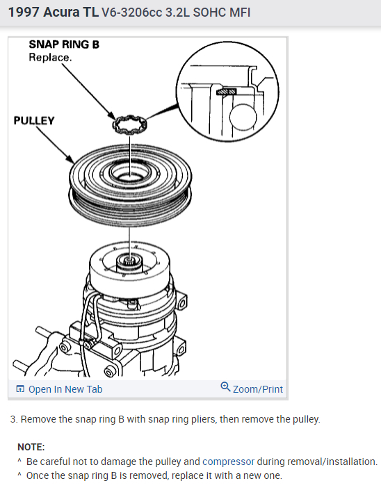

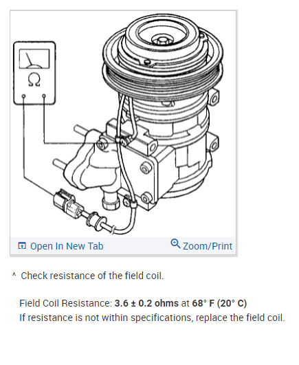

It sounds like you could have a faulty clutch for the A/C compressor. It can also be the pressure switch for the A/C system.
If you have a faulty switch it can provide incorrect data and the compressor will not engage. The switch is located right behind the front grille.
https://www.2carpros.com/articles/how-a-car-air-conditioner-works

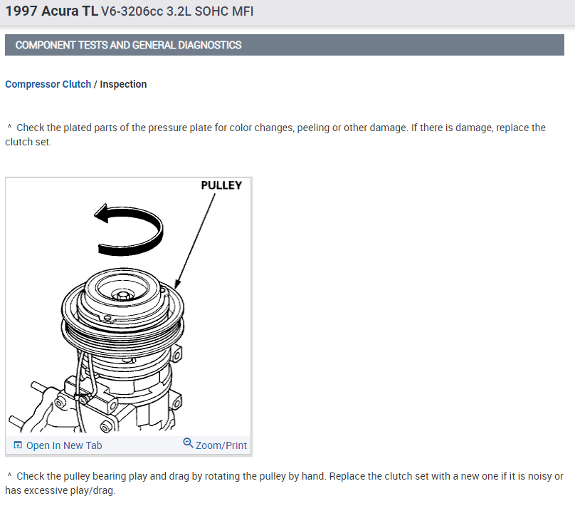

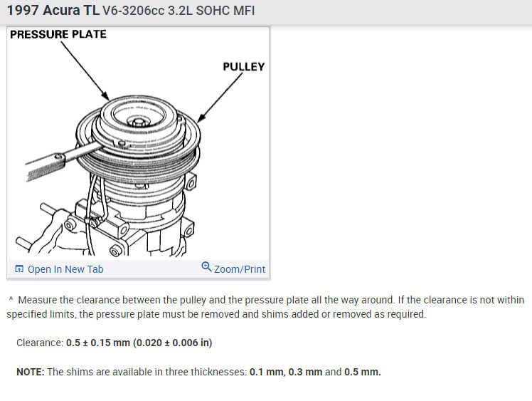

If the compressor clutch does not engage the air will not be cold. A clutch can go bad due to internal failure.
You can do visual inspection of the clutch, check the plated parts of the pressure plate for color changes, peeling or other damage. If there is damage, replace the clutch set.
