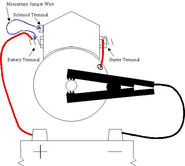

OK, let's go back to the basics. There are two wires on the starter. The biggest one goes straight back to the battery's positive post. Use a test light with the clip lead on a clean, paint-free surface on the engine, then put the probe on the large starter terminal. The test light should light up all the time.
Use a screwdriver blade, the test light probe, or a piece of wire to temporarily connect the smaller wire on the starter to the big cable. Be sure the transmission is in park because that jumper should make the starter work. If it cranks, we will know the high-current circuit is working. That includes the battery cables

There isnt electricity thats flowing through my starter. Battery n everythings good I dont know about the wire harness though. On the battery I connect the positive to the starter and grounded the starter striaght to the negative, and connected the wire that is suppose to be connected to the s terminal to it, and still doesnt start. I have a 1996 acura tl 2.5, swap a new engine and doesnt crank after that.

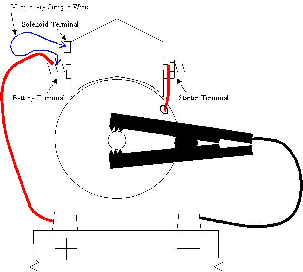

Let's be sure you're jumping the starter correctly. Here's a diagram I drew for this purpose. If you're doing this with the starter still bolted to the engine, all you need is the blue jumper wire. If the starter is on the workbench, connect the negative jumper cable between the starter case and the negative post of the battery, and the red jumper cable between the battery positive post and the battery terminal on the starter. (The battery terminal is next to the small solenoid terminal. Do not use the terminal that has the fat, usually braided cable going into the motor housing).
Connect a clip lead or other jumper wire to the solenoid terminal. Hold onto the starter if it is off the engine, then touch the jumper wire to the battery terminal. If the starter spins, it is working properly. If the drive gear pops out but the motor doesn't spin, the solenoid contacts are worn and must be replaced. If nothing happens but there is a small spark when you touch the jumper wire, one of the two solenoid coils is defective or the drive gear's shaft is rusted and the gear is sticking. If there is no spark, the solenoid coil is defective.
