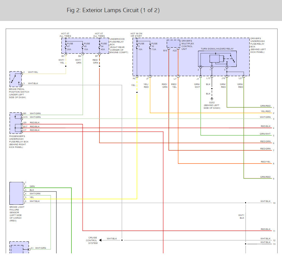

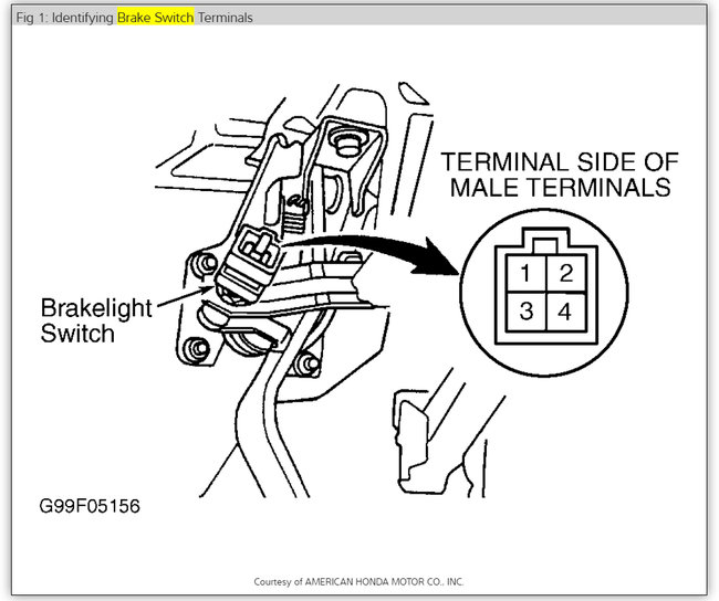

My 2001 acura mdx gear shift wont get out of park. It's just stuck. I also think i have a faulty brake light switch, as my brake lights do not work. Will fixing my brake light switch allow me to move the gear shift out of park? Or is it something else? Is the brake light switch expensive? Where in my car is the brake light switch located? Please Help. Thank u.
Mar 1, 2009 at 1:43 PM
  • 55,224 POSTS
Yes a bad brake light switch will stop the car from coming out of gear due to the shift interlock solenoid will not working.

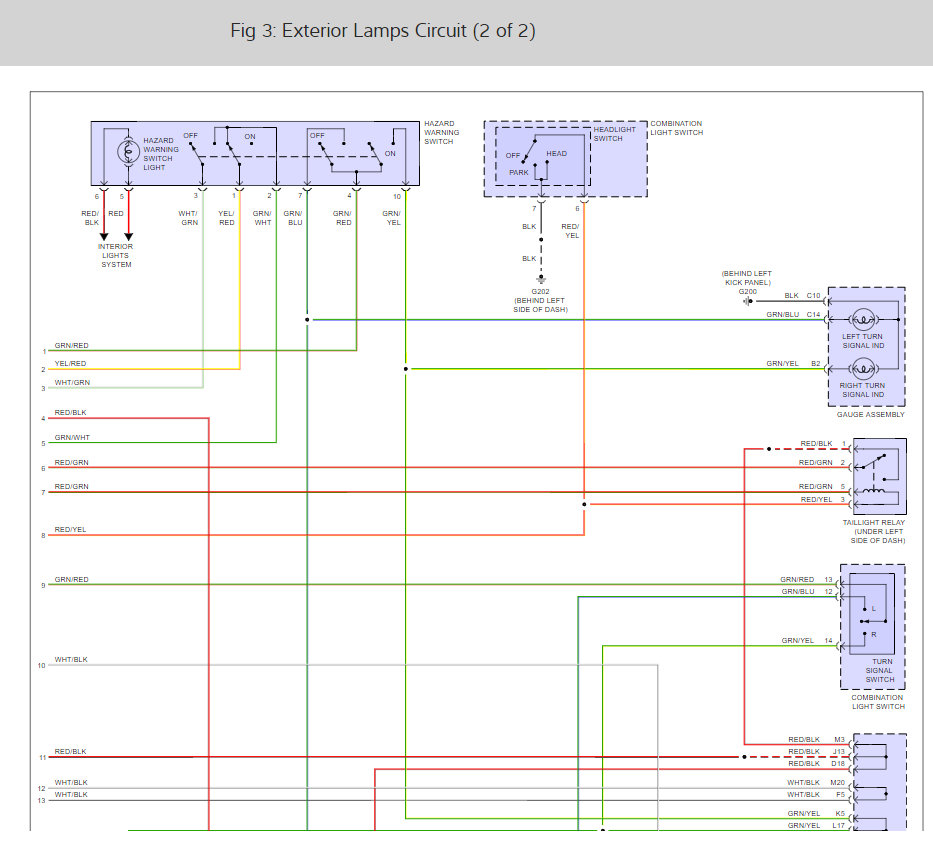

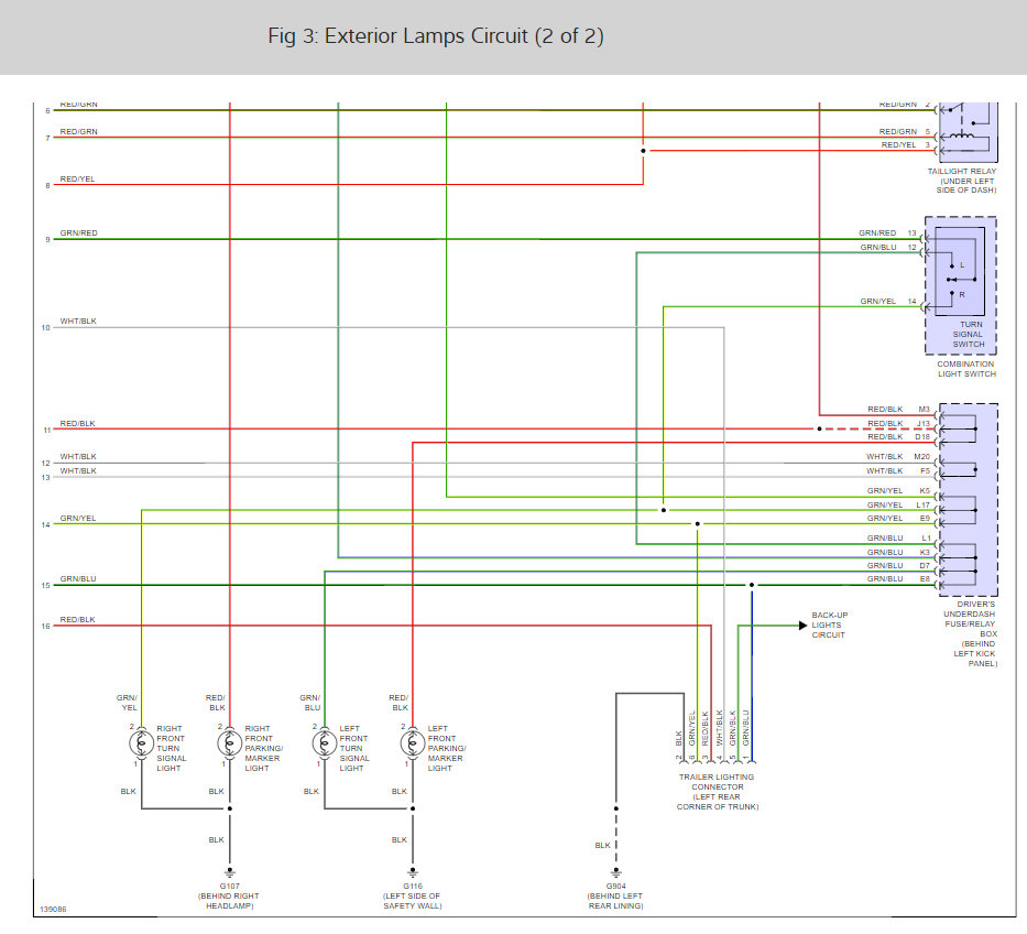

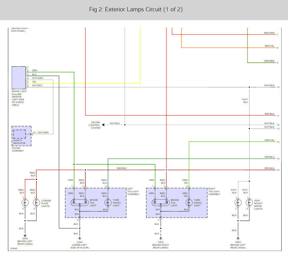

Here are some diagrams that will help you get the job done (below). The switch is located at the top of the brake pedal arm under the dash on the drivers side.
Here is a guide that will yep you test it and the brake light wiring diagrams (below)
