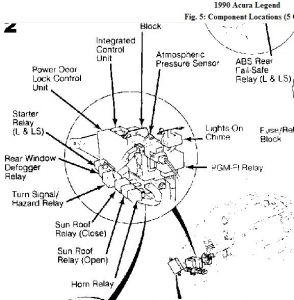

When I start my car have to turn ke half way wait for engine light to go off the start or it wont start what gives
Wednesday, July 15th, 2009 AT 9:47 PM
KHLOW2008
MECHANIC
41,814 POSTS
Hi weezy08,
The symptoms indicates a possible PGM-FI main relay or ECU problem.
Check the PGM-FI main relay first.
