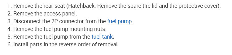

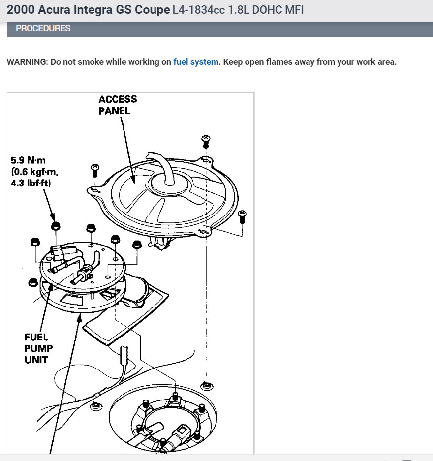

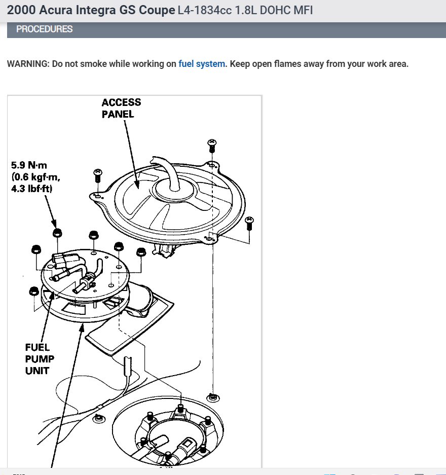

I was driving down the freeway when suddenly my car started to shake and lost almost all power. After a couple of minutes, it ran ok again
Wednesday, January 28th, 2009 AT 6:21 PM
KEN L
  • MASTER CERTIFIED MECHANIC
  • 48,363 POSTS
This happens when the fuel pump is starting to go out but to be sure we can do fuel pressure test and if it fails I have instructions in the diagrams below to show you how to change the pump out.
