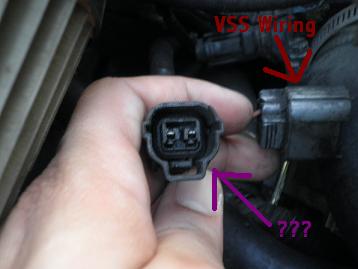

3. Speedometer does not work. At first it would jump up and down about 10 percent of the time while driving but now it doesnt move at all. My car is obd1 so my check engine light displayed a code saying my wheel speed sensor isnt working. I took a look at it and there was a little metal piece to fit inside missing. I went to the junkyard and grabbed one from the same engine. After doing that the speedometer shows too high (I will be cruising at 40 and it would show about 60-70) I could actually see my rpm (in third gear) and my speedometer move at the same rate and at the same position. So I just went to buy a rebuilt wheel speed sensor and put that in. Same thing, it shows too high. The same as with the old sensor.

3. Vehicle speed sensor is attached to the transaxle and not known as wheel speed sensor. Hope you got the correct item. If the speedometer is not in sync with the road speed, either the speedometer is inaccurate, transmission has been replaced with one of different gear ratios or the road wheels are not of the correct specs.

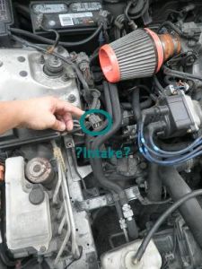

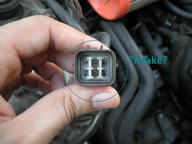

4. Which Honda guy told you all Honda uses MAF? Except the latest models, no Honda uses MAF. What they have is MAP which is located on top of the intake manifold for your model.
The air cleaner does not have any electrical components except for late 90's or 2000 and later year models where an Intake Air Temperature sensor is used. If anything is missing, the ECU would record the fault and trouble codes can be retrieved.
Quite often there are excess wire connectors for transmission controls, accessories and are not used for some models. Unless the ECU ias telling you some thing is malfunctioning, there should be nothing to worry about.

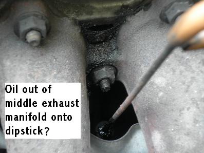

1. Actually I have replaced the distributor and haven't checked the timing after that. This was a little over a year ago. The engine wasn't as bad before as it is now.
2. Yes, another person has told me the same thing about a possibly slipping clutch. I will look into replacing that.
3. I do have aftermarket rims, however the tire size is close to original spec so displaying 70 when going 40 couldn't be that since its such a big difference in speed. The transmission is original also so I would probably put my money on the inaccurate speedometer. That would require me to replace the instrument cluster?

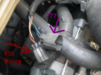

I also have pictures of wires next to the vehicle speed sensor (I guess wheel speed and vehicle speed get crossed when talking to people).
4. My mistake I meant to put does NOT use MAF, thus the confusion of the open wires (see attached pictures).
My car is OBD1 so I had brought it to a place to check which wires to bridge. He had told me the speedometer fault was the only problem showing up. However I don't really trust some mechanics at mom and pop shops so I will check codes myself. I just need to find out which wires I must bridge on the B18 ECU
https://www.2carpros.com/forum/automotive_pictures/442448_Camera_017mod_1.jpg
Very low Idle RPM, sometimes it will move up and down and get close to stalling but never does.
https://www.2carpros.com/forum/automotive_pictures/442448_Camera_012mod_1.jpg
https://www.2carpros.com/forum/automotive_pictures/442448_Camera_013mod_1.jpg
https://www.2carpros.com/forum/automotive_pictures/442448_Camera_005mod_1.jpg
https://www.2carpros.com/forum/automotive_pictures/442448_Camera_007mod_1.jpg

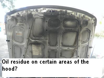

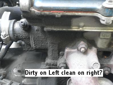

Other Defects found:
https://www.2carpros.com/forum/automotive_pictures/442448_Camera_008mod_1.jpg
https://www.2carpros.com/forum/automotive_pictures/442448_Camera_009mod_1.jpg
https://www.2carpros.com/forum/automotive_pictures/442448_Camera_010mod_1.jpg

I am a little under the weather at the moment so will try to answer as best as I could and if I miss out anything, please remind me.
The speedometer comes as a complete cluster assy.
Let me know all the additional wire color codes. Seems the wireharness is for an automatic and those wires are likely to be for the transmission sensors.

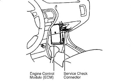

https://www.2carpros.com/forum/automotive_pictures/192750_SCS95Integra_3.jpg

I have bridged the service check connector and turned the ignition to on but not start. The CEL pattern was:
pause, quick blink 7 times, pause, quick blink 7 times, pause, long blink, pause.(Repeat)
Would this be 7 and 17?
This wouldn't give such a low idle would it?

7 quick blinks should be Code 7. A fault with the Throttle Position Sensor. This would cause the lack of power and erratic idling.
A long Blink followed by 7 short flash = 17. A fault with the VSS.

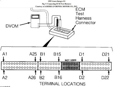

Here are the procedures for testing the TPS.
CODE 7 - THROTTLE POSITION (TP) SENSOR
1 . Turn ignition off. Remove BACK-UP fuse (7.5-amp) from underhood fuse/relay box for 10 seconds to reset ECM. Retrieve codes. If Code 7 does not appear, problem is intermittent. Inspect for poor or loose connections at throttle position sensor, left and right shock towers, and ECM connectors. Test-drive vehicle and retest.
2 . If MIL is on and indicates Code 7, turn ignition off. Unplug 3-pin connector from throttle position sensor. Turn ignition on. Measure voltage between Yellow/Blue (+) and Green/Blue (-) wire terminals. If voltage is not about 5 volts, go to step 6). If voltage is about 5 volts, turn ignition off. Reconnect sensor wiring.
3 . Turn ignition on. Measure voltage between test terminals D11 (+) and D22 (-). Voltage should be about 0.5 volt at closed throttle, and about 4.5 volts at wide open throttle. Transition from 0.5 to 4.5 volts (as throttle is opened) should be smooth. If voltage and operation is correct, temporarily substitute known good ECM, then retest system.
4 . If sensor voltages are not correct on M/T models, go to next step. If sensor voltages are not correct on A/T models, unplug 22-pin connector from Transmission Control Module (TCM). Again measure voltages. If voltages and operation are not correct, go to next step. If voltages and operation are correct, temporarily substitute known good TCM, then retest system.
5 . On all models, replace throttle position sensor or repair Red/Blue wire between ECM terminal D11, TCM (if equipped), and throttle position sensor.
6 . If voltage between Yellow/Blue (+) and Green/Blue (-) wire terminals in step 2) was not about 5 volts, measure voltage between Yellow/Blue wire terminal (+) and body ground. If voltage is about 5 volts, repair open in Green/Blue wire between ECM terminal D22 and throttle position sensor.
7 . If voltage is not about 5 volts, measure voltage between test terminals D20 (+) and D22 (-). If voltage is about 5 volts, repair open in Yellow/White wire terminal between ECM connector terminal D20 and throttle position sensor. If voltage is not about 5 volts, inspect for short in Yellow/Blue wire. If wire is okay, temporarily substitute known good ECM, then retest system.

I followed the list starting at number 2 (I had previously reset the ECM and developed same code)
results:
step2 - voltage between yellow/blue and green/blue wires was 4.95
step3 - voltage between test terminals D11 and D22 was 0.0 and closed throttle and 3.09 at wide open throttle. (Note: voltage became 0.5 at about 1/3 travel of gas pedal/throttle opening)
step4 - sensor voltages are NOT correct on M/T models
step5 - replace TPS or repair red/blue wire between ECM terminal D11 and TPS
I had checked conductivity of red/blue wire from the ECM terminal D11 to the connector for TPS and found no fault. Therefore Replacement of TPS must be needed
Please confirm results (in case I read it incorrectly). Thanks
