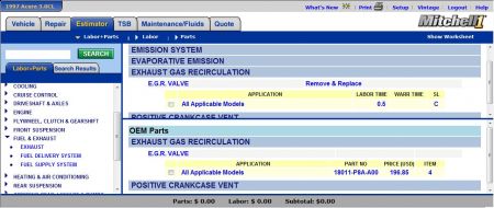

I am getting the above code on my car. I know what needs to be done, and would prefer to do it myself, but I currently don't have a shop or garage to do the work in.
So, long story short, what is a fair price for this job to be done RIGHT. The complete kit w/ spacers, sleeve, cleansing of the manifold etc.? Does $395 sound about right?
Also, what are current shop labor rates? I know this job is primarily labor.

Labor rates and parts varies with location could be $70.00-$130.00-See below
