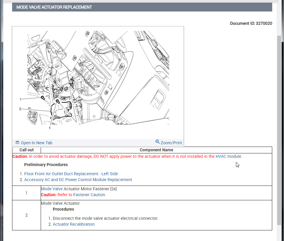

My truck will not switch from defrost. Do I need to replace the actuator? If so, where is it and what is the part number?
Sep 30, 2019 at 7:11 PM
Yes. This is a default position for when the mode door fails. This happens because it could be a safety issue if you can't get the defrost on so if this actuator fails there is a spring that will bring it back to the defrost position so that you always have that so the windows fog up.
https://www.2carpros.com/articles/air-vents-stay-in-the-defrost-position

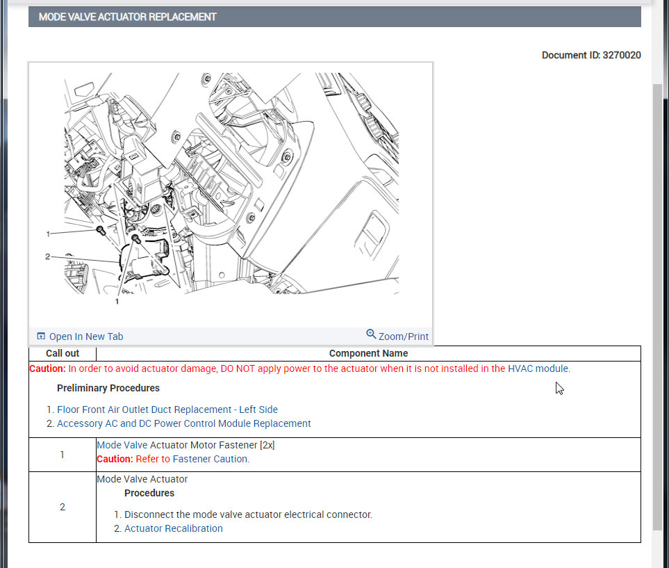

I attached the process for replacement plus the re-calibration process. Let us know what questions you have. Thanks

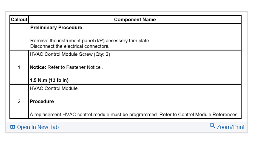

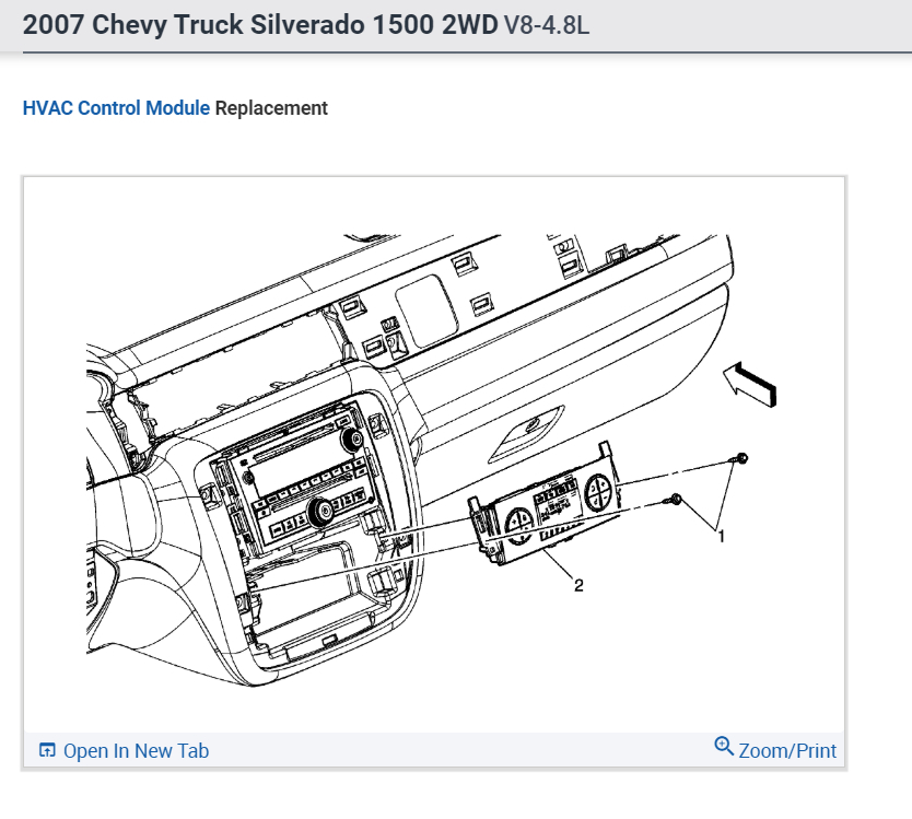

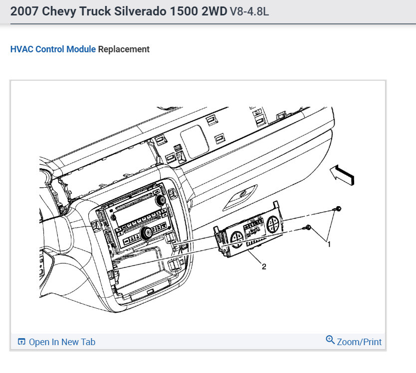

It sounds like the HVAC controller is out. here are instructions in the diagrams below to help you replace the unit:
Without Rear Defrost Without ATC Dash Control Unit 25869947 $303.70.
HVAC Control Module Programming and Setup
Each of the following service procedures may require programming or setup procedures to be performed on the HVAC control module or HVAC actuators.
HVAC Control Module Replacement
If the HVAC control module is replaced it must be programmed with the latest operating software and vehicle calibrations. Refer to Service Programming System (SPS). See: Vehicle > Programming and Relearning
HVAC Control Module Reprogramming
Do not reprogram the HVAC control module, unless directed by a service procedure, or a service bulletin.
Reprogram HVAC Control Module-Refer to Service Programming System (SPS). See: Vehicle > Programming and Relearning

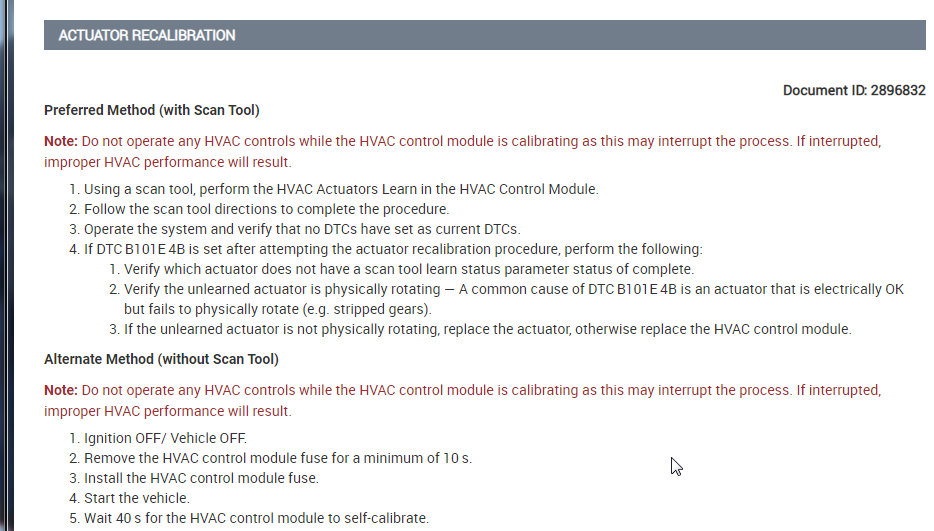

Actuator Replacement
If an actuator is replaced, the following procedure must be performed:
* Re-Calibrating Actuators-Refer to Actuator Re-calibration for the manual system. See: Vehicle > Programming and Relearning
* Re-Calibrating Actuators-Refer to Actuator Re-calibration for the automatic system. See: Vehicle > Programming and Relearning

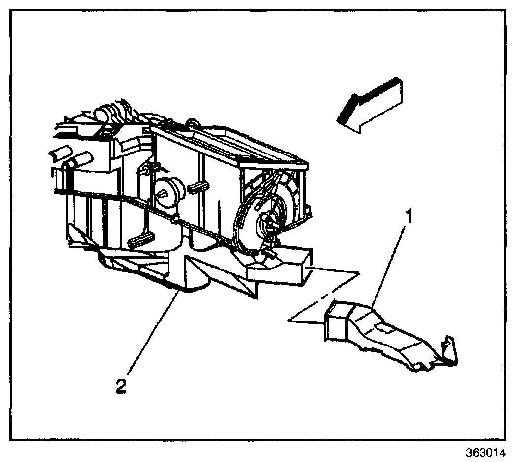

Good afternoon,
I attached the procedure for the mode door actuator for you. That is the most common failure for this issue.
Mode actuator replacement (w/ d07)
Removal procedure
1. Remove the floor air outlet duct extension (1) from the floor duct (2).
2. Remove the center console.
3. Remove the screws from the center console duct.
4. Remove the center console duct.
5. Disconnect the electrical connection from the mode actuator (10).
6. Remove the mode actuator mounting screws from the HVAC module.
7. Remove the mode actuator as an assembly with the actuator cam.

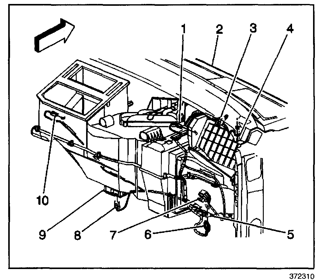

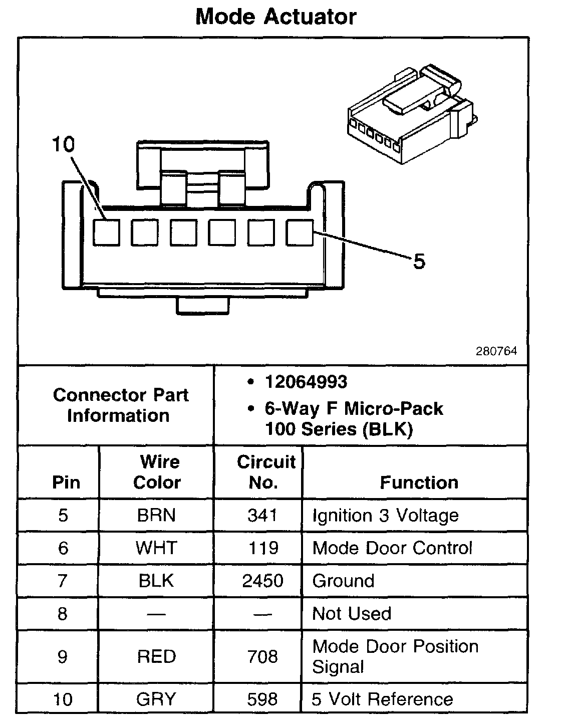

  • 110,194 POSTS
Welcome to 2CarPros.
Was it the mode door actuator that was replaced? Now, often times people end up in error replacing the blend air door actuator or even the recirculation door actuator. I attached a picture of the mode actuator which is where the problem lies. Please confirm this is the part you replaced. It is part 10 in picture 1.
I will also need to know if this has automatic climate control or manual.

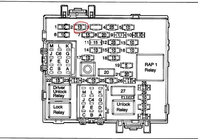

If you replaced the correct one, I need you to look at pic 2. Check the pins indicated in the picture to confirm there is power and ground. Pin allocations are common for both manual and automatic climate control.
If there is no power, next confirm that fuse 2 is good in the left instrument panel fuse box. See picture 3.
I don't know if you need them, but here are a few links you may find helpful:
Apr 30, 2021 at 11:25 AM (Merged)
MATOEMIS
  • 5 POSTS
Replaced #10 driver side. It has power and ground. manual climate controls. A while back It started working fine again for about a week then went back to defrost.
MATOEMIS
  • 5 POSTS
Pluging my test light in to the ground on that clip i can get it to light on one other wire.
  • 110,194 POSTS
Welcome back:
It sounds like a connection issue. Which wire does it light on? You should see low voltage from a few wires.

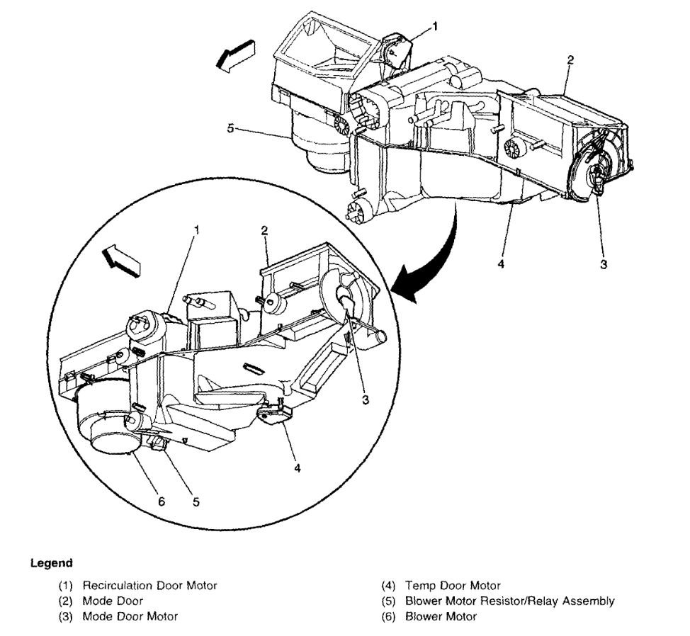

This is a different issue then the compressor. This is due to the mode door actuator not operating. The defrost is a safety default so that the windows don't fog up and you can't see.
Here is a guide that covers this issue in more detail:
Here is a video on how to replace the blend door actuator on your truck. It is a difference actuator then the mode door but the process is the same.
https://www.youtube.com/watch?v=tY6M92fA2ug
Lastly I attached the location of the mode door actuator for your review so that you can replace it. Let us know if you need more info. Thanks

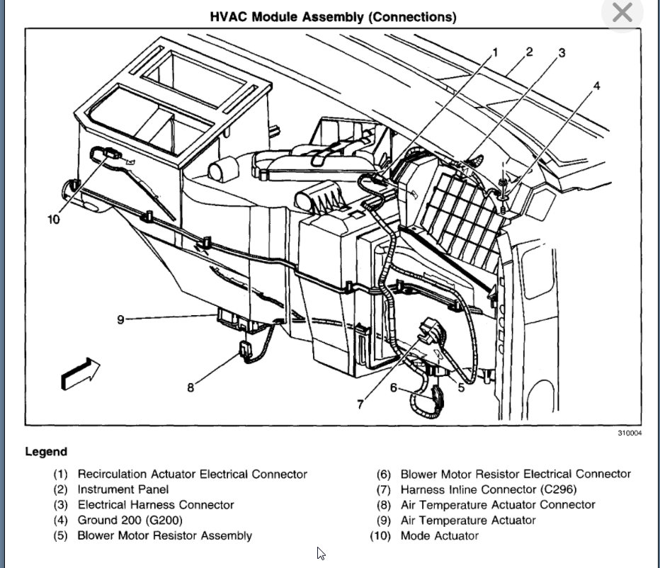

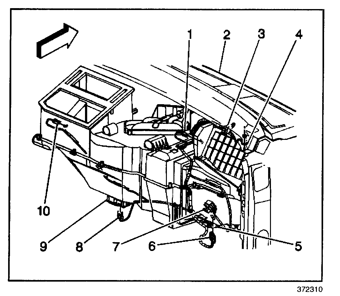

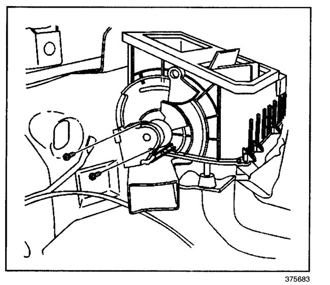

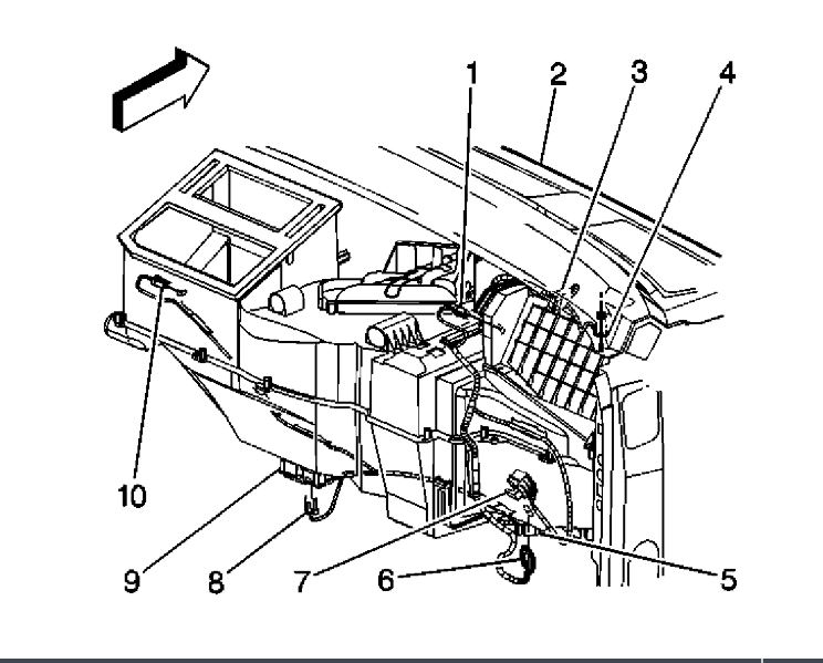

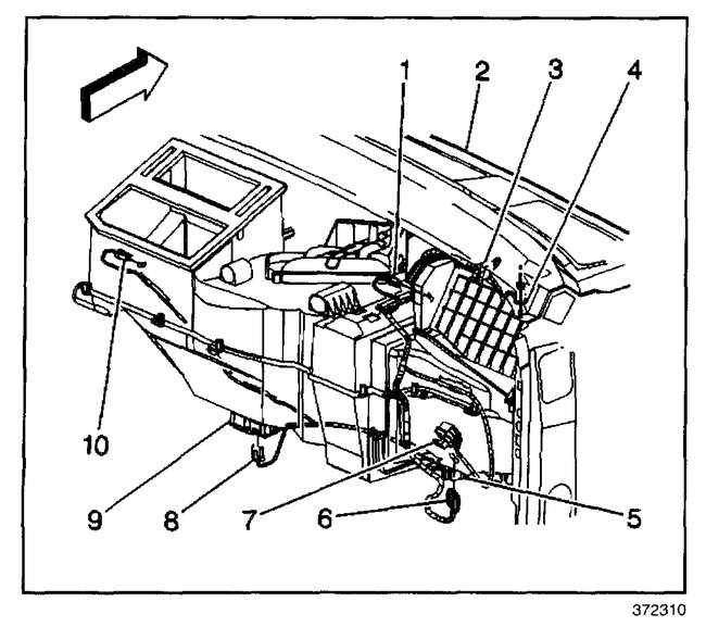

Here are the directions specific to your vehicle. Picture 1 shows the location of the actuator. I circled it in the pic. Yes, it's up under the dash.
_______________________________________
MODE ACTUATOR REPLACEMENT (W/ D07)
REMOVAL PROCEDURE
pic 2
pic 3

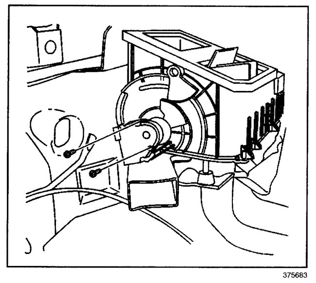

pic 4

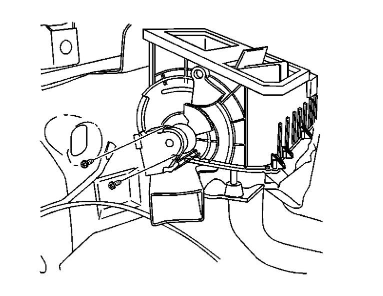

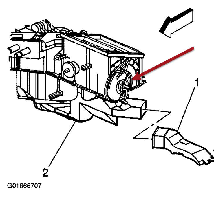

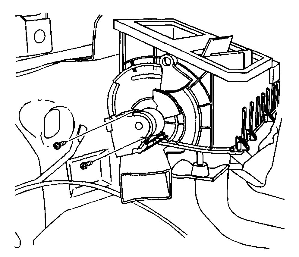

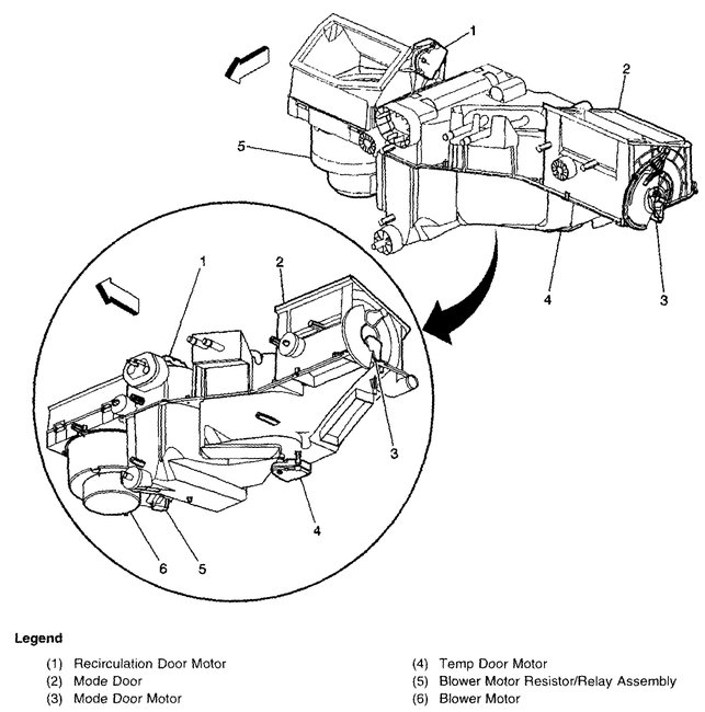

INSTALLATION PROCEDURE
pic 5
1. Install the mode actuator as an assembly with the actuator cam.
- Line up the heater/defroster valve lever with the mode actuator cam slot.
- Line up the A/C valve lever with the mode actuator cam.
NOTE: Refer to Fastener Notice in Service Precautions.
2. Install the mode actuator mounting screw to the HVAC module.
Tighten
Tighten the screw to 1.6 N.m (14 lb in).

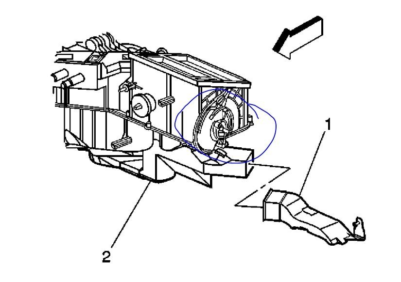

pic 6
3. Connect the electrical connection at the mode actuator (10).
4. Install the center console duct.
5. Install the screws from the center console duct.
Tighten
Tighten the screw to 1.6 Nm (14 lb in).
6. Install the center console.
7. Install the floor air outlet dud extension (1) to the floor air duct (2).

You may have to pull a panel to see it, but look above gas pedal as it is on the heater. See picture item 1 is the floor duct, but try pulling HVAC fuse inside truck first like I said in first reply.

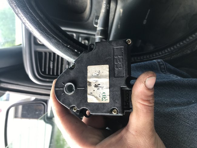

My actuator was stuck on defrost i had to get a new one and it was a little weird to replace but the guide helped. thanks

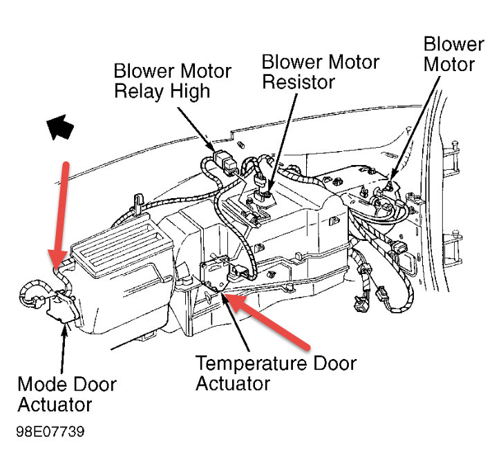

STEVE W.
  • 15,200 POSTS

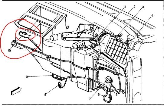

Your description sounds like you have either a bad mode cam or the door itself has failed. If you can hear it most likely the actuator itself is working, it just isn't moving the door.
The mode door actuator is on the end of the HVAC unit on the drivers side right above the transmission tunnel. Item 3 in the image. To get to it you remove the floor air duct that blows into the drivers foot well, then look above the outlet for that duct and you will see the actuator and the cams and linkage that move the mode doors for defrost/vent/floor. There is an electrical connector and two screws that secure it. Reach up and change through the modes and see which parts are not moving. The plastic parts get brittle and fail or simply fall apart loose. You can get the complete assembly as shown in the last picture from Rock Auto or a dealer. It includes the cam that tends to break. Sometimes you can glue them back together as well.

STEVE W.

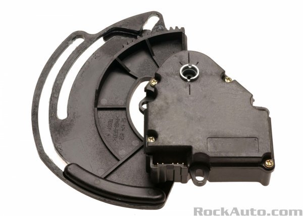

  • 15,200 POSTS
That sounds like a bad mode actuator and cam. The mode actuator is on the drivers end of the HVAC case just above the plastic floor duct over your feet. You remove the duct and the actuator is there. Be sure to line up the heater/defroster valve lever with the mode actuator cam slot and to line up the A/C lever with the mode actuator cam. when you install the replacement part. The plastic piece you see on the last picture is the cam. When the motor moves that moves the various doors to send air to the floor, dash, defrost. I have seen them break open and the door pins come loose from the cam.
Apr 30, 2021 at 11:27 AM (Merged)
LISA SCHEY
So I need the cam and the mode actuator both. So is it called a blend door actuator? Are both the same? The one on the drivers side and the one under the glove box? Finally someone who knows what is wrong. Thank you. Your answer makes perfect sense.
STEVE W.
  • 15,200 POSTS
The mode door actuator will have the cam on it like the last picture.
The blend door controls the temperature of the air by controlling how much goes through the heater core and is a different part in a different spot.
The part you need to look at is # 3 in the first picture. It is very possible the actuator itself is OK but the levers that connect to the cams are unhooked. If you use a light and look up above the drivers foot well you should be able to see it and watch it move.

try pulling fuse for HVAC inside truck for sixty seconds with key on that resets actuators. the wet floor board can be a plugged drain which is under truck and can be cleaned by using a coat hanger into it to clear it. I am assuming A/C pipe gets cold under hood. the mode controls direction and blend controls temperature. See picture.
DEBBIE ELSEN
I pulled the fuse and the air was still warm but not nearly as warm as it was blowing. After about ten minutes it went back to the same hot air and still has not moved from the defrost vent.

HMAC300
  • 48,601 POSTS
Then the mode actuator in picture that I sent earlier is probably bad. It can be reached from drivers side by gas pedal. Also, when you run the A/C feel the large pipe and it should be cool/cold to the touch and maybe dripping water if not then the A/C should be checked for pressure as it may have a leak or low.
