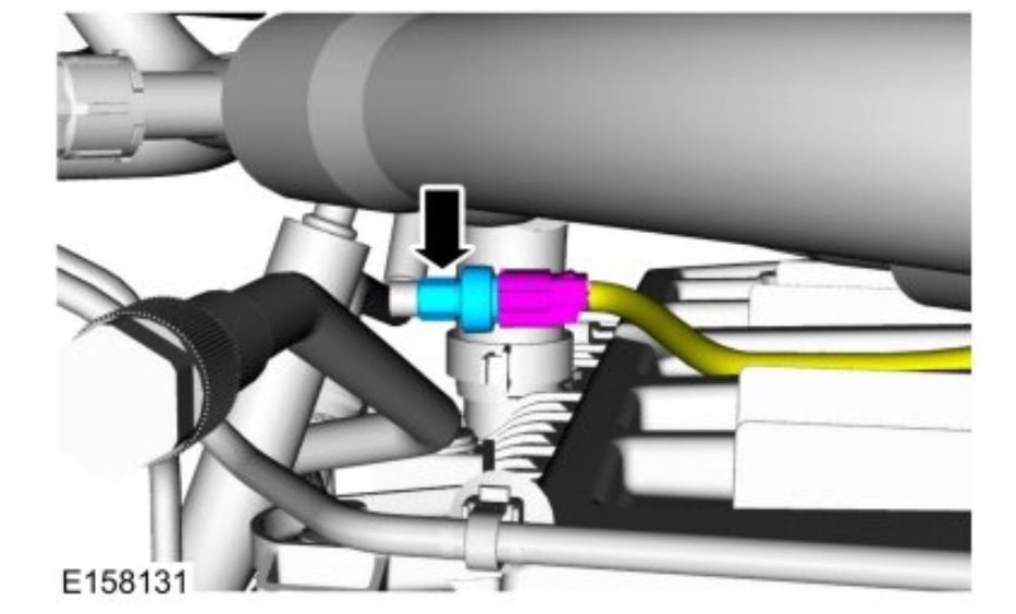

I'm looking for the A/C pressure sensor switch for the low pressure side. I assume it's near the accumulator/drier, but I cannot find that either.
Jul 25, 2020 at 9:36 AM
Good evening,
I attached a picture of the location and the procedure.
Why do you believe that it has failed?

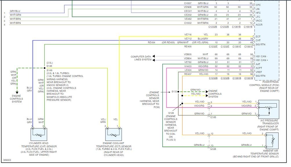

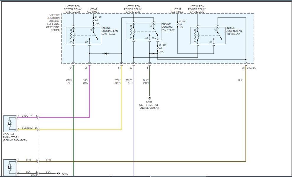

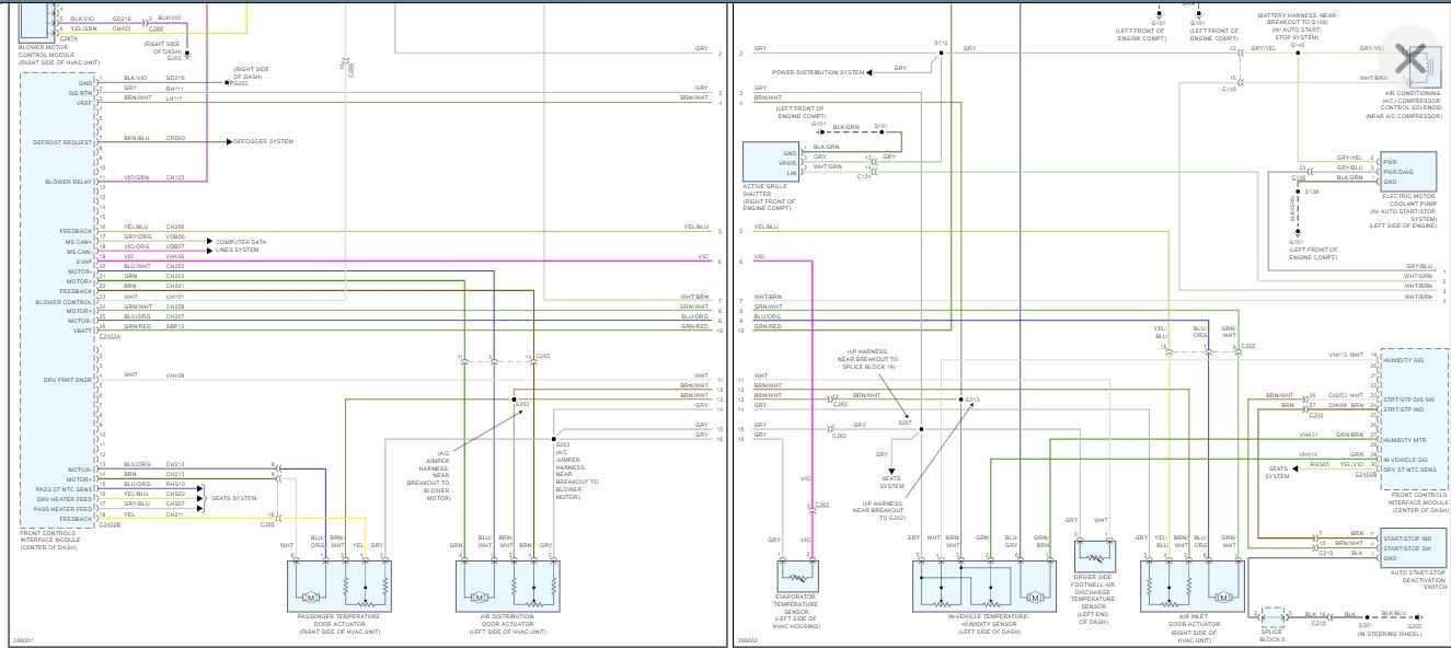

I attached a wiring diagram for you of the A/C system. Do you have a test light to do some checks?

Jul 25, 2020 at 9:49 AM

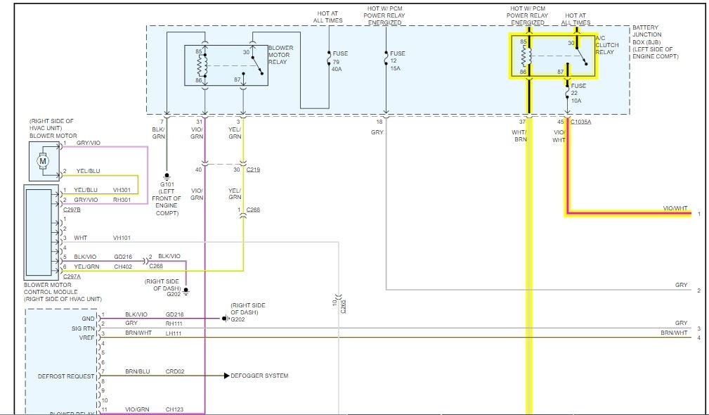

Okay, what is the pressure? What is the numbers on the high and low side?
I attached the wiring diagram for you.
You will need a voltmeter to check some voltages at the pressure sensor.
Let me know when you are ready to do some testing

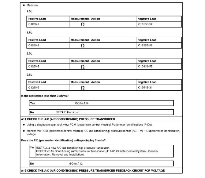

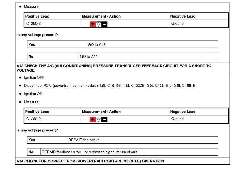

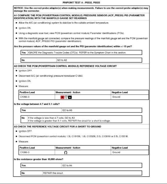

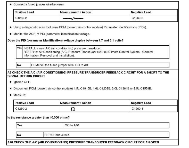

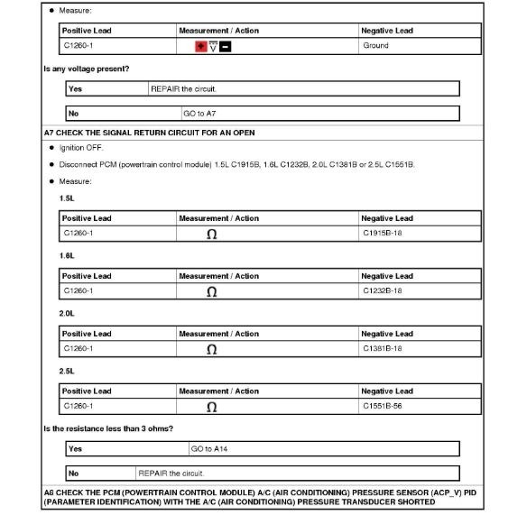

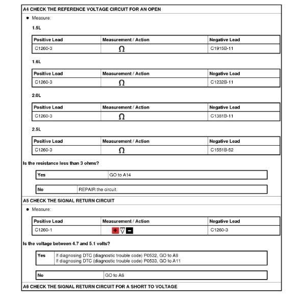

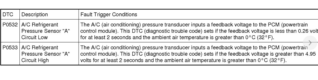

You never gave me a high side reading. I need that reading and the low side while the A/C is on.

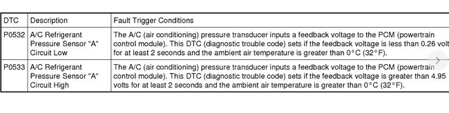

Below is the description of the code and attached is the flow chart for determining the failure.
Climate Control System - Vehicles With: Dual Automatic Temperature Control (DATC)
Pinpoint Test(s)
P0532, P0533
Normal operation and Fault Conditions

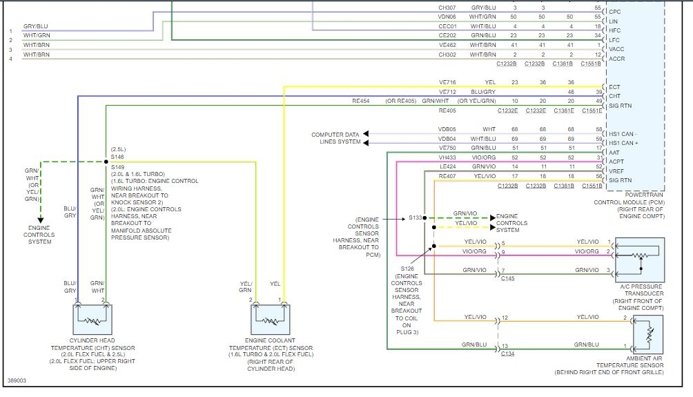

The A/C (air conditioning) pressure transducer receives a ground from the PCM (power-train control module). A 5-volt reference voltage is supplied to the A/C (air conditioning) pressure transducer from the PCM (power-train control module). The A/C (air conditioning) pressure transducer then sends a voltage to the PCM (power-train control module) to indicate the A/C (air conditioning) pressure.
DTC Fault Trigger Conditions
Possible Sources
Wiring, terminals or connectors

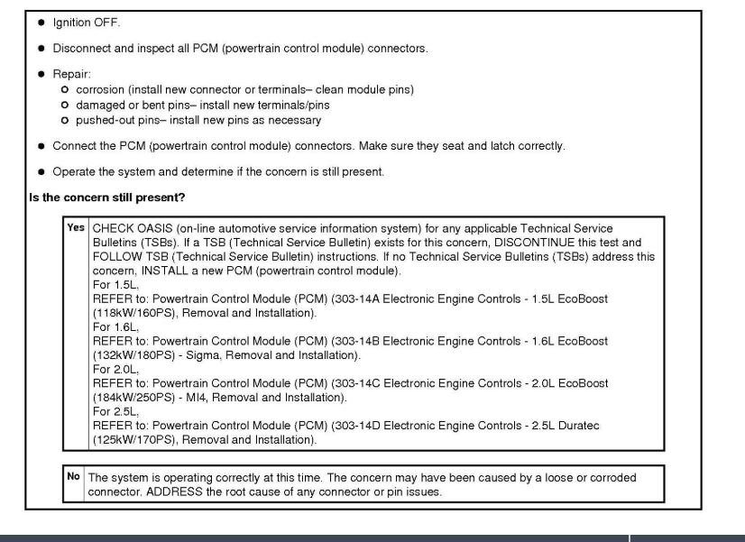

Visual Inspection and Diagnostic Pre-checks
Inspect for loose or corroded PCM (power-train control module) and A/C (air conditioning) pressure transducer connections.
Jul 26, 2020 at 9:22 PM

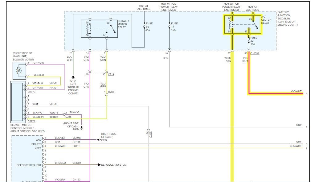

Okay, go to the clutch relay. Remove the relay and with the key on, test for power at the terminals.
You should have 2 powers with the key on.
The diagram I posted back in the beginning.
Jul 28, 2020 at 7:11 AM
J-SPAZ
  • 16 POSTS
Yes. Two powers with key on for relay. Relay clicks on insert, as well. No power to fuse without relay. Power to fuse (both sides) with relay in.
Aug 5, 2020 at 1:19 AM
If the relay energizes when you put it in, check for power to the compressor connector.
If it has power, the compressor is the issue.

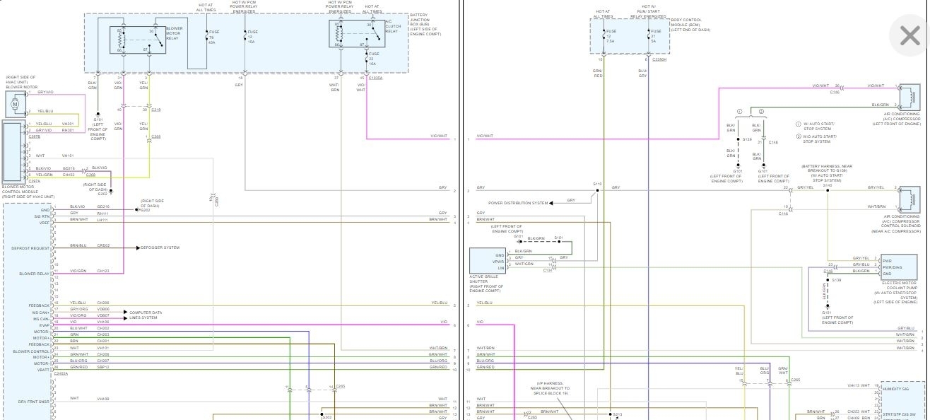

Okay, then it sounds like you have an open wire between the relay and the compressor.
Aug 5, 2020 at 2:12 AM
J-SPAZ
  • 16 POSTS
Great! What's the best way to trace the wire to the relay, or the most likely place for a fault? Thanks!
Aug 5, 2020 at 2:35 AM
I do not have a routing diagram of the wire. I would start at the compressor and work your way back. Look for any areas where it gets hot or the harness is damaged.
Aug 5, 2020 at 2:38 AM
J-SPAZ
  • 16 POSTS

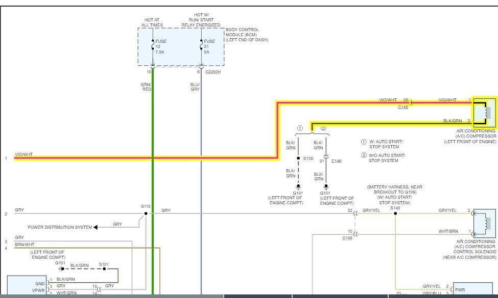

Will do. And, I'm tracing the violet/wht wire from the look of the diagram, correct?
Aug 5, 2020 at 2:43 AM
That would be correct. That goes from pin 87 of the relay directly to the compressor.

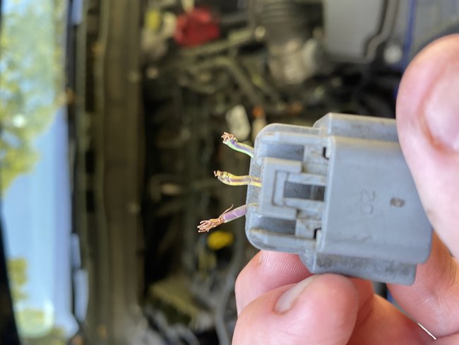

There appears to be a plug with 3 wires underneath the intake manifold where the wires have been pulled from the plug. The wire colors appear to be yellow/brown, green/brown, violet/green? Is this completely unrelated? It seems too coincidental to be unrelated.

More likely a plug with yellow/violet, green/violet, and violet/green? It appeared to be plugged into the harness coming from the alternator.

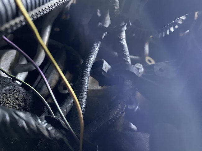

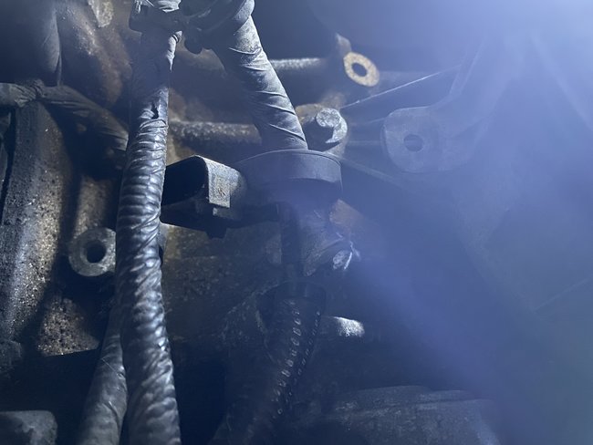

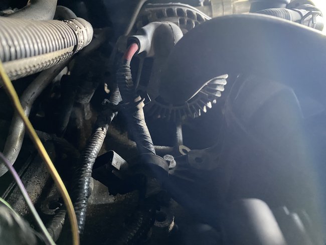

As you can imagine, it's quite difficult to get a picture of the place the plug goes. In the second picture, you can see the plug receptacle in the background and in the final picture, you can see the three wires that go to it in the foreground. As I stated in the previous post, it appears to go into the harness for the alternator? I'm adding a 4th picture of the plug going towards the alternator.

That got ripped out or cut out.
Can you find the 3 wires that go to that connector?

Here's the picture of it going into the alternator. Yes, I can reach the three wires that go into the plug, although it's somewhat difficult. Is this likely the issue, or a completely different issue?
Aug 21, 2020 at 8:17 AM
Okay, you are going to have to remove the wrap from the harness and the tape around the harness to expose the wires and you can do the repair.
You will need to solder and shrink wrap the wires back together.
Since the color wire for the compressor is there, I would say yes to being the issue.

There's not quite enough wire on the connector. Can I remove the wires from the connector, or a new one? Suggestions?
Aug 21, 2020 at 8:40 AM
Yes, you would need a terminal removal tool. You can get one at a part store or you could get the connector. It is called a pigtail and it comes with wires installed and about a foot in length.
A parts store should have them.Take it with you to match up.

Unfortunately, replacing the connector did not work for the A/C problem.
