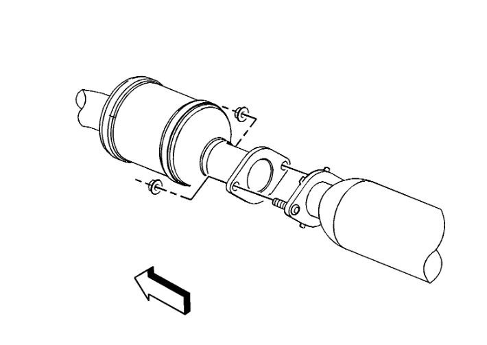

when i am at a red light or going from idle to accelerating the car takes like 10-15 to pickup speed but the rpm's rev up. After i get speed its okay or if i am on a high it's okay, but it only happens when i stop and then go to drive again.

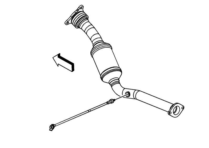

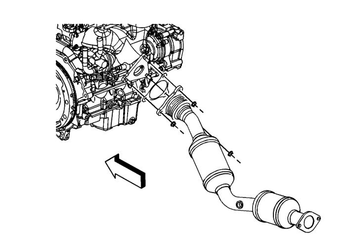

It sounds like the catalytic converter is clogged not allowing the engine to breathe.
It will give you low power. You need to do a back pressure test. You could remove the front O2 sensor and drive the car and see if it runs better. That will confirm the converter.

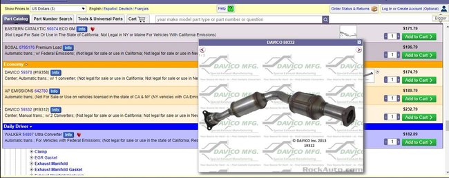

okay and is it cheap to fix a clogged converter?
Mar 2, 2020 at 12:52 PM
It needs to be replaced, not cleaned. You cannot clean a catalytic converter.
