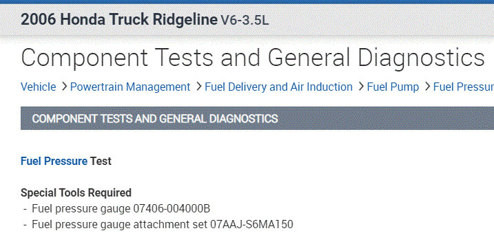

Truck idles, but shuts off when you apply gas.
Dec 22, 2021 at 2:59 AM
  • 110,240 POSTS

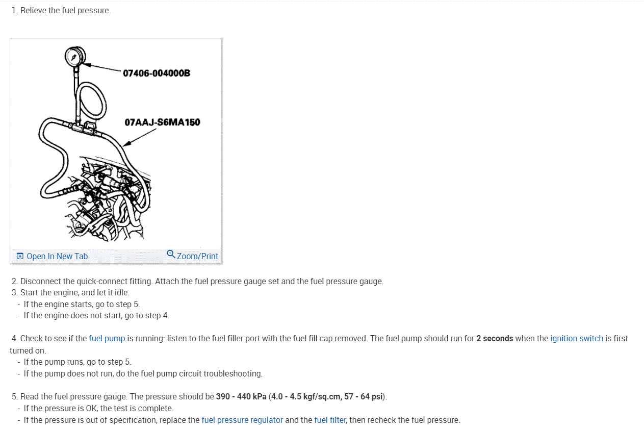

The first thing I would recommend is to check fuel pump pressure. If it is low, this can happen.
To get you started, here is a link that explains in general how it's done.
If you look at the pics below, they provide directions specific to your vehicle for testing pressure. Additionally, the manufacturer's fuel pressure specifications are included.
