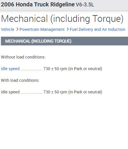

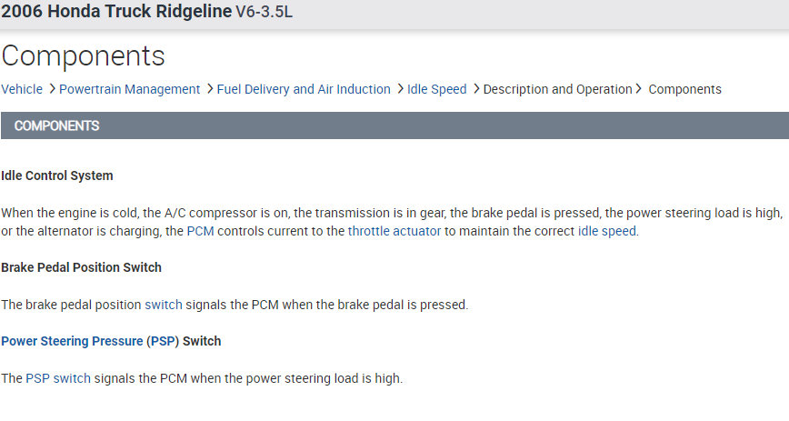

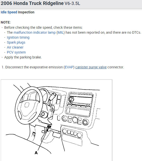

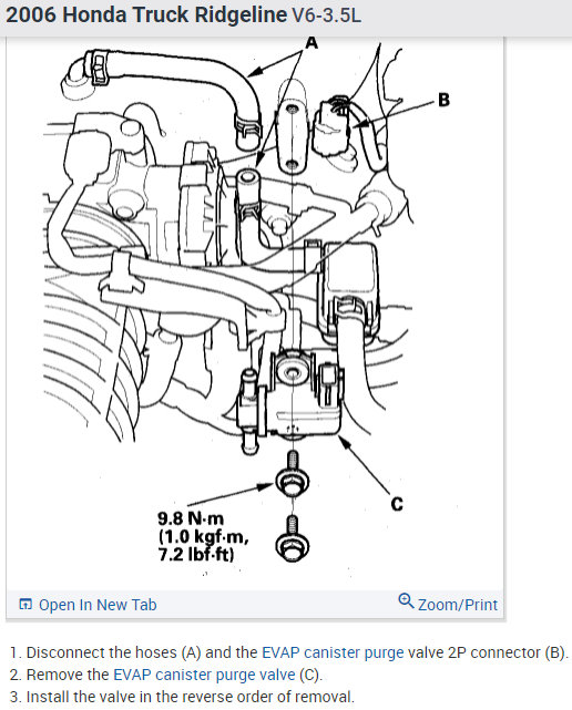

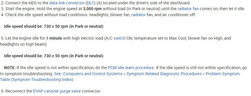

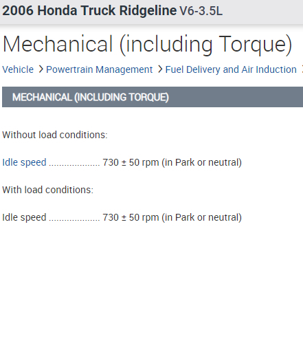

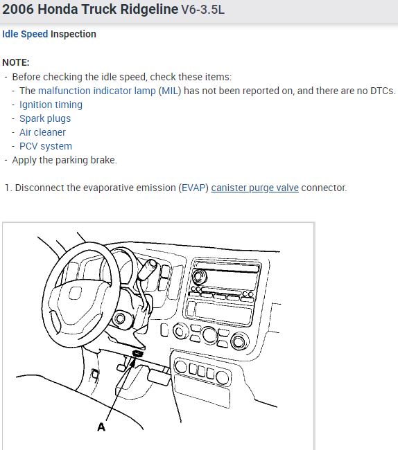

What are the codes that you have on this truck?
I have attached diagnostics for the IAC on your truck.
Let me know of any questions.
