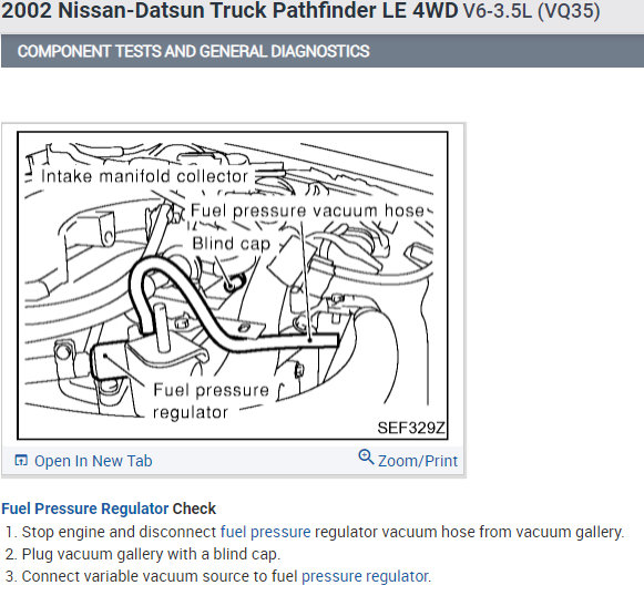

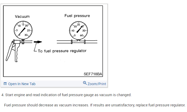

I bought the vehicle listed above which was stopped for a long time. I charged the battery and it did not work, so I asked a local mechanic and he said the fuel pump is gone, so I got it replaced with one from scrap. Then it worked fine for a day, next day it started accelerating slowly and even it gets turned off sometimes. I asked two mechanics locally and one of them told me it's the fuel pump motor and other said fuel filter.
Any idea why is this happening?
Jul 15, 2021 at 2:32 AM
SQM
  • 6,383 POSTS

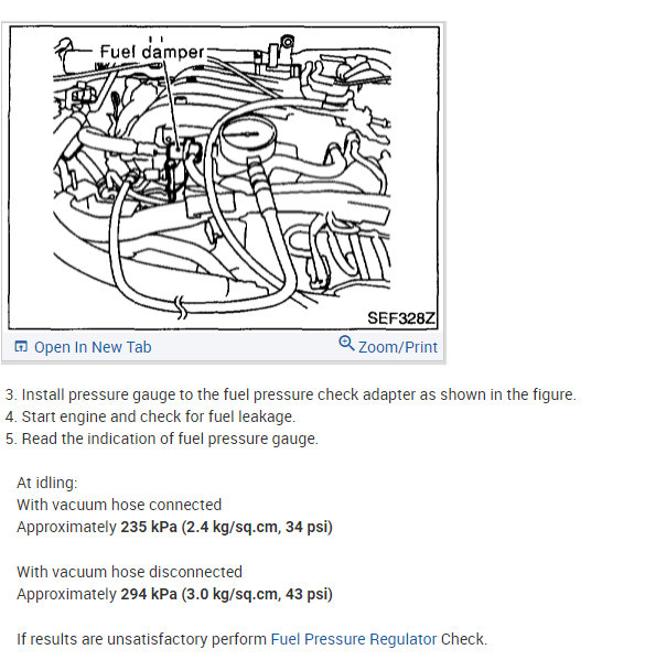

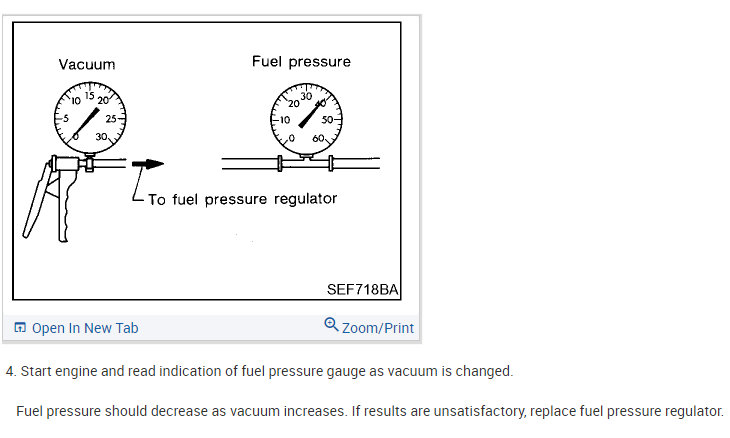

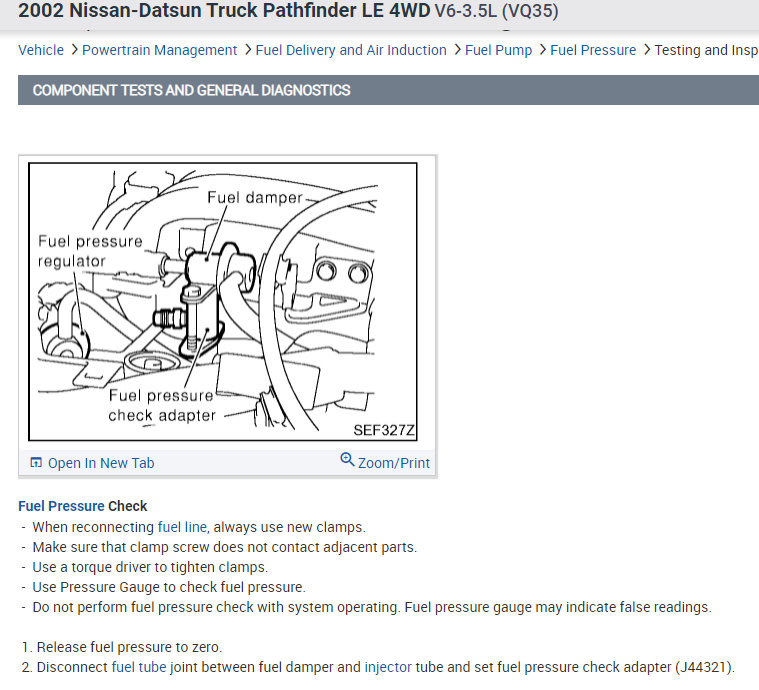

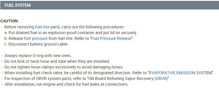

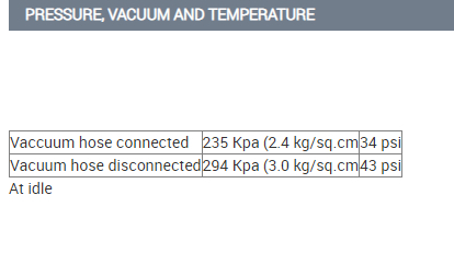

This could happen for several different reasons. You could have a clogged in the fuel line/filter. Could have a fuel hose that might have collapsed.
Have you checked the fuel pressure?
Here is a guide on how to check fuel pressure:
