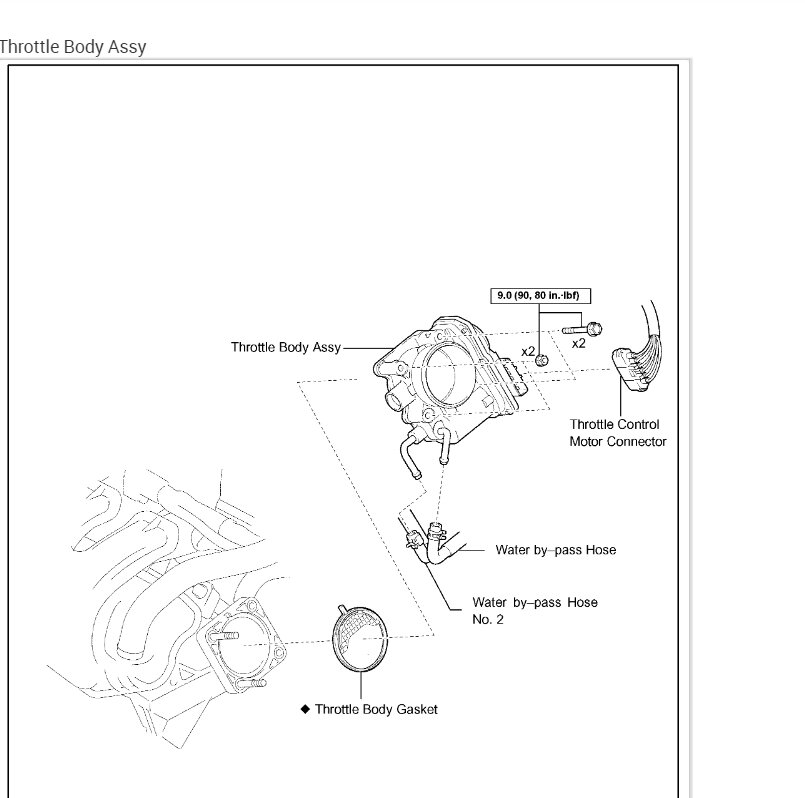

The accelerator stops working suddenly on motion but the engine still running. To get accelerator work I use to run off for about 30 seconds or a minute and on the engine.
Feb 13, 2023 at 1:07 PM
  • 55,256 POSTS
This happens when the car goes into limp mode. This guide will help explain more but usually happens when the throttle body needs to be serviced also, we should run the codes.
https://www.2carpros.com/articles/reduced-power-limp-mode
and this guide can show you how to get the codes:

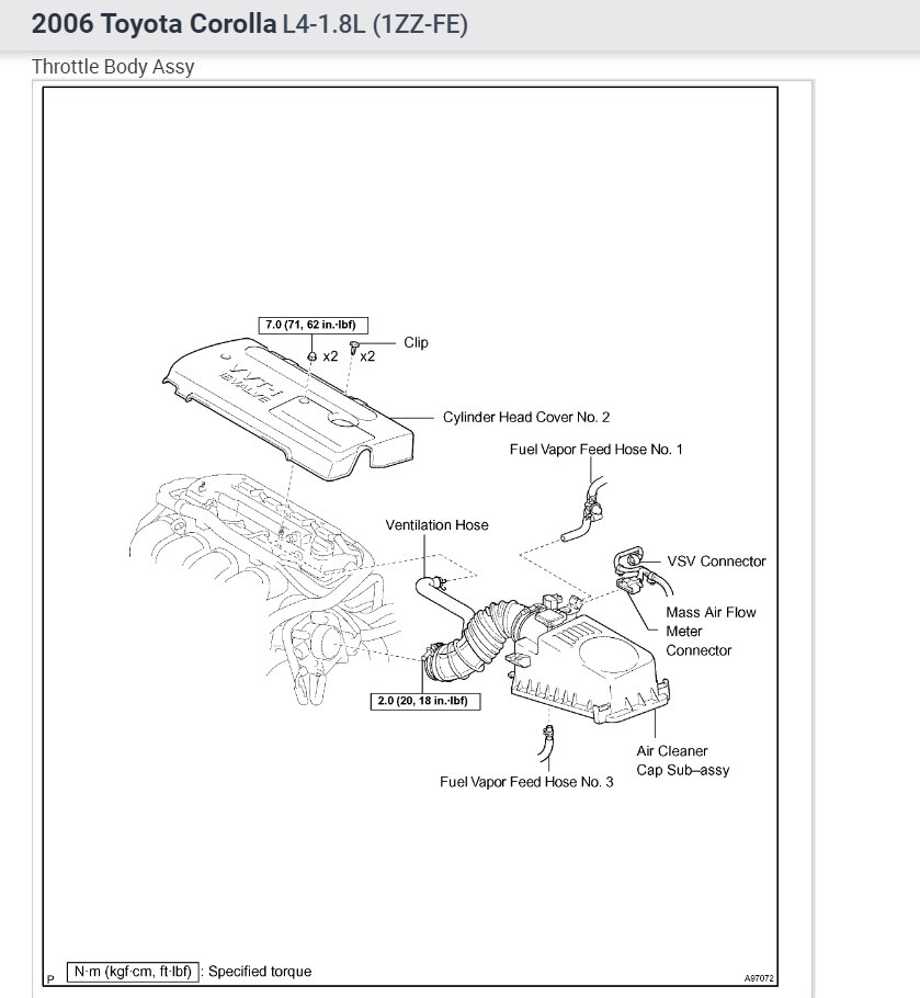

This guide can help walk you through the steps of doing the service and I have included the instructions for your car in the images below.
Please get back to us so we can see what happens.
