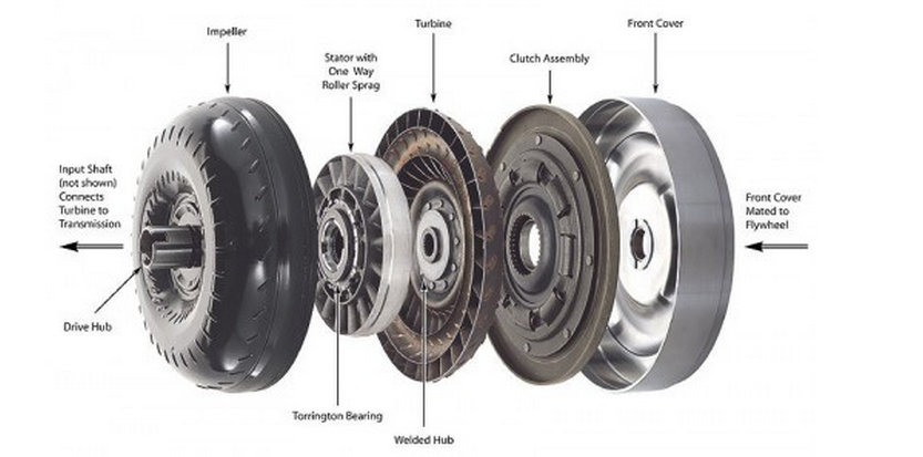

The limited RPMs you experience when selecting D and applying the footbrake is caused by the torque converter in the automatic transmission. It is called torque converter stall.
Torque converter stall speed is the maximum amount of engine RPMs that can be achieved in an automatic transmission-equipped vehicle while the transmission is in a forward operating range without generating any driveshaft motion. This limited RPMs is normal. See image 1 below for a torque converter exploded view.
