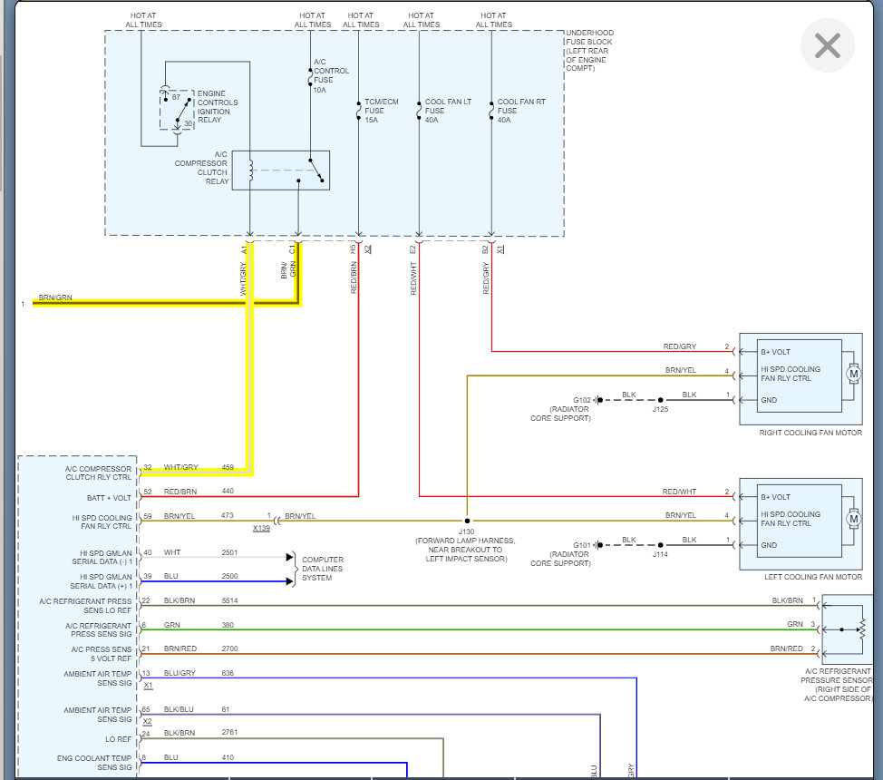

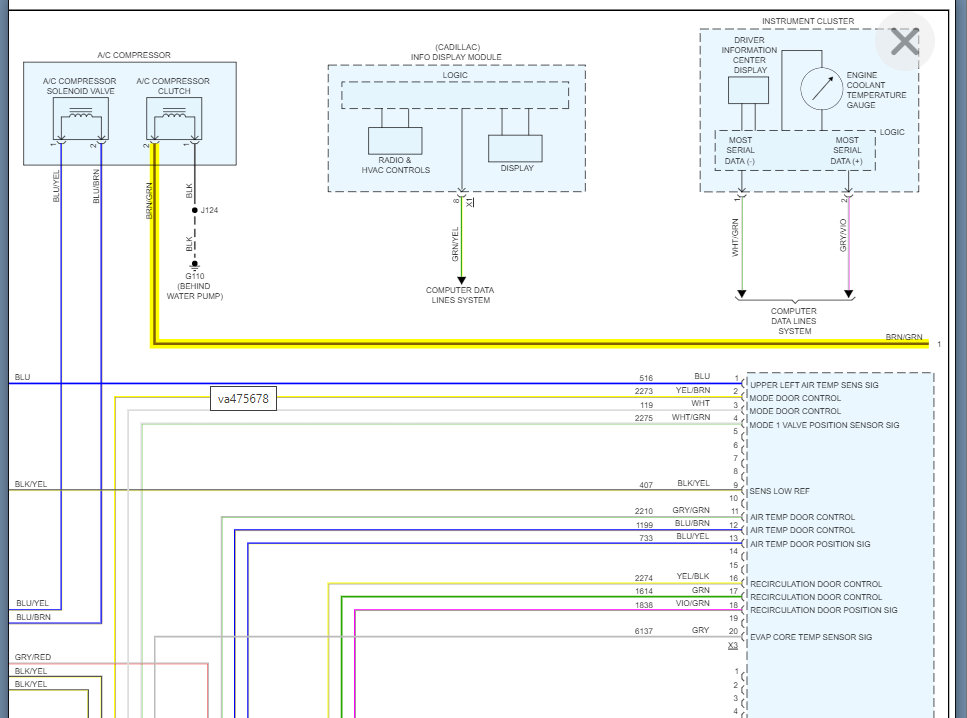

I took my vehicle listed above to a local Chevrolet dealer for a recall and when I got it back the A/C only works intermittently. Of course, I took it back to them five different times. They vacuumed the system and recharged it three times, inserted dye to find the leak they were sure we had. They found no leaks. I was getting pretty frustrated and took it back one last time. They called after 3 days and told me this: "there is a relay in the fuse box that is built in that controls the compressor. It should have a spec of 1 Ohm and it is reading 108kOhms. It is tripping the compressor on and off. This vehicle needs a new fuse block. The total out the door would be $480.00".
I would like to not give them that kind of money to repair something that was working when I dropped it off to them. Which fuse block is this relay located in? Is this something that a novice but fairly mechanically inclined individual can replace?

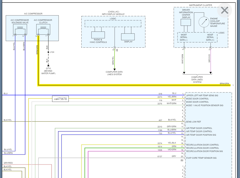

I am not sure which relay they are talking about, but I assume it is the specific compressor relay.

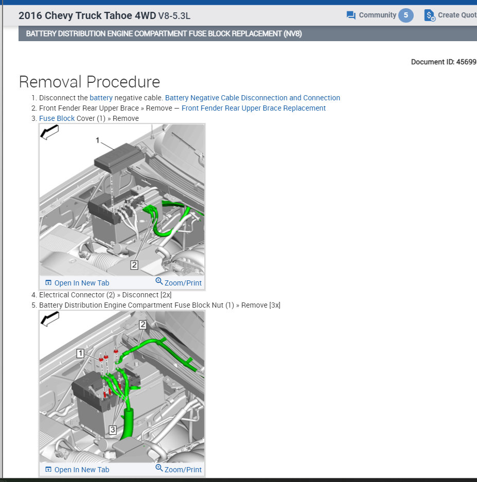

If this is the case, then I am attaching the info for this relay. As you can see this is part of the under-hood fuse block which I am attaching the info below for this.
However, I am concerned that this is not the issue based on this info. Where did they measure the resistance of this relay? Was the relay engaged when they took this reading?
They could be correct, but I would just want a little more proof of this before agreeing to it or get them to agree that if this does not fix it then you do not have to pay for this repair.
Please see the info below and I would get a part number of what they are saying needs to be replaced just to be sure this is what I attached.

Thank you for the quick response. I called the dealership, and they were less than helpful when I asked about their ohm readings. I was, however, able to get the part number. GM part# 84114437.

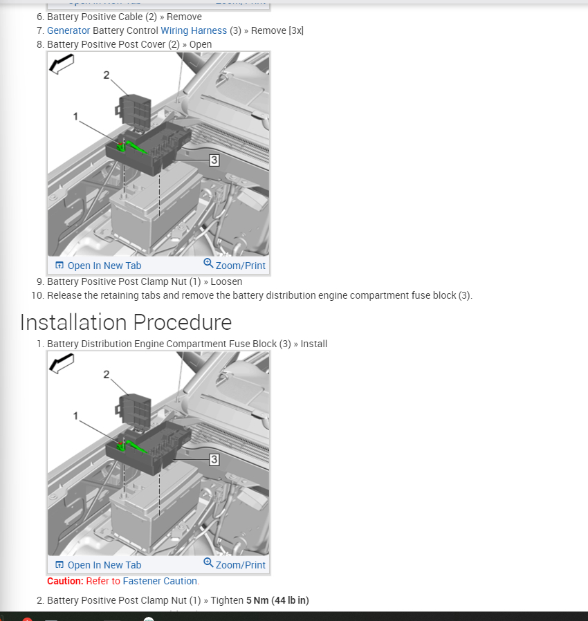

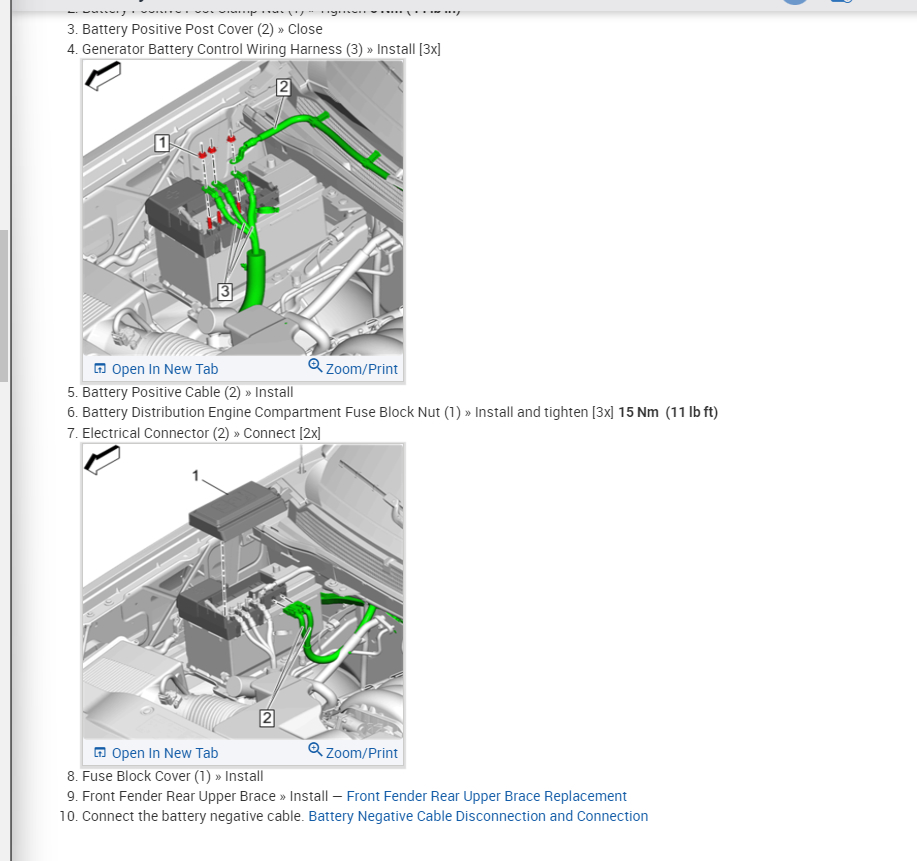

That does appear to be the same part that I supplied the process for. So, if we trust their diagnosis then let me know if you are going to try this based on these instructions.
Let me know if you have questions. Thanks

Well, the part arrived on Wednesday, and I just installed it. That was a much simpler job than I had anticipated. After swapping it over the A/C blows cold. I am optimistic that my $60.00 used part just saved me $500.00 from the dealership and kept me out of the doghouse with the Mrs. Thank you for your input and help on this!
