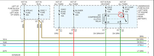

have replaced the compressor, the relay, and all switches. The pressure is right all was charged when I replaced compressor. I can jump the relay the compressor will come on. But what's keeping it from working? I've got 5 volts at the low and hi pressure switches. I'm lost.
Apr 19, 2023 at 6:30 AM
BURRESS 1998
  • 18 POSTS
If I add ground to 30 on relay the compressor will also kick on but not cycle.
Apr 19, 2023 at 7:15 AM
  • 110,244 POSTS

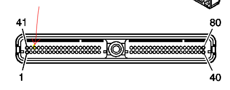

That is confusing. Pin 30 should be a power supply for the compressor clutch. If you ground that, it should cause the fuse to fail. See pic 1 below.
Please confirm that it is pin 30. I have a feeling it is pin 85 that isn't providing a ground. Pin 85 is the ground path for the primary side of the relay and is provided via the PCM.
Please double-check that and let me know.
See pic below.
Apr 19, 2023 at 12:58 PM

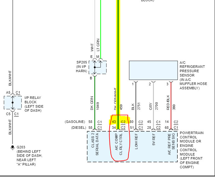

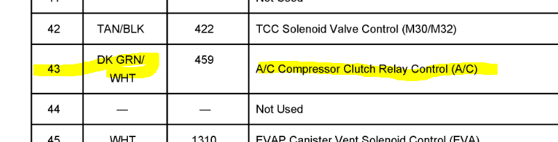

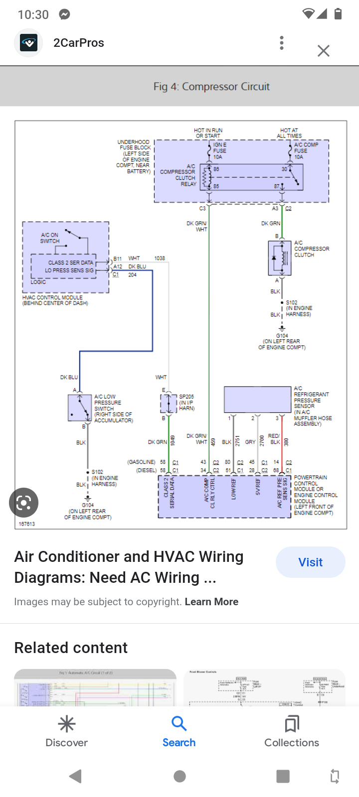

Okay, the problem is the PCM isn't providing a ground path or there is an open circuit between the two.
What I suggest is to first locate the PCM. Disconnect the battery and then disconnect the PCM. Locate the green wire with a white tracer in connector 2. See if there is continuity between the PCM C2 and the relay pin 85. This is just to confirm the wire itself is good.
If that is good, then in connector 2 locate pin 43. Reconnect the battery and turn the AC on and see if pin 43 is providing a ground path to actuate the relay.
Let me know what you find.
See pics below. Note: Connector 2 is a green 80 pin connector.
Apr 20, 2023 at 11:39 AM

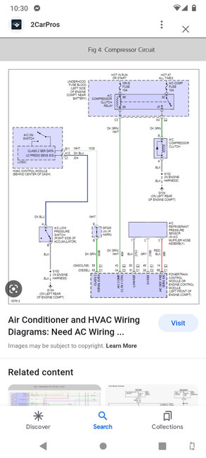

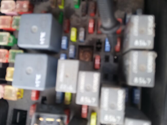

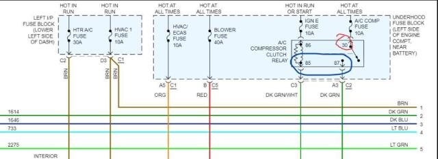

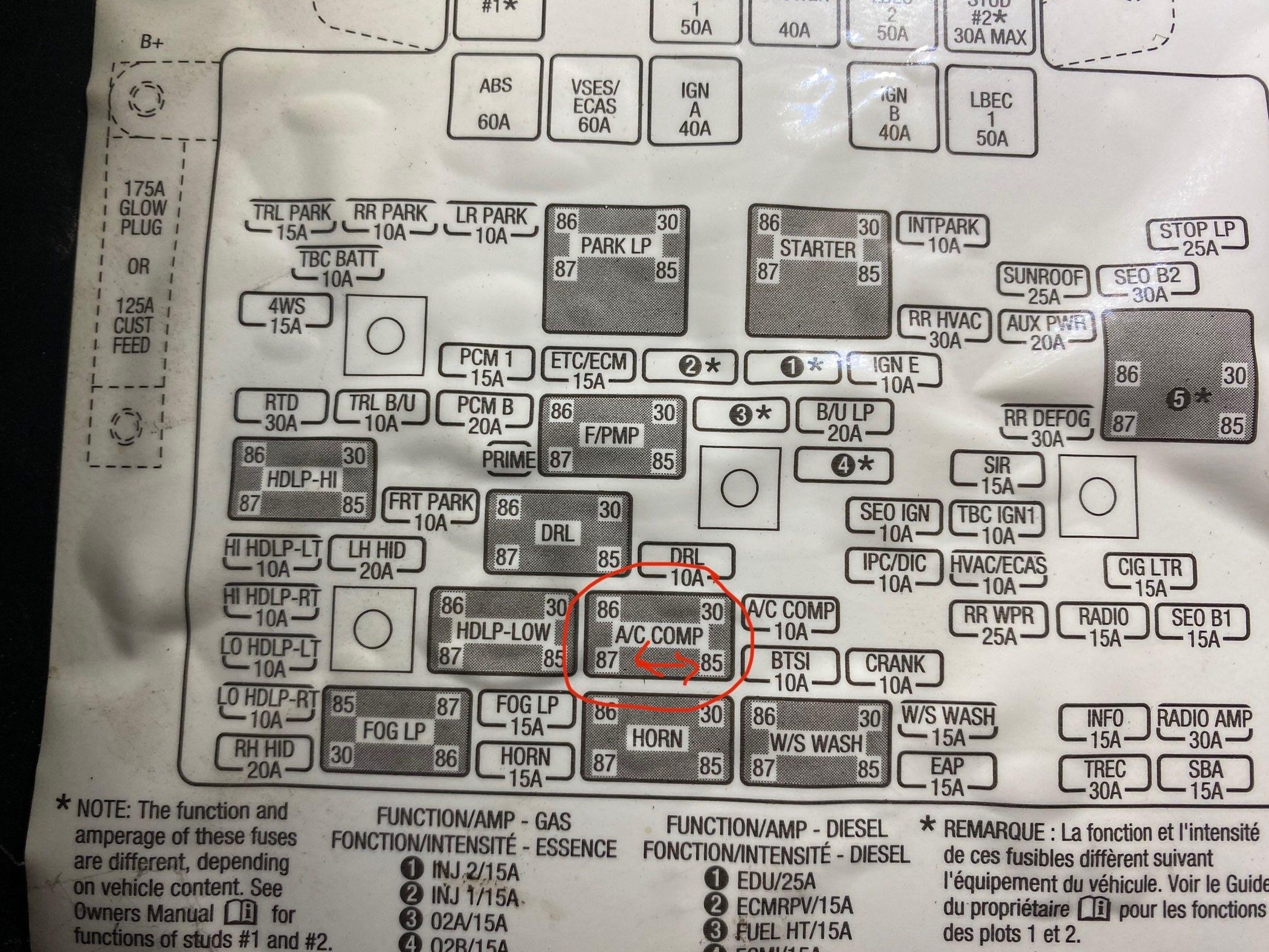

Okay, I'm very sorry for the confusion. This is what I was going off of and it looks like 87 and 85 are swapped. The is my lid to fuse box.
But if we are going off of your diagram in photo two. 85 does have continuity all the way to the plug of the PCM. When I was adding the ground yesterday to get the compressor to kick on, I was adding it to 87.
Tomorrow I will see if pin 43 is sending ground to relay.
Also, another thing I realized is if I jump the compressor switch on the AC drier it does not kick on the compressor. And I'm getting almost 5 volts to the plug, and I have replaced both sensors high and low.
Apr 21, 2023 at 12:59 PM

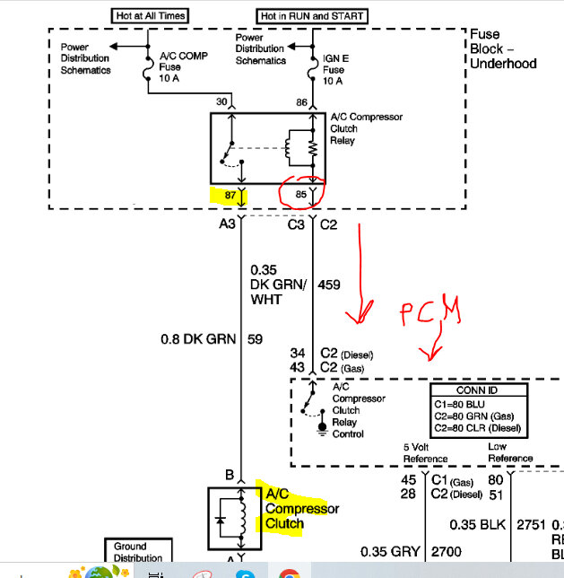

  • 110,244 POSTS

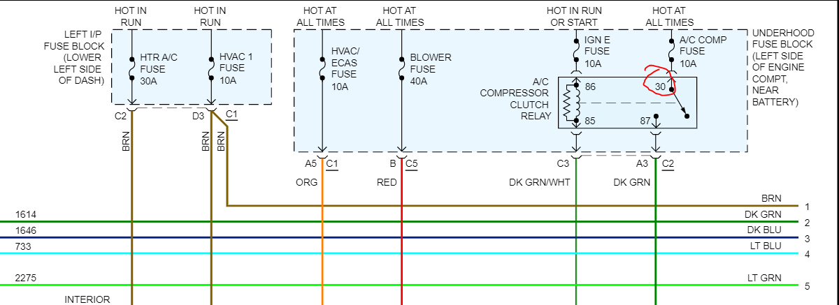

Pin 87 should be power out to the compressor. I dug up the manufacturer's schematics. See pic below. Pin 86 is fused battery voltage and pin 85 is where we should get a ground path from the PCM.
See pic below
Apr 21, 2023 at 3:56 PM
