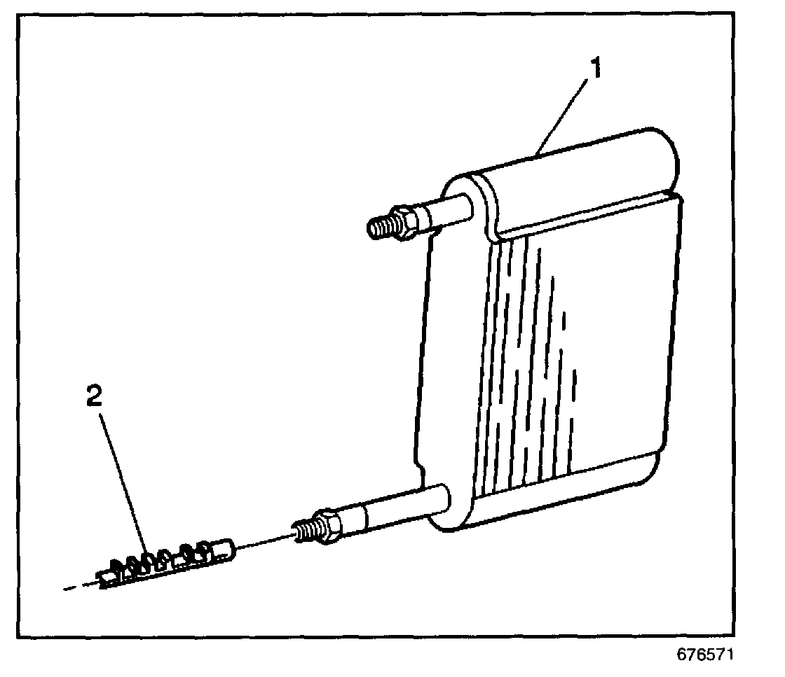

Honestly, something is plugged or you have a bad compressor. My first suspect, like you. is the orifice tube. However, make sure you are using the correct Freon. This is a transitional year. Some R12 was used and R134A. They can not be mixed. Just for curiosity, are you certain that you are hooked to the low pressure side? It will be the larger line.
Did you flush the system? When you say it's evacuated, did you vacuum it? Here is a link that shows how that is done:
Also, here are the directions for replacing the orifice tube:

EXPANSION (ORIFICE) TUBE REPLACEMENT
TOOLS REQUIRED
^ J 26549-E Orifice Tube Remover and Installer or Equivalent
^ J 39400-A Halogen Leak Detector
REMOVAL PROCEDURE
pic 1
1. Recover the refrigerant from the system. Refer to Refrigerant Recovery and Recharging.
2. Remove the evaporator tube from the evaporator (1).
3. Remove the O-ring seal and discard.
4. Use the J 26549-E in order to remove the expansion (orifice) tube (2).
5. If you have difficulty removing a restricted or plugged expansion (orifice) tube, use the following procedure:
5.1.Remove as much of any impacted residue as possible.
NOTE: If the system has a pressure switch near the expansion (orifice) tube location, it should be removed prior to heating the pipe to avoid damage to switch.
IMPORTANT: DO NOT overheat the pipe.
5.2.Carefully apply heat with a heat gun (hair dryer, epoxy dryer, or equivalent) approximately 7 mm (0.25 in) from the dimples on the inlet pipe.
5.3.While applying heat, use the J 26549-E or equivalent in order to grip the expansion (orifice) tube.
5.4.Use a turning motion along with a push-pull motion in order to loosen the impacted expansion (orifice) tube.
Remove the expansion (orifice) tube.
INSTALLATION PROCEDURE
IMPORTANT: Install the shorter screen end of the expansion (orifice) tube into the evaporator first.
pic 1
1. Use the J 26549-E in order to install the expansion (orifice) tube (2).
2. Coat the new O-ring seal with 525 viscosity refrigerant oil.
3. Install the new O-ring seal.
NOTE: Refer to Fastener Notice in Service Precautions.
4. Install the evaporator tube to the evaporator (1).
Tighten
Tighten the evaporator tube to 28 N.m (21 lb ft):
5. Evacuate and recharge the A/C system. Refer to Refrigerant Recovery and Recharging.
6. Leak test the fittings components using the J 39400-A.

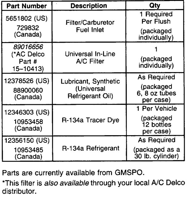

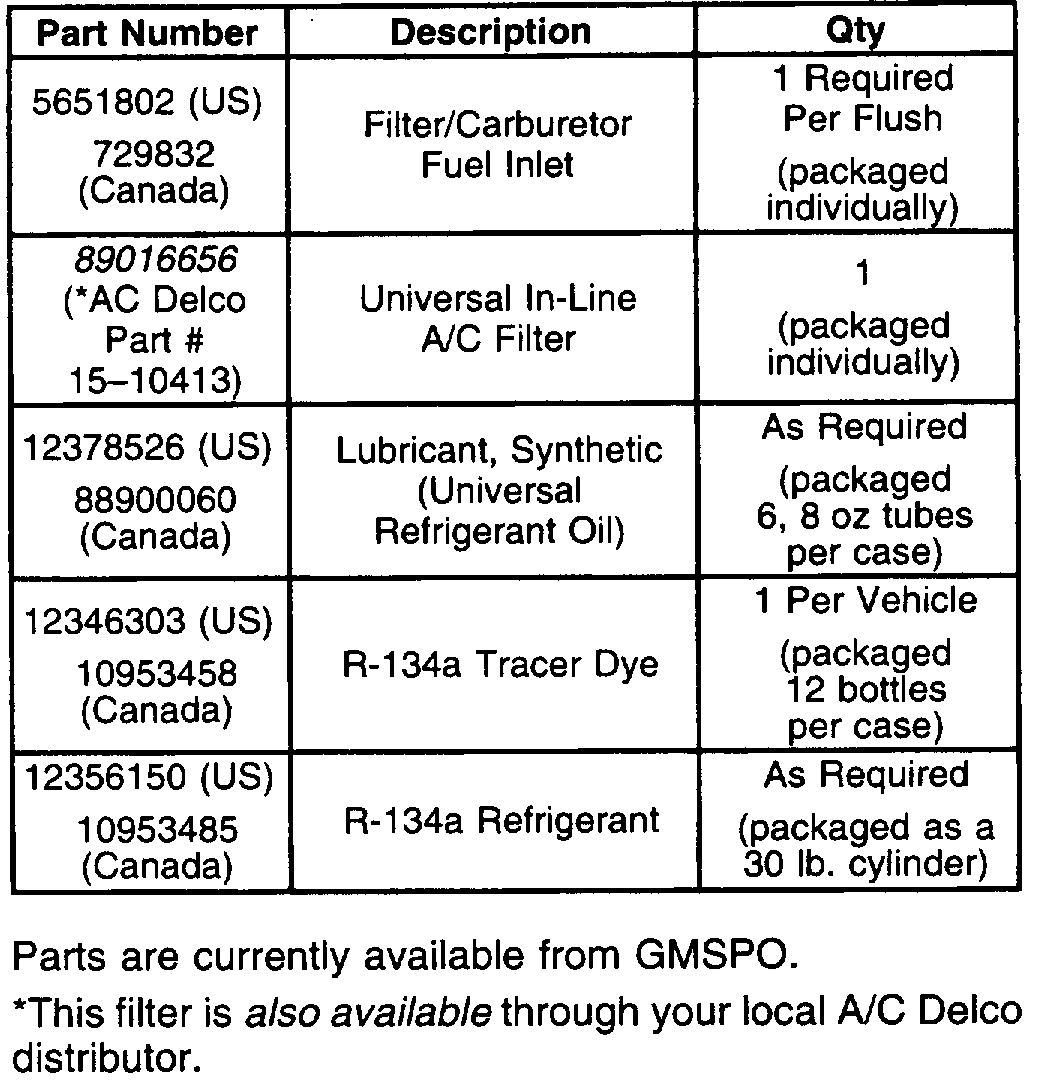

I don't know if you want them, but here are the directions for flushing the system, which may be a good idea since there was bearing damage.

14. Install a Universal In-line A/C Filter, P/N 89016656 (AC Delco P/N 15-10413). Refer to the instruction sheet included with the filter for detailed installation instructions. Re-install the suction screen if it was previously removed.
15. Look up the required amount of A/C system lubricant for the vehicle being worked on. Refer to the System Capacities table in the appropriate section of SI. Remember that after a system flush there is no lubricant in the A/C system.
16. Install the proper amount of Synthetic Lubricant (Universal Refrigerant Oil), P/N 12378526 (in Canada, P/N 88900060), into the A/C system using the J 45037 Oil Injector.
17. Add one bottle of J 41447 R-134a Tracer Dye, GM P/N 12346303 (in Canada, P/N 10953458), or the equivalent, using the J 41459 dye injector (or the equivalent).
18. Evacuate the A/C system.
19. Recharge the A/C system to the proper charge level specified for that vehicle's A/C system.

I believe JACOBANDNICKOLAS is on to something with having a plug system. Also to add to it. When replacing anything with the A/C system you cant just add freon to the system. You need to pull a vacuum to get all the moisture out before you charge it back up. If you do not vacuum out the system it would be just like a cooling system with an air pocket and overheat.
Unfortunately you may need to buy a vacuum pump or have a shop install the the A/C machine to do this. But I would recommend you replace the orifice tube and the drier before doing this. Maybe even have the system flushed as well. Once a compressor fails the whole system gets contaminated.
