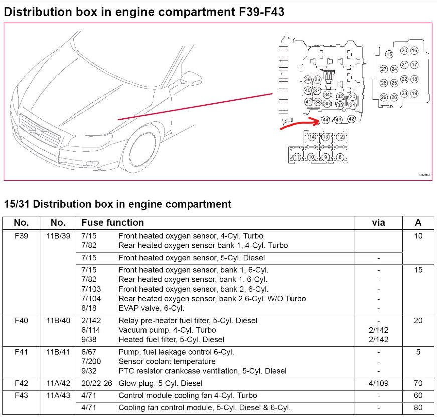

My A/C only blows cold while driving. It gets really cold at highway speeds. Any ideas what it could be? (The coolant fan does come on, so I don't think that's the issue.)
Thanks!
May 27, 2024 at 11:12 PM
  • 55,423 POSTS

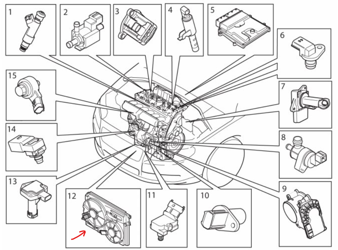

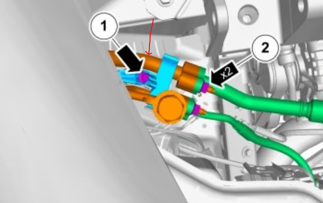

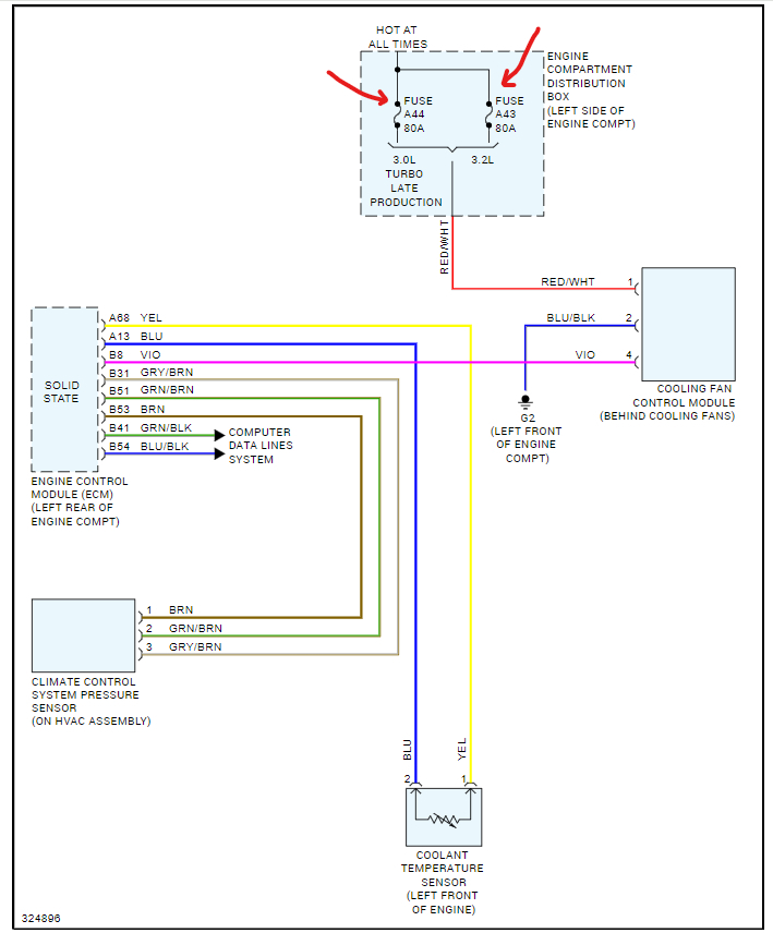

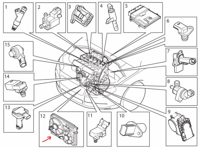

Yep, the cooling fan must run for the air conditioner to work correctly, chances are the cooling fan motor/module has gone out, but we should check the fuses which are under the hood fuse # a44 or #a43 here is a guide that will help and the fuse locations for under the hood. Also, I have included how to swap the radiator cooling fan motor/module out in case you need it. Here are the wiring diagrams for the system as well so you can see how the system works. Check out the images (below). Please upload pictures or videos in your response to any problems so we can see what to help you with.
May 28, 2024 at 3:26 AM
YK16
  • 40 POSTS
I did check and the fan is working but it may only be working the first few minutes the car is on. I will try to figure that out. Thanks

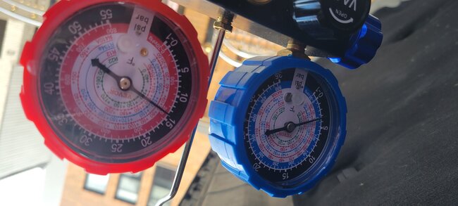

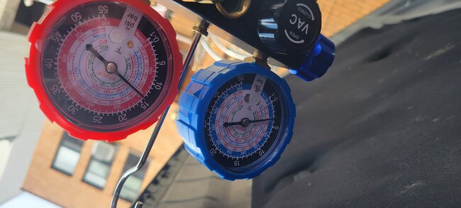

YK16
  • 40 POSTS
Yes, the fan is on. Okay, thanks. I'll try to get a reading.
Jun 23, 2024 at 4:06 AM
YK16
  • 40 POSTS
Temperature outside is 91 degrees.
Jun 23, 2024 at 5:06 AM
YK16
  • 40 POSTS
This is while the vehicle is idling, and the A/C is blowing cold. A/C stops blowing cold while driving.
Jun 23, 2024 at 5:08 AM
YK16
  • 40 POSTS
I just watched the video. Doesn't explain the eratic behaviour of my ac but it's excellent!! Thanks!!
Jun 23, 2024 at 5:47 AM
  • 55,423 POSTS

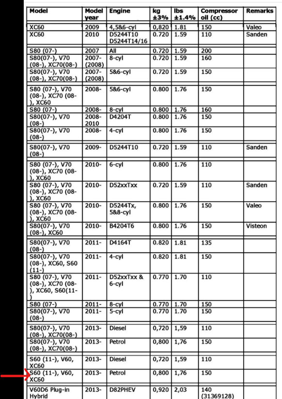

Yep, it looks like the A/C compressor is going out, the high side is too low. How much refrigerant is in the system? There should be 1.7 pounds.

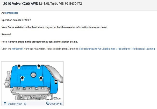

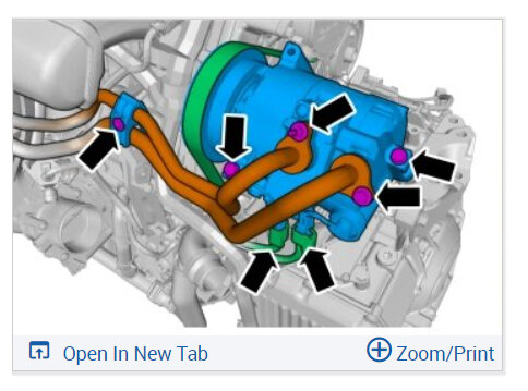

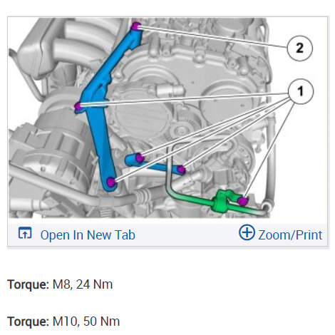

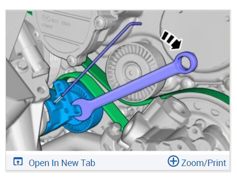

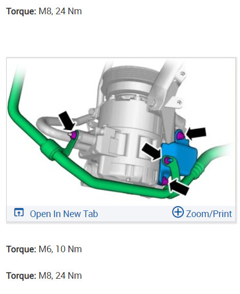

Here is how to change the compressor out with instructions below for your car:
https://www.2carpros.com/articles/replace-air-conditioner-compressor
Check out the images (below). Let us know how it goes.

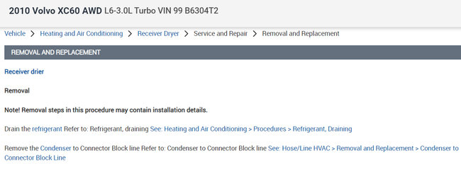

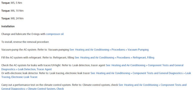

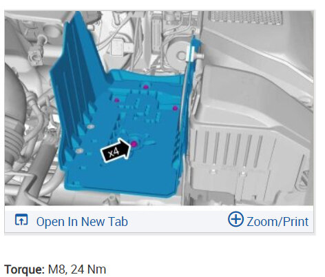

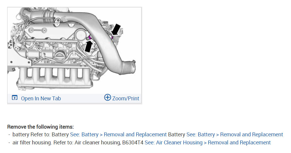

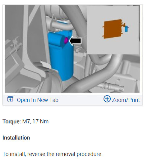

Thanks! Is it important to change the drier of any other components when installing the new compressor?
Jun 24, 2024 at 2:41 AM
  • 55,423 POSTS
Yes, it is, sorry I should have mentioned that. Here is the location, check out the images (below). Let us know how it goes.
Jun 24, 2024 at 3:19 AM
YK16
  • 40 POSTS
Any idea how I get to that?
Jun 24, 2024 at 3:21 AM
YK16
  • 40 POSTS
Replace expansion valve as well?
Jun 24, 2024 at 3:23 AM
  • 55,423 POSTS
Yep, the receiver dryer can be tough to get to, I would open the system after the refrigerant has been removed and see what it looks like, there are two ways a compressor with stop working, messy and not. I other words are the compressor seals spread throughout he system or is the system clean inside, this will determine if you need the expansion block or not. You can upload an image or video of the inside tubes once apart so I can tell.
