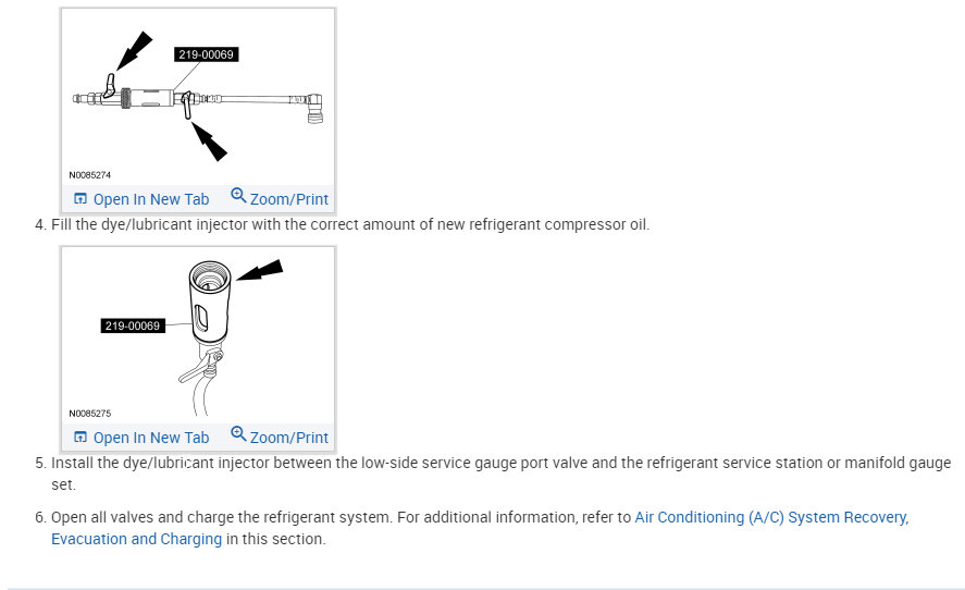

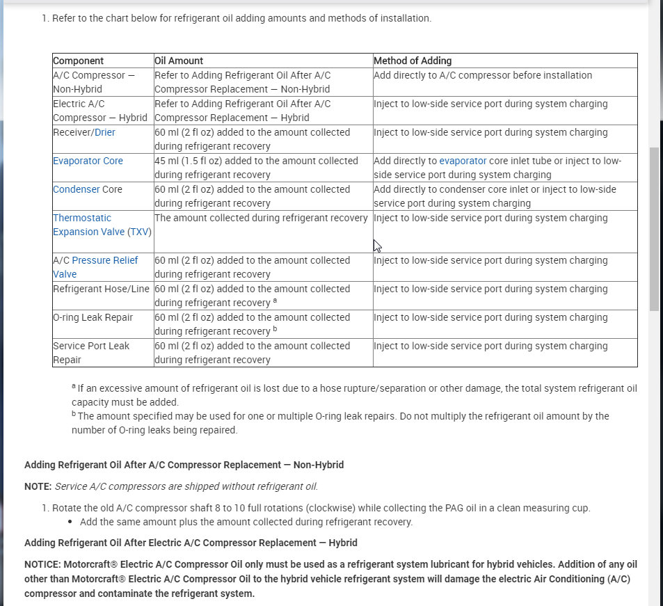

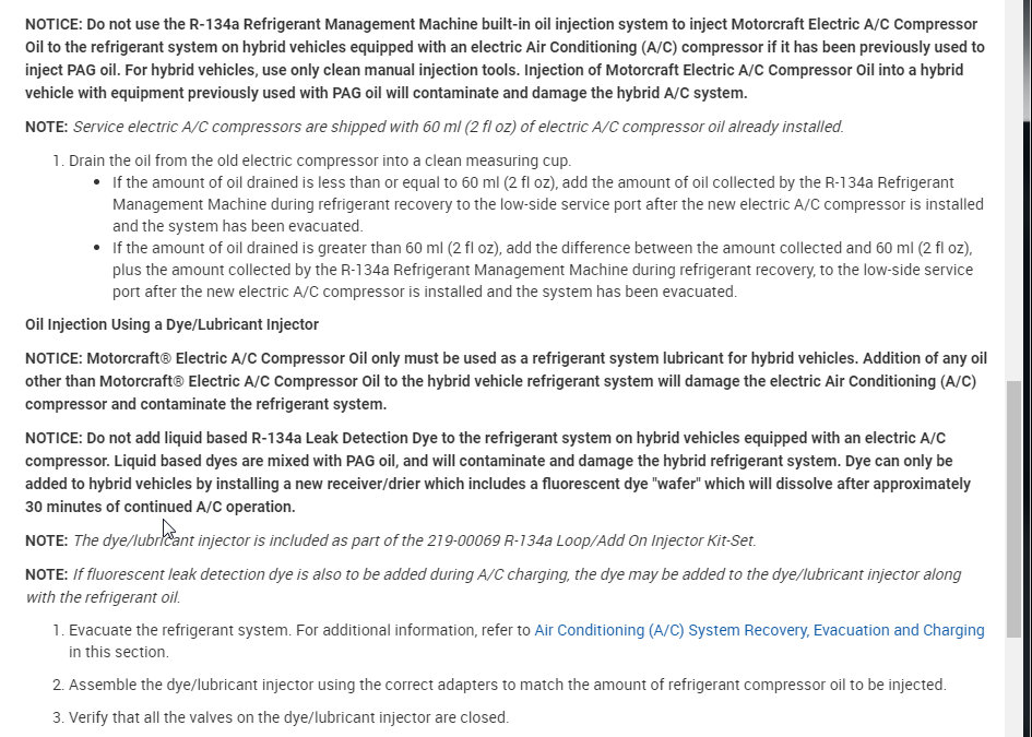

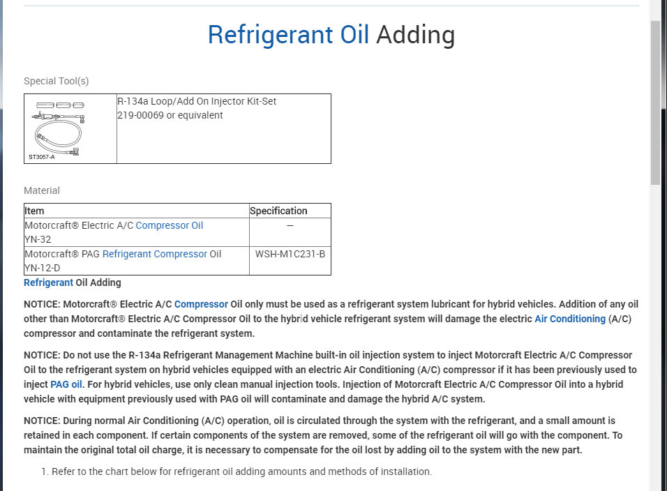

First of all, good job knowing that you need to account for the oil that is in each component. Most people forget that or don't know it and just add some for the compressor or go the other way and add a complete system fill when they only replace the compressor and end up with too much oil.
Here is the process and a chart that lists each component and how much oil to add for it if you replaced it.
Let us know if you have questions. Thanks

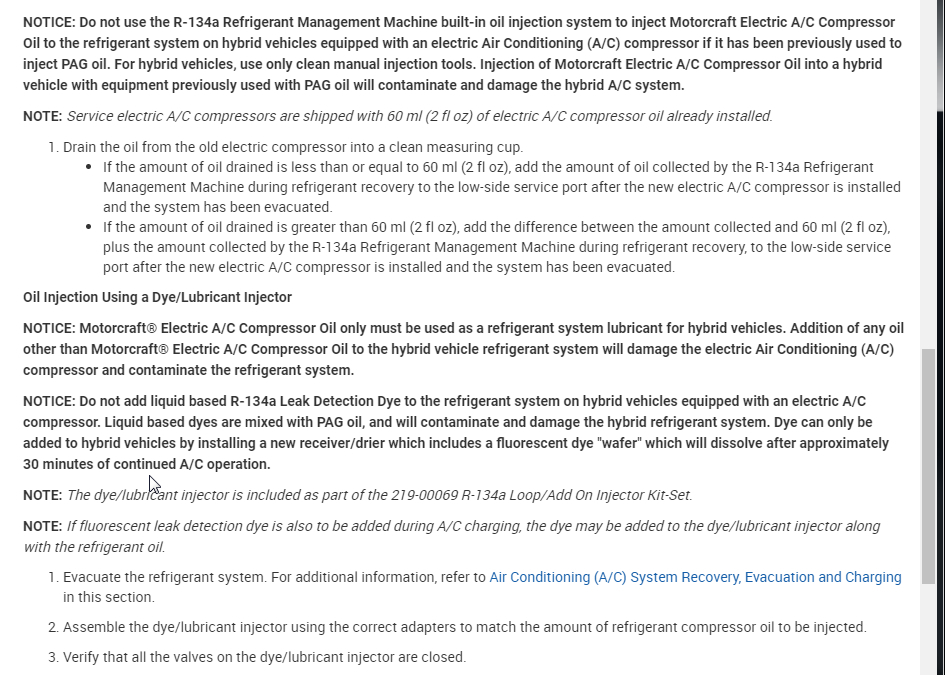

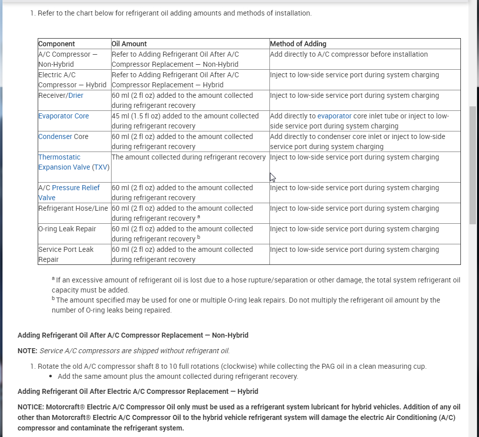

Not sure what happened, but the last attachment is the first page. The other three are in order.
