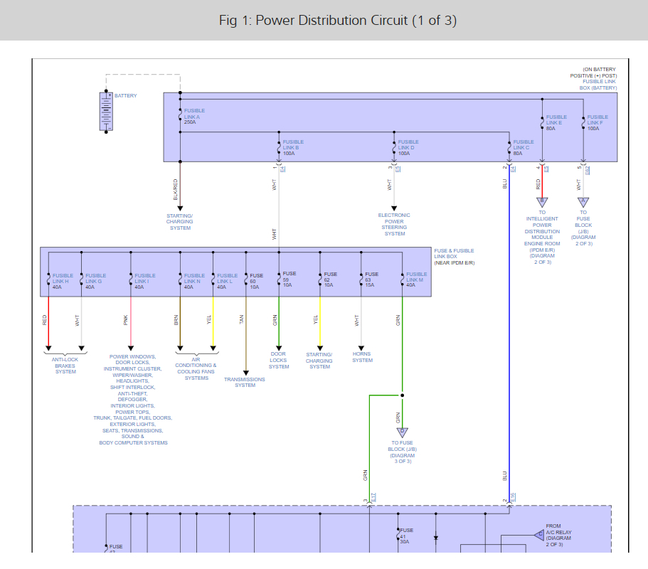

A/C not working and half of fuse box under hood is also not working
2014 NISSAN ALTIMA
150,000 MILES • 4WD
IMDANDAMAN
believe my compressor receives power however, the clutch is not engaging. I have performed the Nissan diagnostic, and everything seemed fine. After testing the power to the A/C fuse, which worked, I noticed that about half of the fuse box was out. I believe this may be why my radiator fan and A/C are not working. I attempted to replace some of the fuses that are out, but i have gotten no success. Please help!

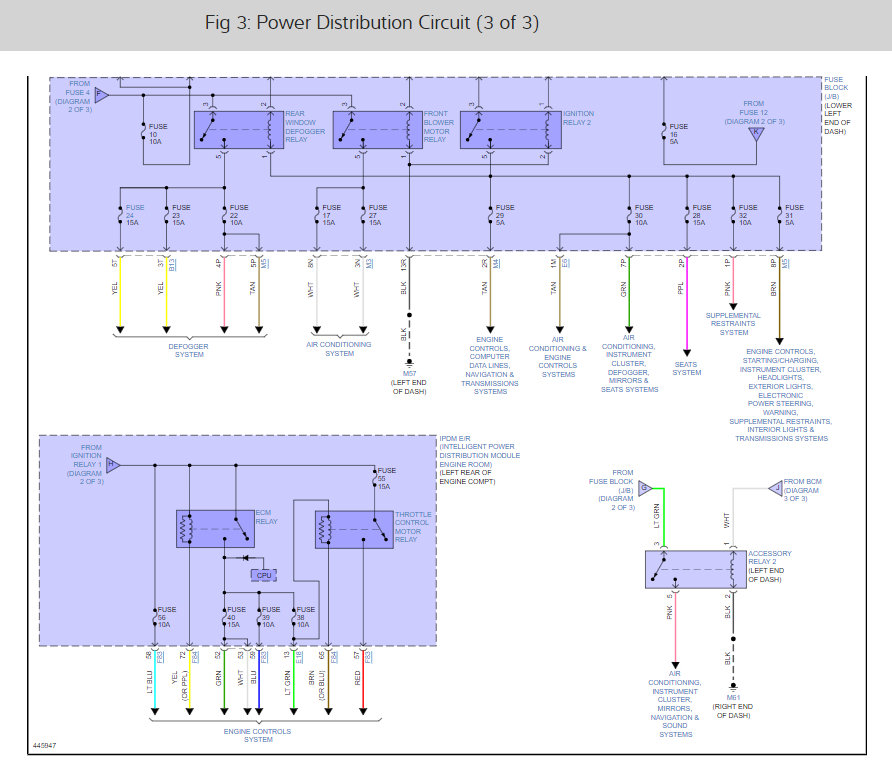

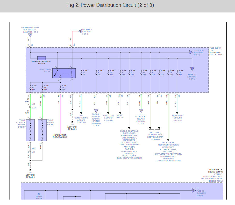

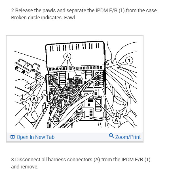

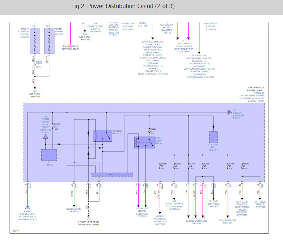

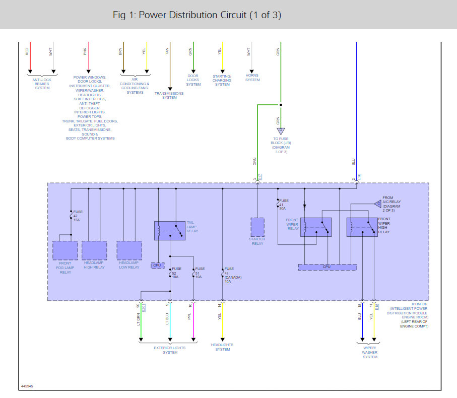

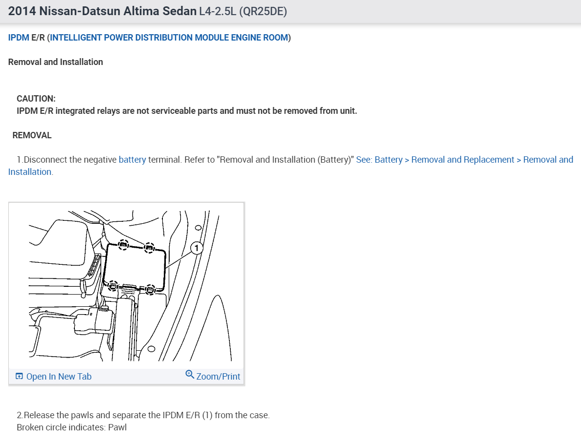

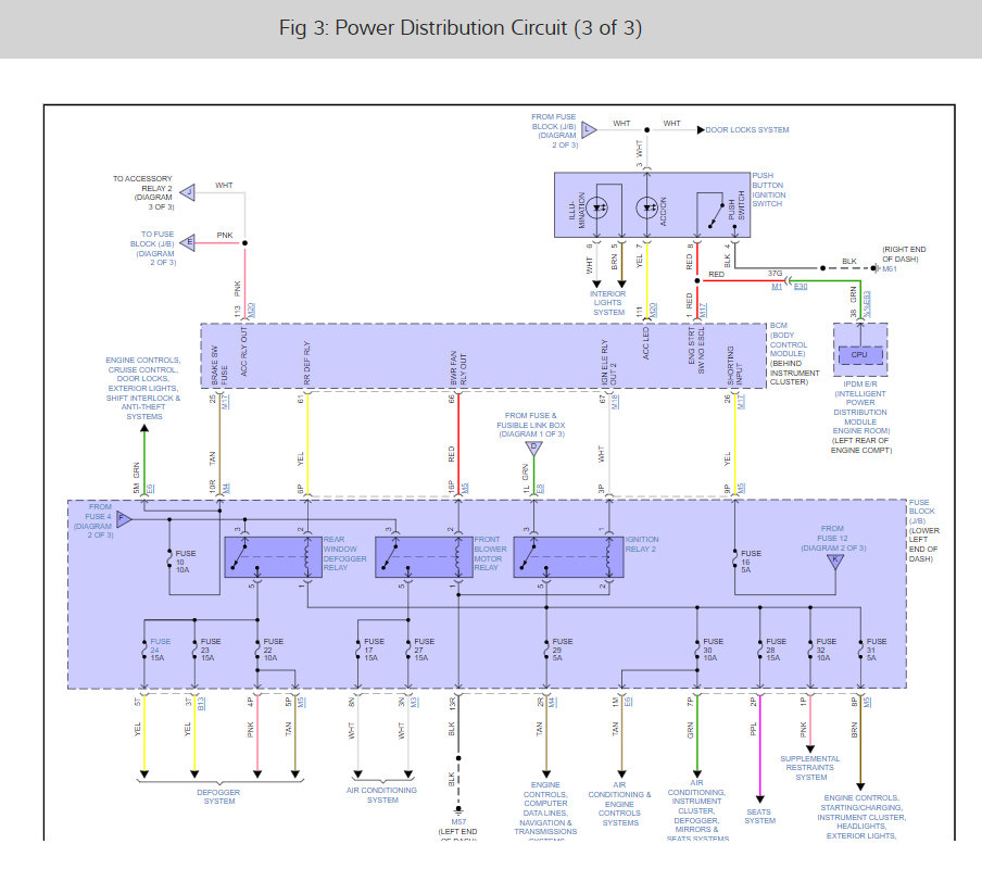

Here are the power distribution wiring diagrams with the fuses that need to be checked first with a guide to help, but I have seen the IPDM go out which is common but to be sure let's do a CAN scan which is the future of automotive repair you can get a CAN scanner from Amazon for about $30.00. here is a video to show you how and a link to a scanner from Amazon. I have included how to change the IPDM out in the diagrams below just in case you need it. It is easy because it-self initializes.
https://youtu.be/u-4syLc-ifQ
and
https://amzn.to/3OpAotj for the scanner
