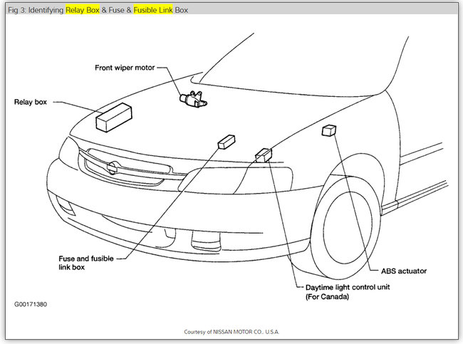

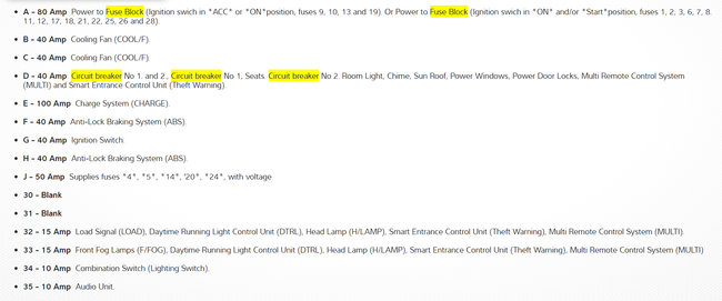

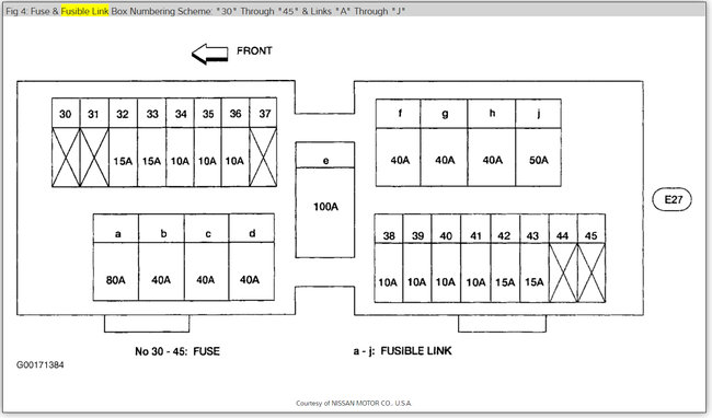

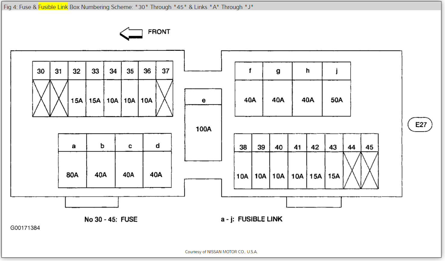

This indicatres a power supply failure.
Main power supply is to Fuse E ( 100 A) in fusible link biox at left side of engine compoartment.
Use a test lamp to test fuse A, B, C and D for battery voltage. If no voltage are available, check Fuse E.

We don't need any pictures yet and I guess we have to get to serious and step by step trouble shooting.
Is battery voltage present at all the fuses A, B, C and D ?

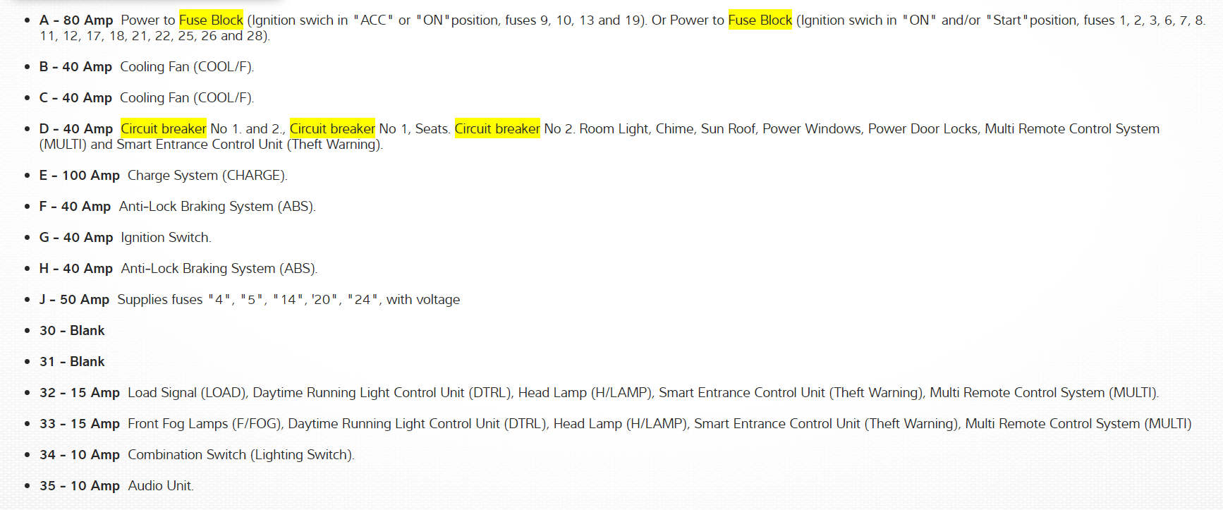

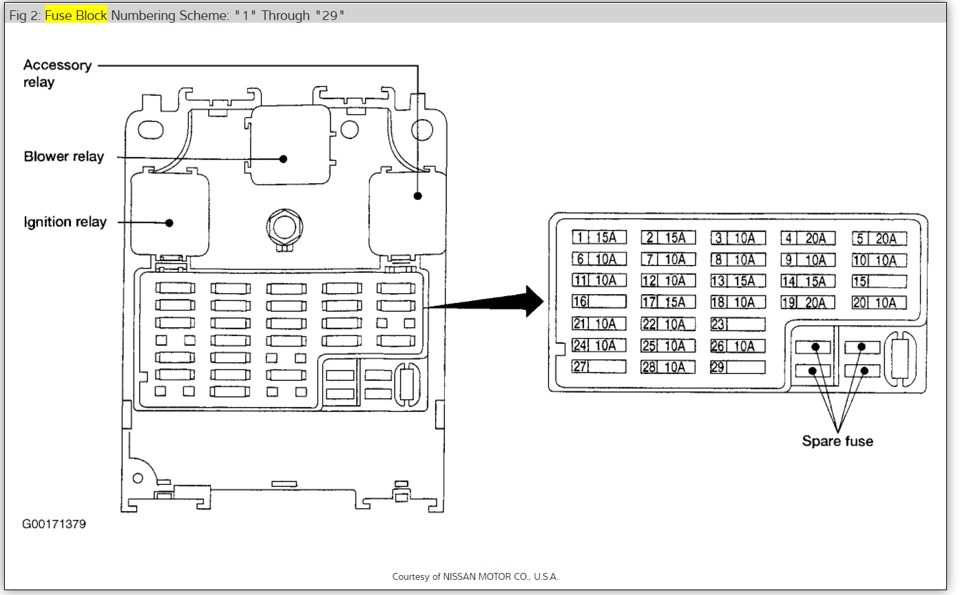

Do you have battery voltage at Fuse A?
At ignition switch, check for battery voltage at the White/Blue wire with ignition switch turned ON.
Do you have battery voltage at Fuse # 1, # 2, # 9, # 10, # 13 and # 19 in underdash fuse box?

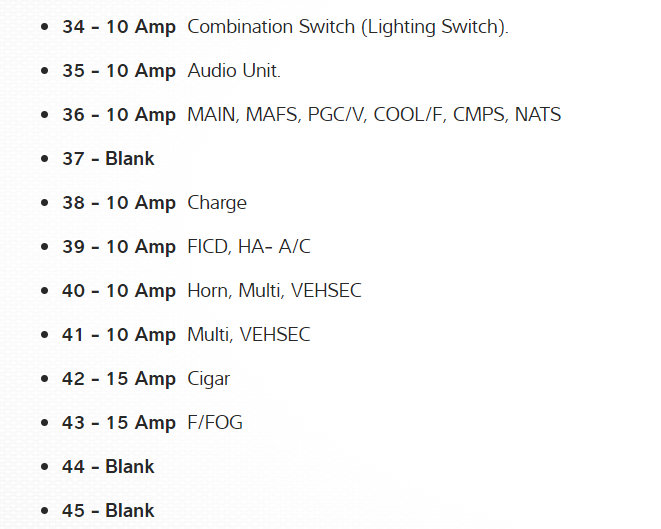

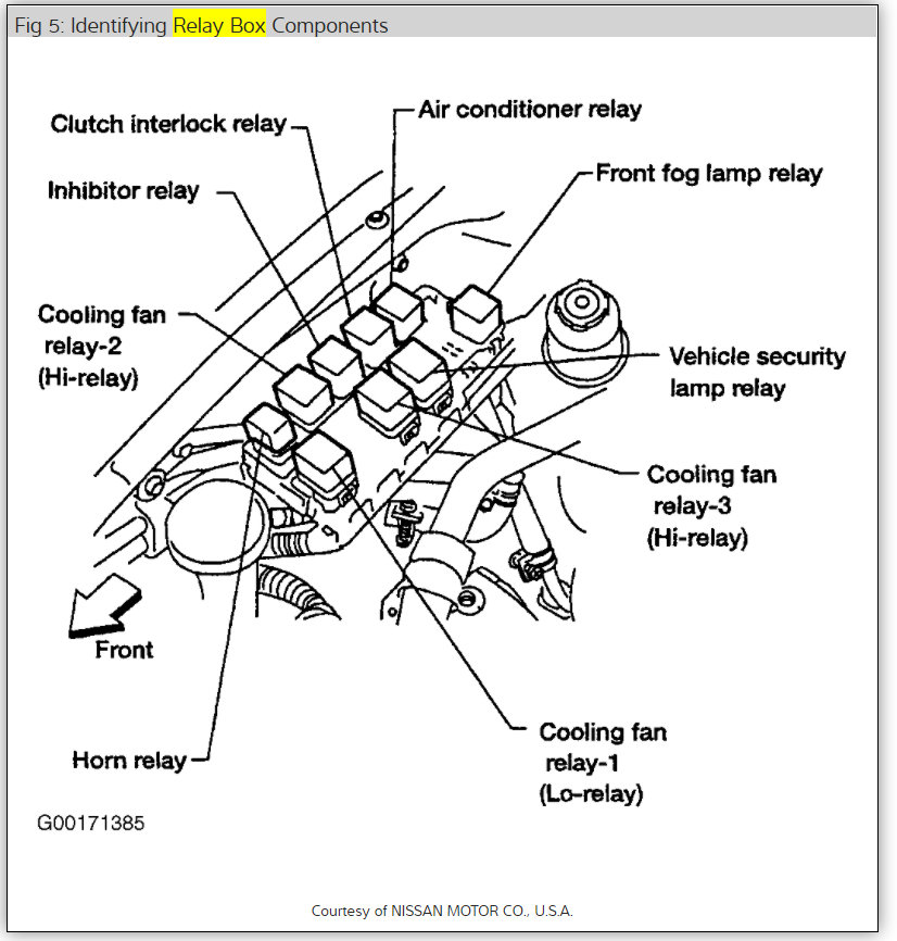

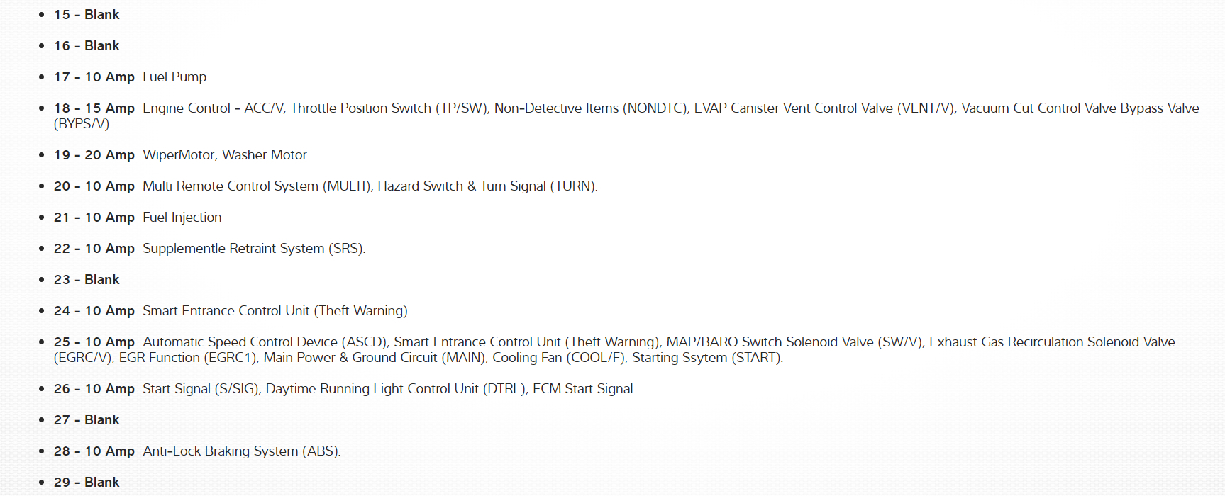

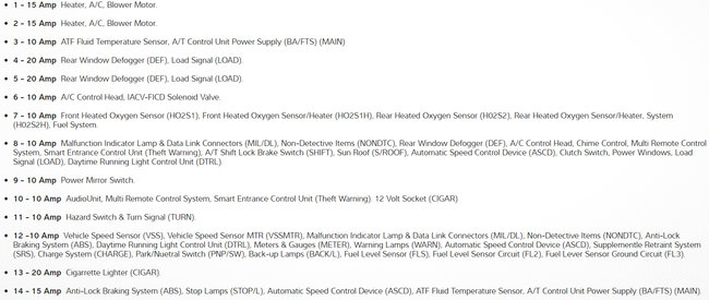

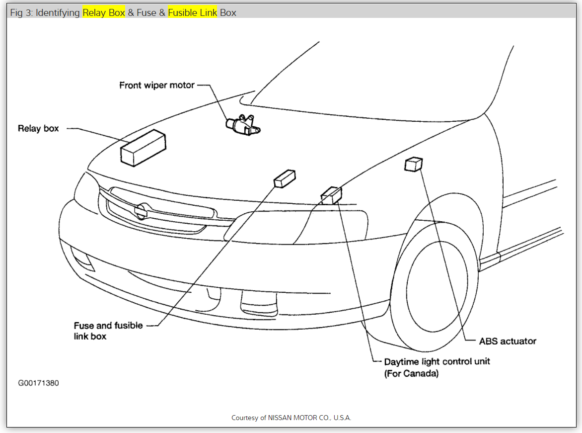

Do you have battery voltage at Fuse # 1, # 2, # 9, # 10, # 13 and # 19 in under dash fuse box?
This guide can help with the fuse locations below:
