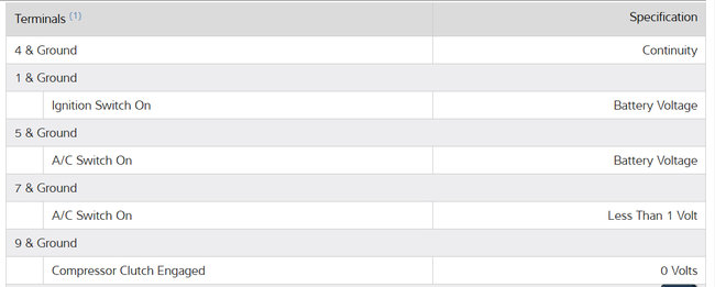

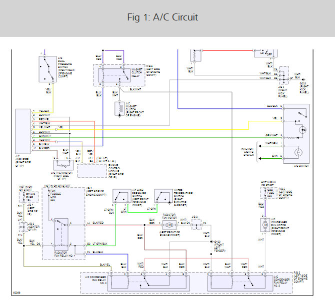

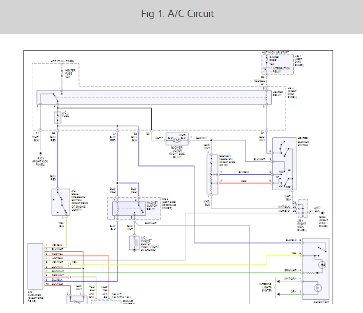

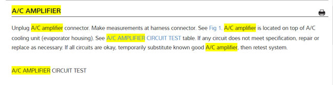

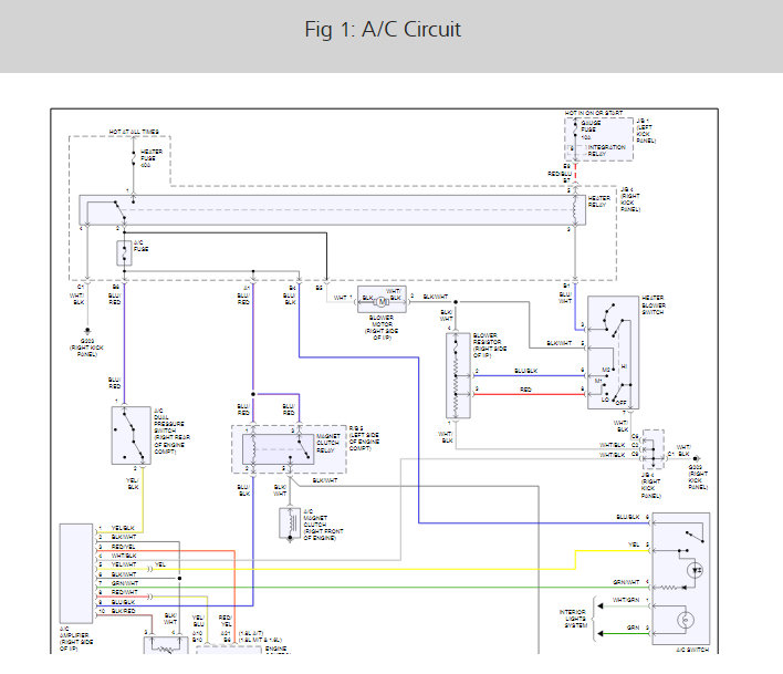

The blower doesn't even turn on. I have put power directly to the motor and it turned on. Fuses seem all good. I hear a relay clicking when I turn the fan on but nothing happens. When I push the A/C button the light does not turn on. I am lost as to what to do next.
Aug 14, 2019 at 12:23 PM
SCGRANTURISMO
  • 4,897 POSTS

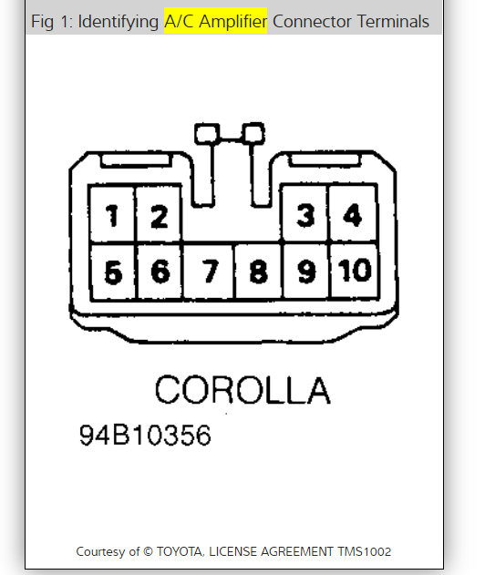

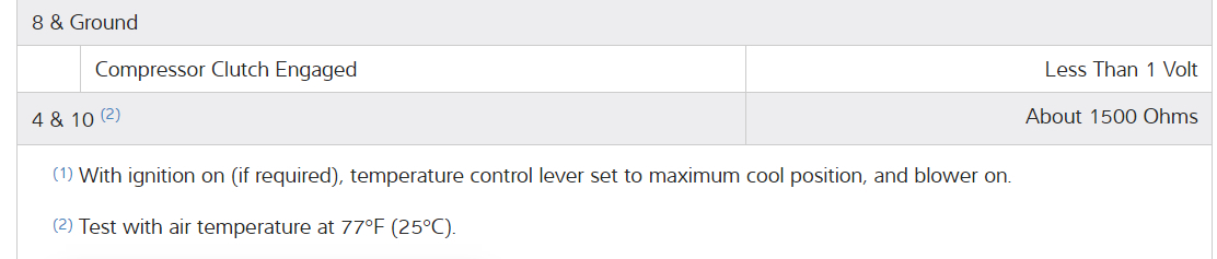

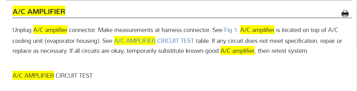

This could be a problem with your vehicle's A/C Amplifier, which is located on the right side of the Instrument Panel. In the diagrams down below I have included your vehicles A/C circuit wiring diagram and the factory diagnostic troubleshooting tests for th A/C Amplifier. Please go through these guides and get back to with what you are able to find out.

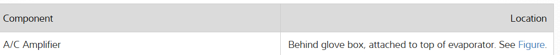

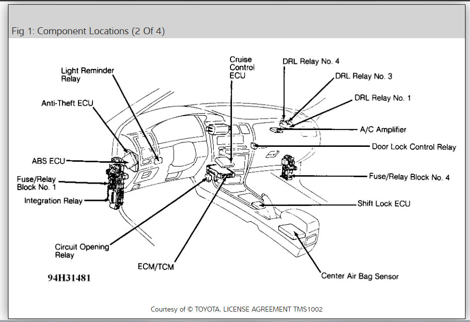

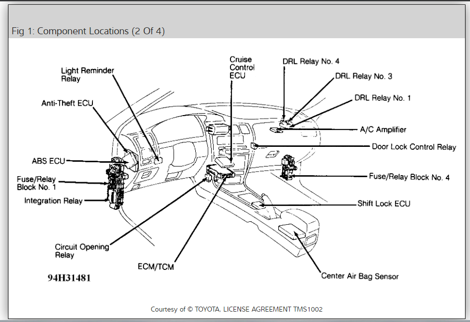

Where exactly would I be able to find the A/C amplifier?
Aug 15, 2019 at 6:31 AM
SCGRANTURISMO
  • 4,897 POSTS
Hello again,
I'm sorry about that, I thought that I had that included in my last reply. It is located behind the glove box on the right hand side of the instrument panel. I have included a diagram for you in the diagrams down below.
