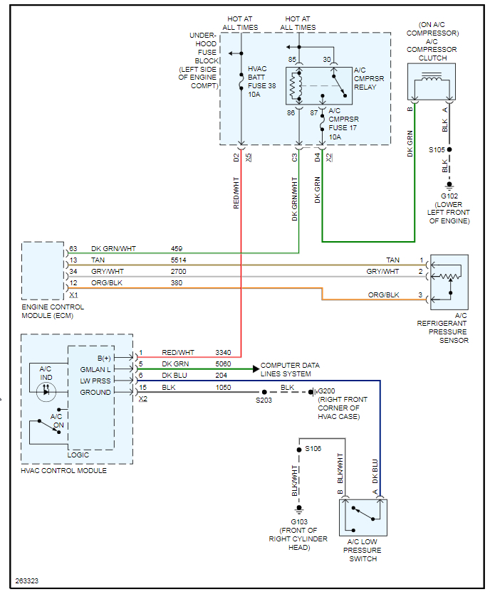

The problem I have now is the A/C compressor is not kicking on. The very next day it was no longer working. The lights just flashes and nothing happens then it stops flashing.
It worked before when the blower was not working. It literally stopped when the resister was replaced.
My husband then tried replacing the low pressure switch, jumped the low pressure compressor (it didn’t start) and it still won t work.
Any ideas?
