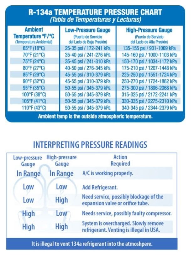

STEVE W.
  • 15,379 POSTS
Okay, you have a very low charge. You should see a pressure like those in the chart with the compressor working. Static pressures should be slightly higher than the temperature when you are testing, So if it's say 75 degrees you should see a static pressure around 78 PSI. That would be with the compressor off. If it's 90 degrees it would be about 95 PSI.

What were the pressures at when you finished? When it shuts off then starts working after setting I would look at the system pressures while running, that somewhat suggests a higher than correct charge as the system will shut off if over pressure than may start working once the pressure has equalized.
Jan 3, 2021 at 10:40 PM
A1953
  • 40 POSTS
225 PSI high side and around 60 low side.. holding steady for 30 minutes with vehicle idling. Pressures dropped when I occasionally turned off the A/C, but I didn't check the exact final static pressures.Weather temperature here was around 80.

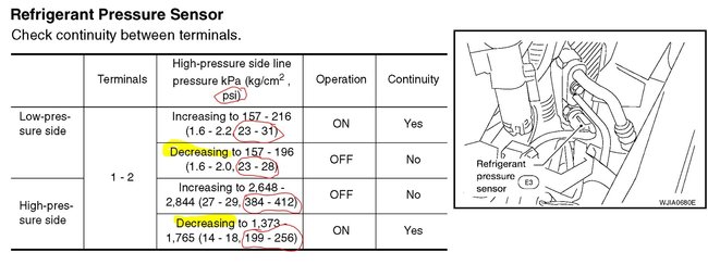

For 80 that's about 15 PSI high and could be the issue if the high pressure cut out is a bit aged. The only way to know for sure would be to run it until it shuts off and then see what the pressures are when it shuts down. Attached are the numbers the switch should operate at. The increasing numbers are where the switch cycles So on the low side the switch turns on at a pressure higher than about 25 PSI and off at about the same The high side will shut off the A/C at a pressure above about 400 PSI and as the pressure drops it turns back on between 200-250. So a weak switch could easily be turning the system off at 350 or so, and it comes back when it drops back below that. But I would check the pressures simply because running them high can easily damage the system.
Jan 4, 2021 at 7:38 AM
A1953
  • 40 POSTS
Okay, thanks! I will get the guages again because it will be good to know. Are you thinking maybe the electrical component of the switch, or likely a sensor replacement that will require another vacuum of the system?
Jan 4, 2021 at 9:55 AM
STEVE W.
  • 15,379 POSTS
I would check the pressures first, it may be that they just need to be lowered a bit to make it work properly. There is also the possibility that it was working too well and iced up the evaporator core, that would trigger the temperature sensor on the core to shut it off until it thawed out. I'm leaning more toward the pressure switch but want you to know the other items that could act that way.

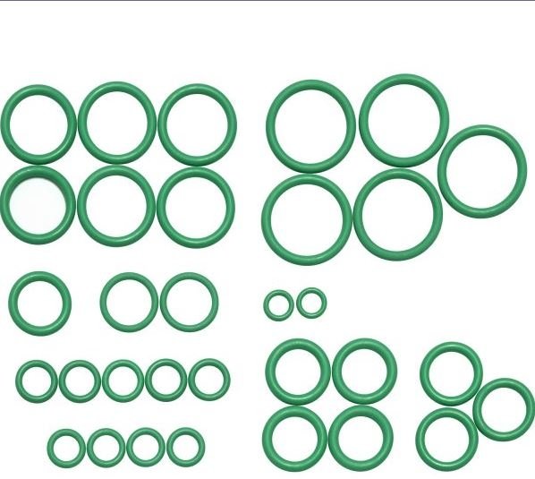

Yep, pretty common in A/C and other systems as well. The way the seals work they can be drawn tighter under vacuum while they still leak under pressure. Or some odd ones like a very corroded condenser core on a Ford a while back, it would leak like a screen door under pressure, but under a vacuum the corrosion would draw into the pitting and flakes and seal.
Similar issue with the o-rings, They get squished into an oval with flat sides, under pressure the sides will act like one way valves and let pressure out, then when you apply a vacuum they will draw into the split line between parts and seal up. Can be frustrating at times. That is why I generally test under both as a vacuum can give you a false result.
Jan 9, 2021 at 12:27 PM
A1953
  • 40 POSTS
That makes a lot of sense. Wish me luck in finding the leak! I am assuming that there are special o-rings for resistance to the chemicals in refrigerant.
Jan 9, 2021 at 12:38 PM
STEVE W.
  • 15,379 POSTS
Yes, but you can usually get kits that include all of the needed ones for a particular vehicle. This is a picture of the kit they sell for your Nissan, lot's of places that can leak. Plus the compressor and other hard parts. It's why I would start with the dye first and then go hunting. Another trick to finding the leak, use compressed air or similar to pressurize the system, then mix up some dish soap and water and spray it all over the parts and look for the bubbles.
