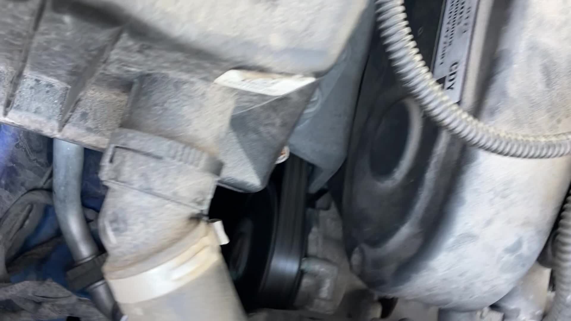

Whenever the A/C or defroster is on and the transmission idling in drive it makes a loud chirping. When I'm driving it's quiet but when i come to a stop and it idles it chirps bad. If you put it in park and the A/C or defroster is on its quiet. Being the a compressor engaged i figured the tensioner wasn't strong enough to handle the load so i replaced the belt tensioner and the chirp still exists. So, when it's in drive and idling and the air on is the only time it acts up. If you rev it up it goes away or if you turn the A/C off, it stops. Would you expect a component of the A/C compressor is failing? Also, the belt was replaced 10,000 miles ago when I changed the timing belt. I'm just confused as to why it happens only in drive with the air on and in park with the air on its quiet.

Is it possible for you to record and upload it for me to hear? I realize the belt isn't old, but what you described sounds like a belt noise. The A/C compressor places a heavy load on the belt. Also, when the defroster is on, the compressor engages.

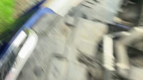

At the 22 second mark you can hear the belt chirp and also a rattling noise as well. Like i said, it only does it when i come to a stop. i can sit in park and it's fine or driving its fine it's only when I'm at a complete stop in drive. in the 2nd video i have it in drive and foot on the brake and just tapping the gas i can make it do that noise.

For some reason, I don't have the time stamp at the bottom of the video. I did listen to both videos several times but didn't hear a chirping noise. I do hear something that sounds like it's vibrating.
If you have a helper start it and place it in gear, open the hood and see if it is louder and upload it for me to hear.

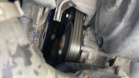

BAT KID
  • 48 POSTS

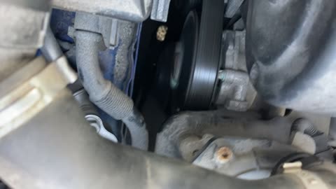

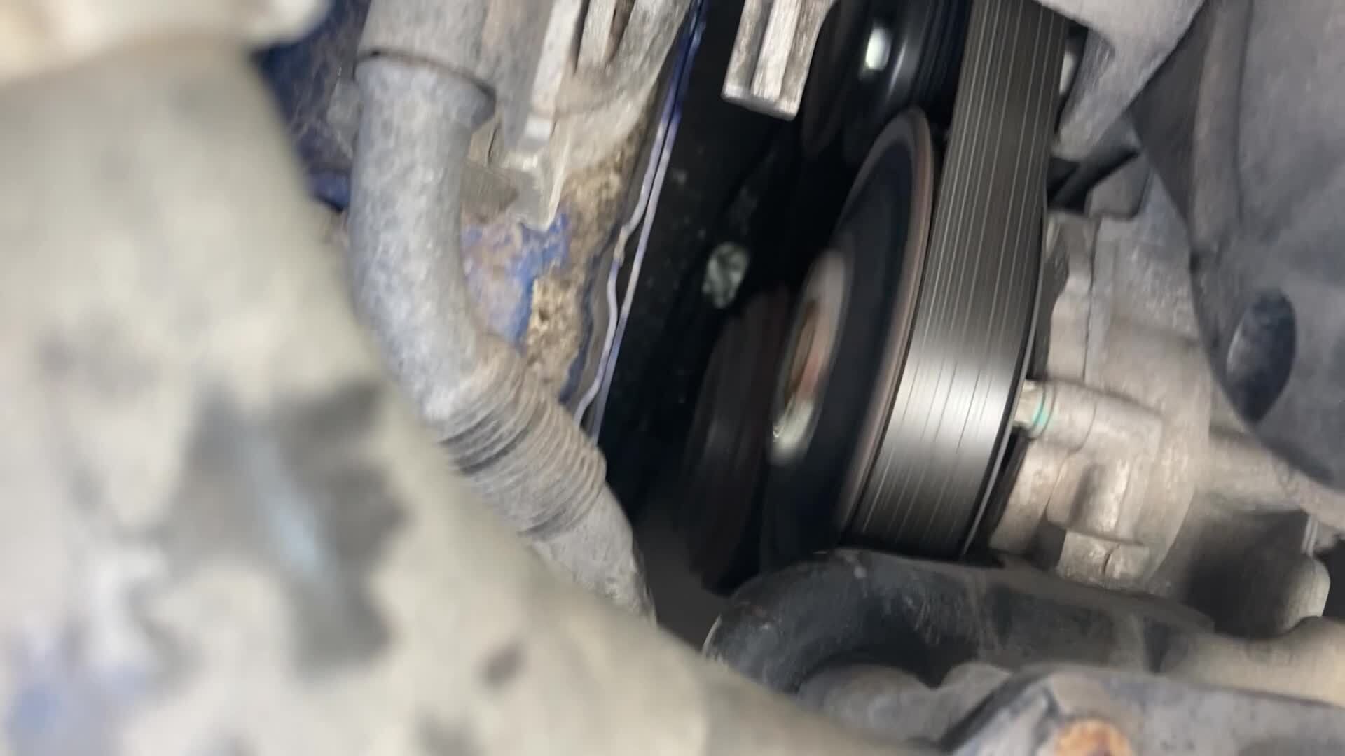

In this video you can really hear it and you can see the tensioner moving. I replaced the belt 15,000 miles ago and the tensioner was replaced a few months ago. Both are Ac Delco parts and i changed the tensioner because i figured it wasn't strong enough to hold tension under the load of the compressor when it was engaged but the new tensioner didn't solve the issue. I'm not sure if the Ac Delco design isn't good enough? These 1.8 tensioners are different than the 1.4 turbo tensioners.

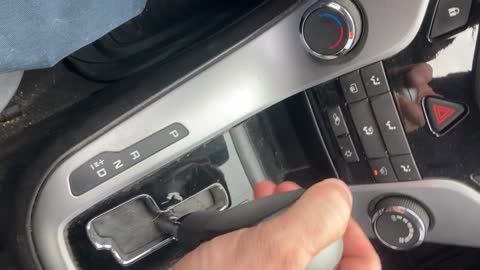

BAT KID
  • 48 POSTS

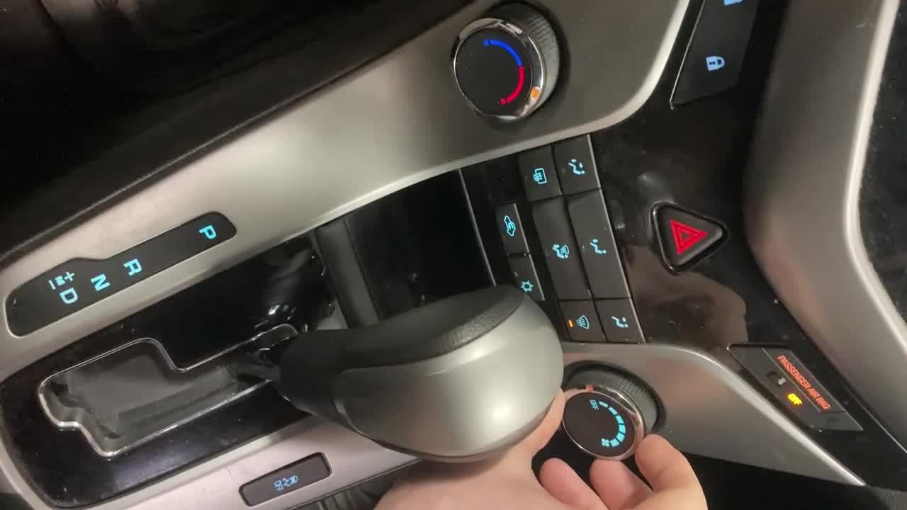

In this video you can hear it happen in reverse or drive but not in park or neutral.

It sounds like the belt. Try this. When it is making the noise, pour a small amount of water on the belt and see if it stops or changes.

BAT KID
  • 48 POSTS

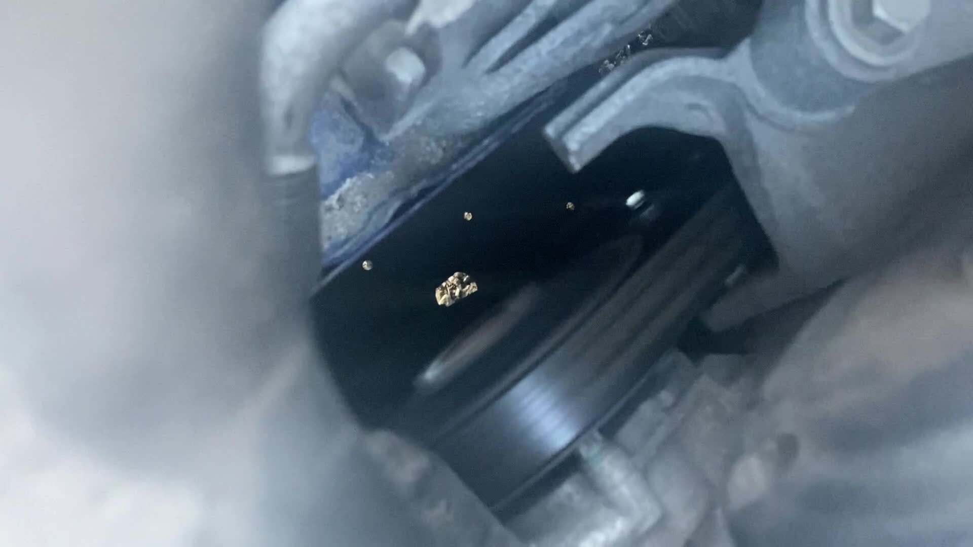

Alright i sprayed the belt with water and there was no change but i had my wife help me and with the ac on and in drive you can in this video I'm attaching the belt starts to vibrate like crazy and the chirp is the belt because it vibrates due to lack of full tension when it's under the load of the compressor. I changed the tensioner 4,000 miles ago with the ACDelco OEM tensioner. In the video when it starts chirping bad you can see the belt vibrating like its losing tension.

It could be the belt, the tensioner, or the compressor. Has anyone added Freon to it recently? If it is overcharged, this can happen. However, I did notice the belt tensioner in an earlier video you sent jumping around. Also, is this the correct one for the vehicle? The OEM part number should be 25191534.

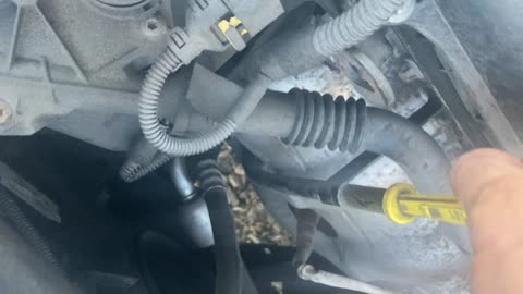

BAT KID
  • 48 POSTS
With the car running and A/C on i pull the oil dipstick out and I hear a hissing in the back of the engine and then it triggers the engine to struggle and the chirping. With the A/C off and dipstick pulled it'll do the same hiss and engine hesitation but no belt chirp. I don't know if that means anything more or just shows that's a load on the engine like a compressor creates.

  • 110,244 POSTS
I suggested the PCV because when you remove the dipstick, the sound returned. It seems like that is lowering the RPMs and causing the noise. It's just a theory. When you remove the dipstick, it is allowing fresh air to enter the crankcase. With the dipstick removed, is there a strong vacuum at the dipstick tube?

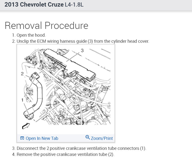

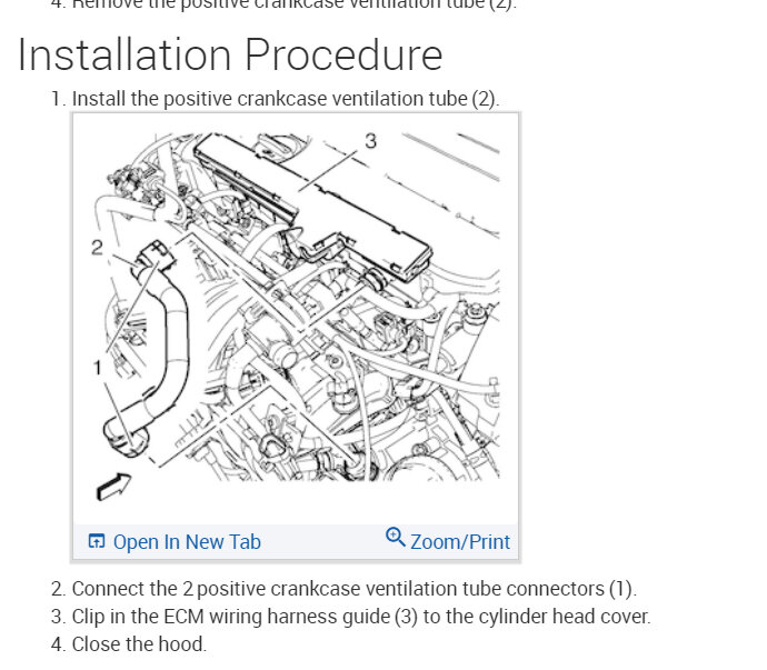

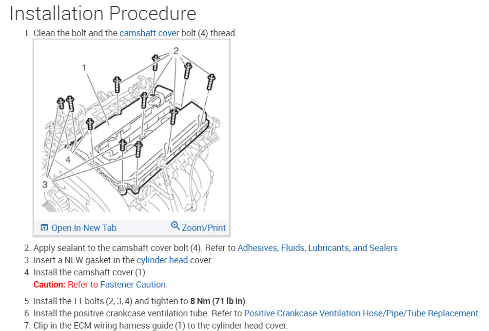

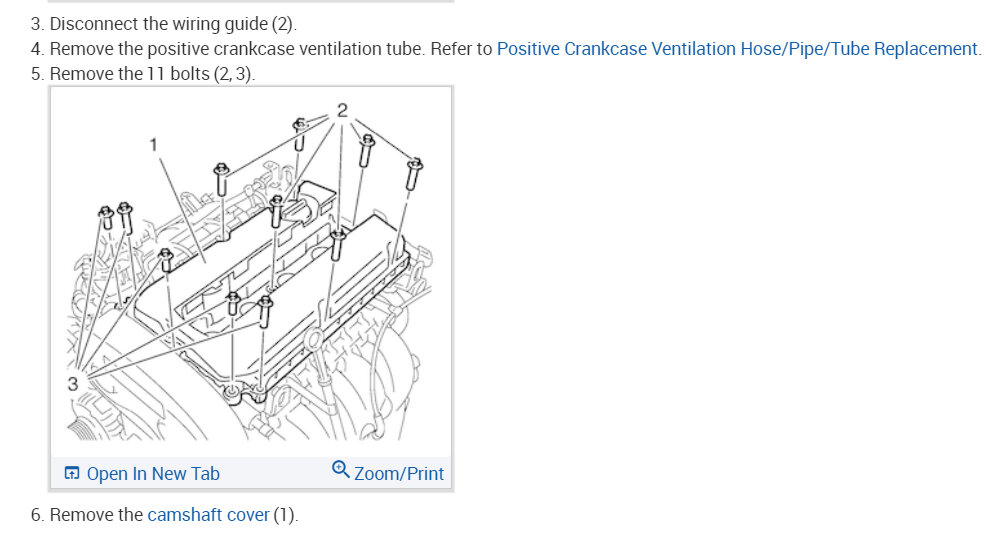

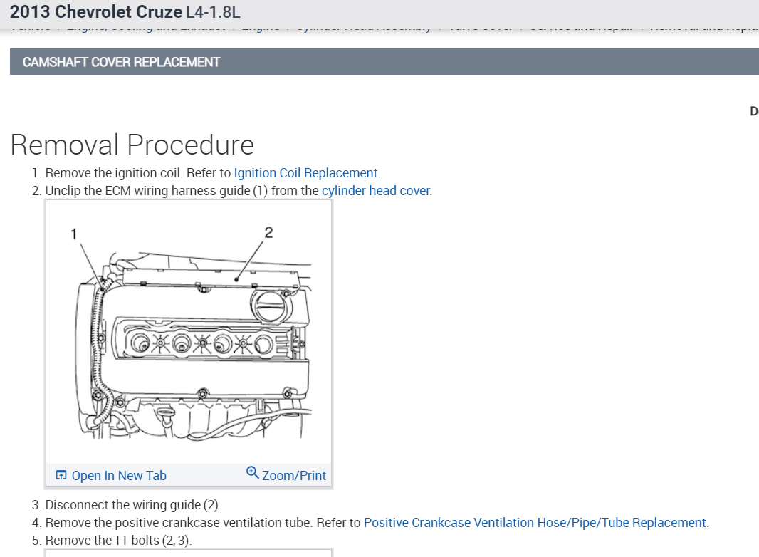

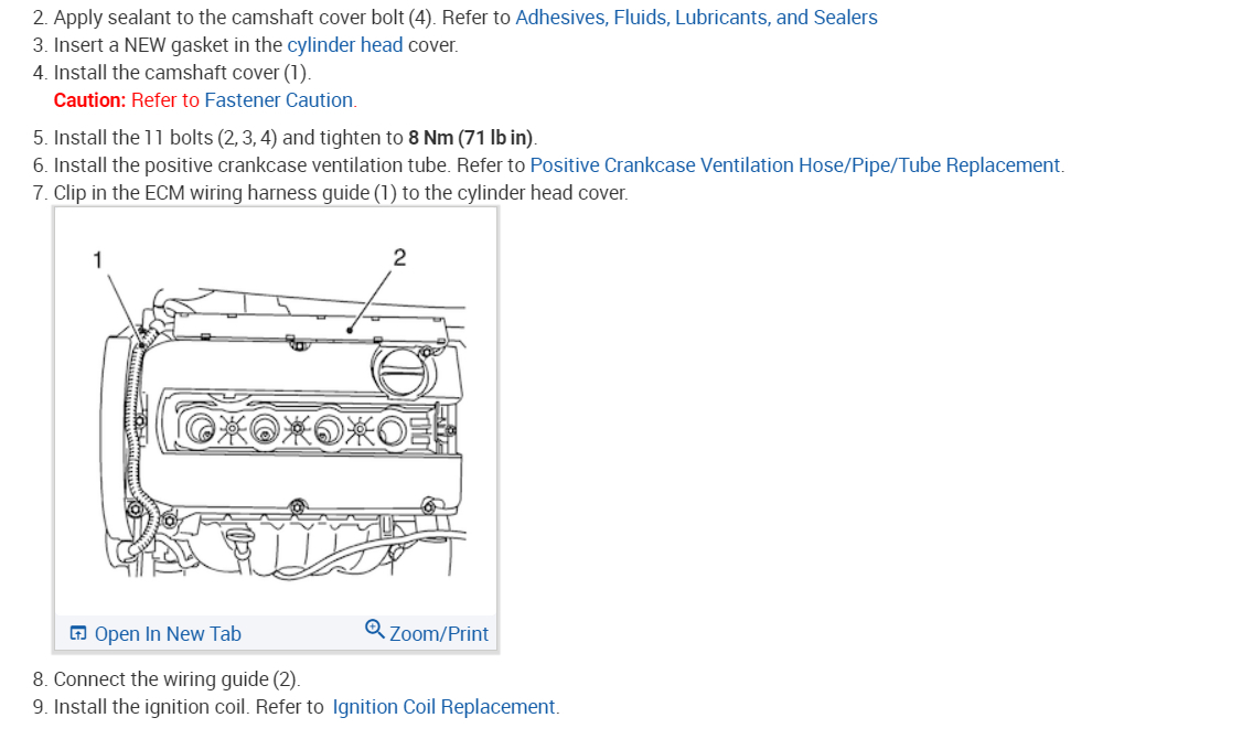

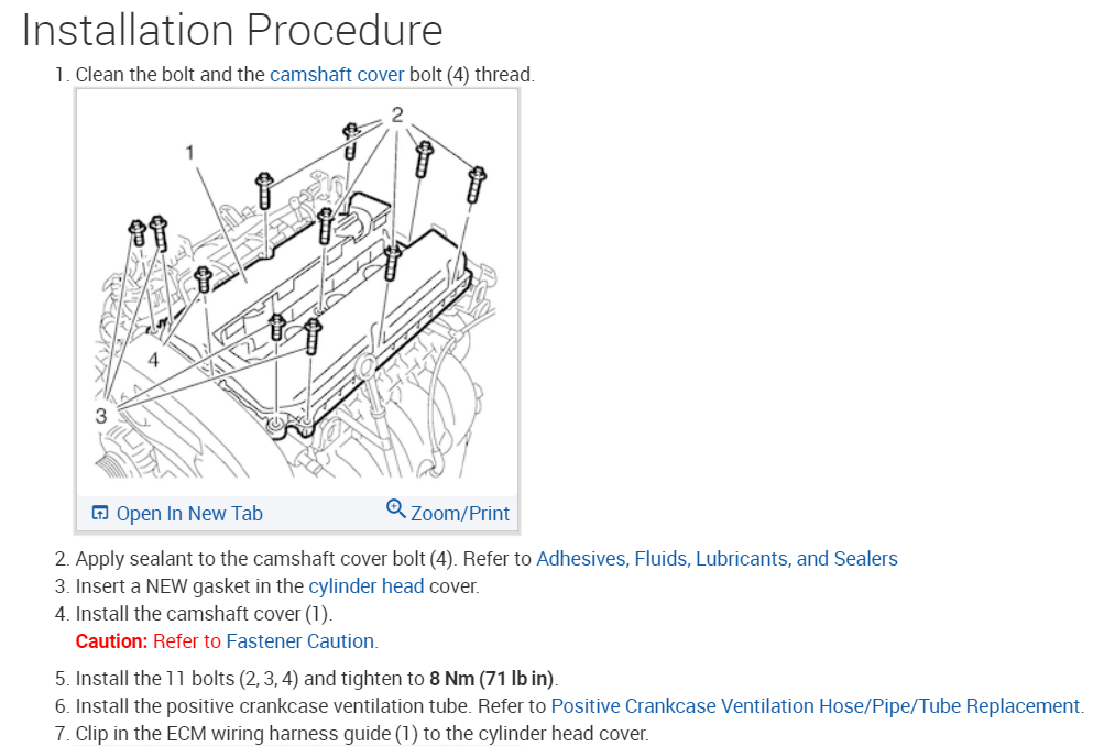

  • 55,433 POSTS

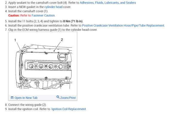

Yep, this happens when the valve cover needs to be replaced because the crankcase ventilation diaphragm has gone bad and creates an internal vacuum leak inside the engine. Here is how the job is done to fix the problem. Check out the images (below). Please let us know how it goes.

BAT KID
  • 48 POSTS

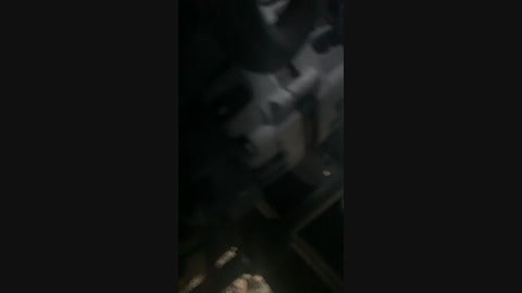

I just installed the new valve cover GM #55564395(new part #96889998), and the issue still exists unfortunately. I am attaching 2 videos.

BAT KID
  • 48 POSTS
Today at the shop we saw the tensioner bouncing causing the belt to shake and squeal so we took a socket and ratchet and gave the tensioner a little more tension on the belt and turned the A/C on and put it in drive and even tapped the gas. It stops when you give the tensioner more tension so i guess the new tensioner i put on it months ago is defective. and or the new belt i put on months ago before then is stretched? Both are ACDelco OEM parts so I'm kind of confused but i guess I should change them again or warranty them out or try different brands?
Jul 20, 2023 at 12:19 AM
BAT KID
  • 48 POSTS
Problem solved. i had an ACDelco 6k609 belt on it because rockauto said it works with A/C. I looked up on Chevrolet parts website and it calls for a gm55578115. Rockauto doesn't show that number as a cross reference when you select the 6k609. I bought a continental 4060610 which crossed to that 55578115….Delco 6k609 says its 61 1/2” and the 55578115 says its 61” so i guess i had the wrong belt on my car and I'm not sure why rockauto lists it as an option or why there is 2 different sizes that close in range for a with A/C option.
