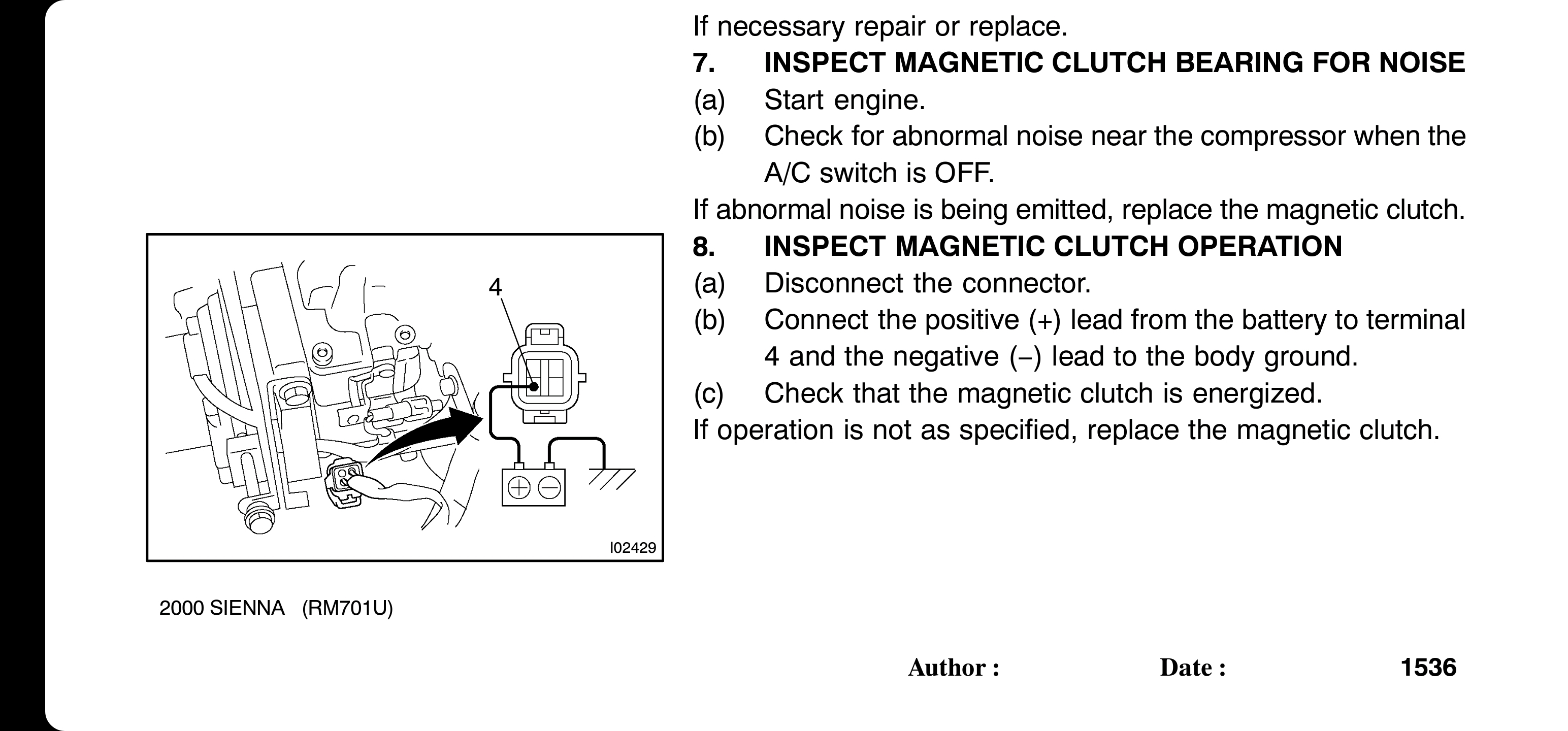

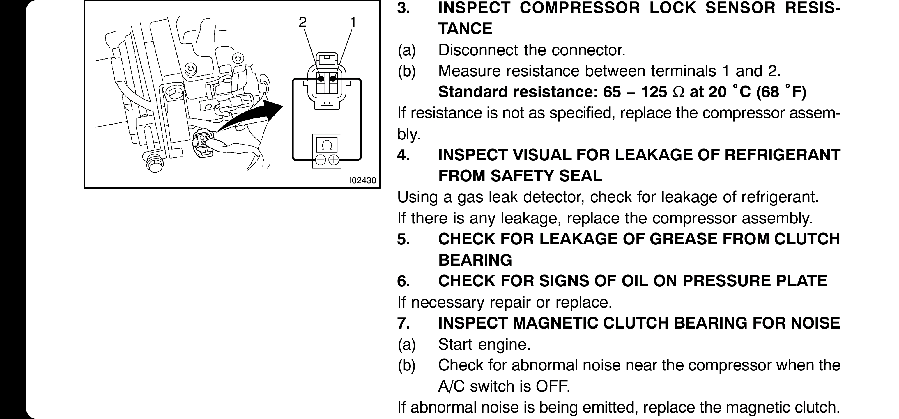

A/C runs for 2 minutes, then the A/C compressor clutch disengages, and the light starts to blink. I've checked all fuses and relays, all are good. With the vehicle off not running the A/C compressor speed sensor ohms are 105. I can't find anywhere as to what it is supposed to read. Also, the outside air temperature is 75°.
Jun 10, 2022 at 5:36 AM
JIS001
  • 3,412 POSTS

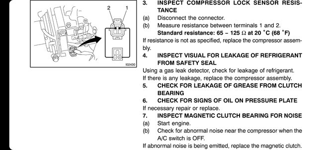

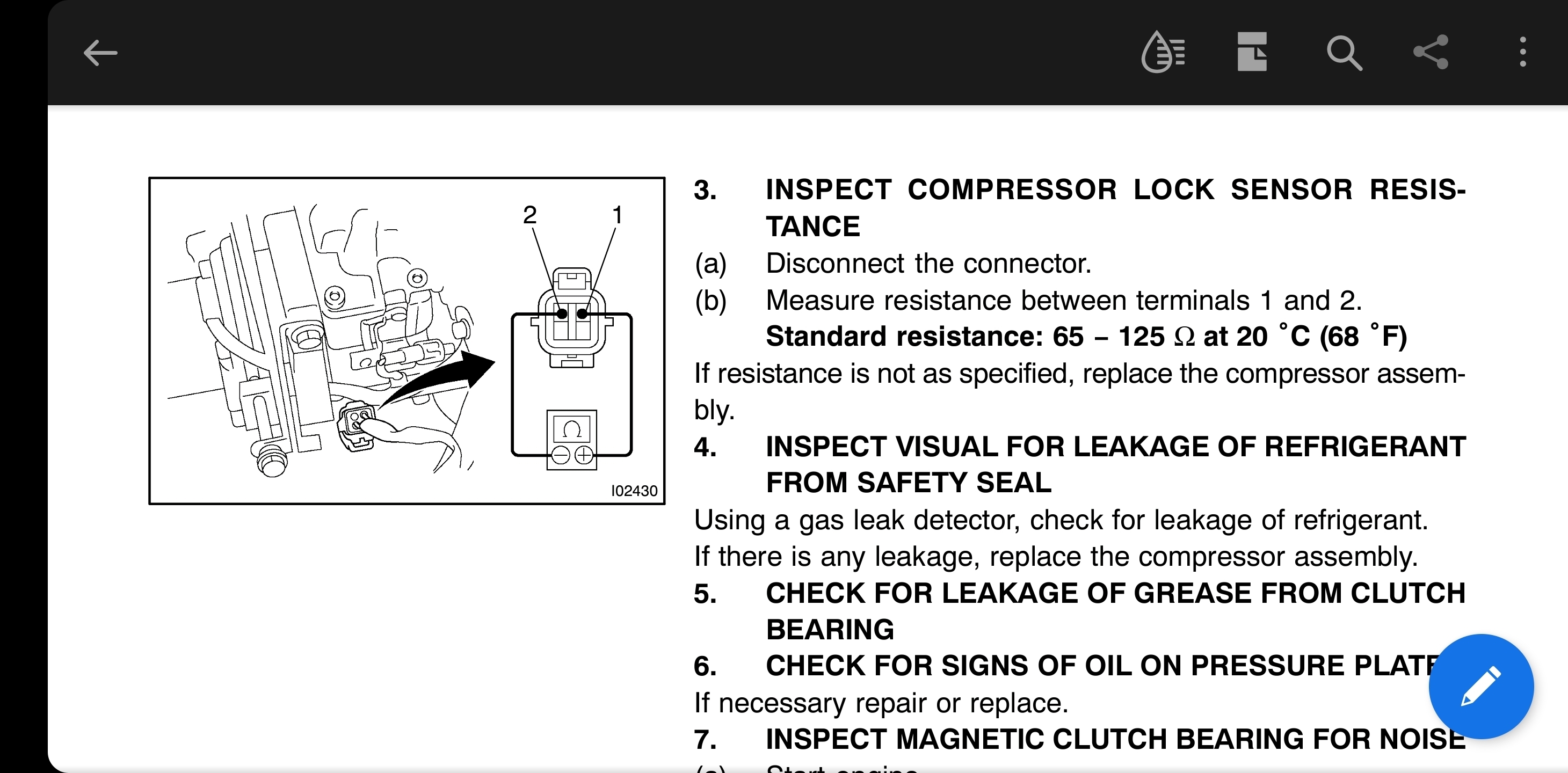

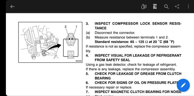

Hello. I think you ohmed out the compressor lock sensor. See image below and I hope this is what you were searching for. Let us know if this helped.
Jun 10, 2022 at 3:01 PM
RODNEY7867
  • 70 POSTS
Yes, that's what I homed. Can't seem to figure out why A/C light keeps flashing.

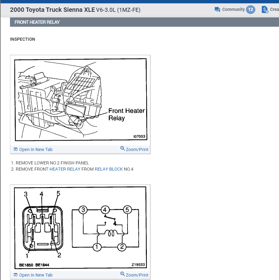

You may want to start with replacing the magnetic clutch relay as a first step. The contacts could be opening up once the engine bay gets warm.
Jun 15, 2022 at 10:56 PM

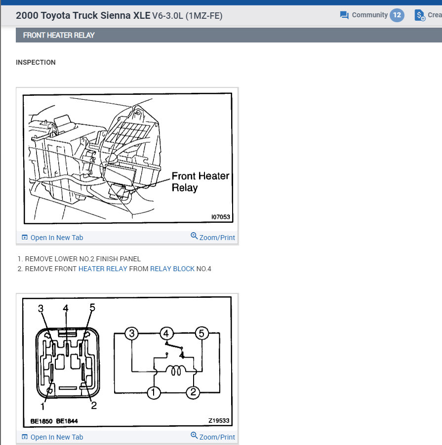

RODNEY7867
  • 70 POSTS
Where is the magnetic clutch relay? AutoZone and dealership show it's a 4-prong relay but the A/C relay under my dash on driver side next to fuse box inside is a 5-prong. So, what am I missing?
Jun 16, 2022 at 5:17 AM
RODNEY7867
  • 70 POSTS
Also, my headlights stay on even when I turn them off. So, I was wondering if the solar sensor affects both the A/C and headlights.

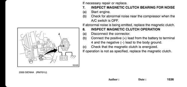

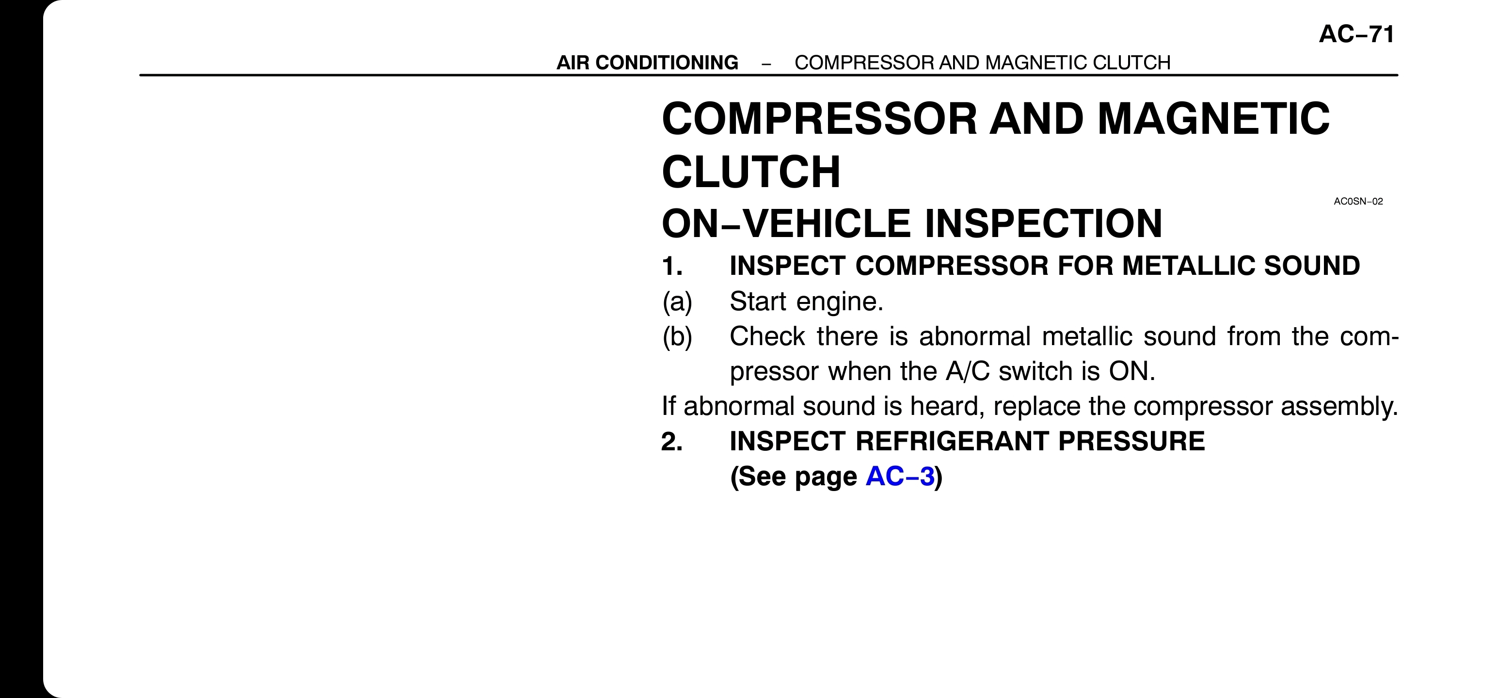

I am posting the diagnostic procedure for the compressor. I apologize that I overlooked the possibility that you could be low on refrigerant, causing the clutch to disengage.
I posted how to check the compressor properly. If you can rent some gauges from your local parts store get them and measure the pressures and post them on here. If it is low then following the compressor clutch inspection, you will be able to turn the compressor on so that it can take in the refrigerant. Let us know if you need further assistance.

  • 70 POSTS
Ohms read 113.9 at outside temperature 85 ° f.

The reading is good. As for gauges, I thought AutoZone or Oriley's would let you borrow them?

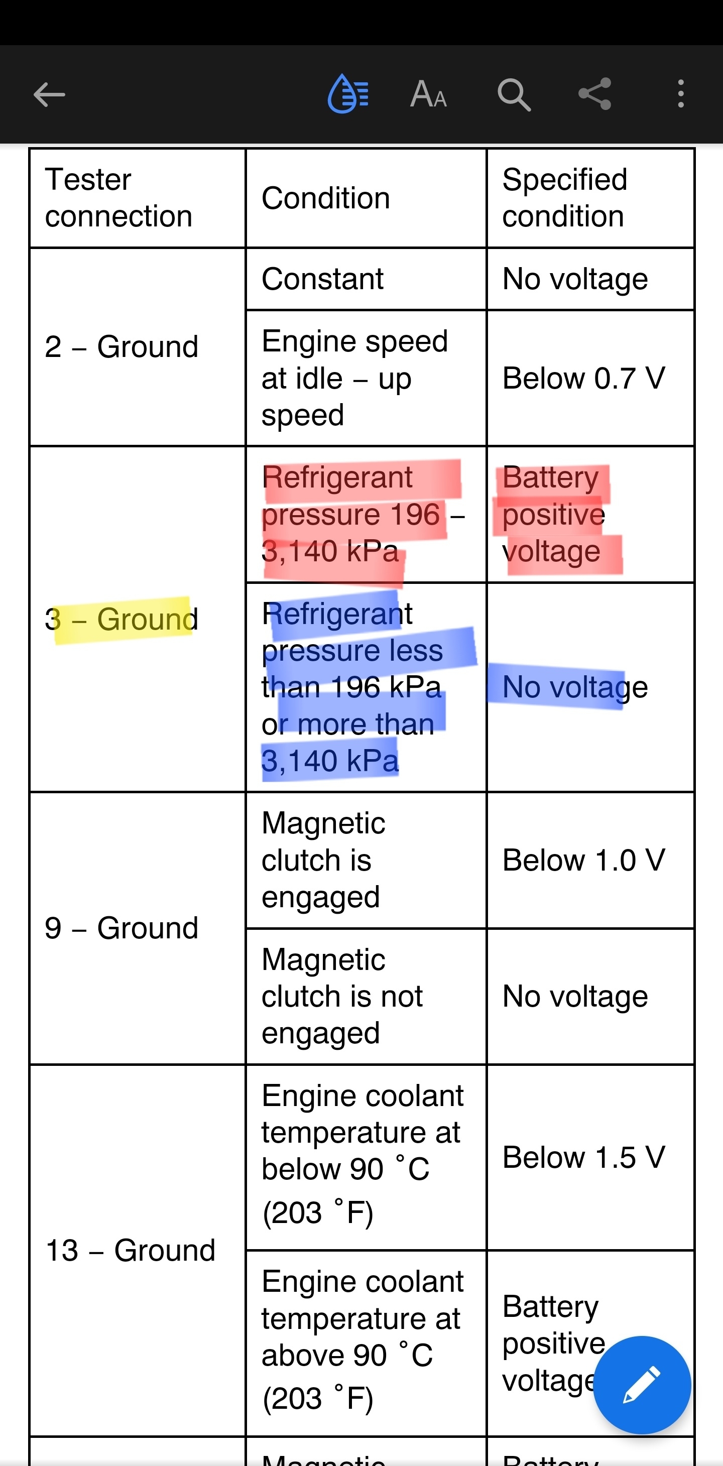

JIS001
  • 3,412 POSTS

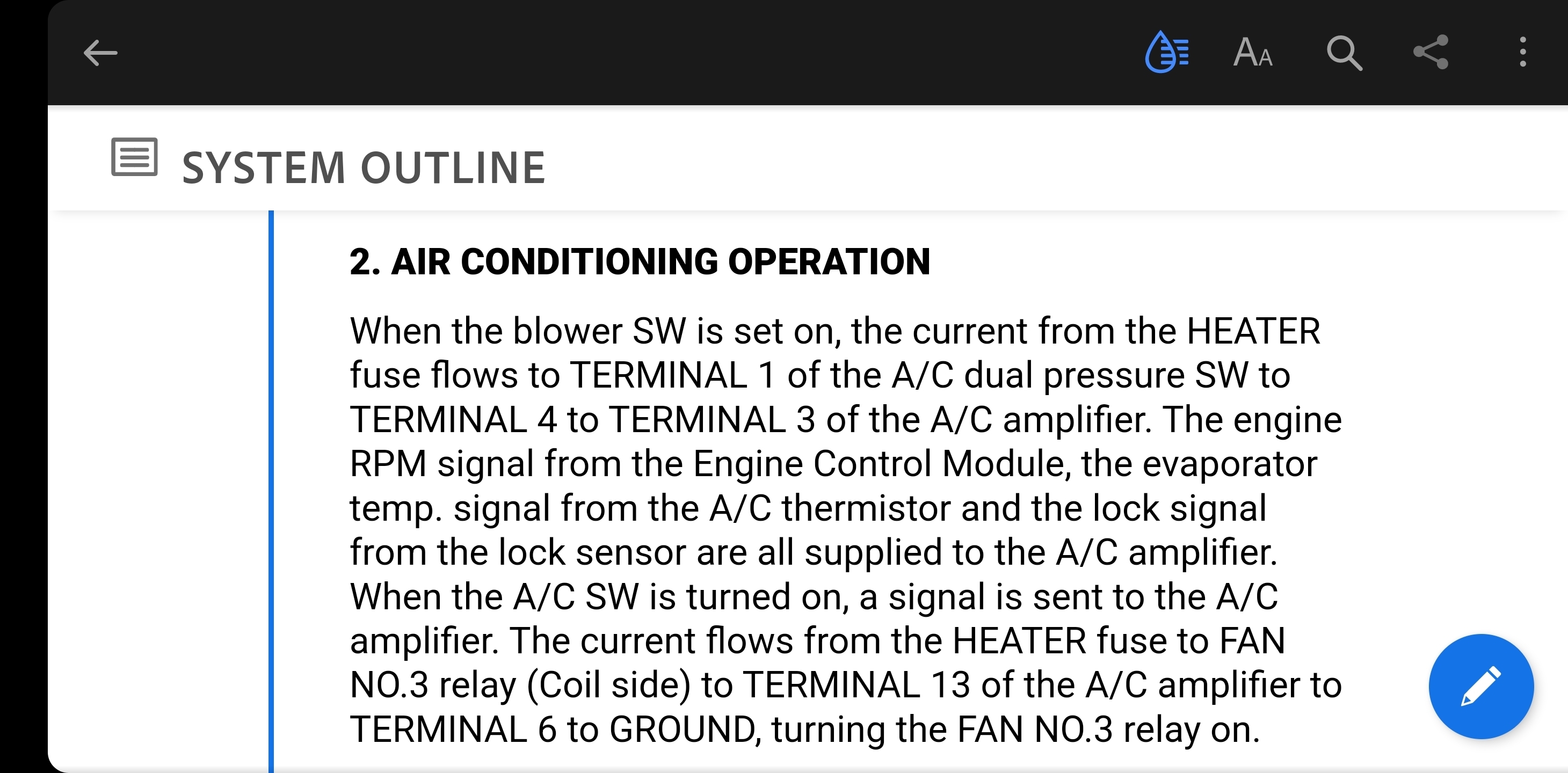

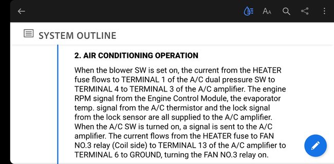

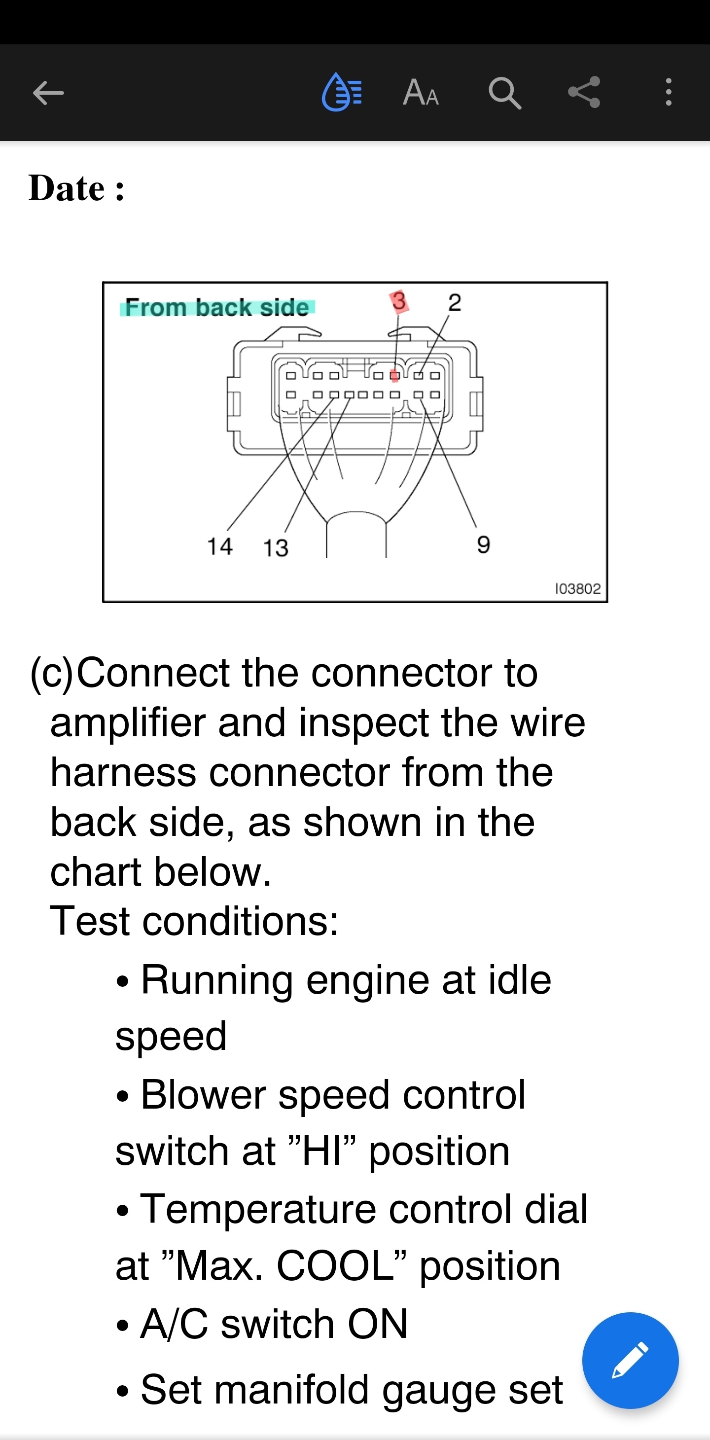

The article was supposed to help you use a can of refrigerant with a gauge on it to measure the pressure. As far as retrieving codes you would need an enhanced scanner. You cannot manually retrieve them. What we're trying to do is figure out if you're low on refrigerant or have a bad compressor.

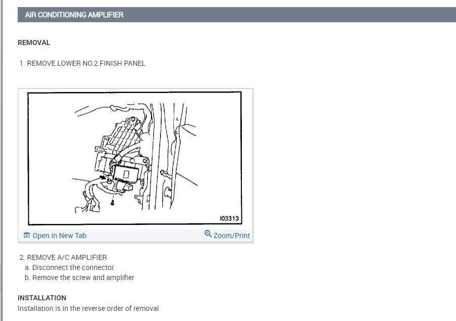

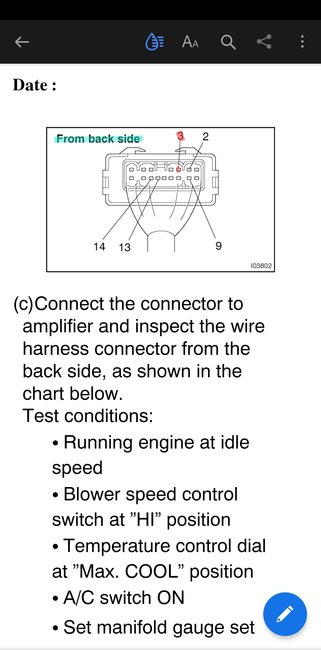

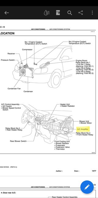

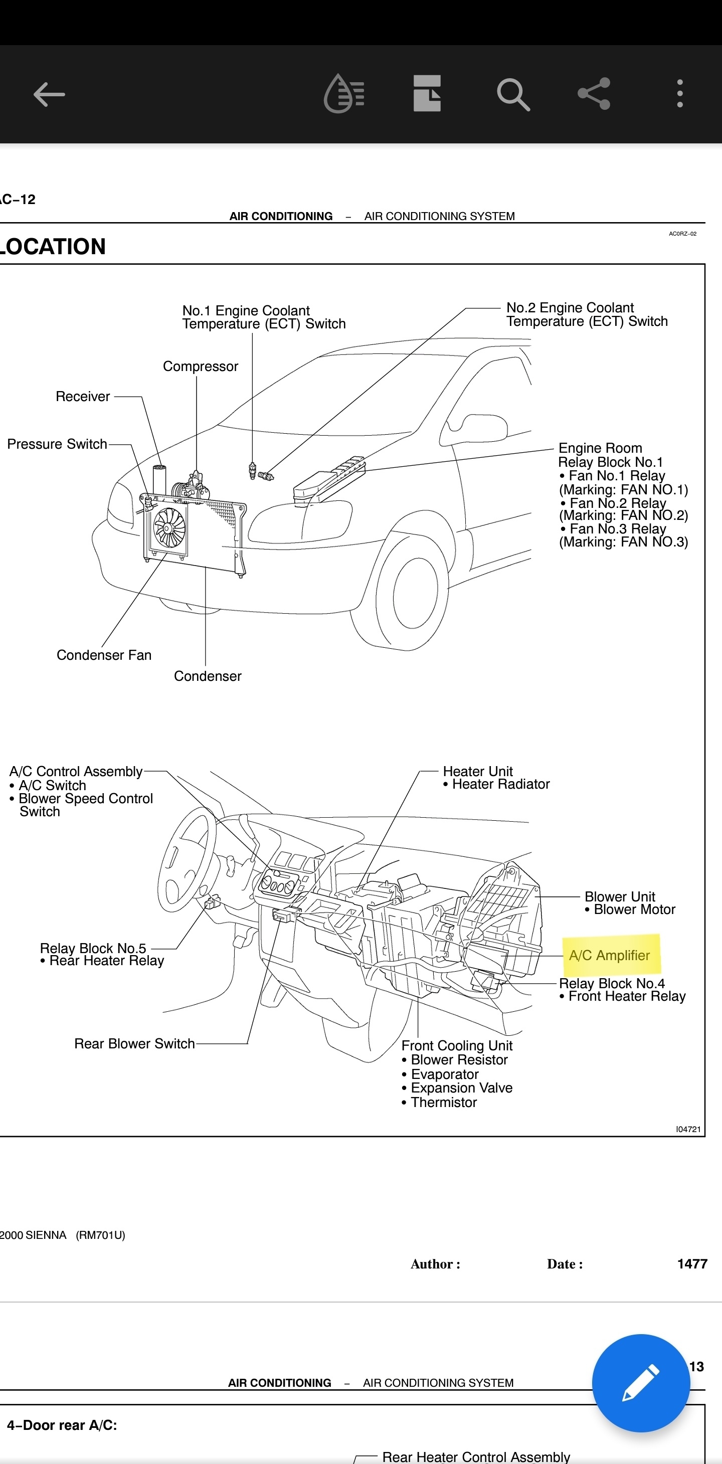

The next images I am posting hopefully will help you determine if you're low on refrigerant or not. You would need to remove the glove box out of the way to access the A/C amplifier. You will need to back probe pin number 3 on the connector with the power lead and the other lead grounded anywhere on a ground point. If you have voltage the system is full, if you have no voltage, you're either empty or overfilled.
If you do have voltage indicating the system is full and the compressor clutch disengages and A/C light blinks, then that would strongly be an indicator your compressor could be faulty. Highlighted the pin and the specs for you and the location of the A/C amplifier. I hope these images help you out.

So, this van has two A/C relays: one for front and one for rear?
Jun 20, 2022 at 9:36 AM

RODNEY7867
  • 70 POSTS

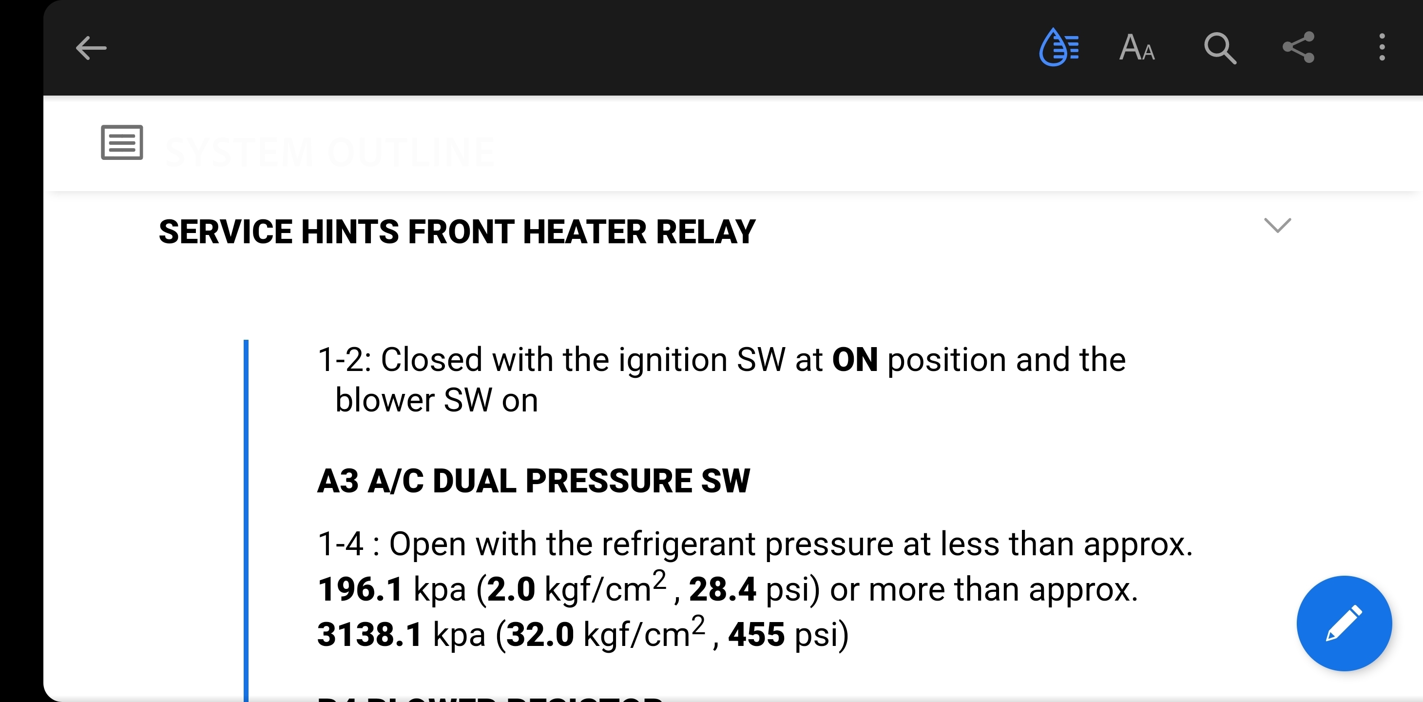

I didn't know there were two A/C relays. I'll try to replace the front heater relay as soon as I can.
Jun 20, 2022 at 11:24 AM

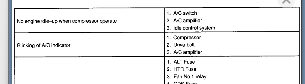

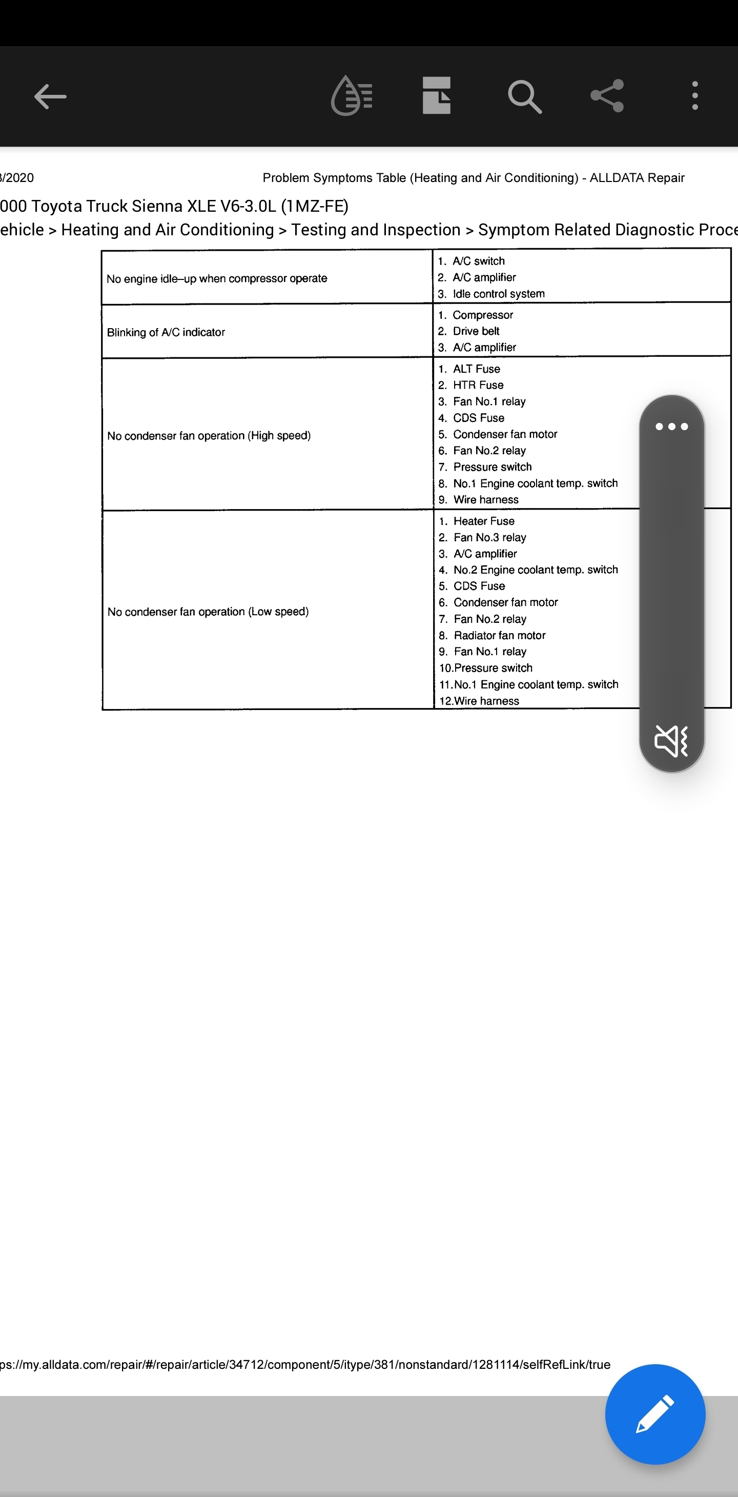

I just want to jump in on this because I suspect we are overlooking the basic things that may help with this.
The most common cause of the compressor cutting off and the light blinking is due to incorrect pressure in the system.
I see that you are checking the low side pressure and it is 45 PSI when the compressor is on and 89 with it off.
What is the high side when you are checking this? I am attaching a chart below that will help with this.
So, we need to know three things to start, or we are going to chase this for a while longer.
First, we need to know what the ambient/outside temperature is. If you have 45 PSI when the compressor is on, then it should be around 85 degrees. Is that correct?
Next, we need to know the low side.
Lastly the high side pressure. If these are not correct, then the module can cut the compressor off, and it flashes the light to tell you there is an issue.
So, we need a gauge set to check the high and low side while this is running.
Without this info we are going to chase our tail.
Jun 20, 2022 at 12:28 PM

RODNEY7867
  • 70 POSTS
How do I get to the front heater relay on passenger side?
Jun 21, 2022 at 4:46 AM

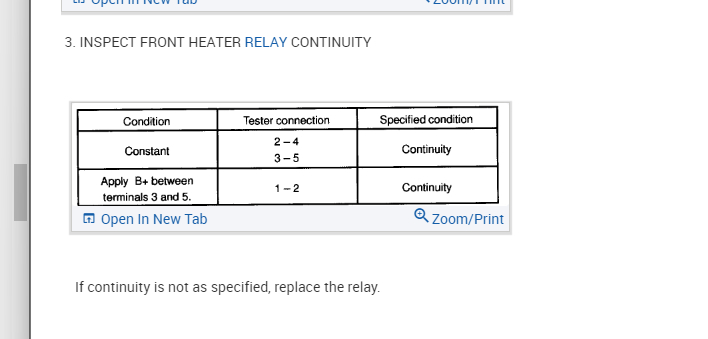

Please see the attached info per your request.
As for the blinking light, if we want to assume the pressure is correct on the high side then that would mean there is a drive belt issue, or the module is the issue.
Take a look at the info below and let me know if you have questions on this.
Thanks
Jun 21, 2022 at 4:55 AM
RODNEY7867
  • 70 POSTS
Whatsoever it mean apply b+ to 3-5.
Jun 21, 2022 at 5:08 AM
RODNEY7867
  • 70 POSTS
What does it mean?
