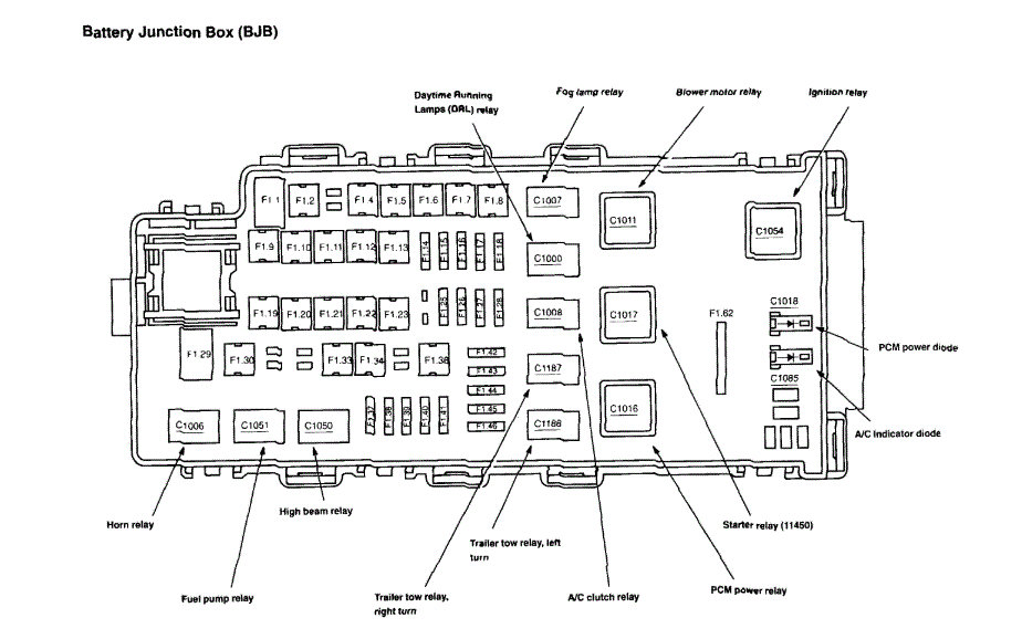

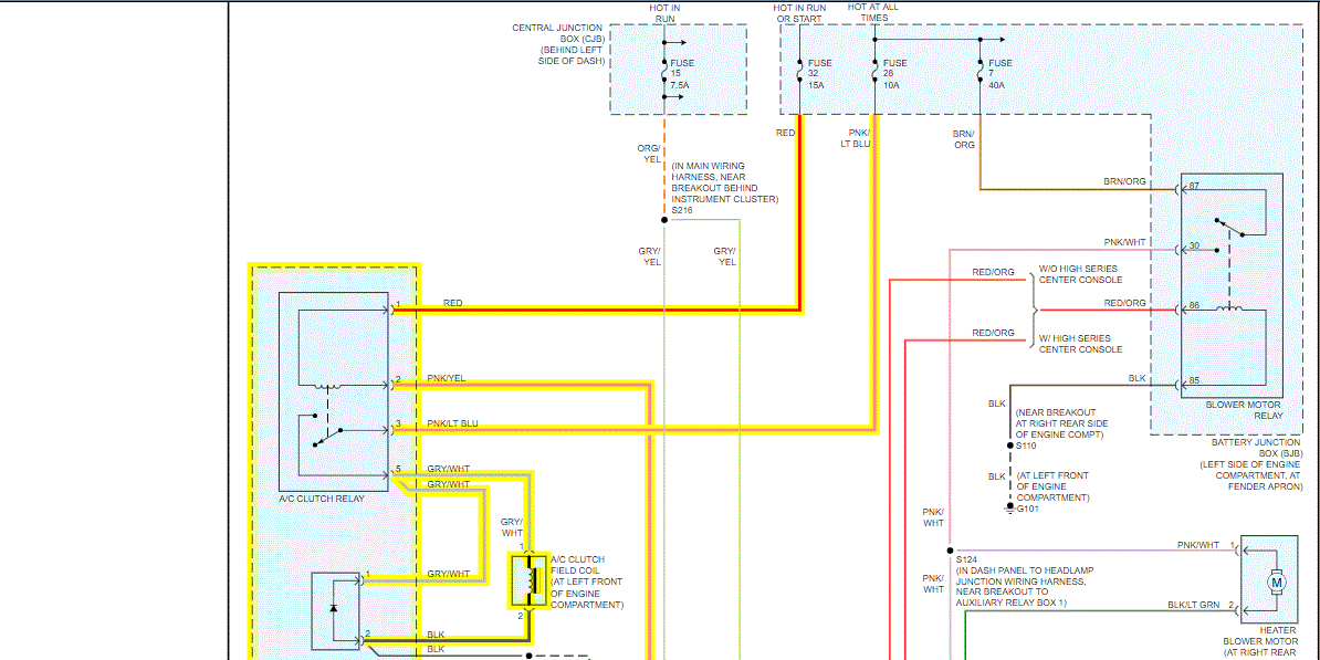

I attached a wiring diagram and the location of the relay if we need to do testing.
