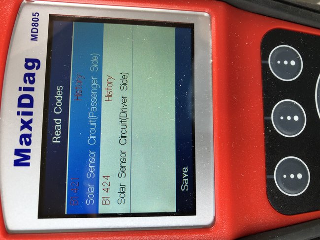

A/C compressor not kicking, is this one supposed to turn free by hand with car off? I have seen VW ones that you can't turn with your hand. I am trying to figure out whether it's locked. Also, I have codes that are history, do these have anything to do with the A/C running?

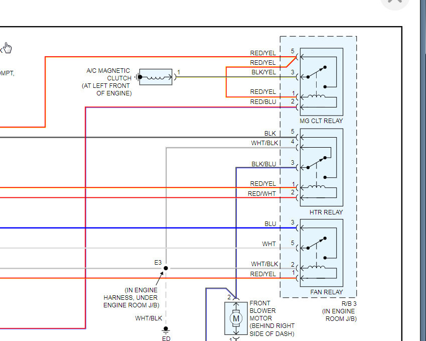

Let's start with jumping the relay to see if the compressor comes on. This is a magnetic clutch compressor so I would assume it should be able to spin freely.
However, if jumping power to it does not cause it to come on then I would think it is locked up since it doesn't spin as well.
Let me know if you jump pin 5 to 3 on the relay or just jump 12 volts to the compressor.

Actually the compressor turns by hand. Couldn't get it to kick on by jumping any if the relay wires. I cant tell which is 3 and which is 5. But i tried them all, jumping between any if them nothing happens. With a test light two of them have power with engine running and none of them show to be ground.
Jul 13, 2020 at 3:15 AM
Okay. We could still have a wiring issue to the compressor so let's jump power from the battery directly to the compressor. Just back probe the compressor or remove the connector and touch the 12 volt wire to the pin for the compressor (looks like it only has one). If the compressor comes on then we will chase the ground issue because clearly that doesn't sound right. The control module should be grounding the relay when it wants the compressor on so let's just make sure we don't have two issues and the compressor will actually come on.

so I removed the compressor's connector, jumped a wire from the battery positive to the compressor and nothing happened.also connected the male/female of the compressor wire with a clip and attached a wire between them to the positive and nothing happened. but I also checked with a test light and when the car is running A/C on there is no power going to the A/C compressor wire.

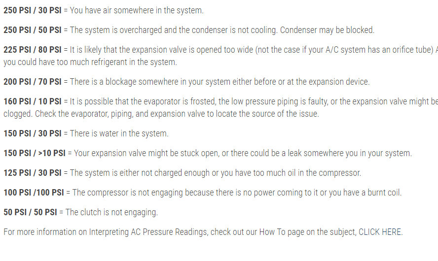

Yeah. Take a look at this chart as I agree it is probably not low Freon. The 50/50 is what I suspect the issue is. Basically when the pressures are low and equal it is due to the compressor not coming on. If you have power at the compressor but it still doesn't come on then the compressor is the issue.

I see. And just for my own info all these readings are for when the compressor is not running, engine on, ac on, and the number on left is low pressure side
Jul 14, 2020 at 12:44 PM
These numbers are when the engine is running and compressor is on. The number of the left is the high side.
