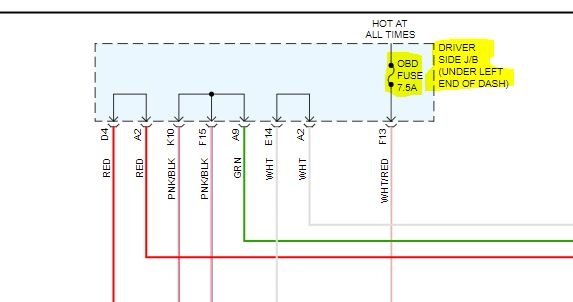

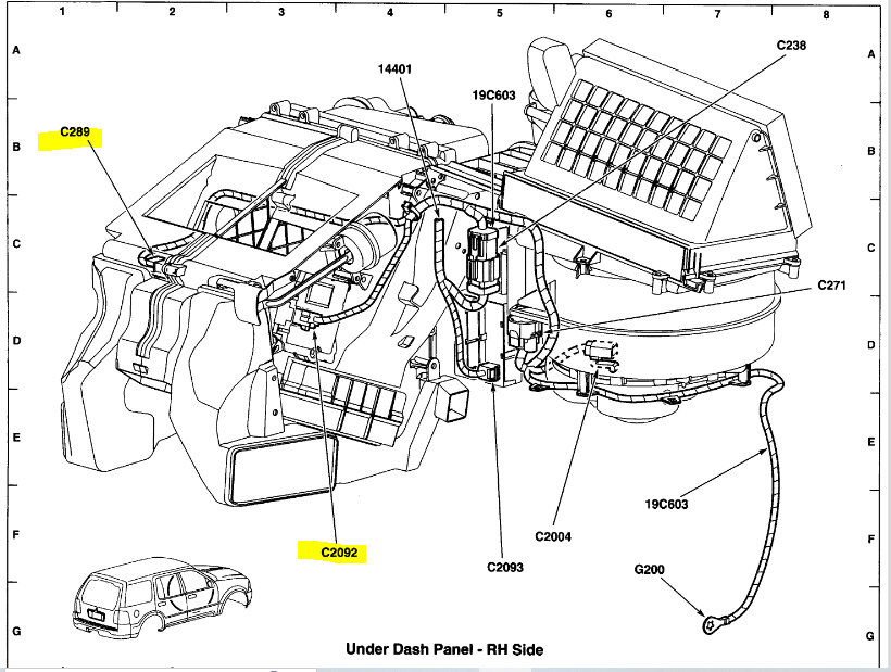

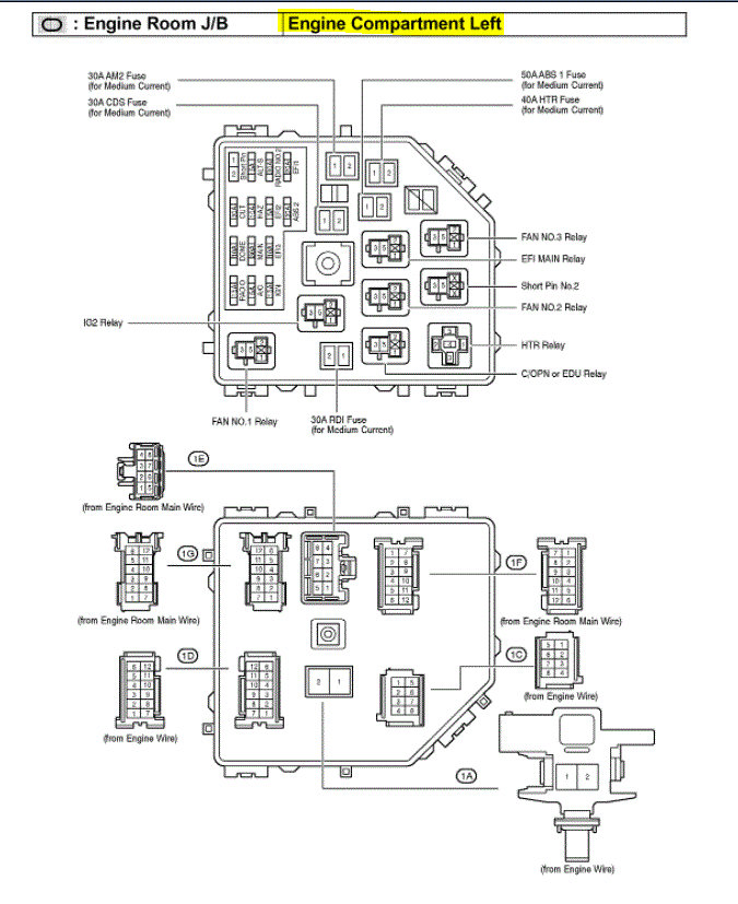

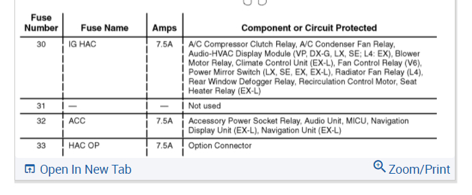

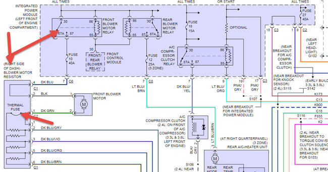

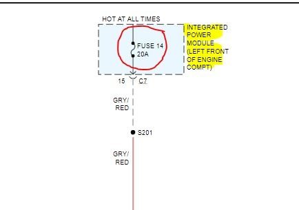

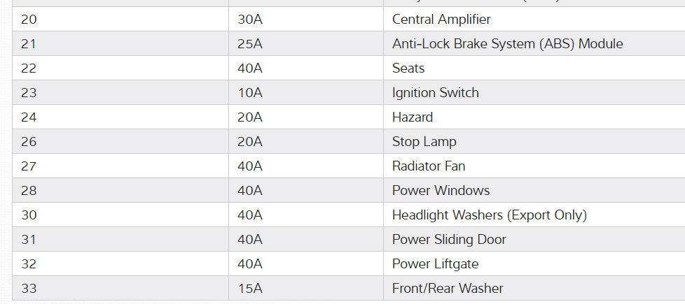

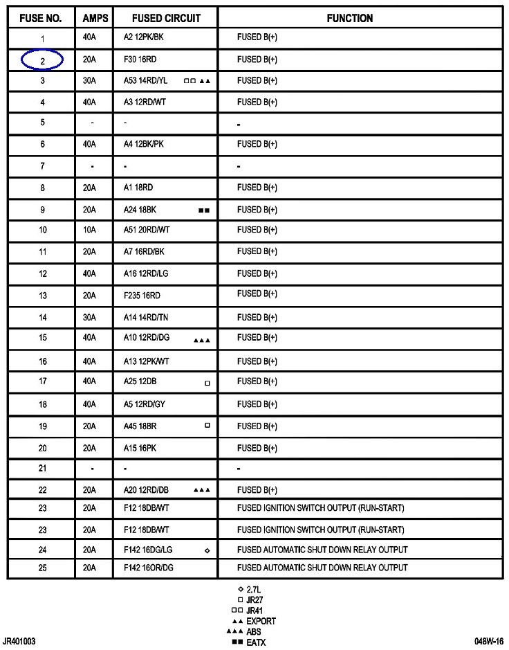

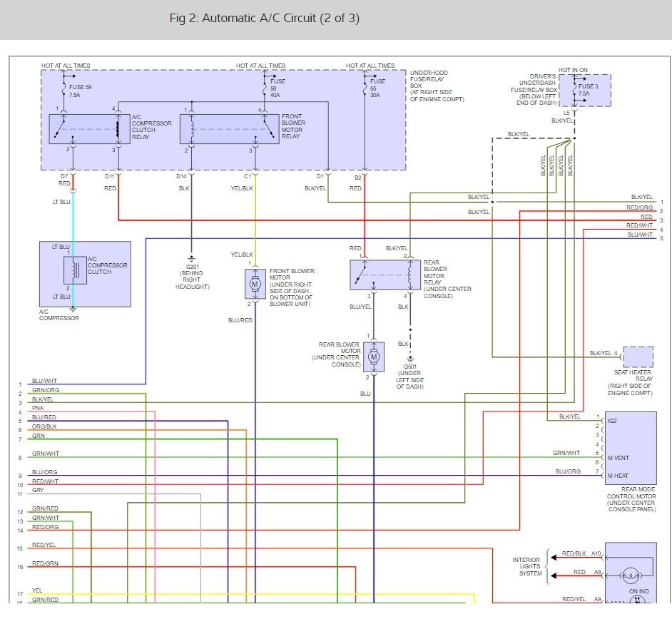

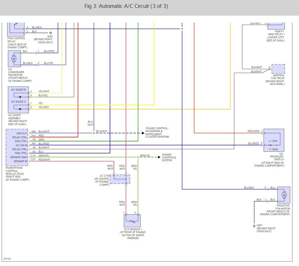

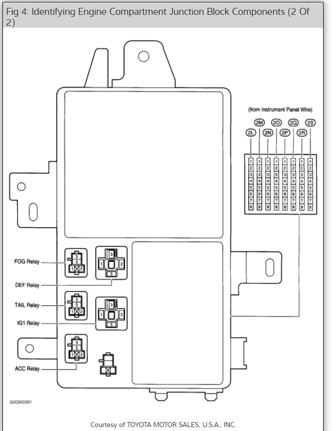

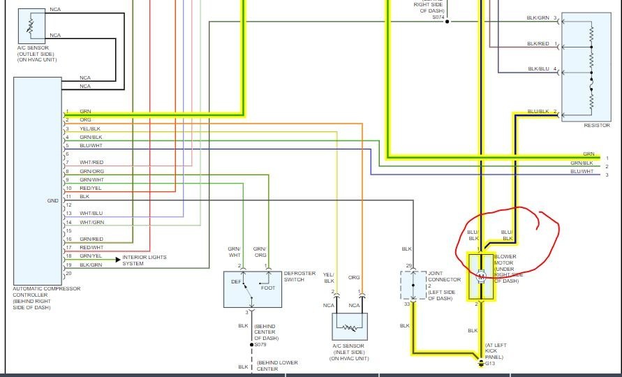

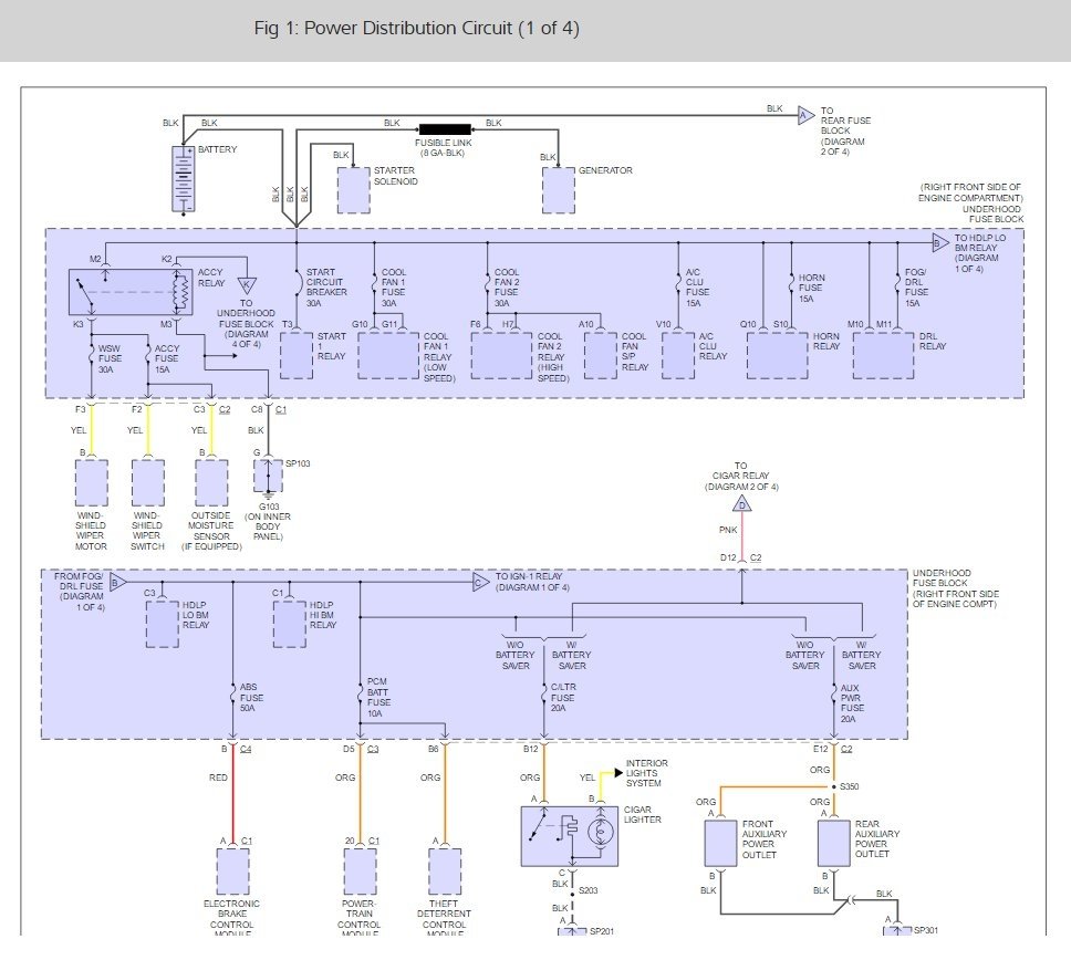

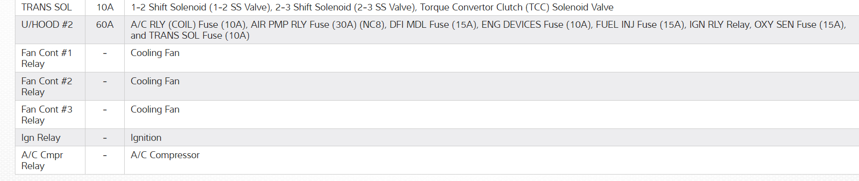

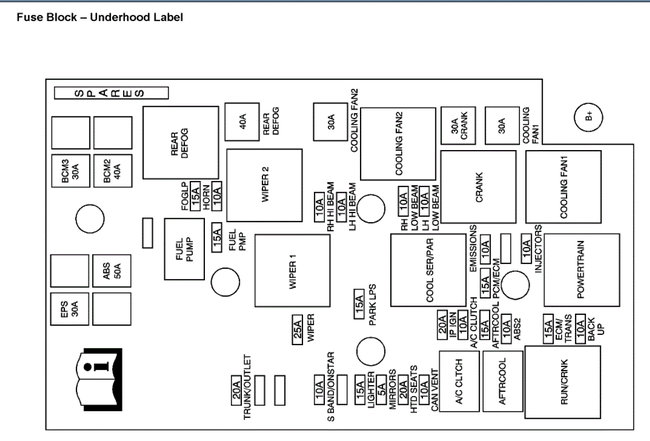

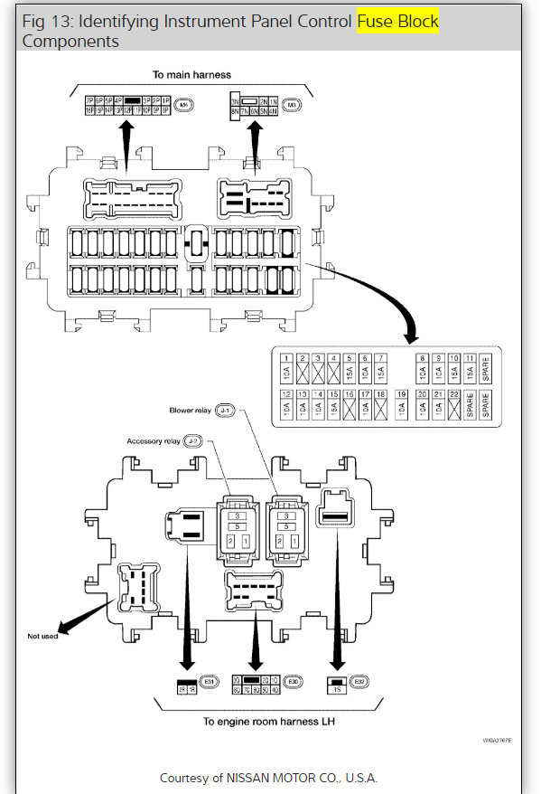

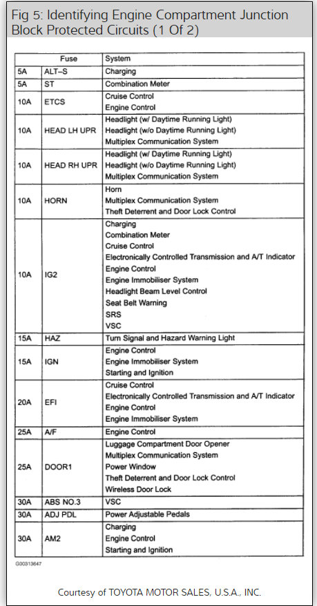

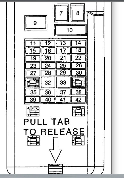

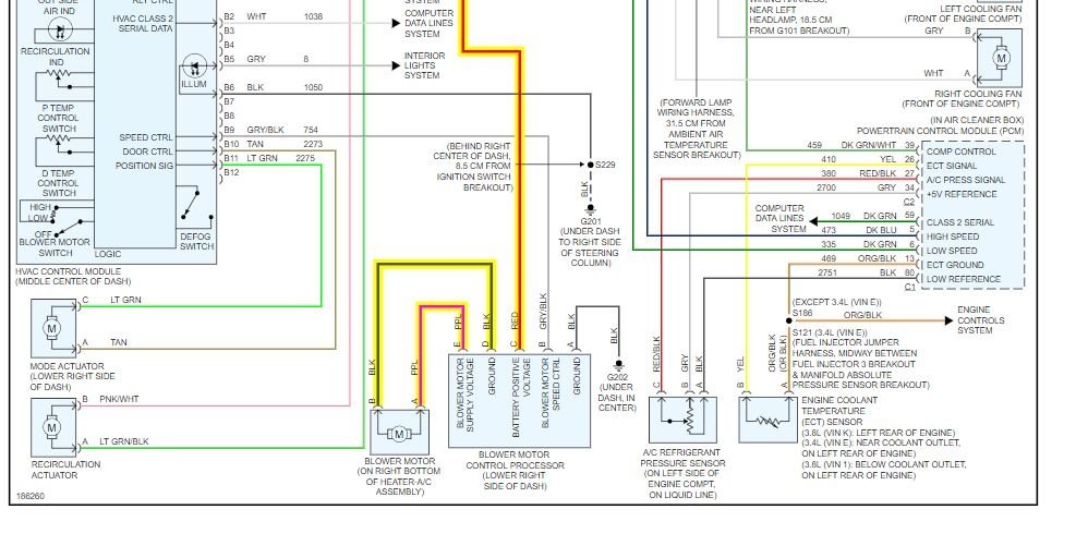

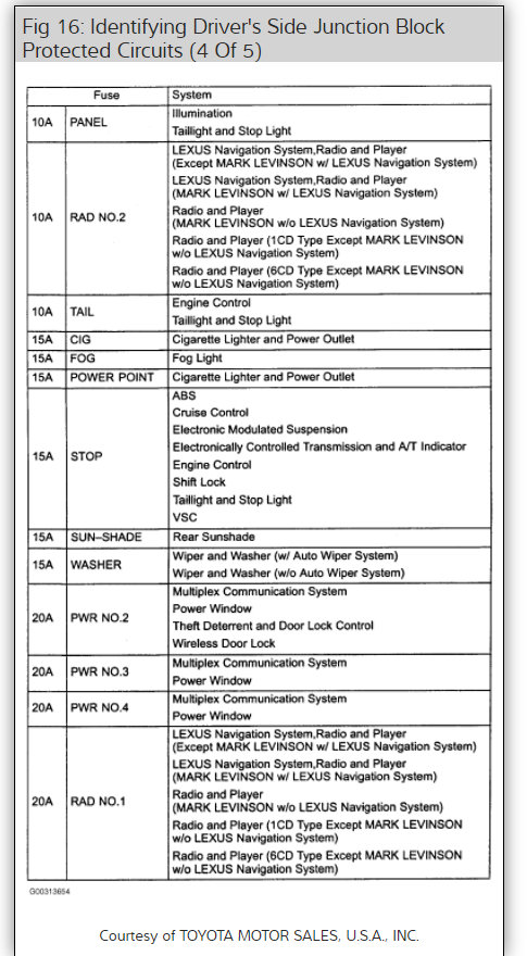

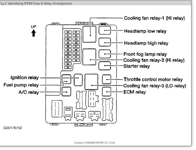

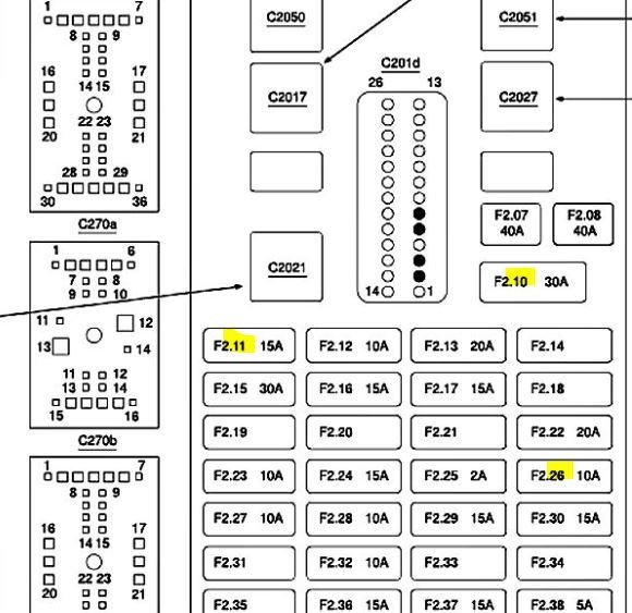

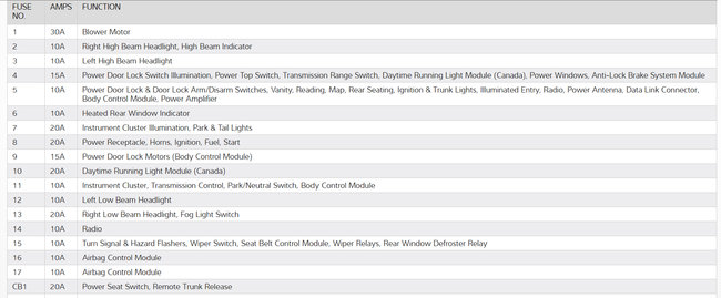

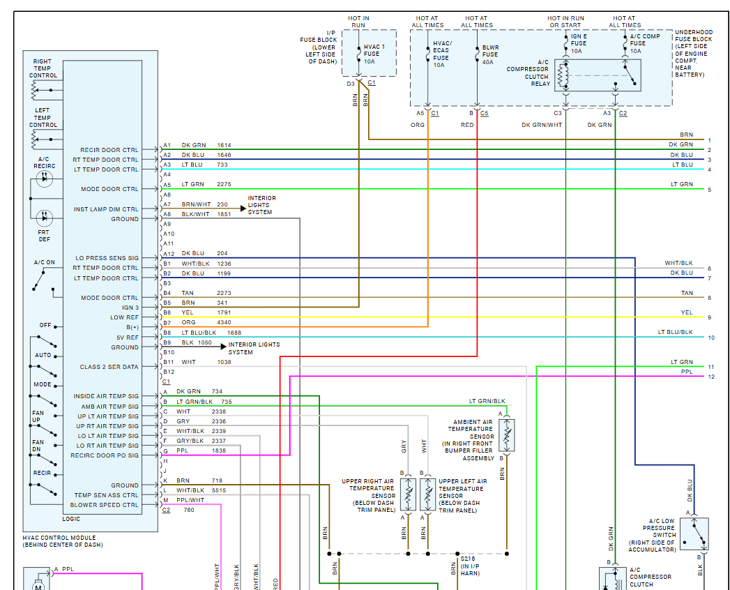

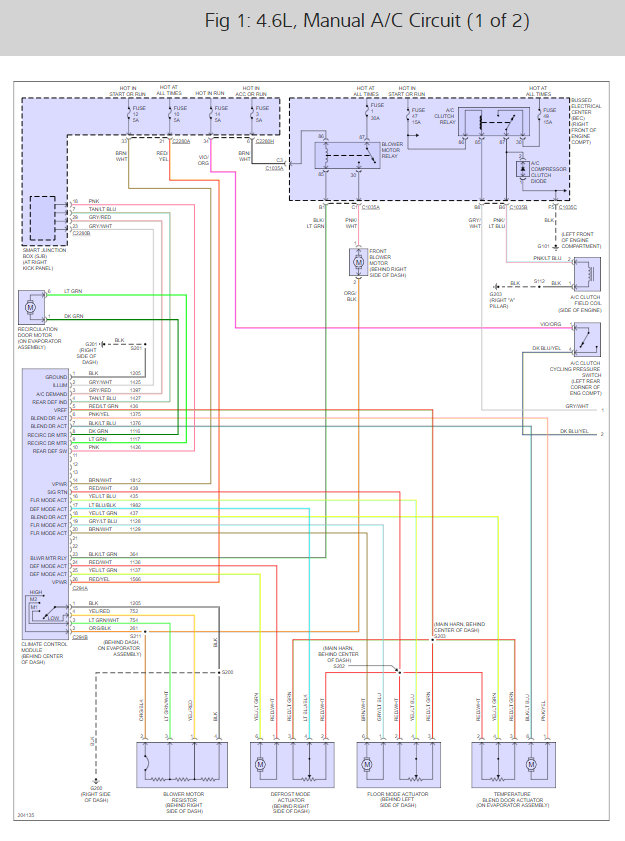

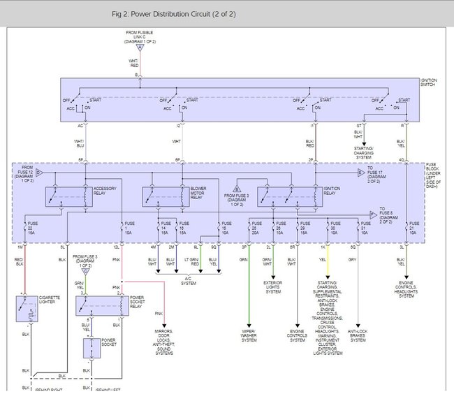

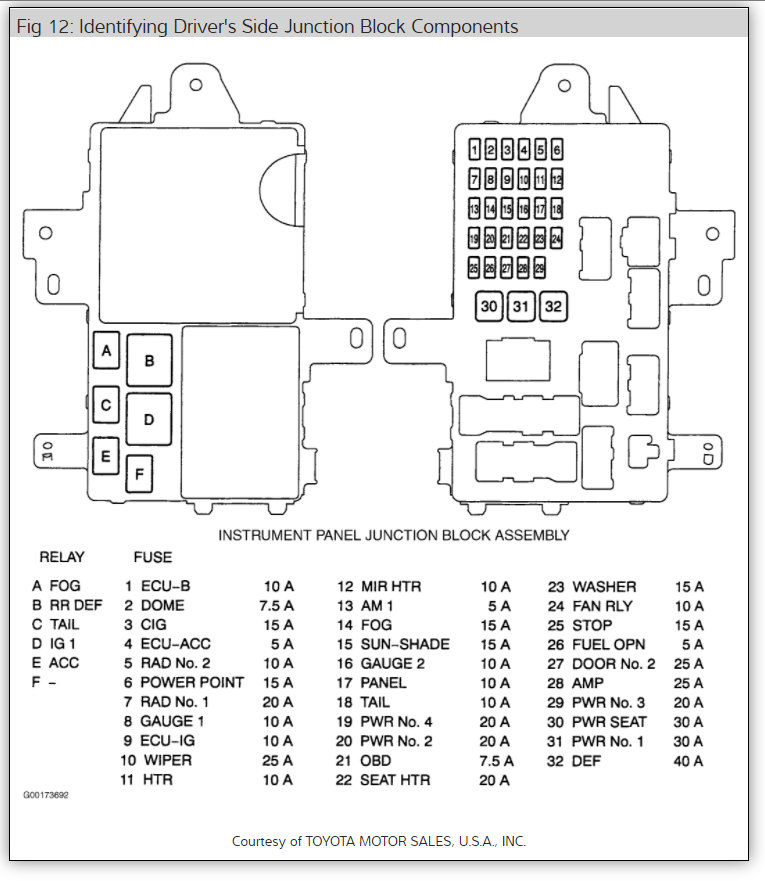

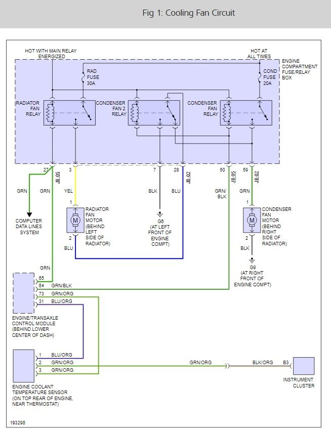

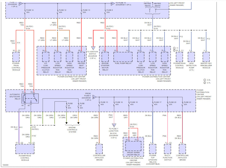

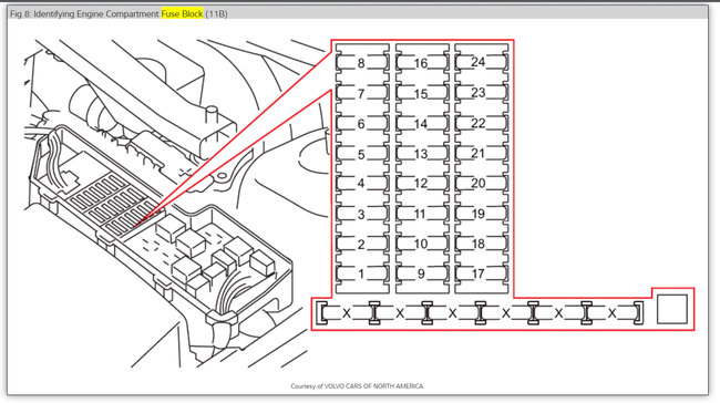

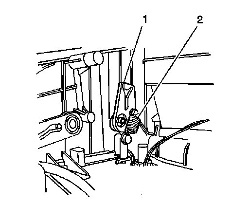

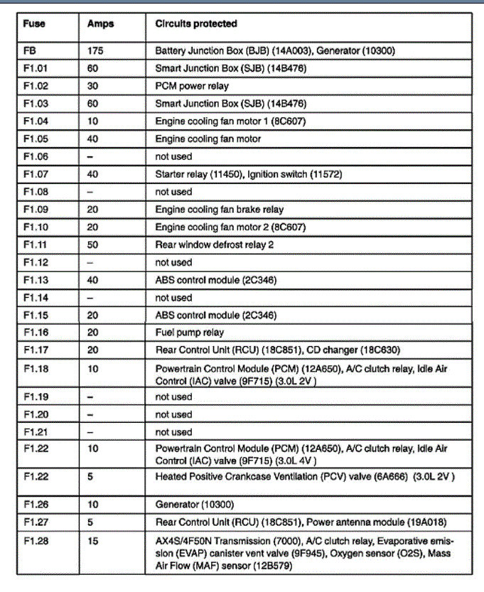

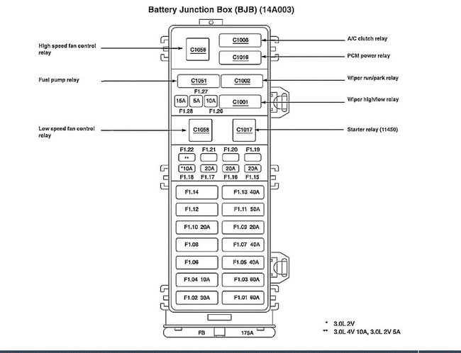

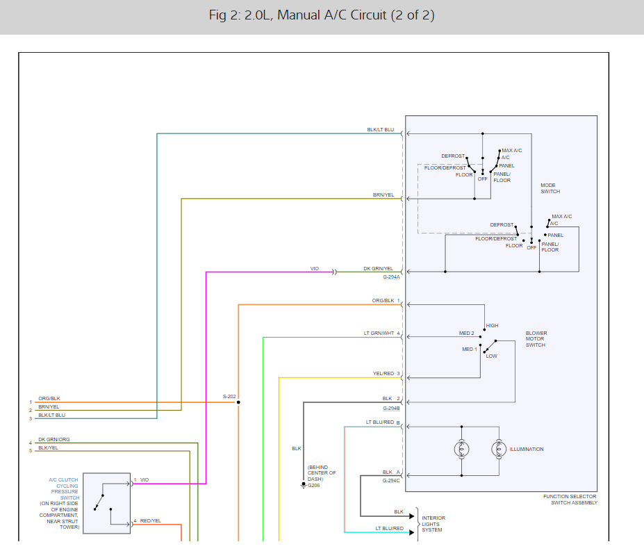

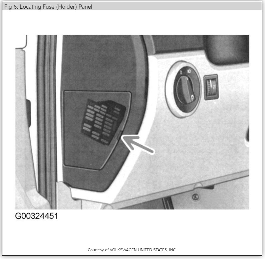

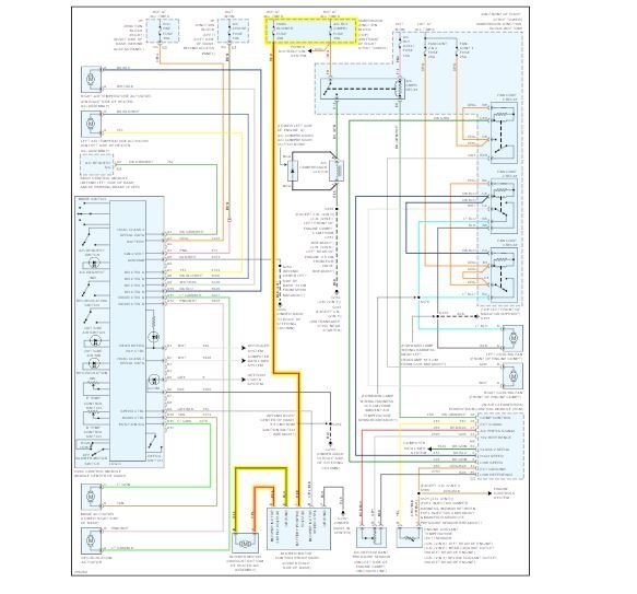

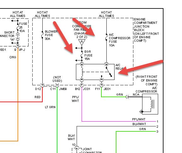

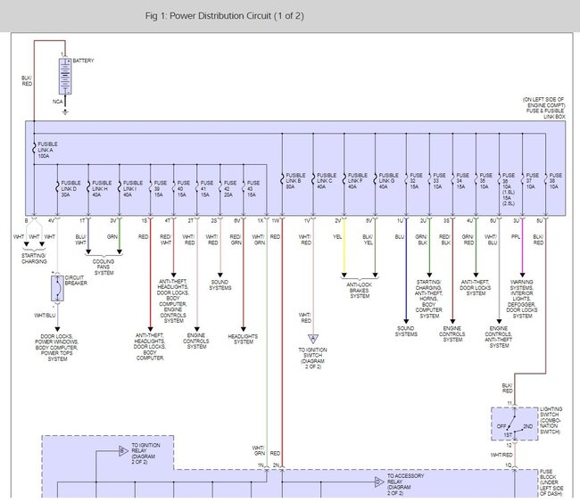

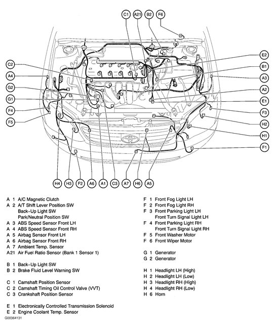

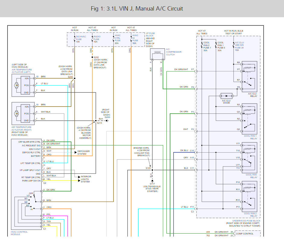

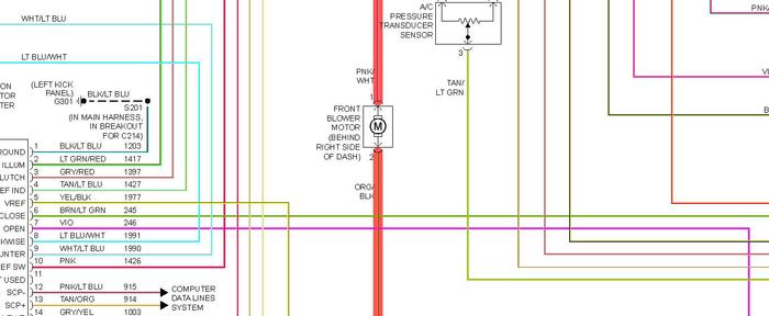

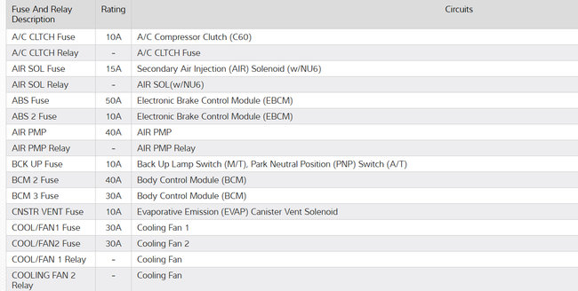

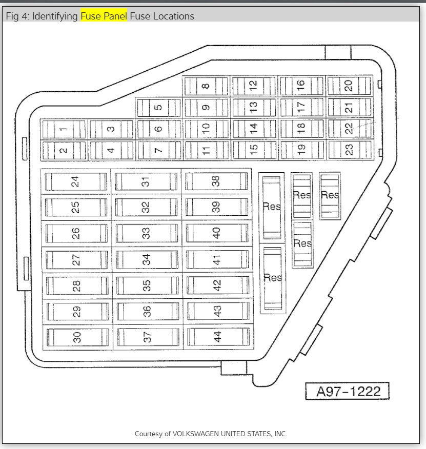

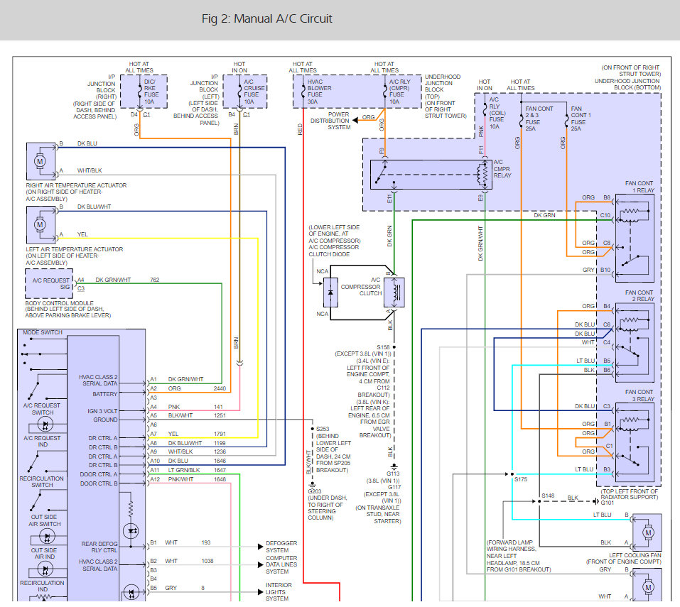

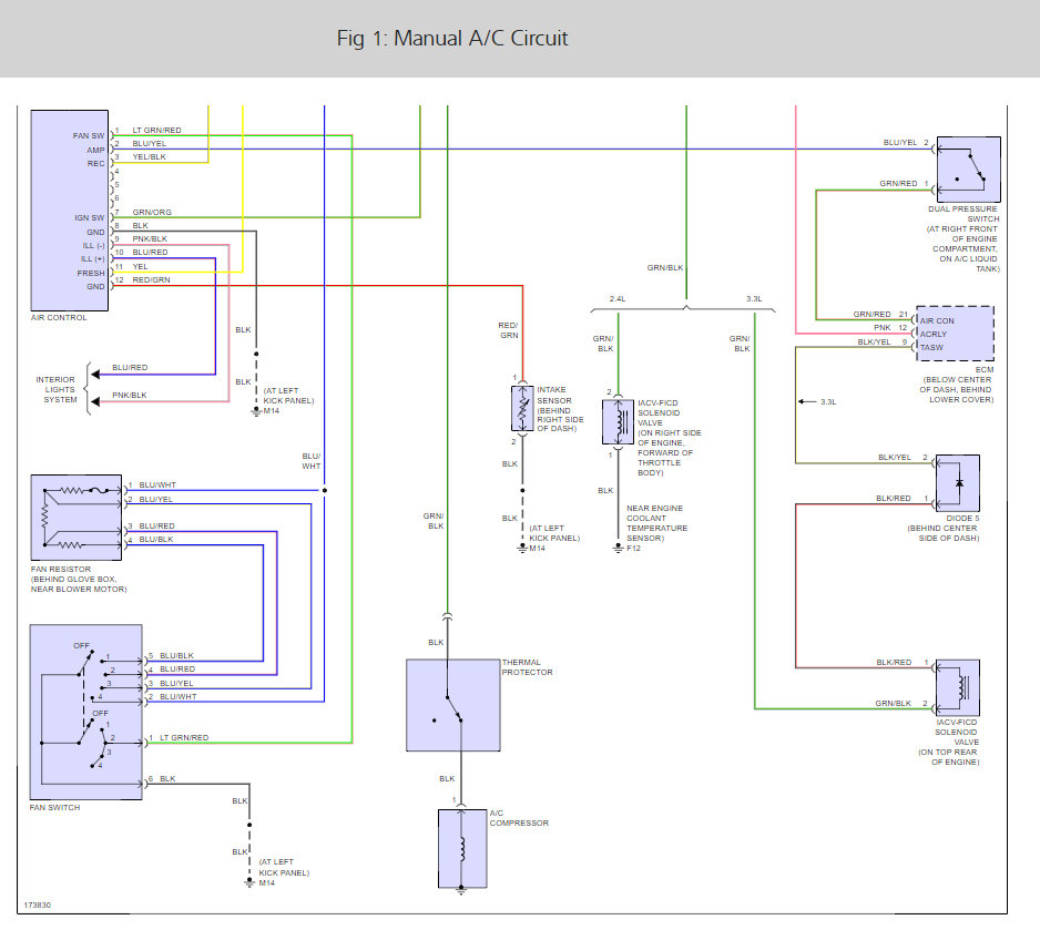

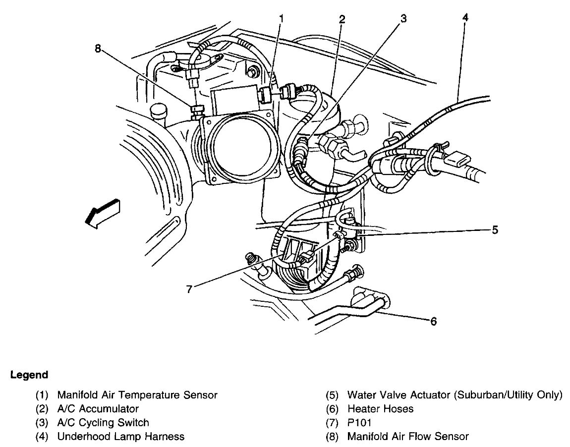

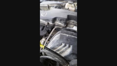

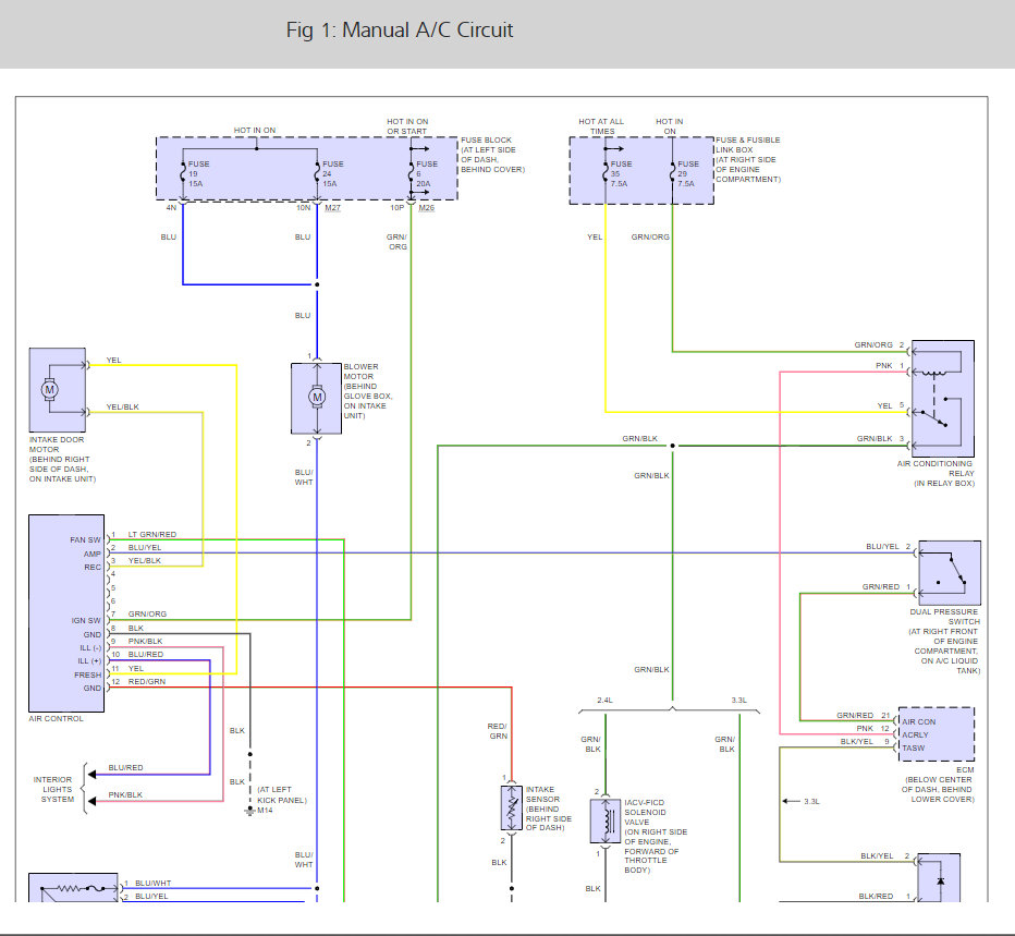

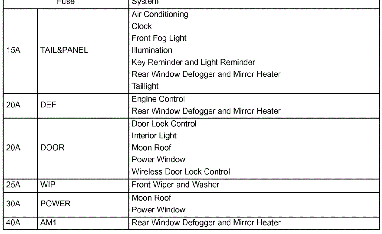

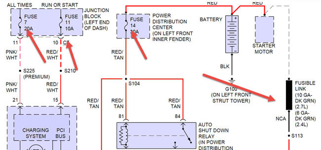

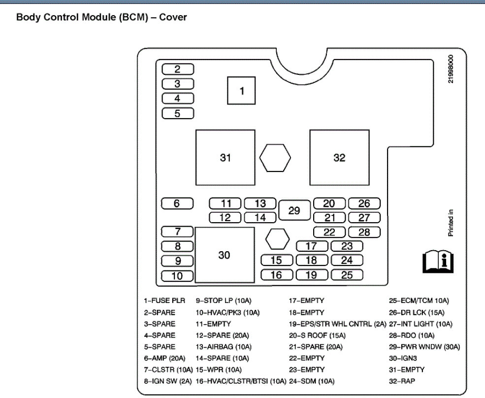

A/C not working i have check for power at the presure switch there is none also no powere at the compresser, i have checked all the fuses that i know about and have switched the relay but nothing also ran 12v power to the compresser also nothing, tried adding a can of of freon to see if it would kick the presure switch on but also this did not work.
I would like to make sure that the compresser is the problem before i replace it. Im concrened that there is no power there.
Any suggestion?
Aug 5, 2015 at 2:31 PM
HMAC300
  • 48,601 POSTS

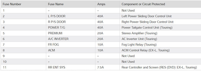

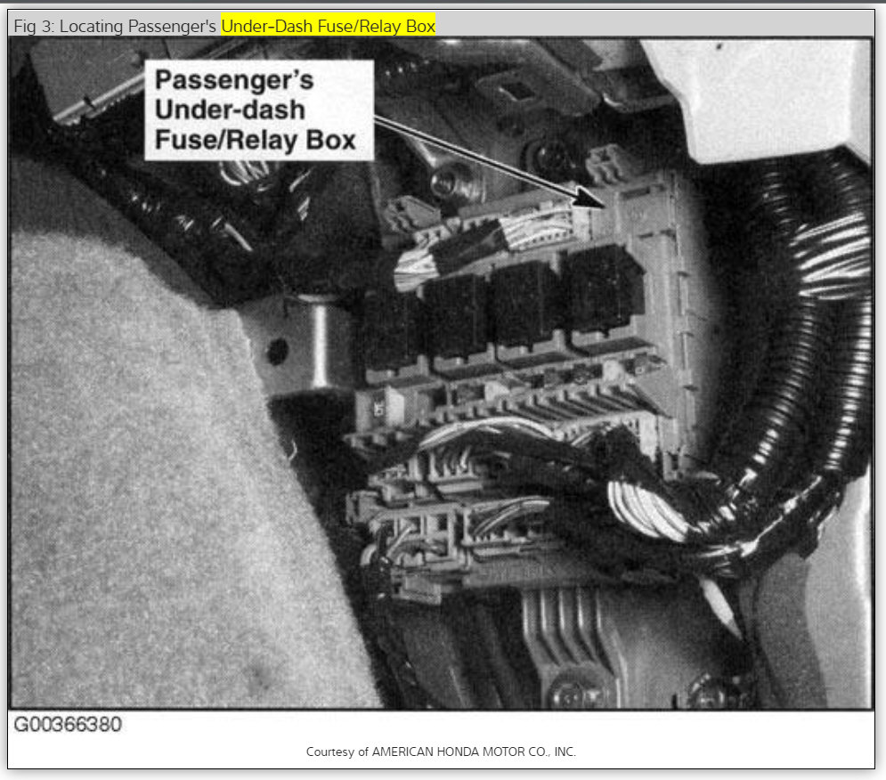

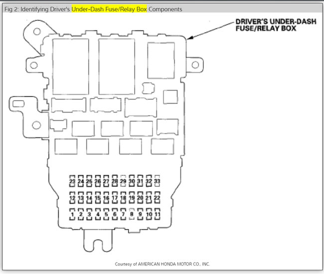

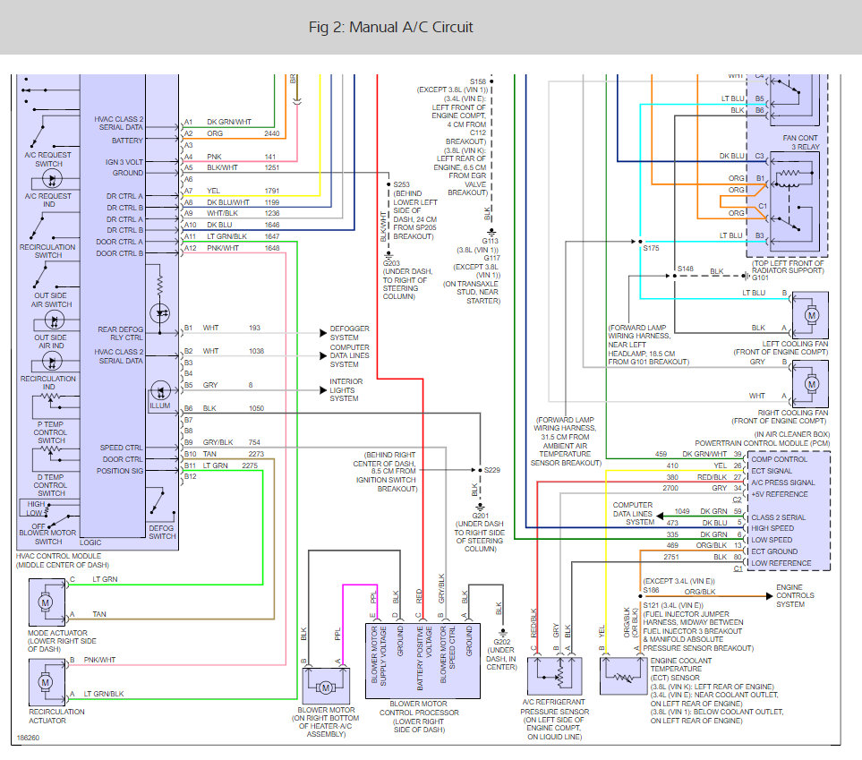

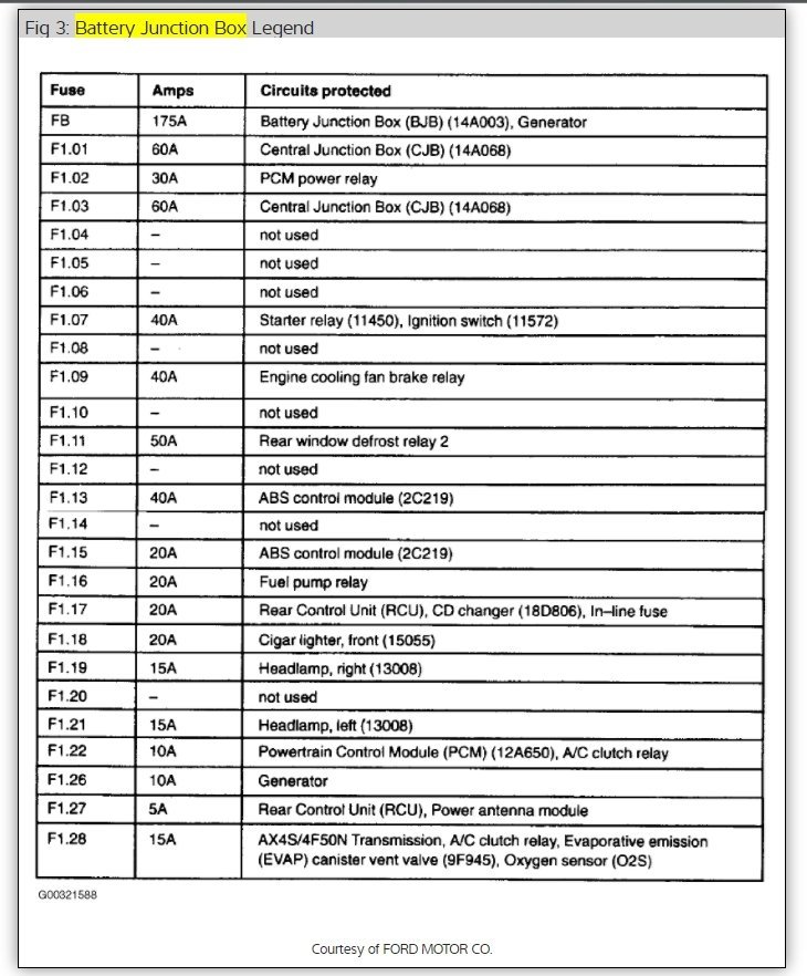

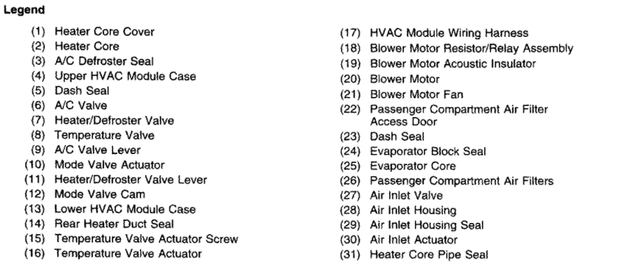

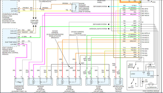

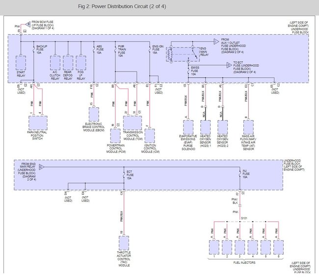

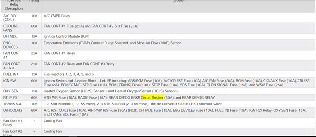

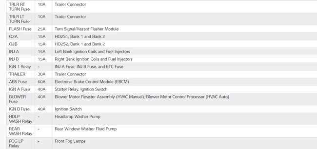

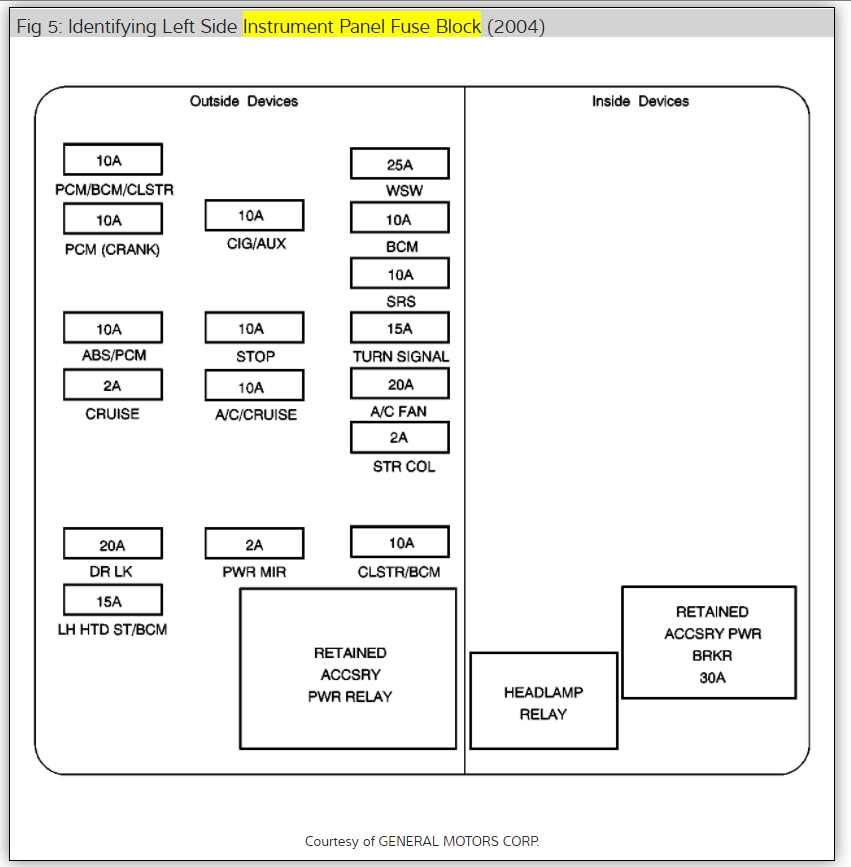

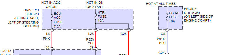

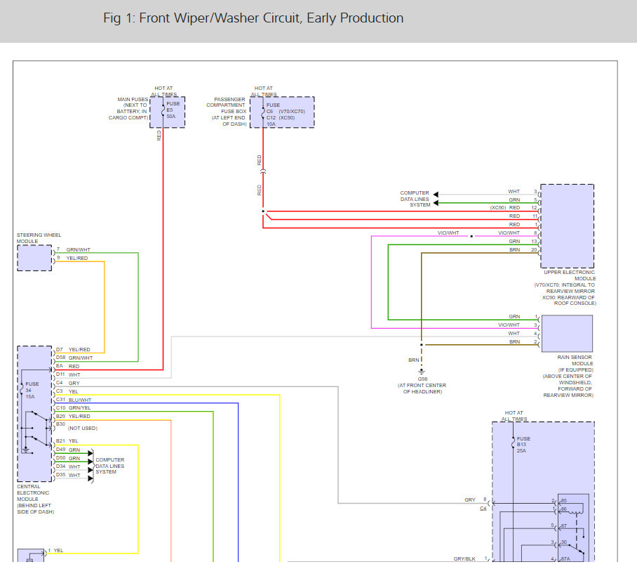

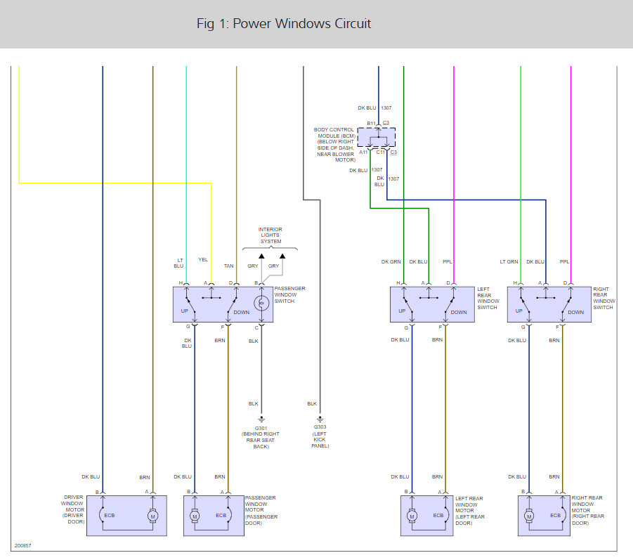

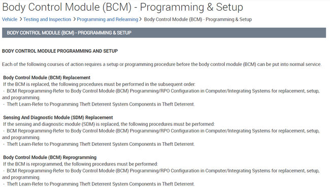

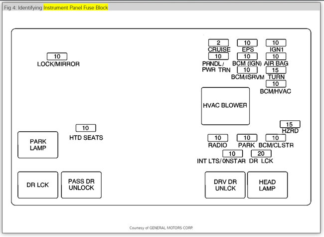

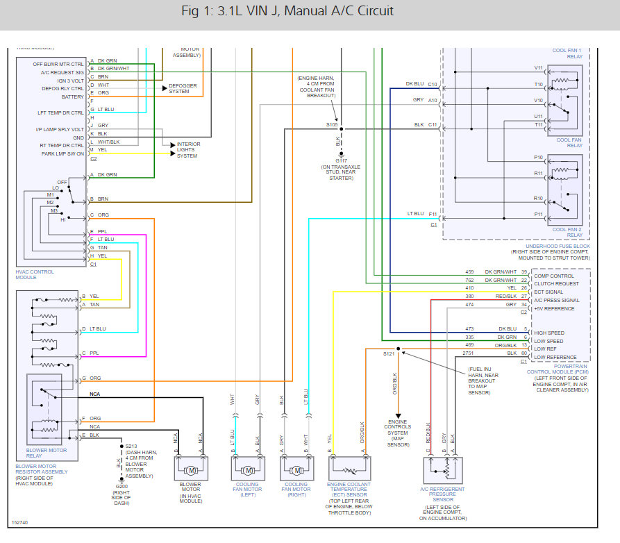

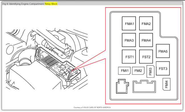

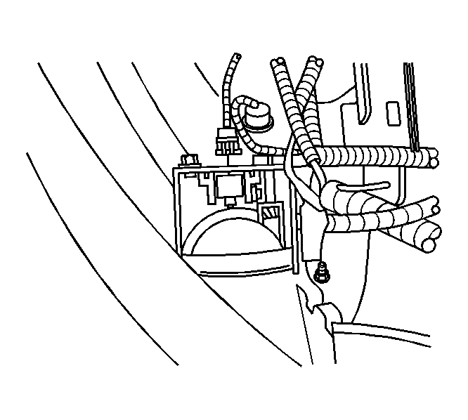

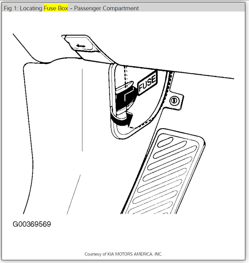

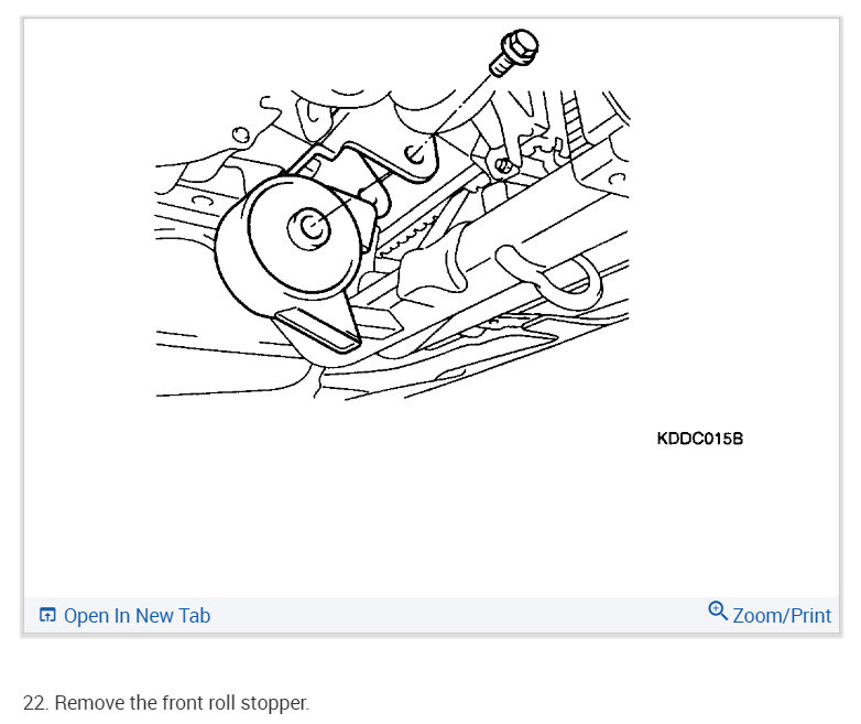

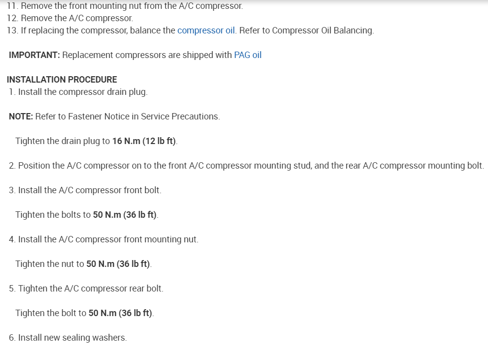

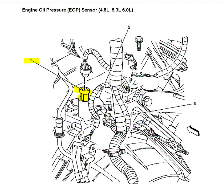

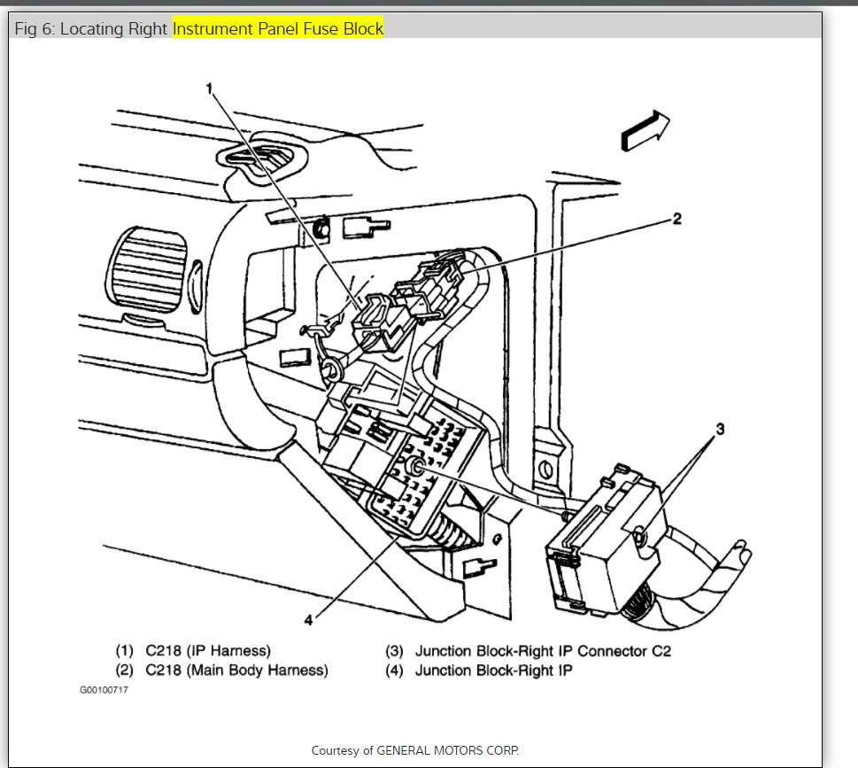

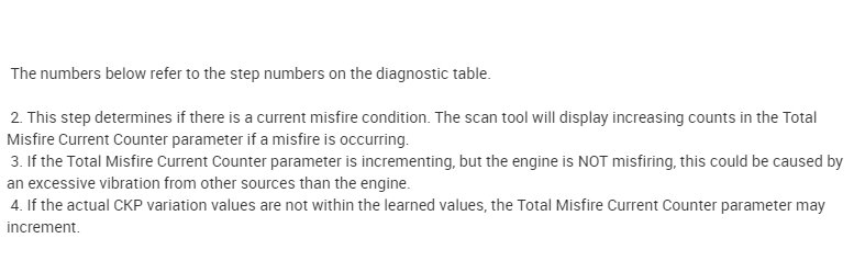

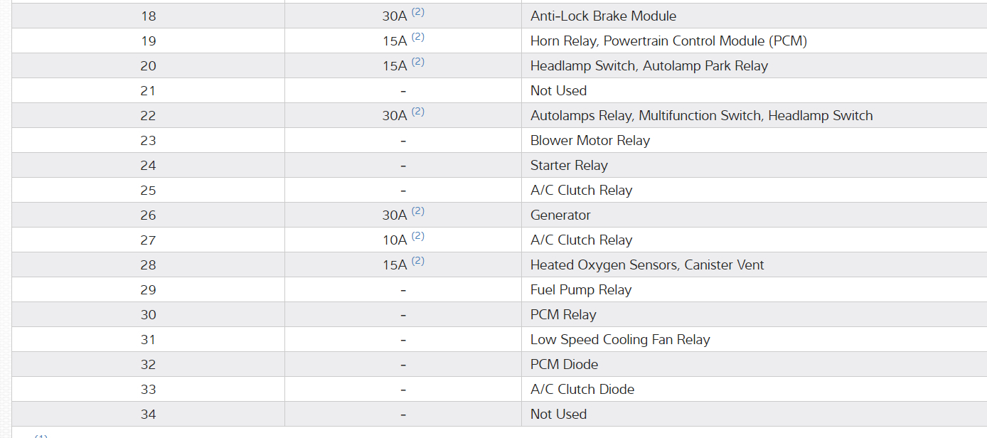

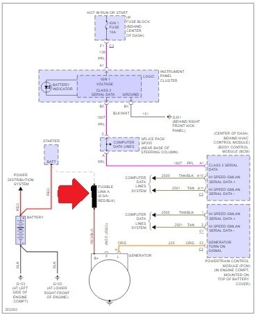

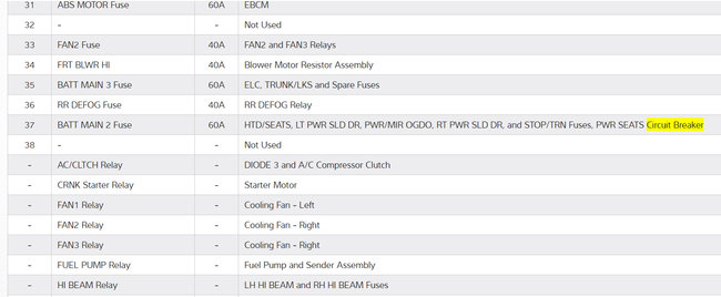

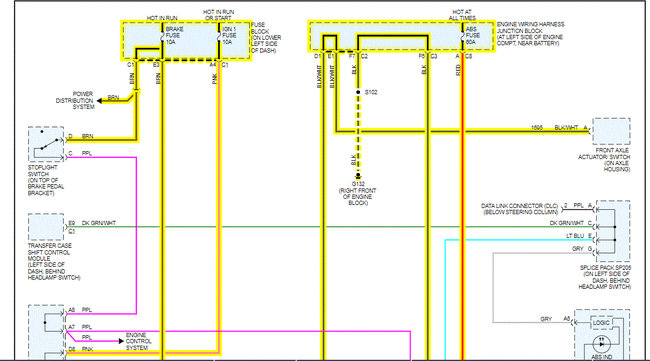

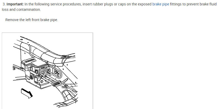

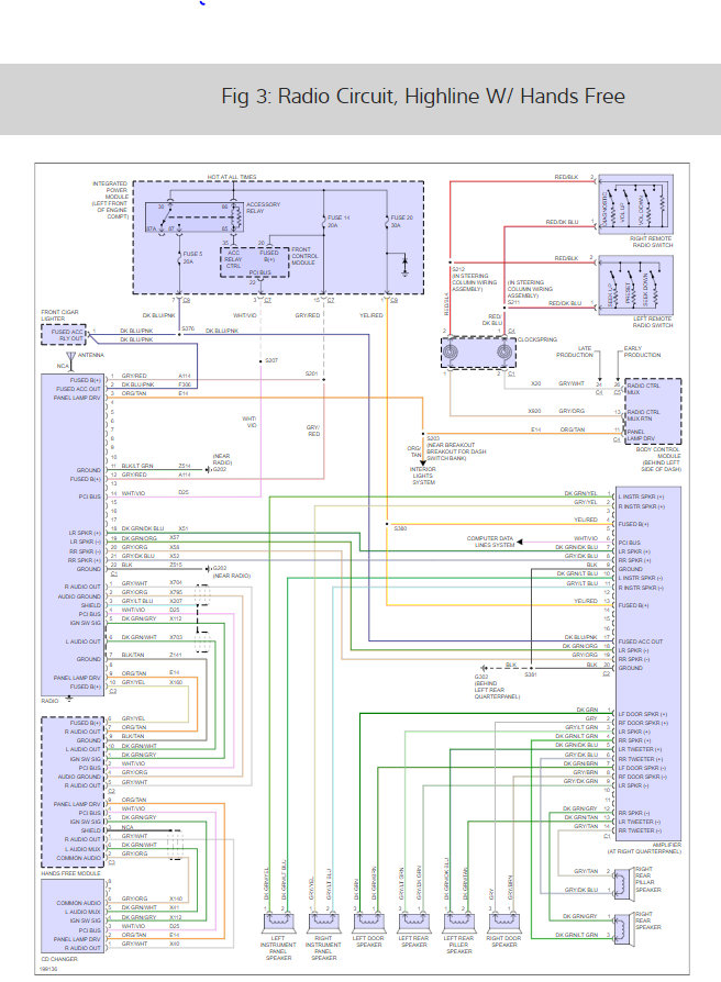

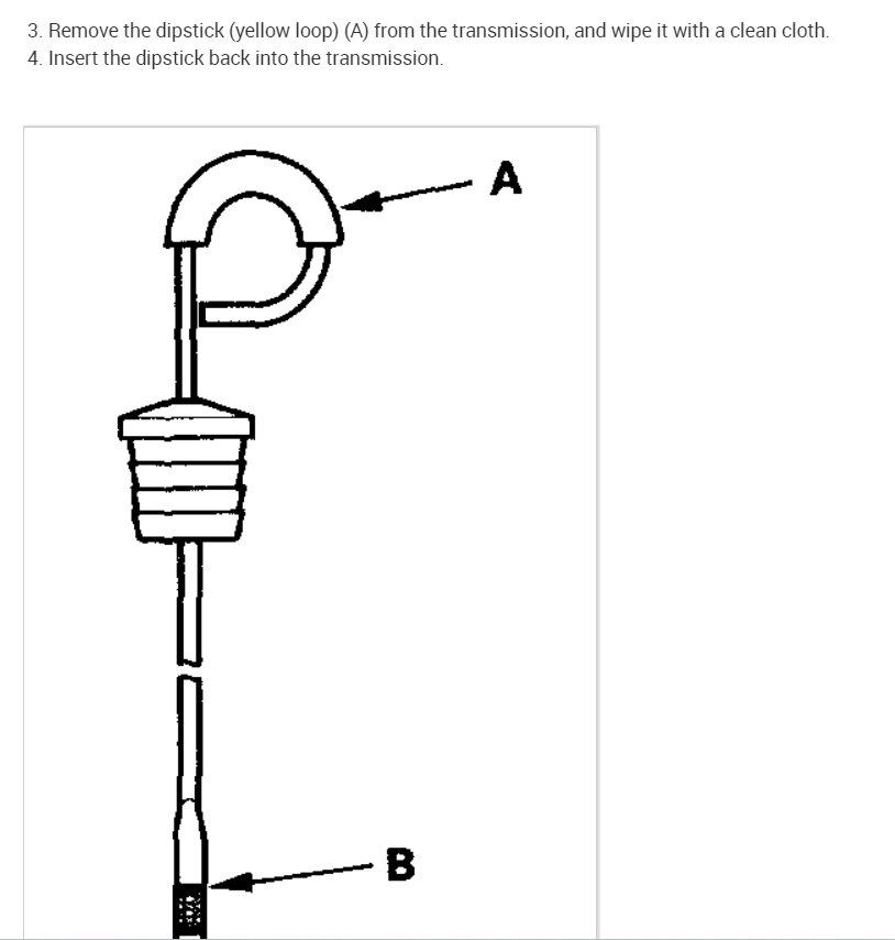

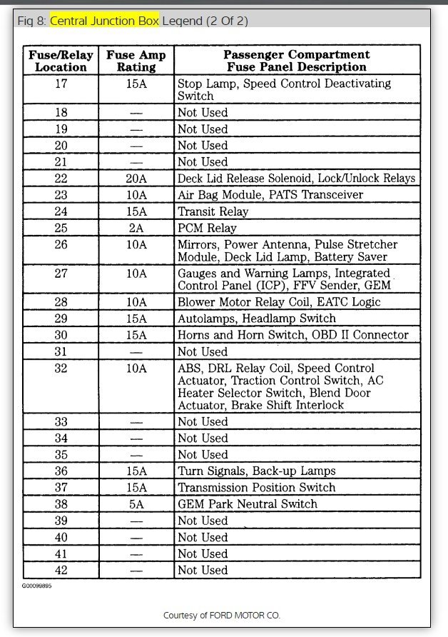

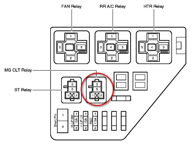

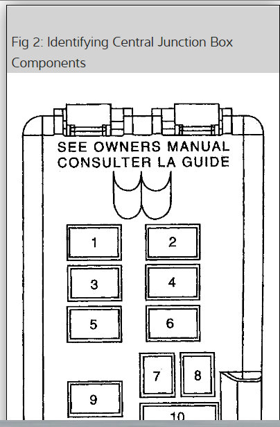

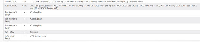

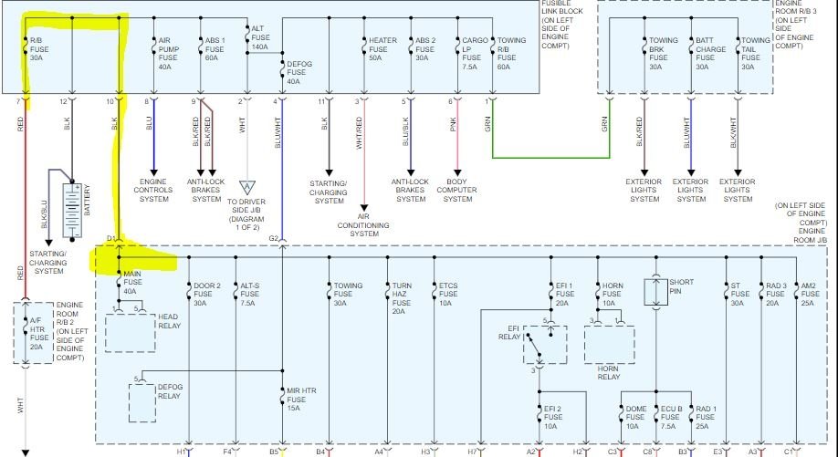

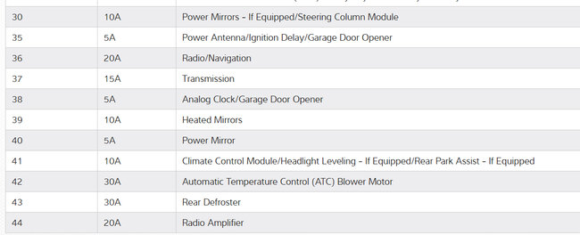

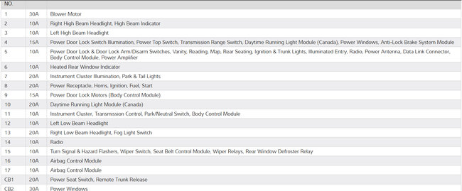

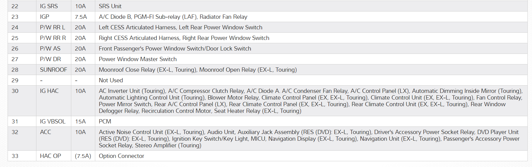

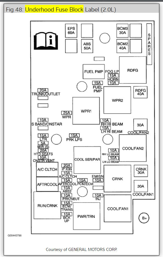

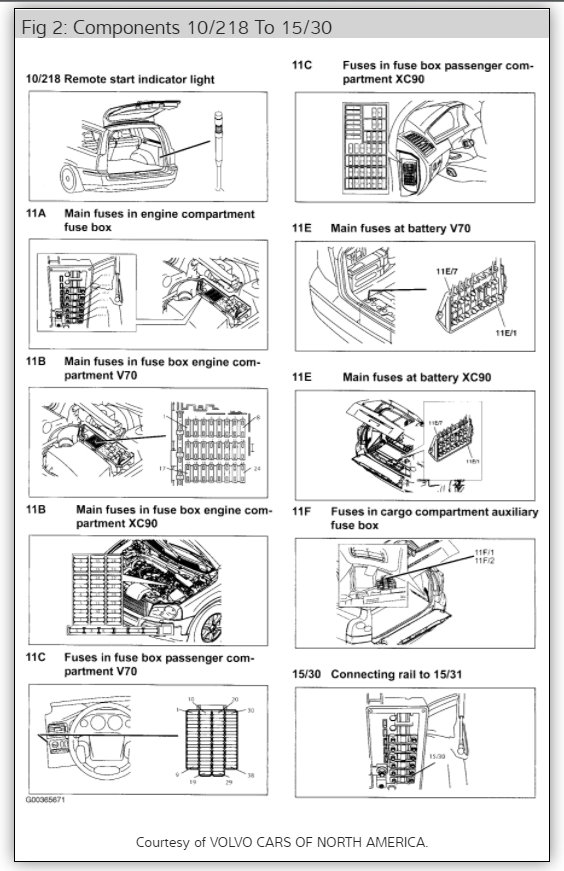

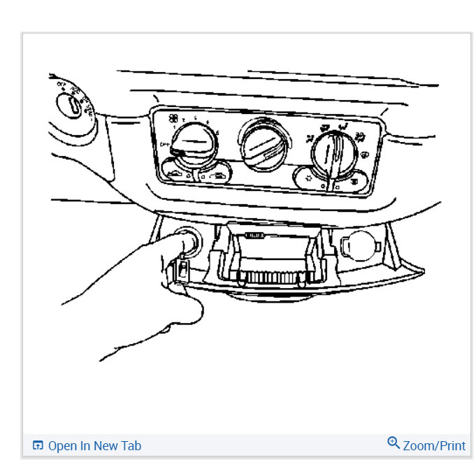

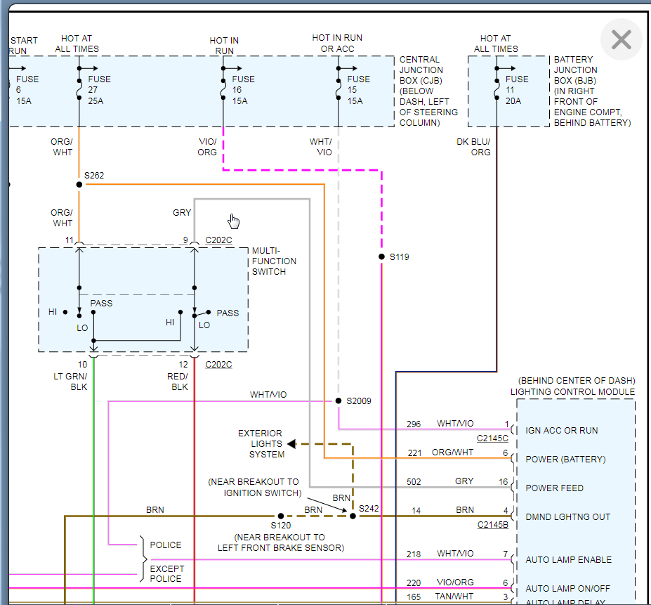

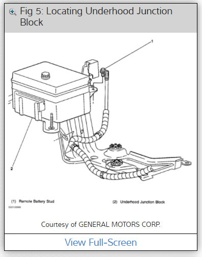

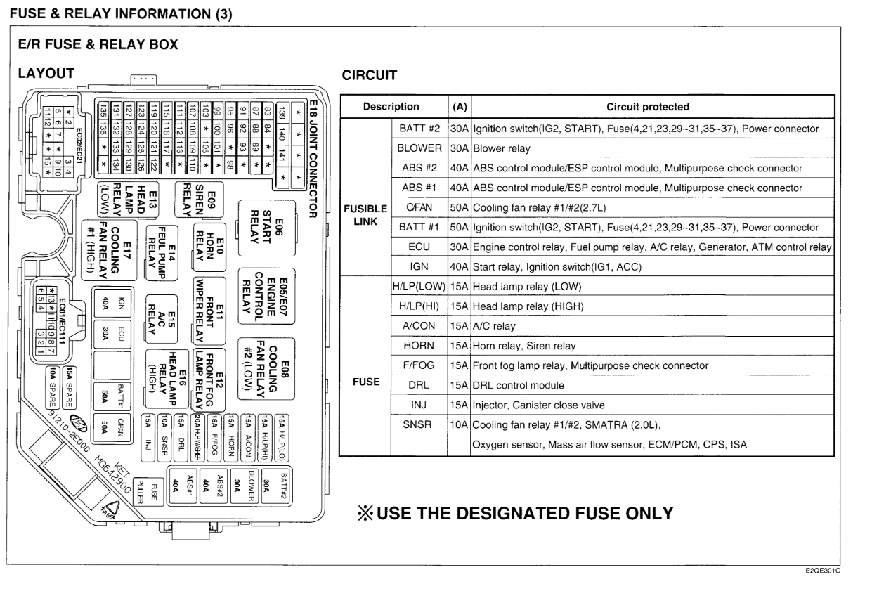

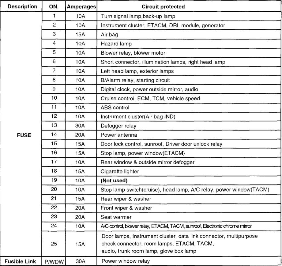

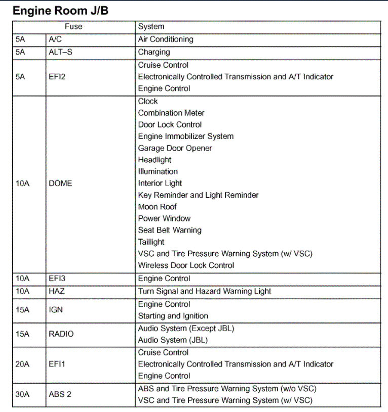

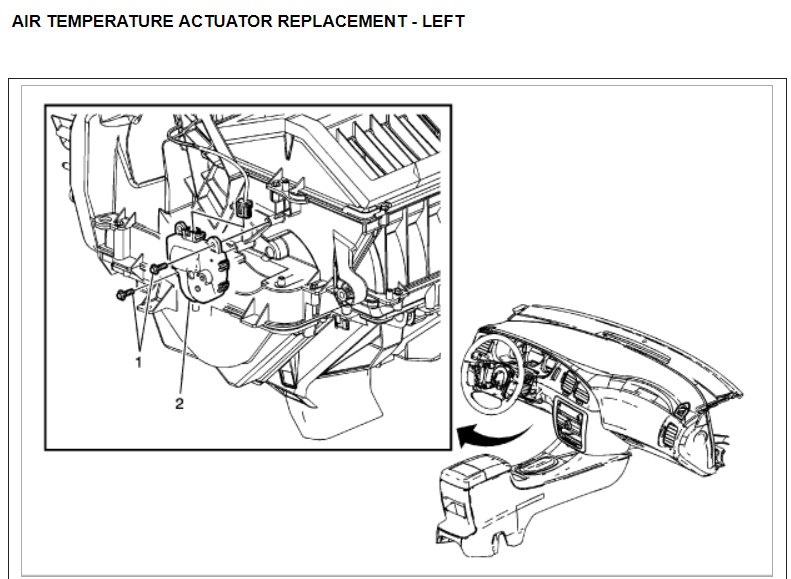

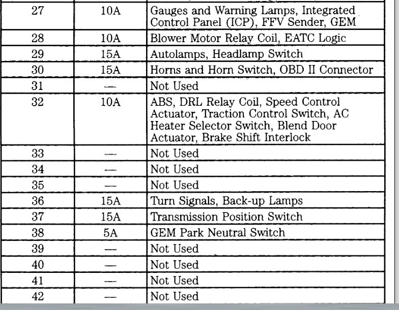

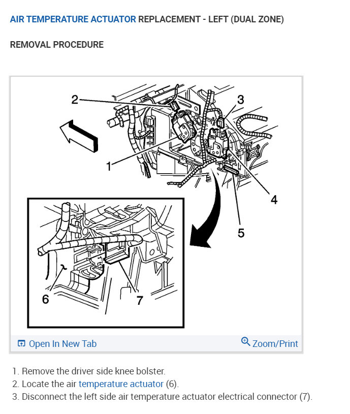

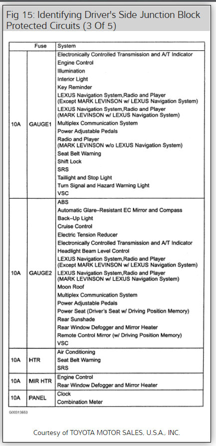

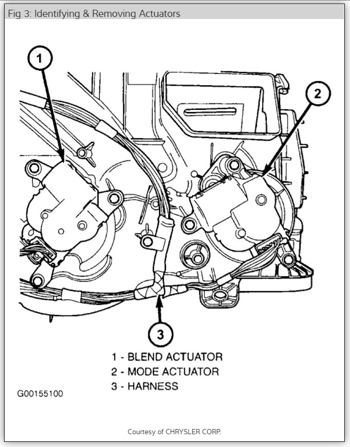

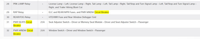

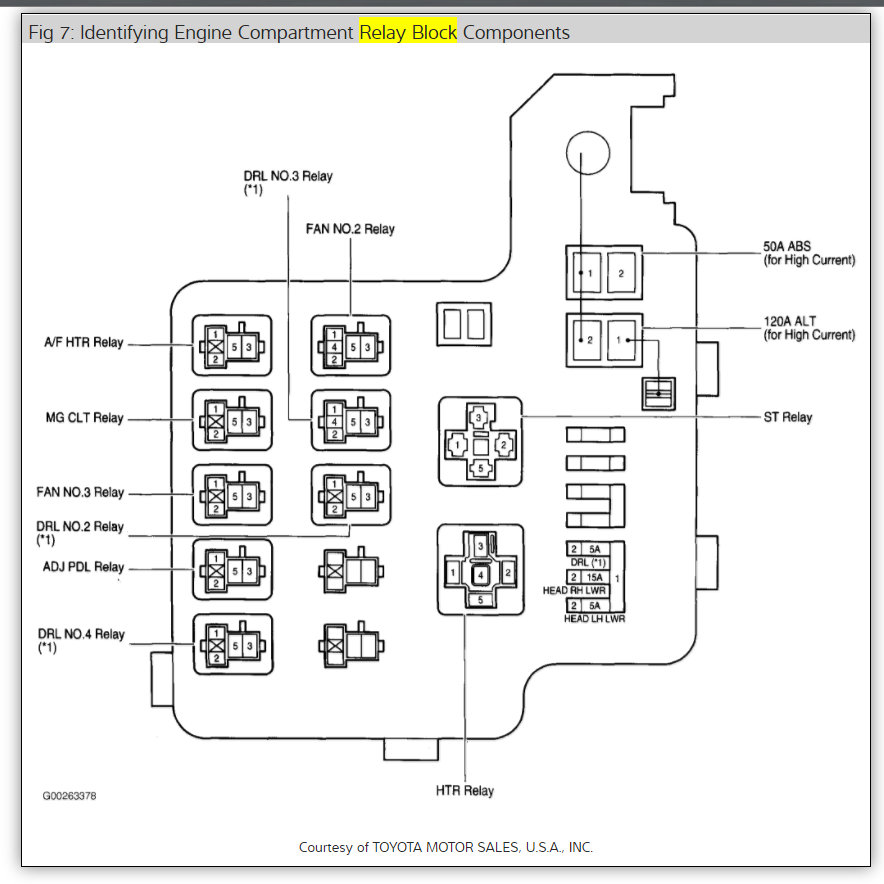

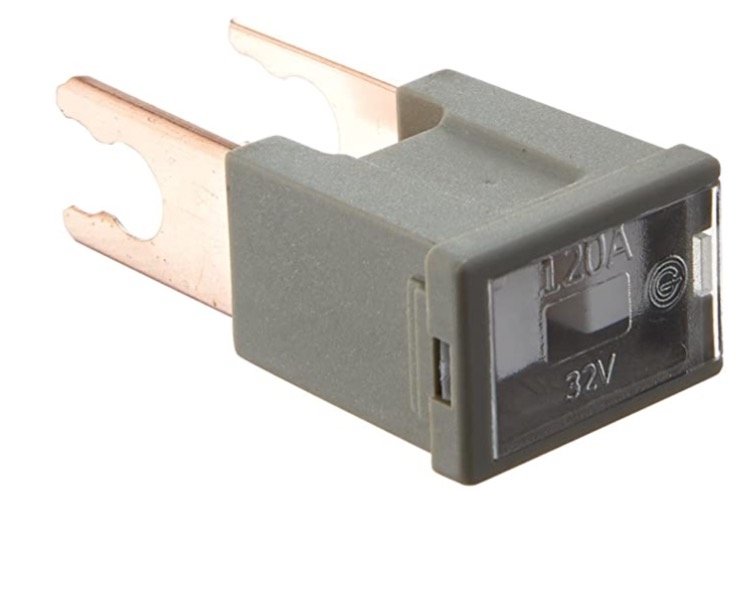

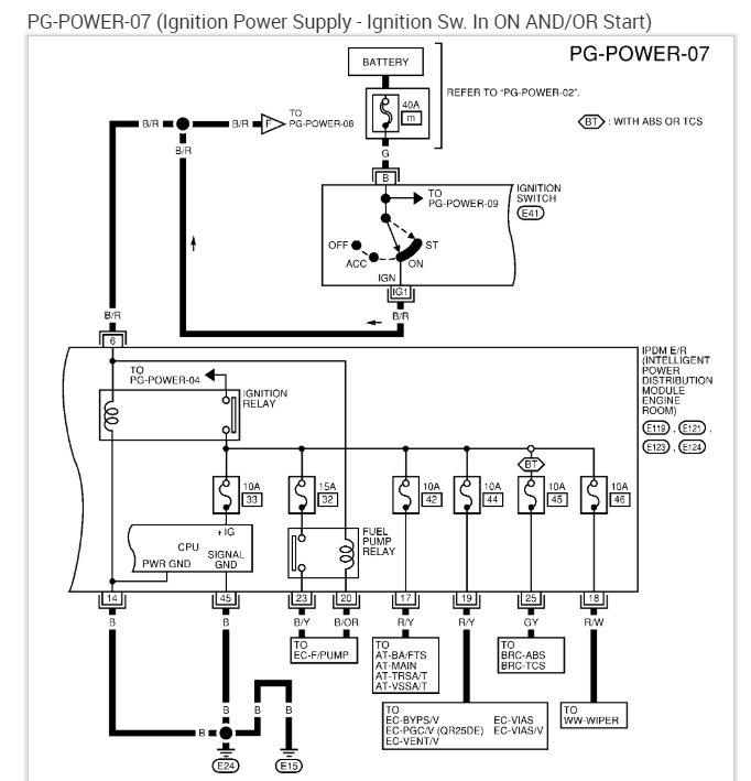

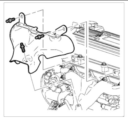

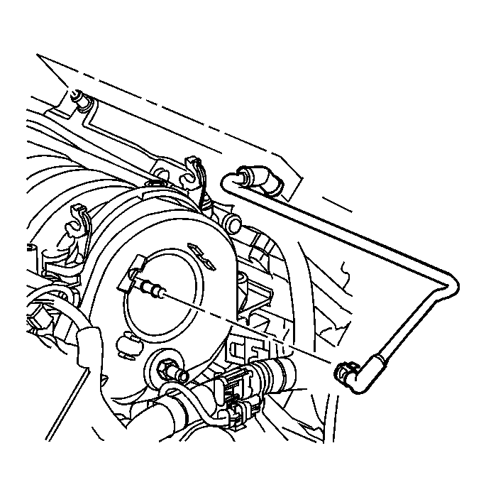

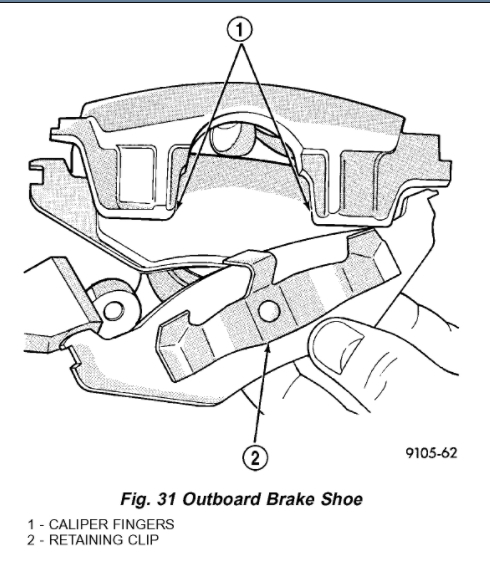

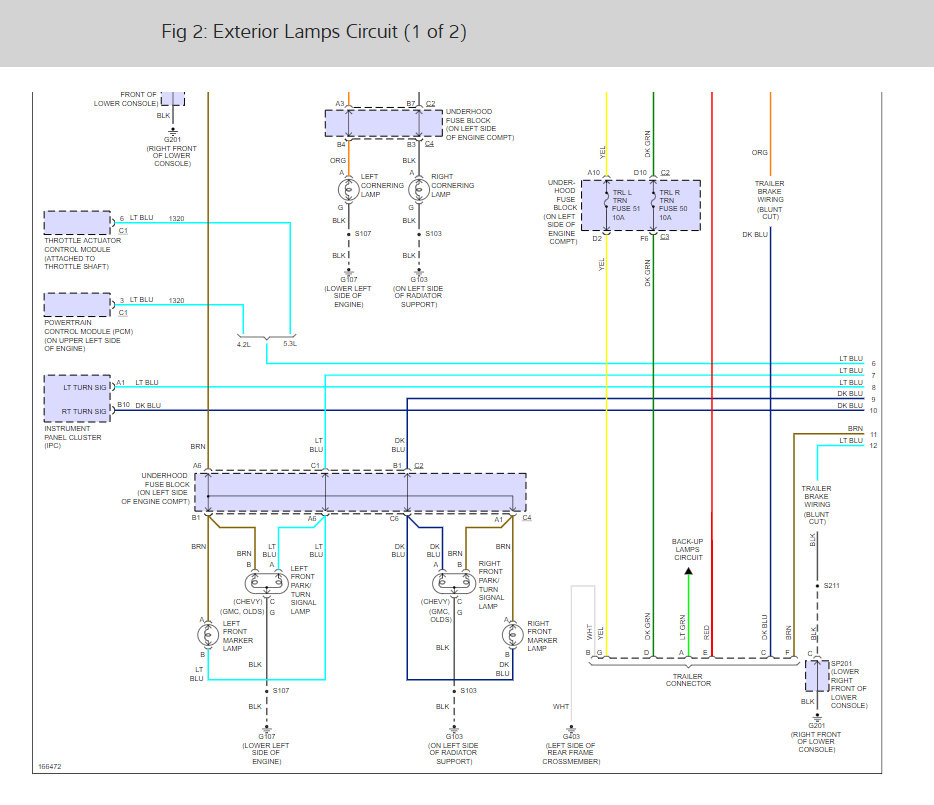

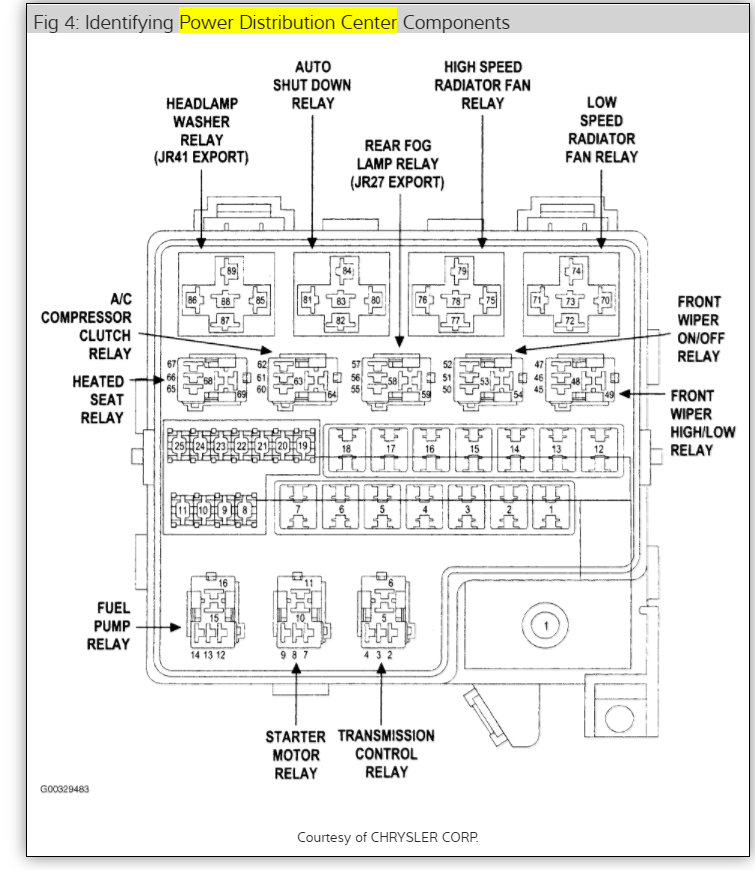

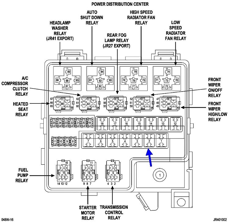

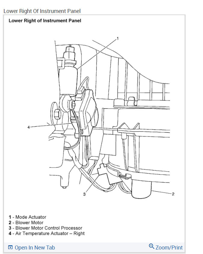

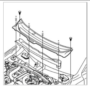

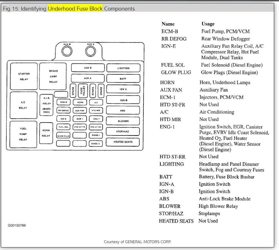

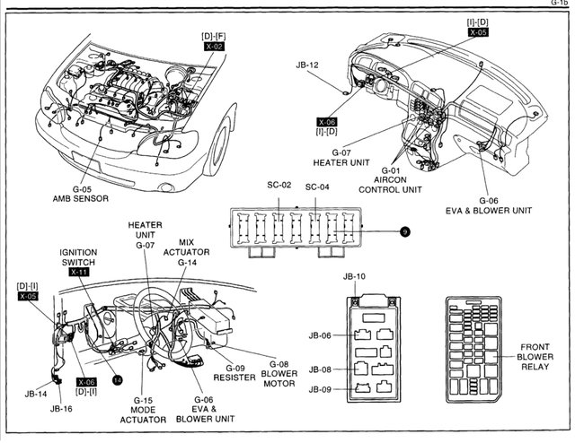

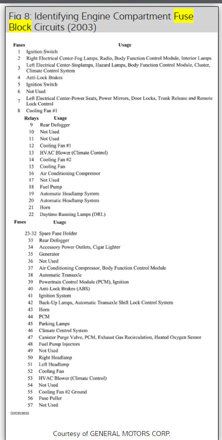

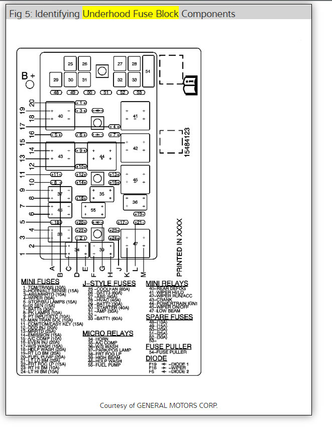

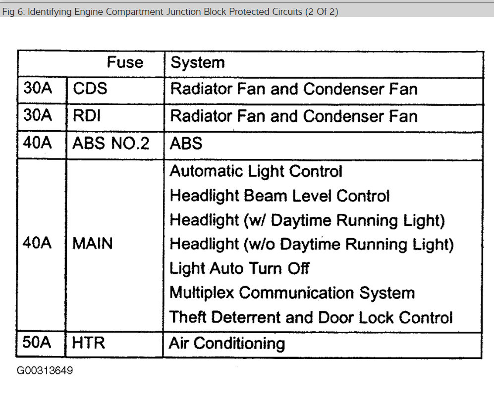

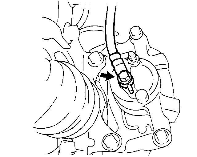

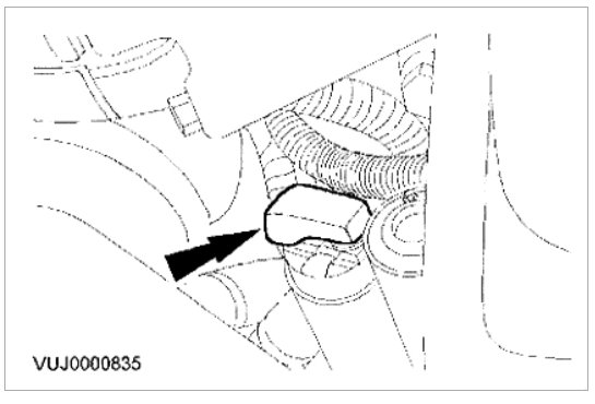

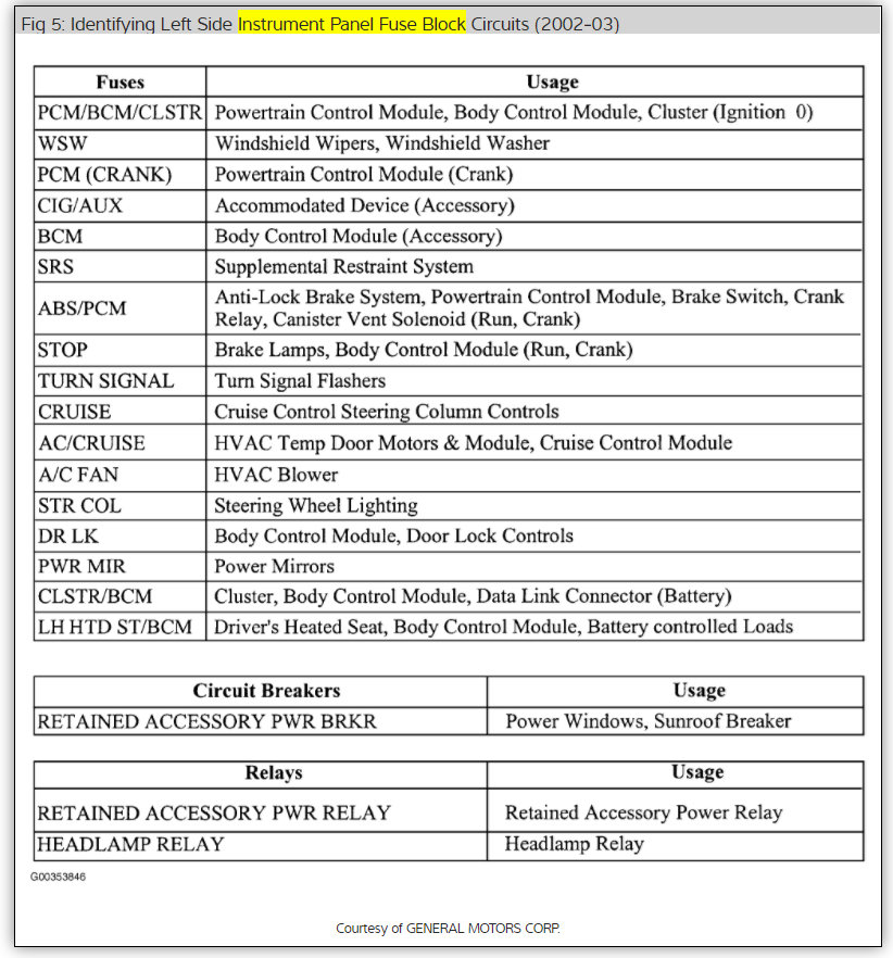

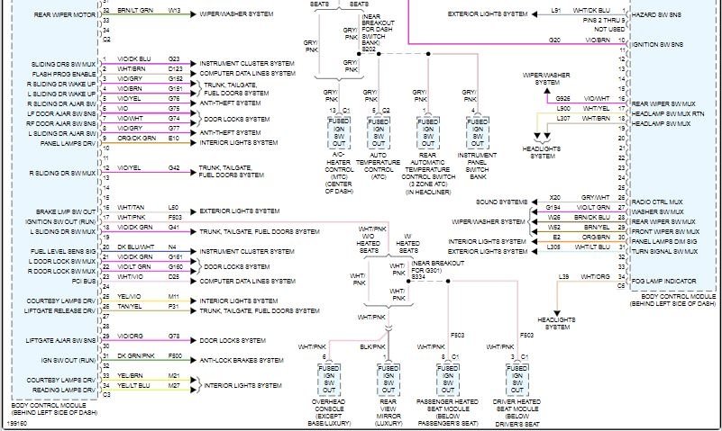

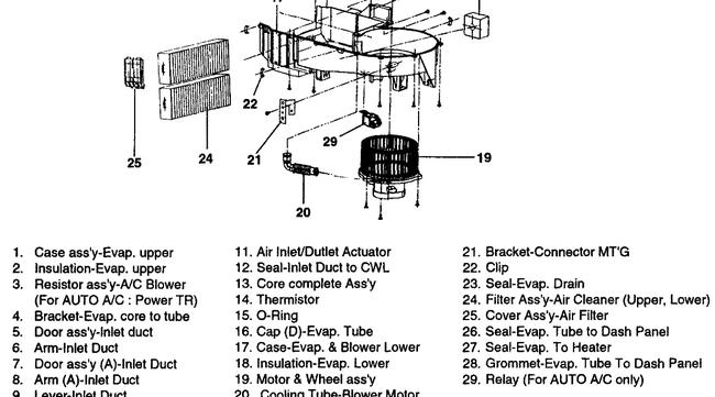

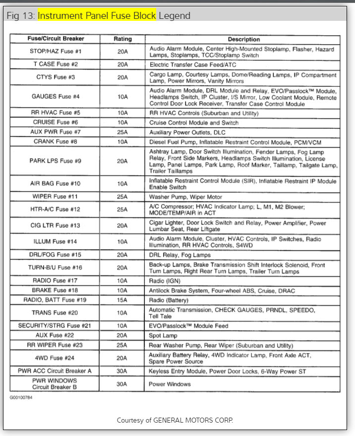

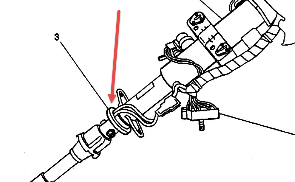

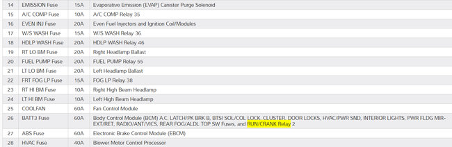

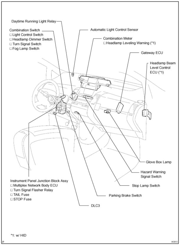

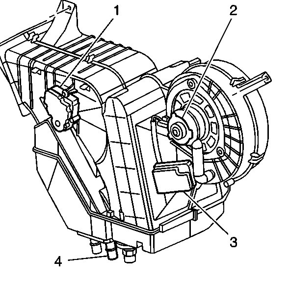

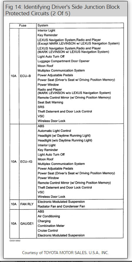

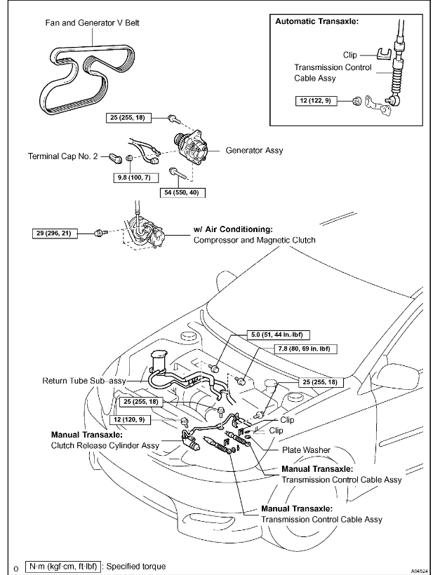

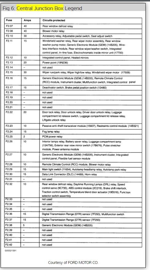

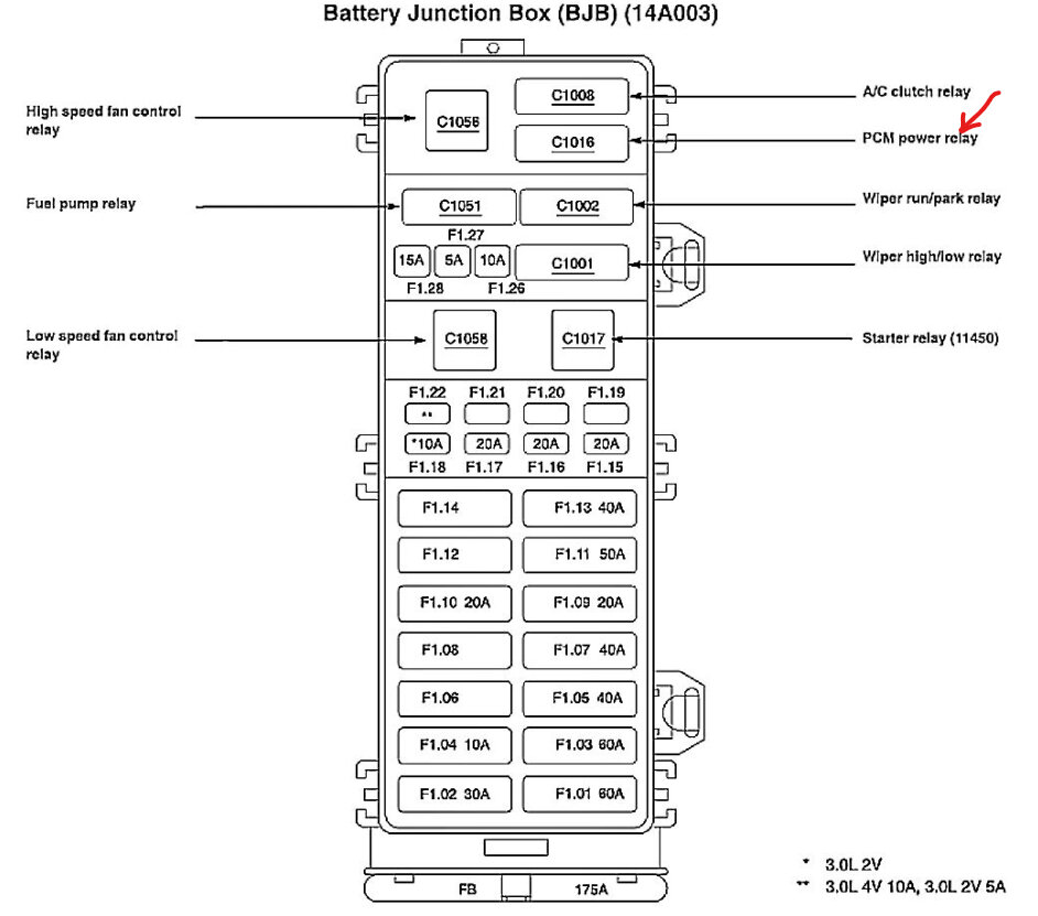

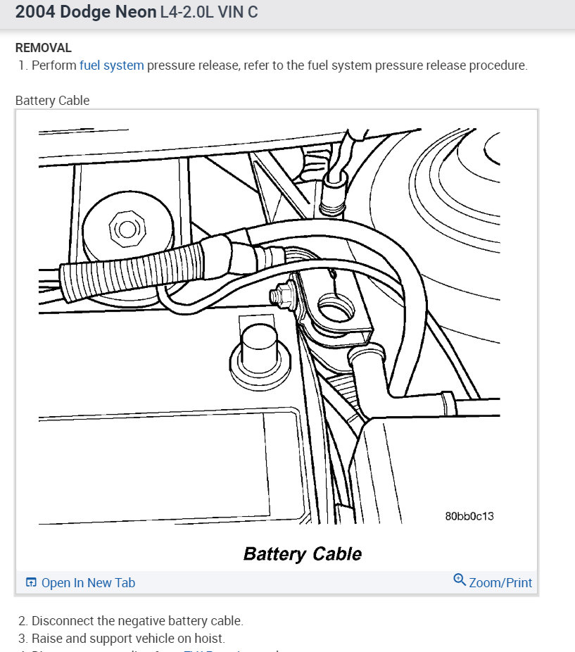

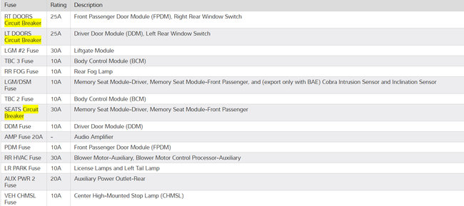

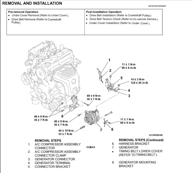

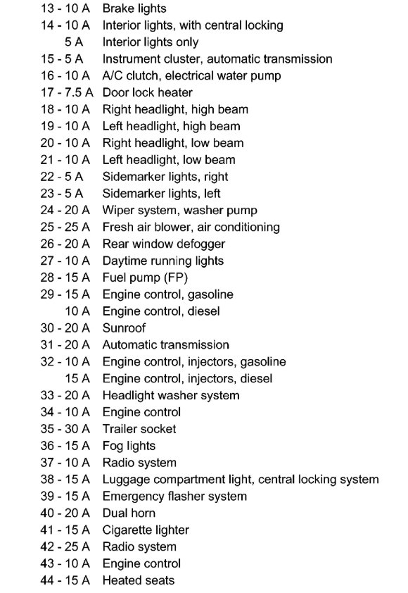

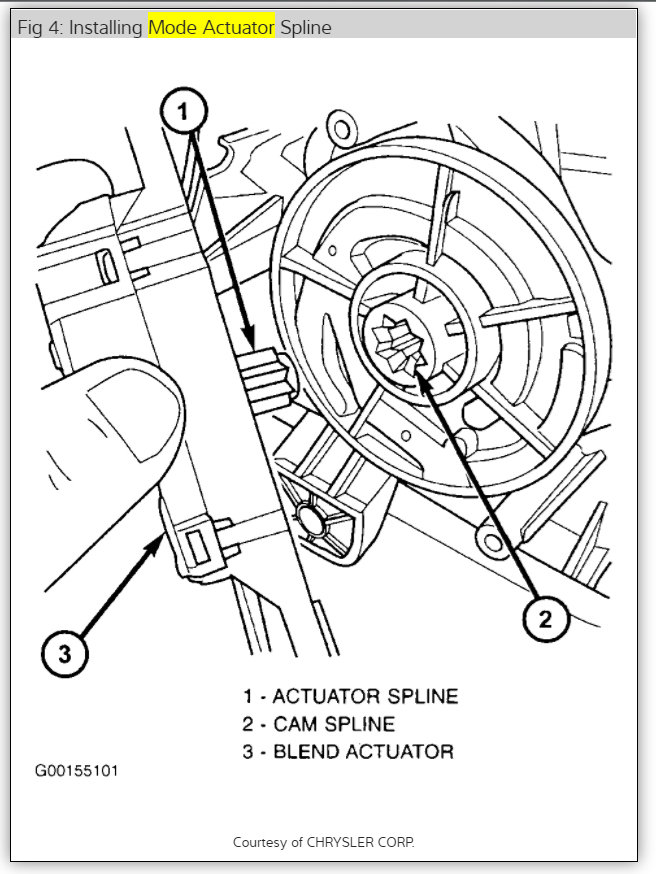

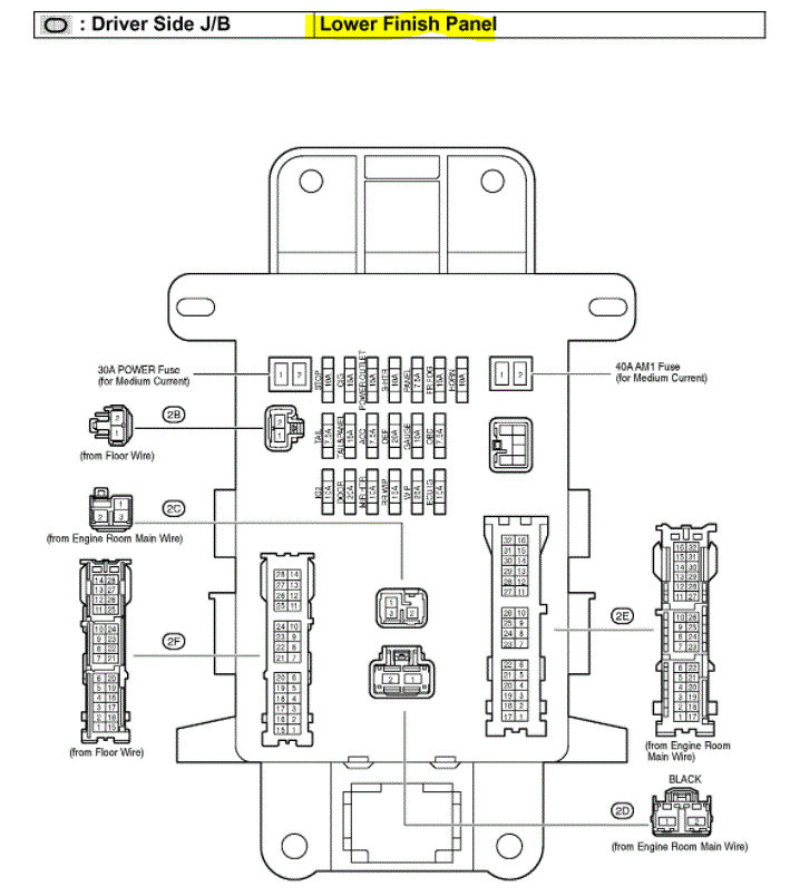

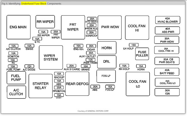

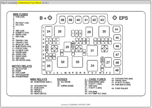

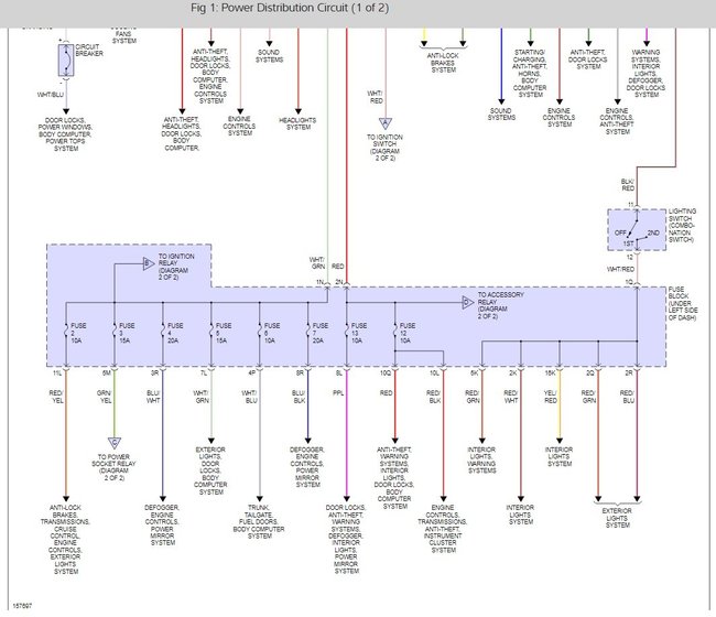

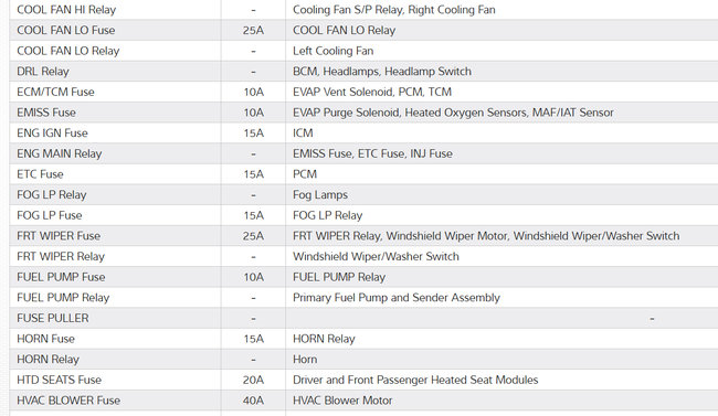

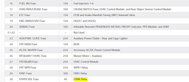

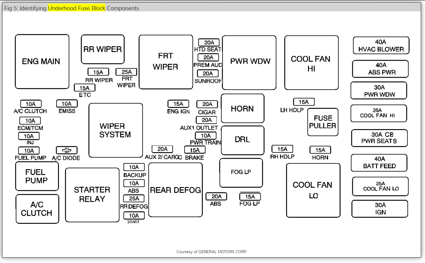

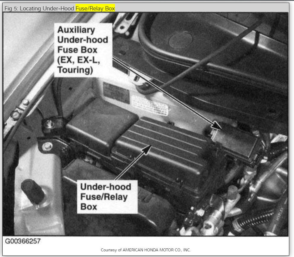

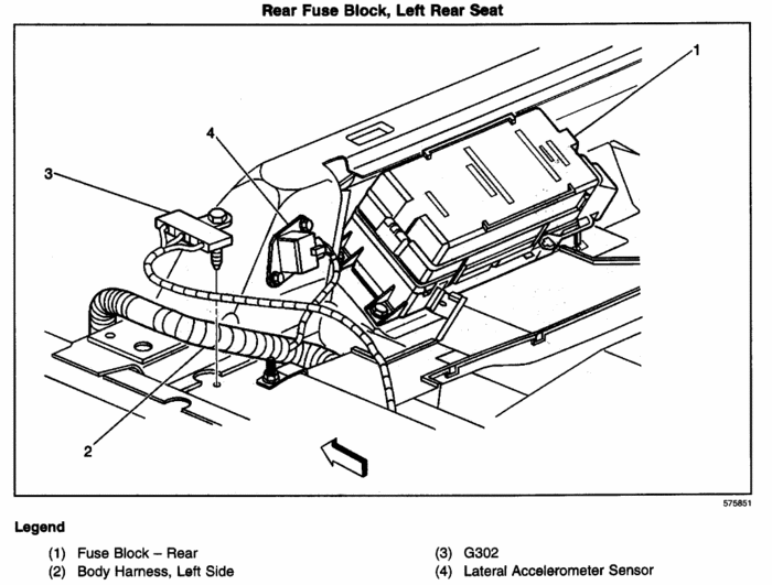

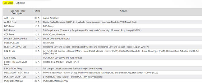

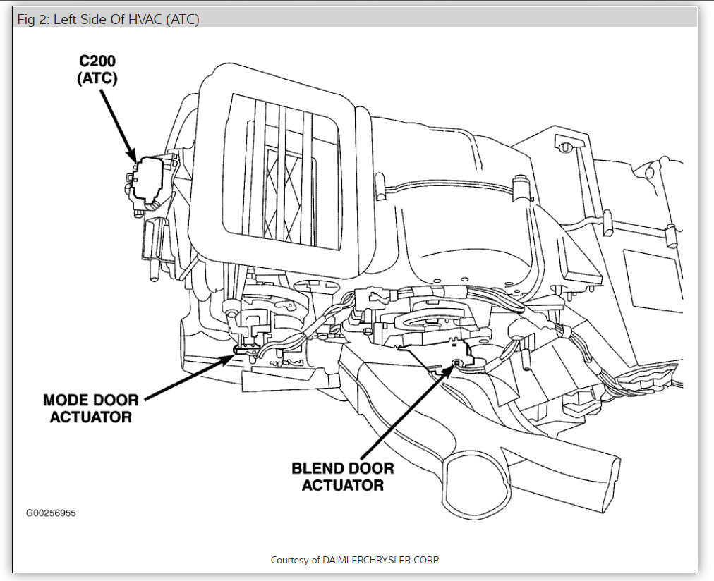

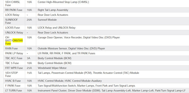

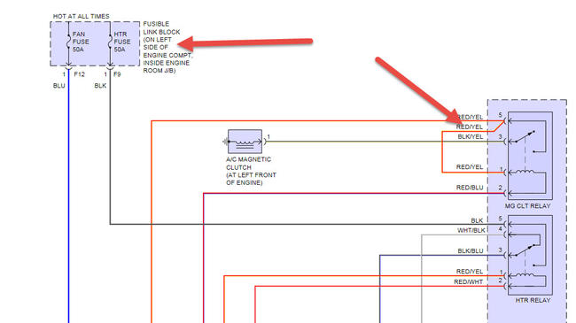

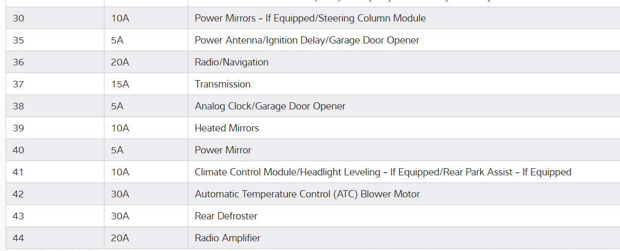

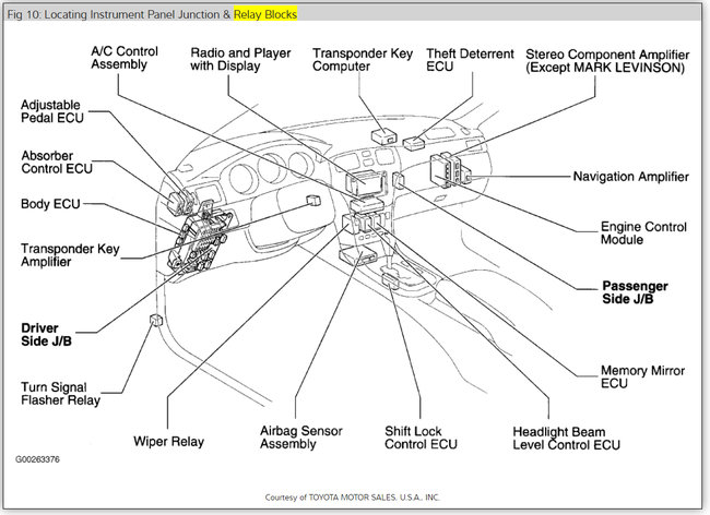

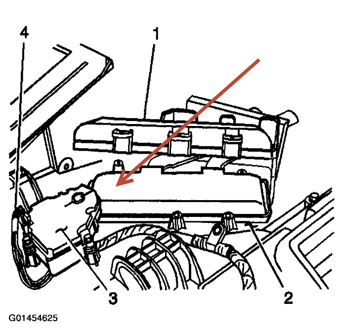

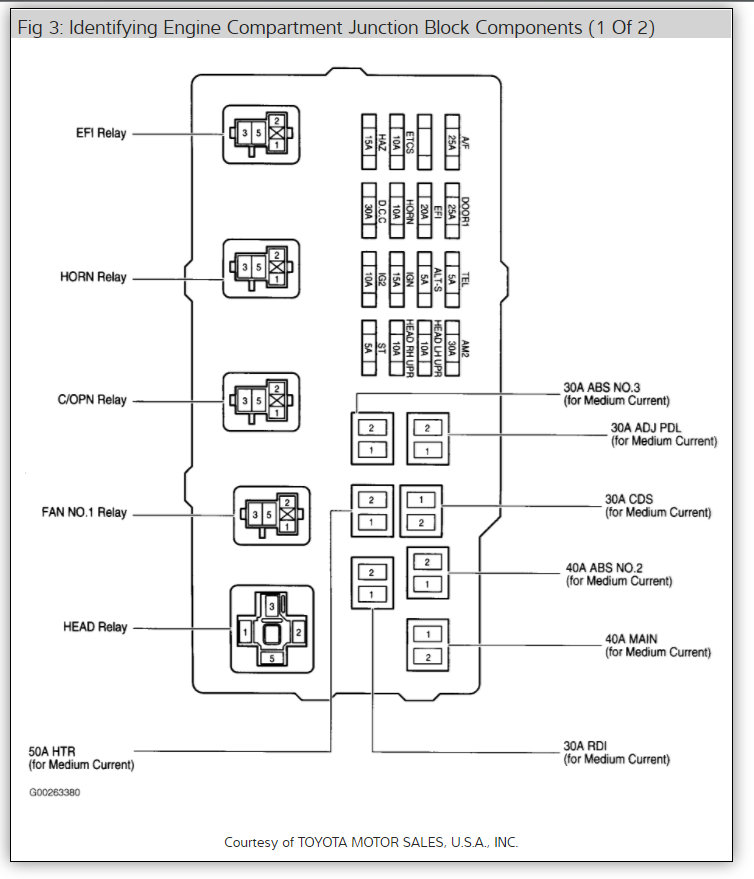

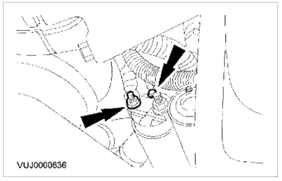

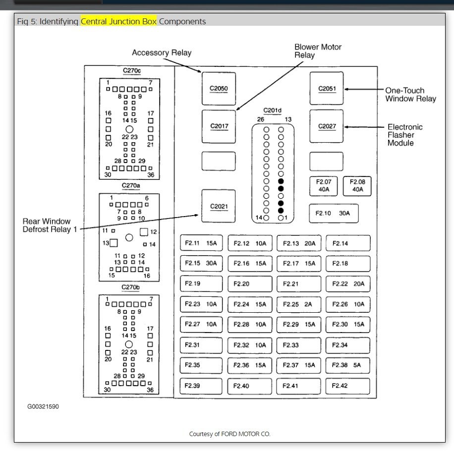

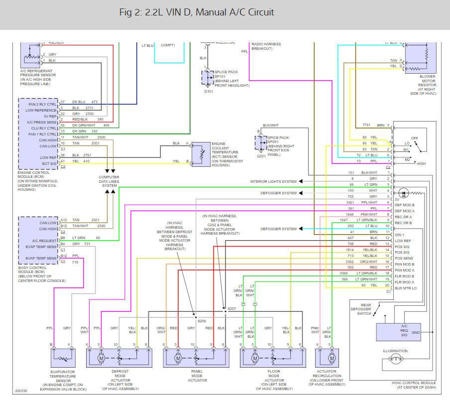

if there is no power to the compressor then fix that first not a new compressor. check items in pics then have it scanned as it may be the control head is bad. if automatic temp control it must be scanned first.
