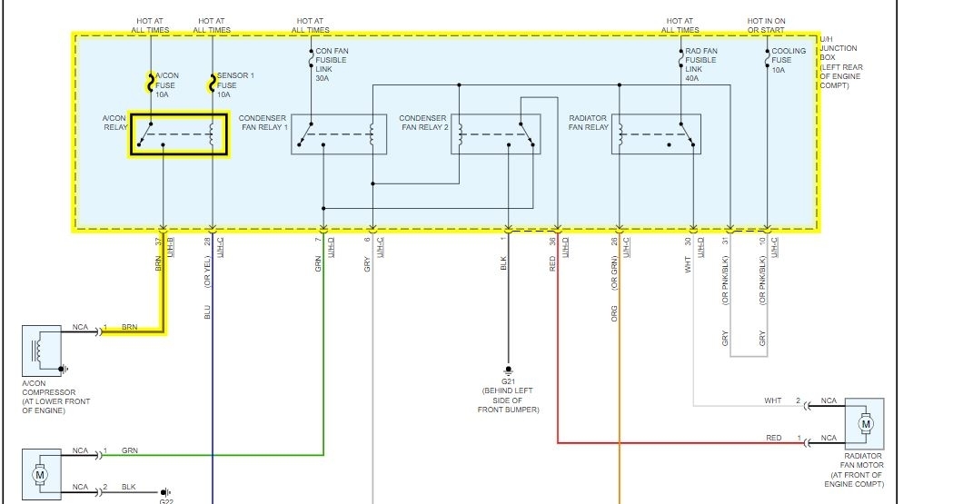

My car's A/C is not getting cold just blowing air. I have it checked with my mechanic friend he said it must be the wiring but he is not sure. Every time he tried to attach a wiring, the fuse explodes. He said it is too complicated to check for we have to take out the whole engine just to check any broken wiring. Anyone can help me please?
Jun 20, 2019 at 4:34 PM
Good morning,
You need another mechanic. That is totally inaccurate information.
You need someone to do testing to determine the area of failure.
Does the clutch engage when you turn on the A/C?

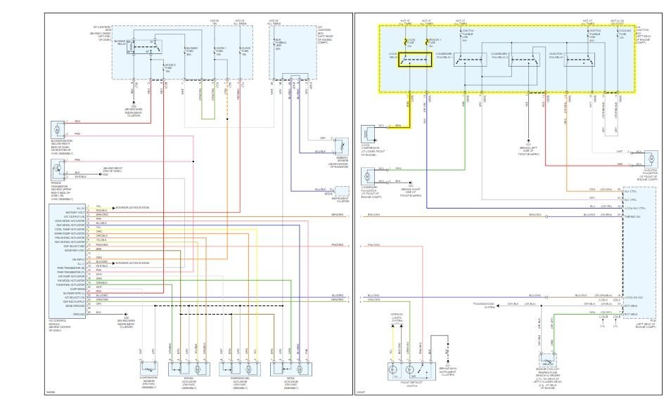

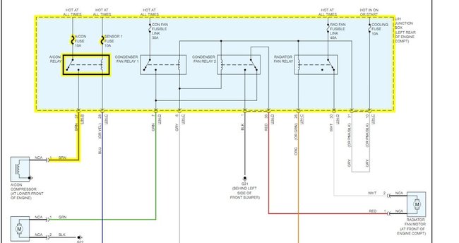

I attached a wiring diagram for you to view. You need to test for power on both sides of the fuses for the A/C system. Use a test light for this test.
Let us start there.
