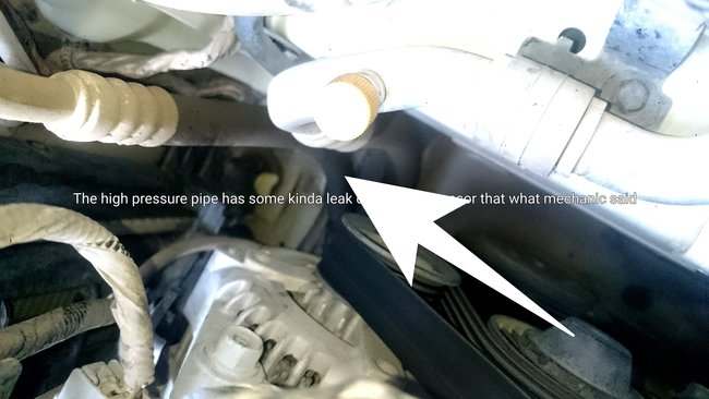

Okay, I took it to another mechanic and looks like the high pressure pipe has oil all over it especially from the bottom near to compressor. And he said the pipe need to be replaced as well as the compressor. I attached the picture aa shown below the leak part marked with arrow.
Sep 29, 2018 at 12:11 AM
The line looks like it is leaking but why did he tell you the compressor?
It could very well be low in Freon from the leak.
Sep 29, 2018 at 12:15 AM
BAKHTIAR DUSKY
  • 96 POSTS
I told him why I need to replace the compressor if the leaking is from pipe he said it was due the compressor fault. But I did not believe him I think he was trying to rip me off.
And he checked the low pressure from Freon he said it is okay.
So but most likely the leak is near to compressor end to high pressure pipe.
So I am not sure what to do.
Sep 29, 2018 at 12:25 AM
Compressors do not cause a leak from a line. It is the line that has worn out.

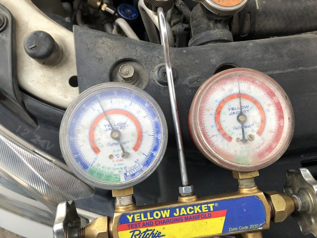

Okay, here the results looks like they both are in normal range.
But he said your compressor is getting weak and it’s an electric compressor not the clutch one and not sure what are those. He said since we are in summer and it is about 45c here so it kind of normal for those electric compressor.
Aug 14, 2019 at 1:01 AM
Okay, no, they are not normal at all.
the low side is way too high. It should be 25-30 lbs. You are at 60.
You need an expansion valve and a dryer.
